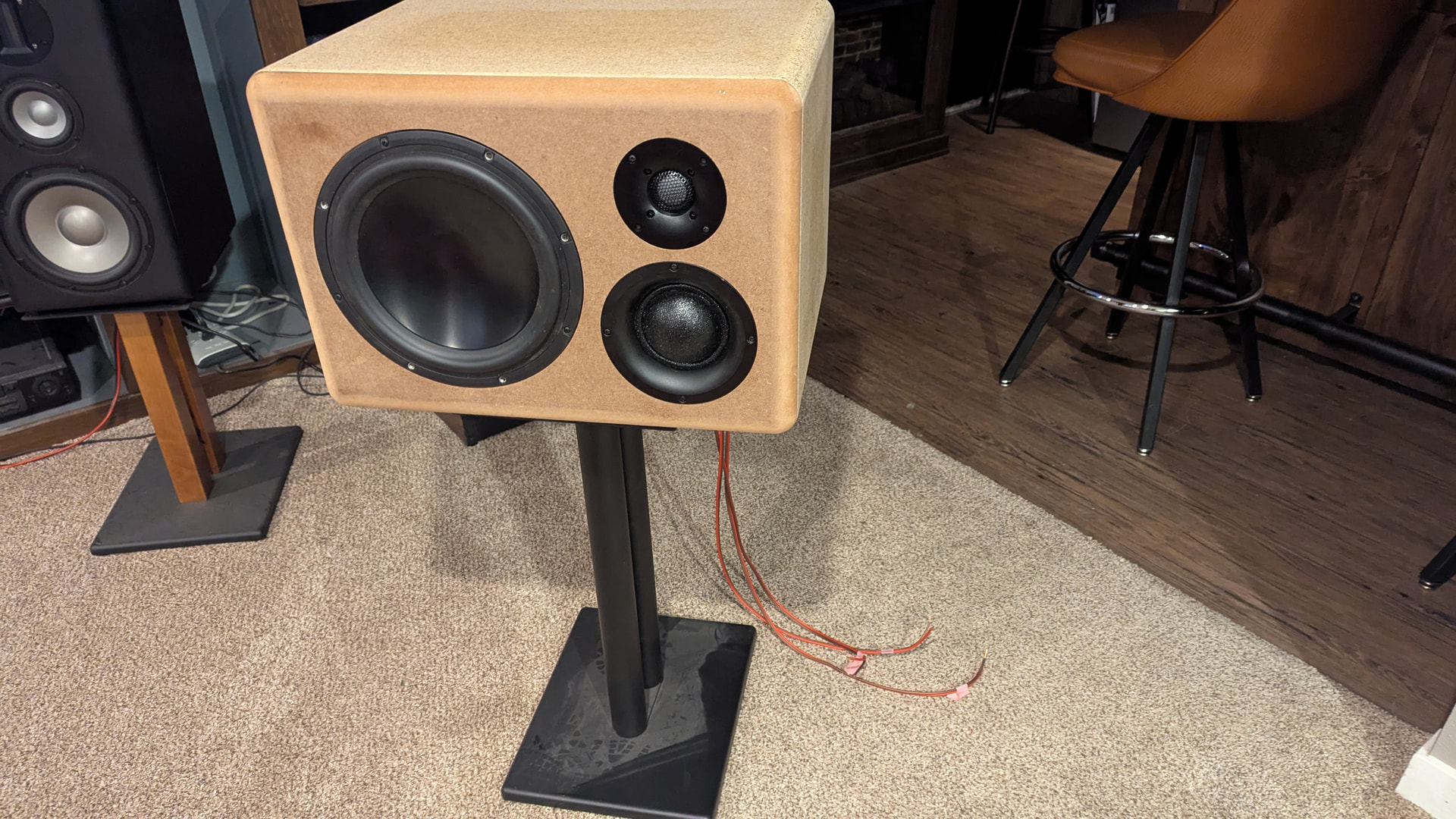

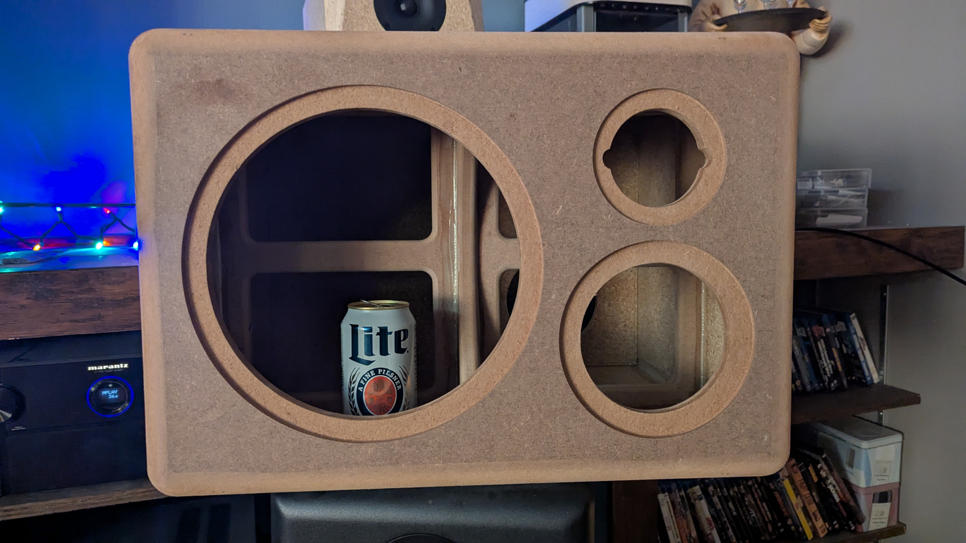

These are fairly large cabinets at almost 2 cubic feet, the picture does not do them justice lol. Will be moderately heavy when loaded. I am fairly excited about these.
Beer can for scale. Big boys.

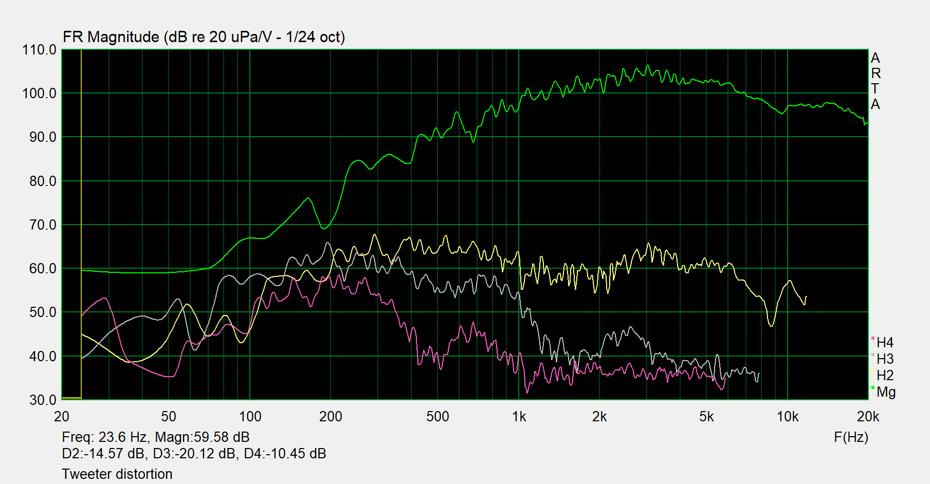

Tweeter distortion, very impressive IMHO. FR is a little weird but I can work with it.

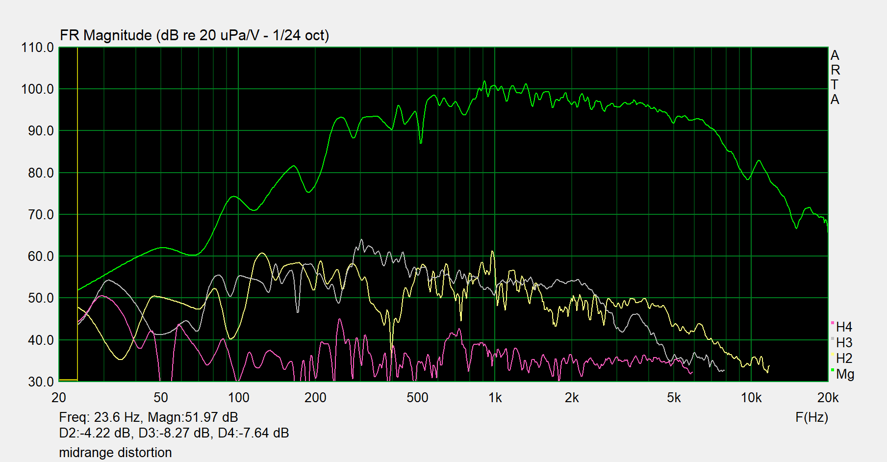

Midrange distortion.

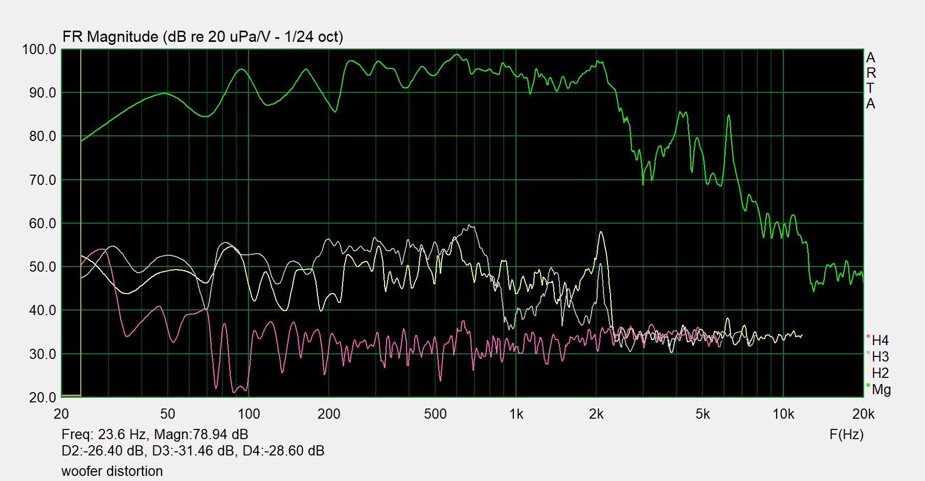

Woofer distortion.

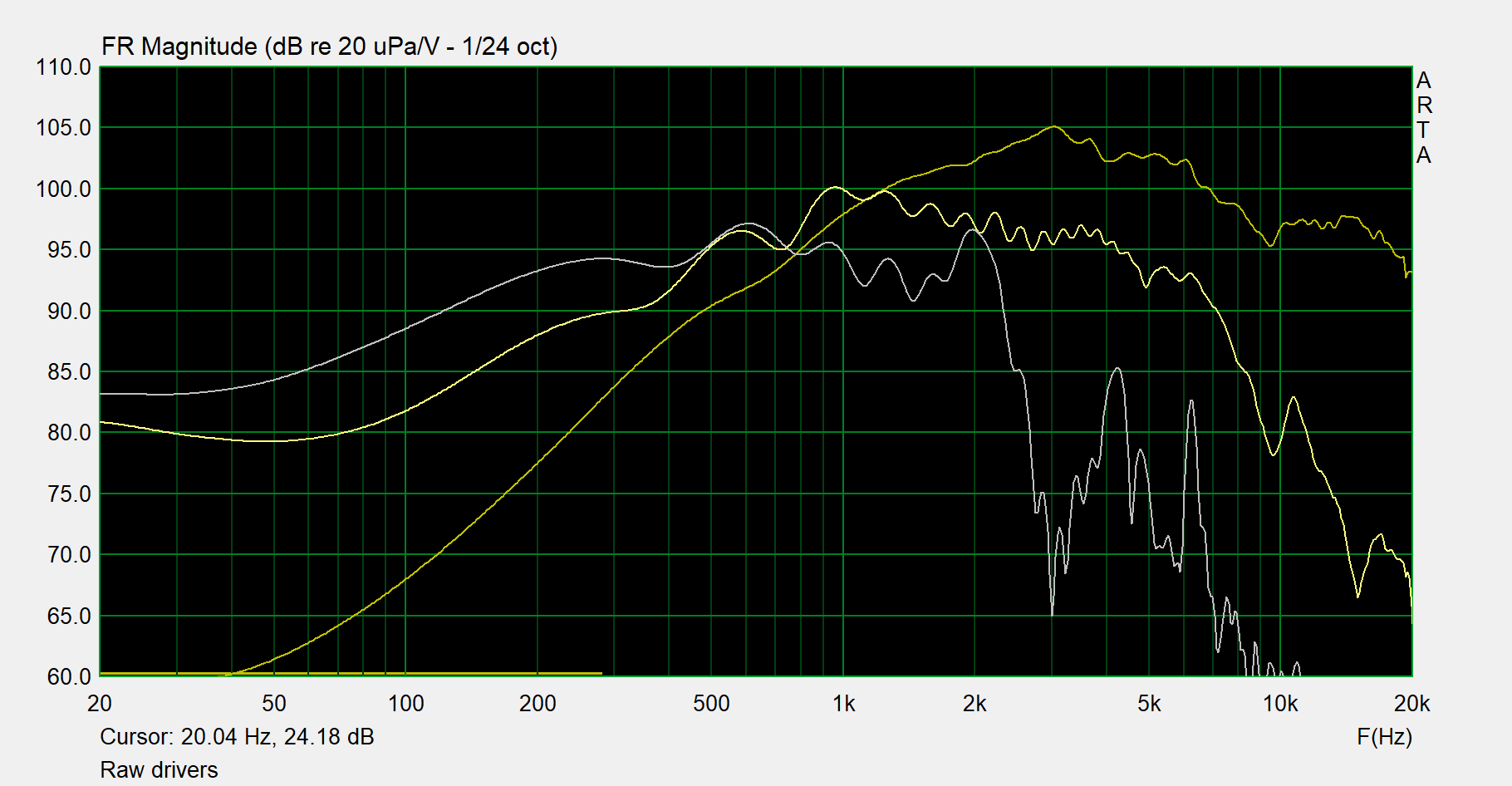

Raw responses. I measured everything at 1M on tweeter axis.

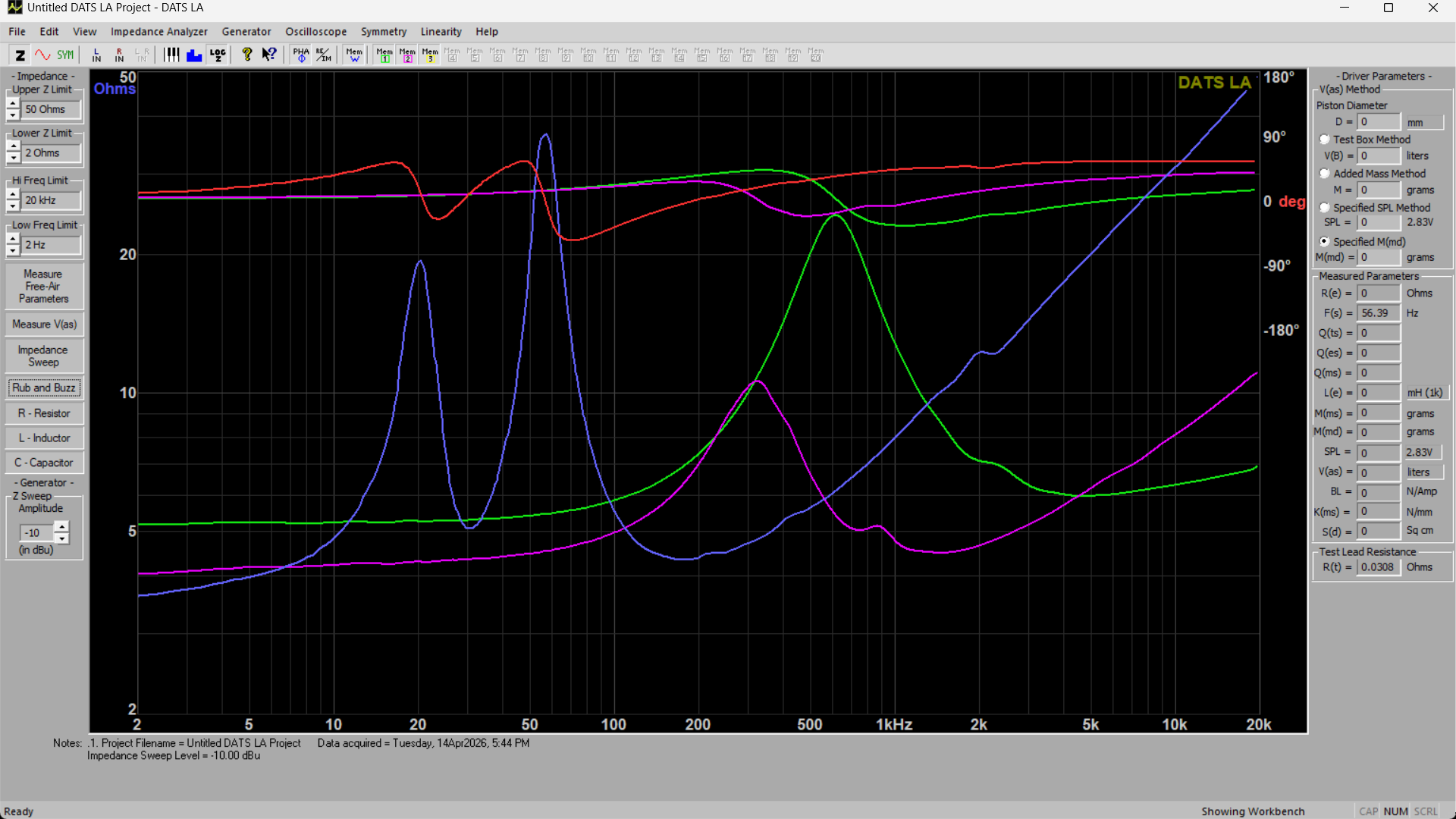

Impedance of each driver.

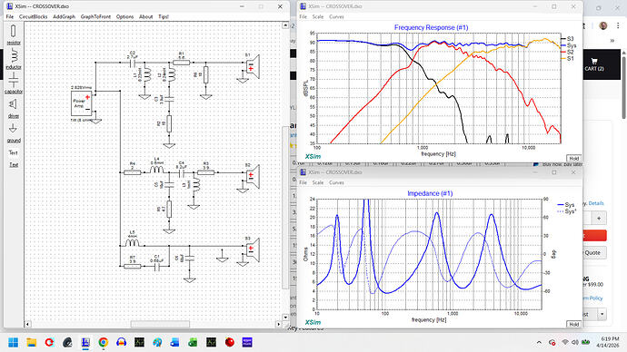

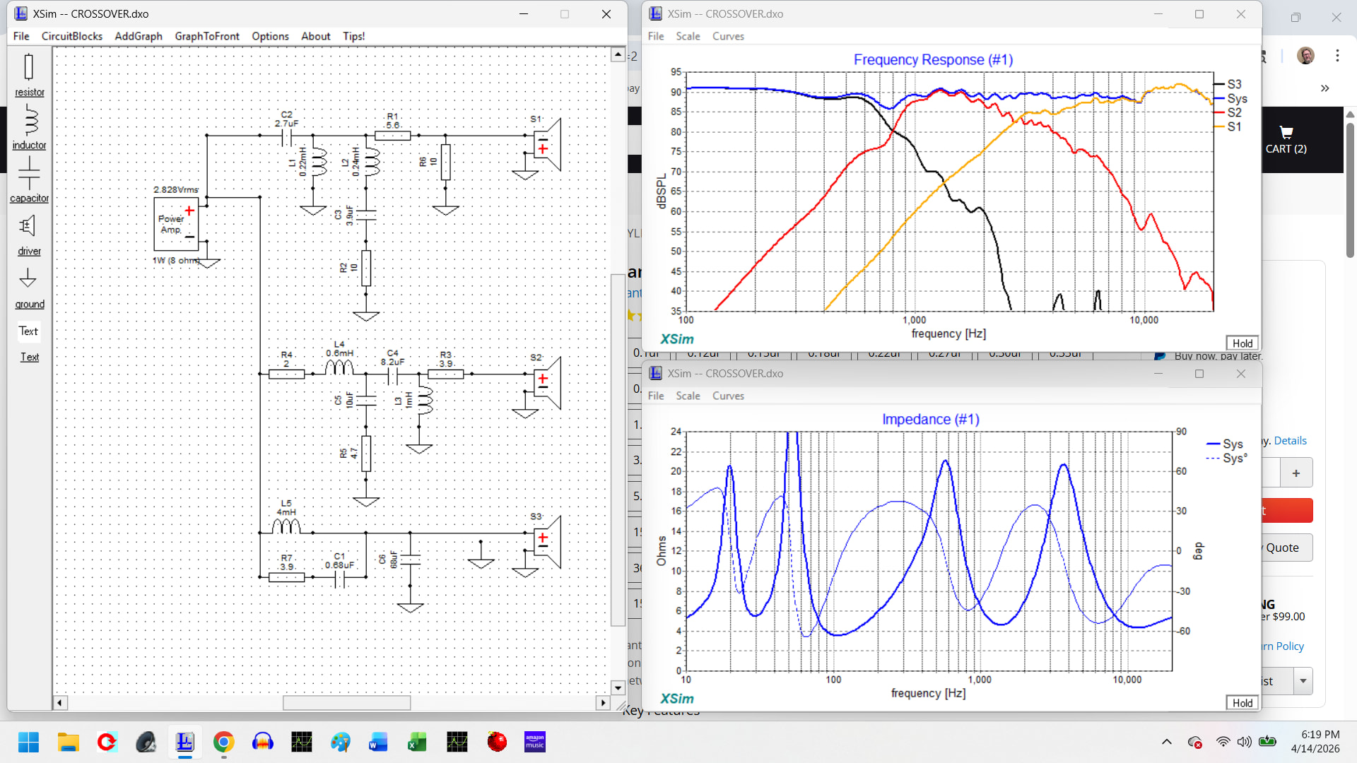

Just dicking around and came up with this. I’ll clip it up tomorrow and see what’s up.
