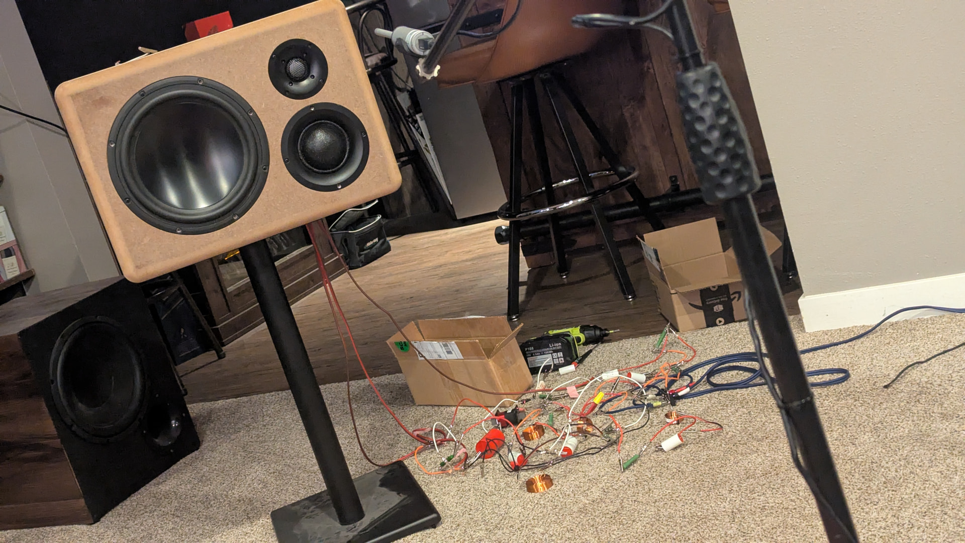

Wow, that looks very promising.
I wonder if you’ll be able to get a little lower with the mid. Not a bad start by any stretch.
800 is low enough.
Maybe a little higher with the mid ???
Anyway- good looking driver combo !
3k is about all the higher a 3” dome should go.
Just looked like it had a little more to give is all. No offense intended.
I was thinking up towards 3.8kH, as measuring up thru 4kHz fairly clean, but may of course be other reasons not to go that high.

No offense taken. I am targeting high output with this bad boy, and want to ensure some extra protection on the mid, is all.

These look like they’re going to be KILLER!
These tweeters are no joke.
The fun(er) part. Xover parts all over the floor !
I’m behind, JR. These aren’t the ribbons you started with. What are they?
Some Chinese beryllium tweeters.
Veils lifted? more detail?
