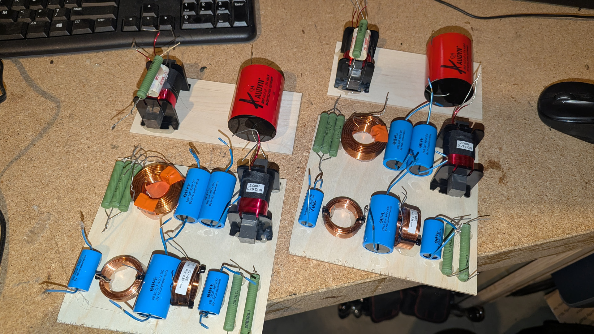

Here I sit listening to them. I think I like current crossover. I’ll know more in another hour or so. Have company coming over tonight, so will have to put shit away. They do not see the beauty in a floor full of components.

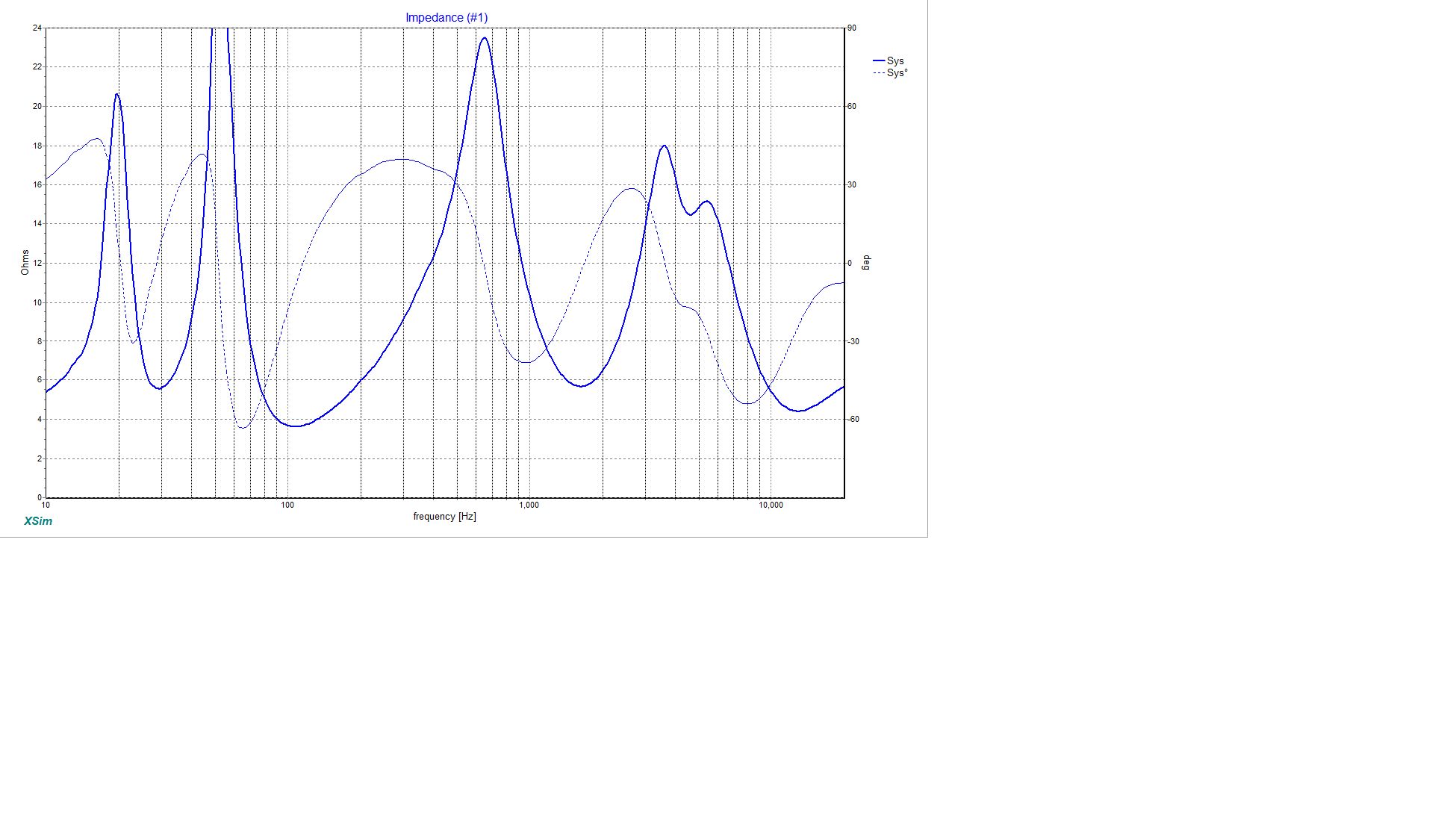

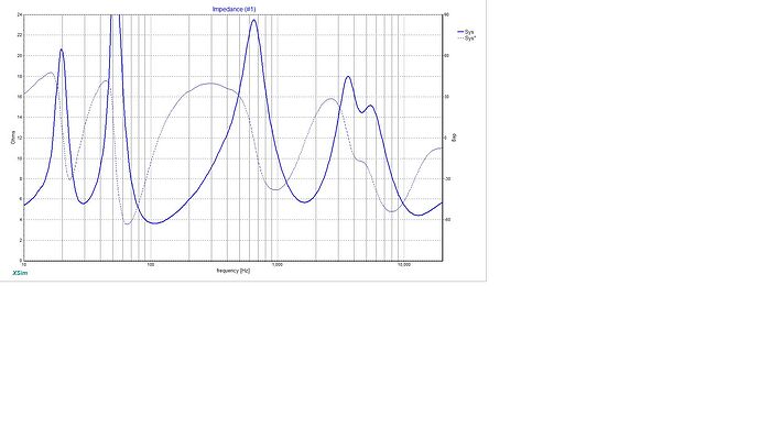

I should add I am miles away from the sim I posted. It happens. I believe the woofer network is the same, though. I am currently listening to a version of the XO that is the result of my voicing. I did receive a thumbs up from Mrs. JR.
Typically for my 3 ways, the woofer LP is close to the sim, but the midrange needs a lot of tweaking. I need to learn VituixCad, which should be closer to real world.

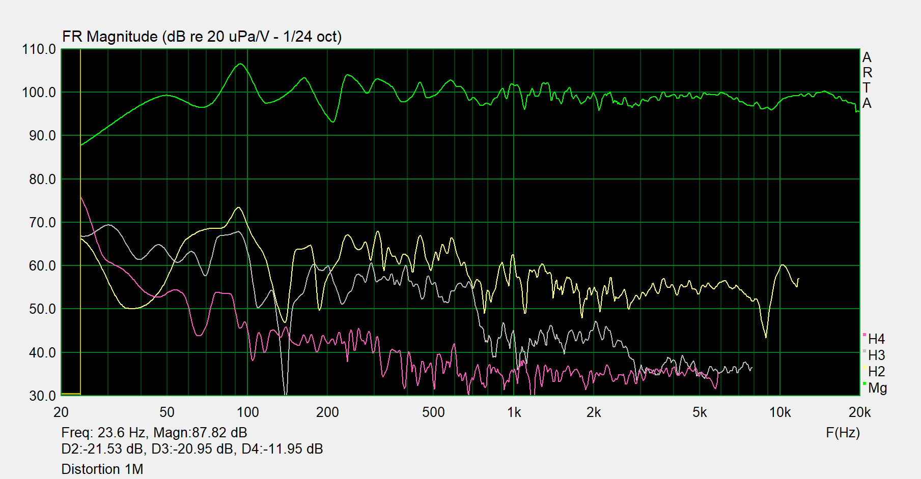

Current iteration is pretty nice. Here is distortion measured at 1M, SPL accurate. Plenty loud, plenty clean. Can definitely see that the Signature motor is not as advanced as the mid or the tweet.

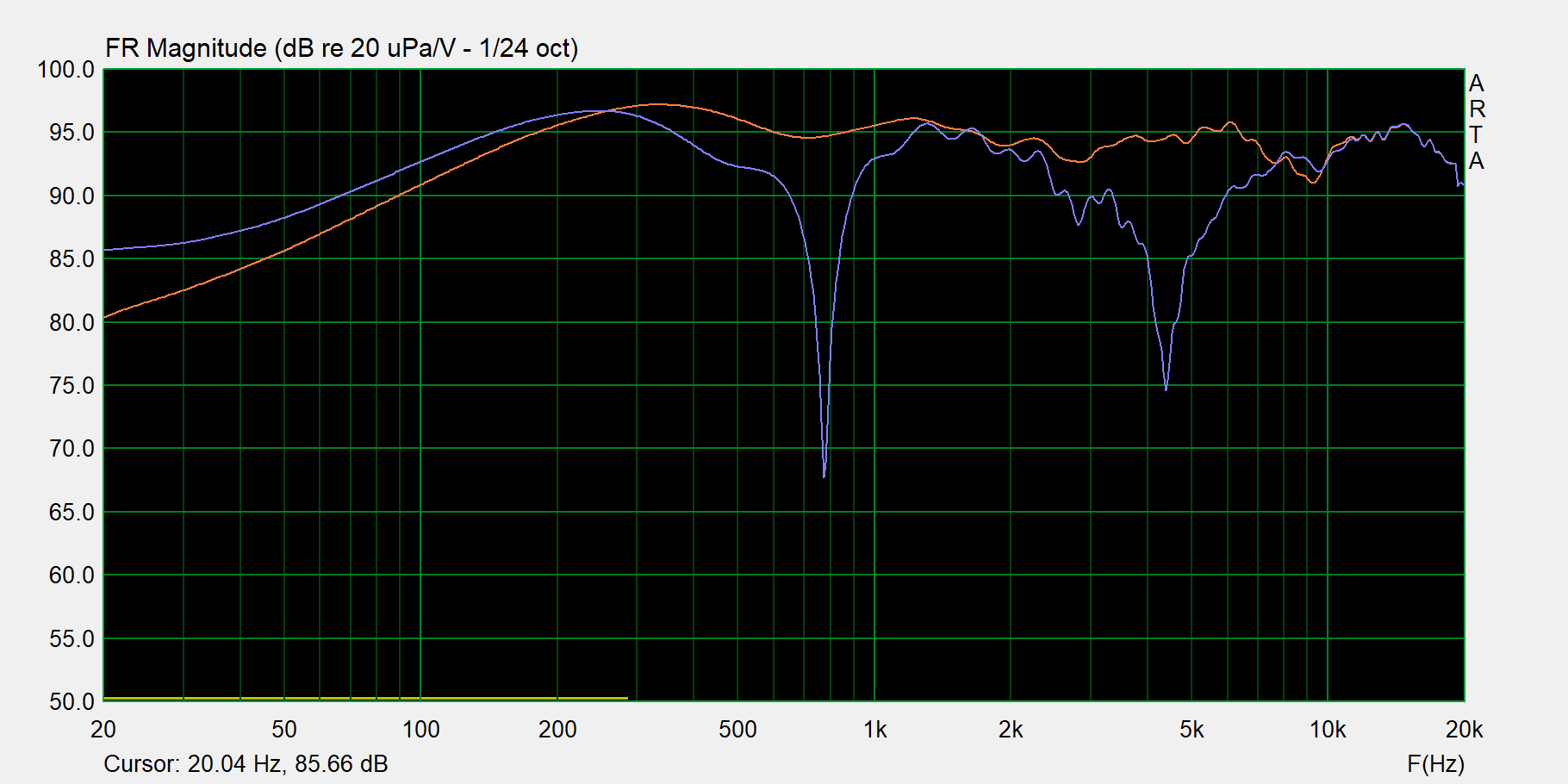

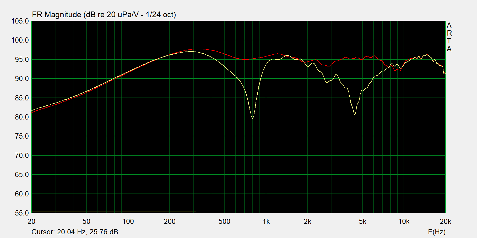

On axis and reverse nulls.

DM 7600 distortion is very good!
Yes, and the Melo-David tweeter is not measureable in my room! Very clean design.
Was the nosedive real to 70dB at 20k as shown earlier, or do you mean your noise floor isn’t low enough?
My noise floor isn’t low enough.
The phase issue at 8-9k bother you? Is something from the mid still poking through?
I’m not too worried about that little bit.
