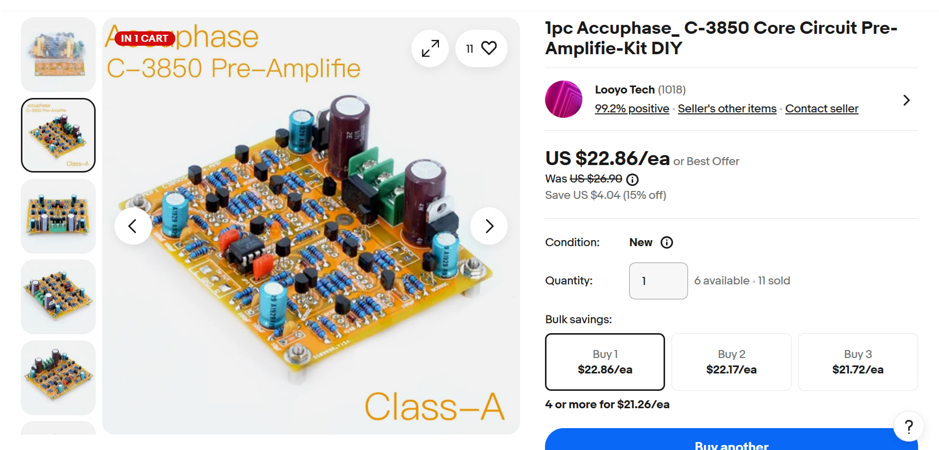

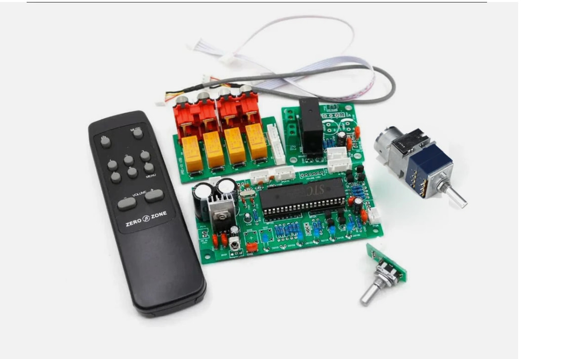

I was originally looking for a tube preamp to build, and I found a few designs that I liked, but they were going to be fairly expensive. I still want to build one, but I came across this Accuphase C-3850 clone kit, and it looked like it has really good performance. From what I could find, it performs the best with a 10K alps pot. I wanted a remote control, but most of them come with a 50k or 100k pot. I reached out to one of the vendors in China, and they put a kit together for me with the 10k pot. We will see how long it takes to get, but I thought that was pretty cool that they would customize a kit for me. I put some pics below of what I ordered. I am planning on building the case from scratch using some nice hardwood and sheet aluminum.
I am interested this one too. Do you mind sharing the vendor details and how you went about putting this together?
Edit: Are you getting the prebuilt populated board or the kit parts?
I have followed the videos from Michael Beeny on Youtube to get some of the inputs to the preamp board like the 10k pot and also there is a 100pF cap that should be replaced with a 47pF on the output. I bought the preamp in unassembled kit form from Looyo Tech on Ebay. I had researched the volume control on my own. I may need to modify it a bit to work. The vendor for the remote is GZLOZONE Online Store. I have not received any of the components yet.

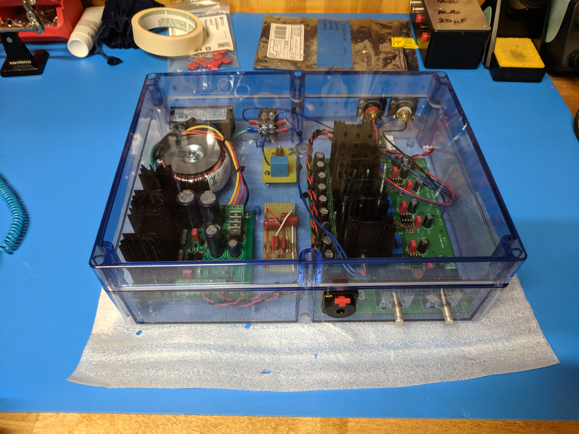

I think you’ll like that kit. It’s a pretty decent board for so little money. I built a similar one after seeing Micheal Beeny’s videos. I added a motorized pot from an old Sony receiver, an IR receiver & Arduino Nano clone to control it. Once I figured out the grounding issue with the regulated power supply boards I used, it measures and sounds great!

Sounds good, clear and I was worried my toroid may need shielding being close to board but no issues.

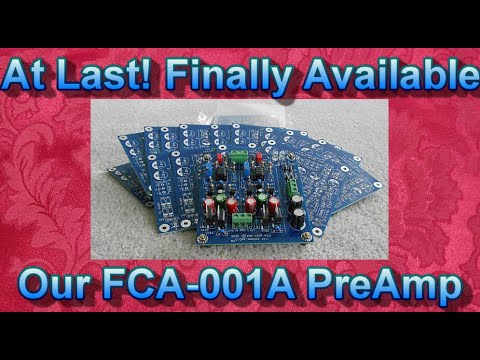

I saw Michael Beeny just posted a video and the boards for the one he had been working with Ron are now available. Fewer parts, but really low output impedance - under 20 ohms. They say it’ll drive higher impedance headphones. I ordered a pair, so we’ll see how they measure compared to the 3850 clone.
Hi @Tom_S can you please start a new thread once you get the board and stoart working on it? The boards seem to be out of stock now - all 120 boards sold out, but still interested in this build.
Sure - no problem.

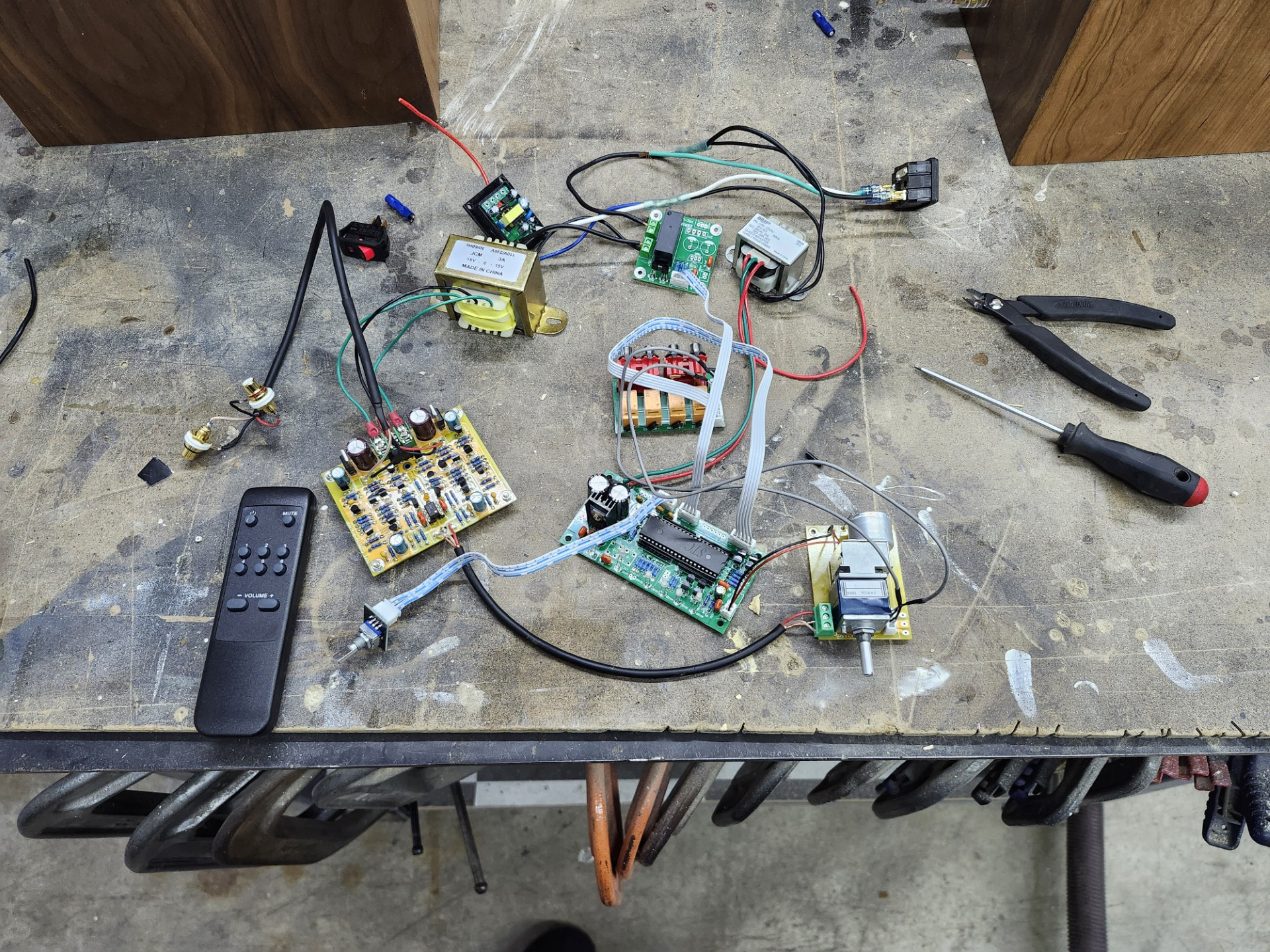

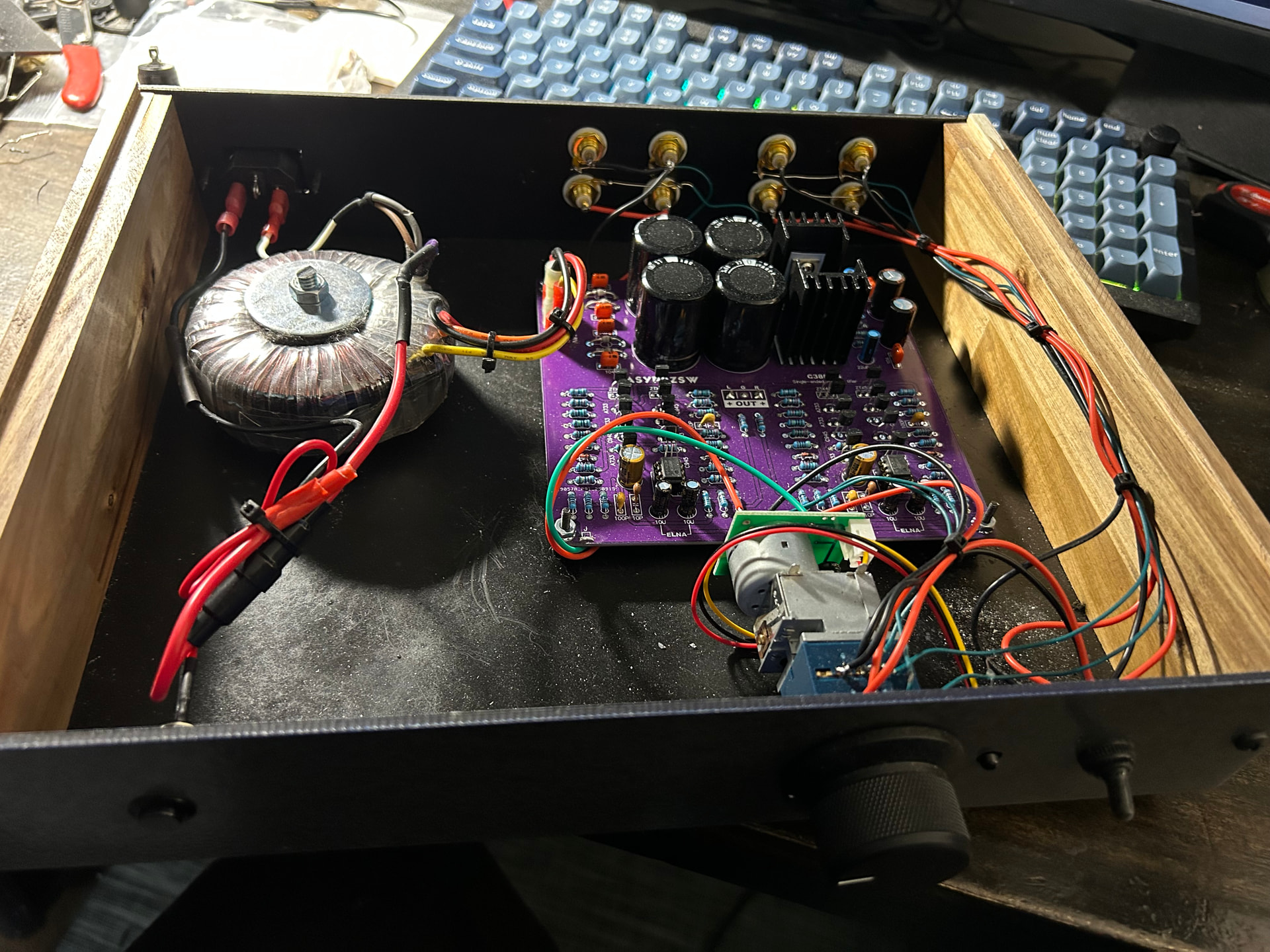

I finally got all of my parts in to test the preamp. Once I know it works, I will start working on the case. I now have the remote kit, which has power, input switching, and volume control. I added a circuit for remote trigger to turn on other devices, and will also have a separate set of pre-outs for a subwoofer.
How are you planning to do the sub outs?
At this point, just another pair of outputs. I have dsp for filters.
Y split from output or input - are you putting any electronics on the split? Would it do anything to the impedance
I don’t think you need anything other than just a set of paralleled outputs. The output resistor is only 22ohms. I have seen some preamps run a second output resistor to the second set of outputs, but I don’t think you need to do that with this preamp.
