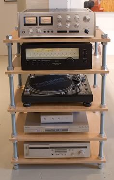

I’ve seen some interesting builds that used large all thread for the uprights. Nuts and washers sandwich the shelf pieces to lock it in place. Which obviously makes it easily adjustable, add or subtract shelves as needed. Sort of an industrial/contemporary style IMO.
Here is one example I found.

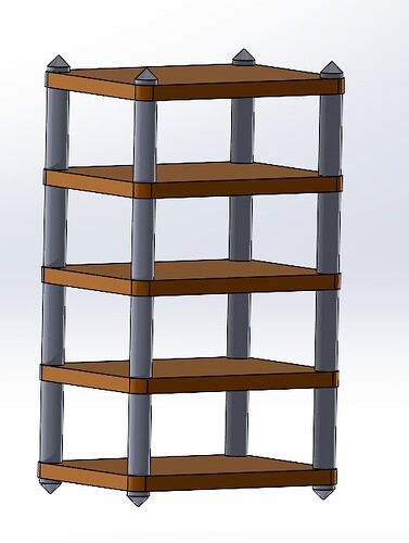

I was thinking about this design. Use 3/8” all thread inside 2” conduit. I would paint the conduit, and use 1.5” birch butcher block as the shelves. The top caps and feet may change a bit.
I like PVC conduit.
Yeah I guess PVC conduit does come in a nice grey.
You 3d printer guys could probably come up with a spacer to keep the threaded rod centered in the pipe.
Ah yeah that’d be straightforward to make a bushing of sorts for that.

Back in the day (mid 2000’s) built one of those threaded rod racks, did it’s job but yeah didnt like the exposed threaded rods where have to gingerly place the ongoing component/amp shuffle back then as to not scratch gear on them.

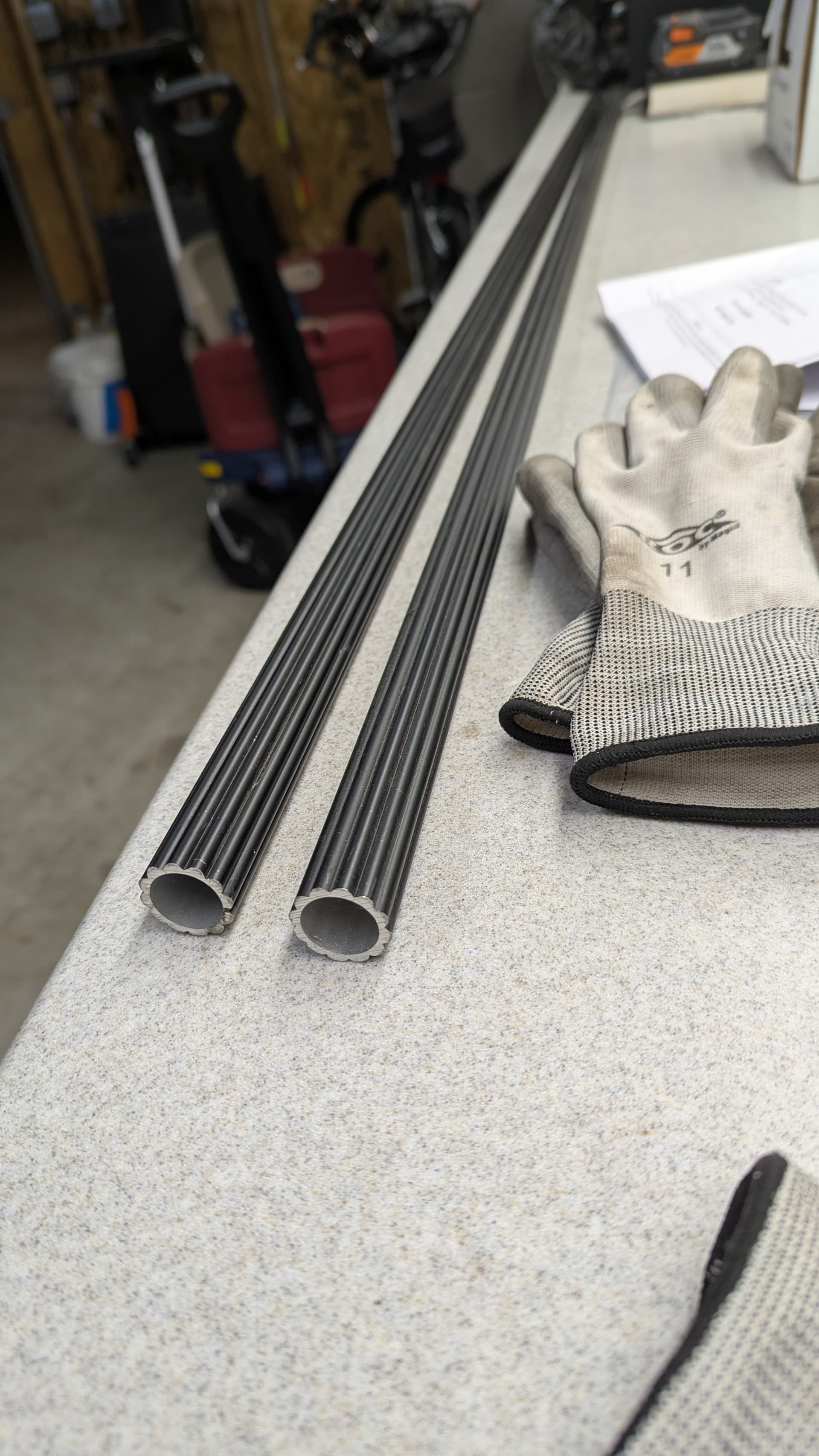

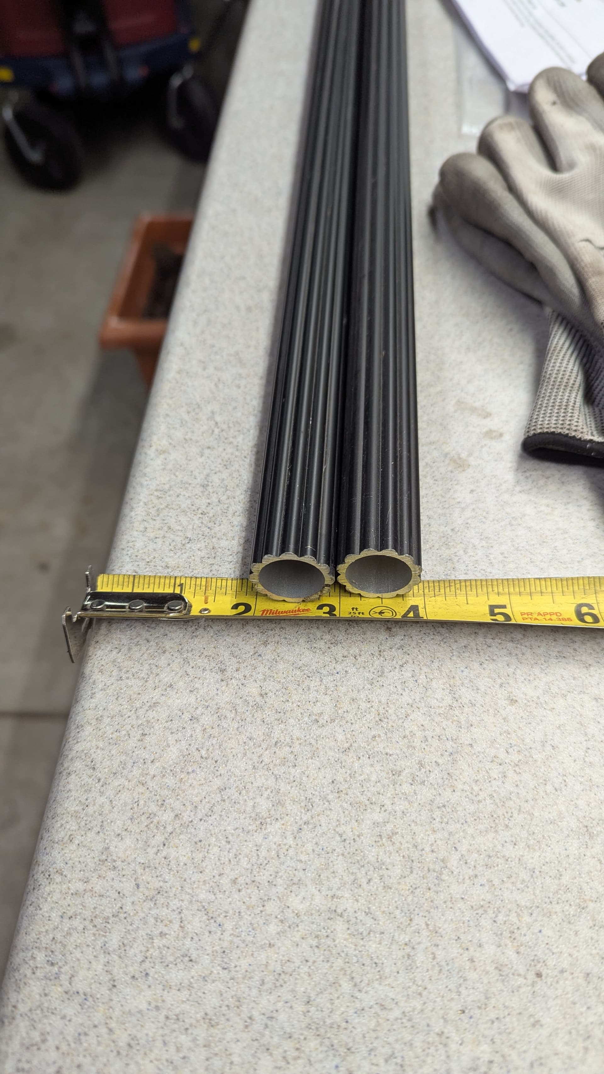

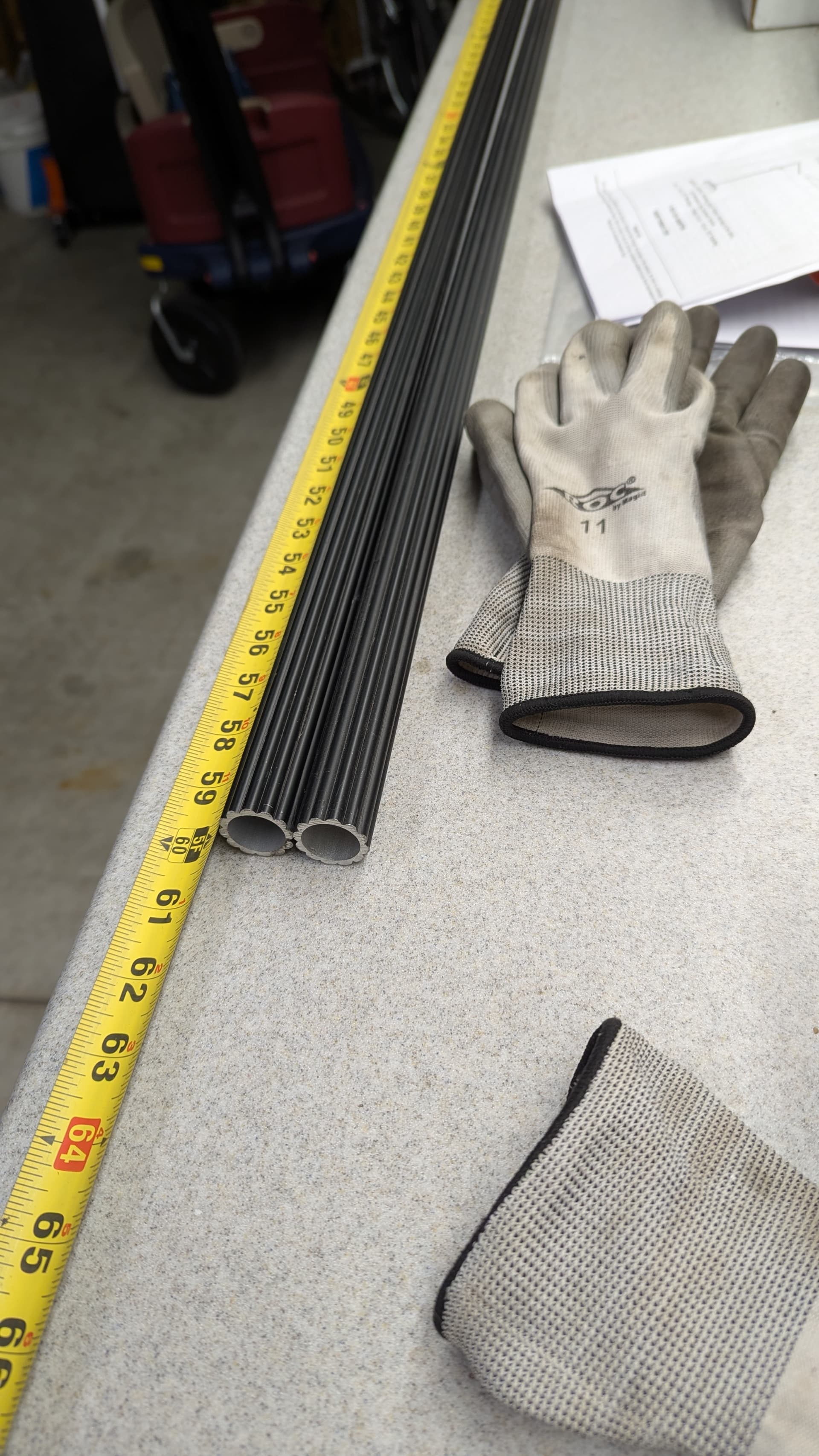

Ani, I’ve had these in my garage for near 10 years waiting for use in some project. I thought they might work nicely as a sleeve over threaded rod. However, I’m not sure they would look hefty enough for your project at only 1” diameter.
They are made of extruded aluminum, and I only have two 60” tubes available. Let me know if you are interested.

Hey Marvin, thos tubes look good - may not look beefy, but they aren’t load bearing. I need to get this rack done in short order, so may not be possilbe to utilise them now. I’ll look you up when we meet next - but they may not fit in the car when the family’s there :frowning:

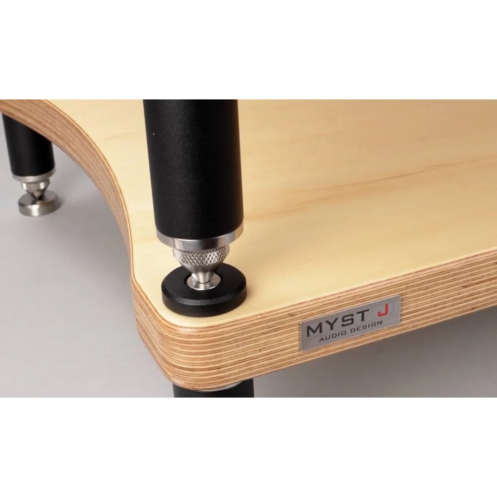

was trying to see if this kind of hardware is readily avaialbe - guess not. Look neat - the closed to replicating these would be the “Flexi” with conduit, or 3-D printed slip covers.
