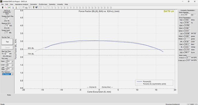

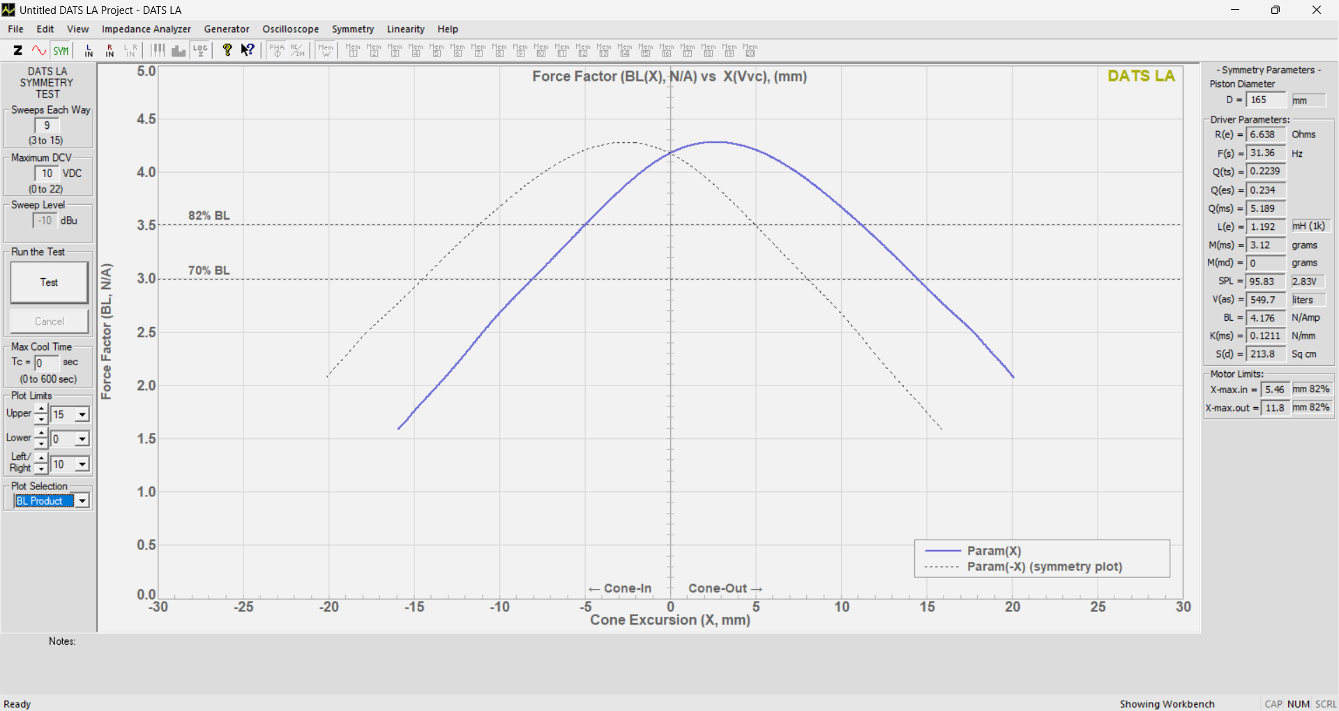

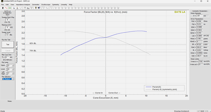

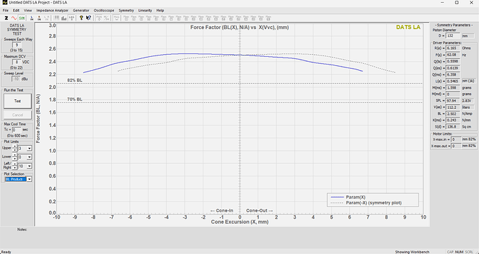

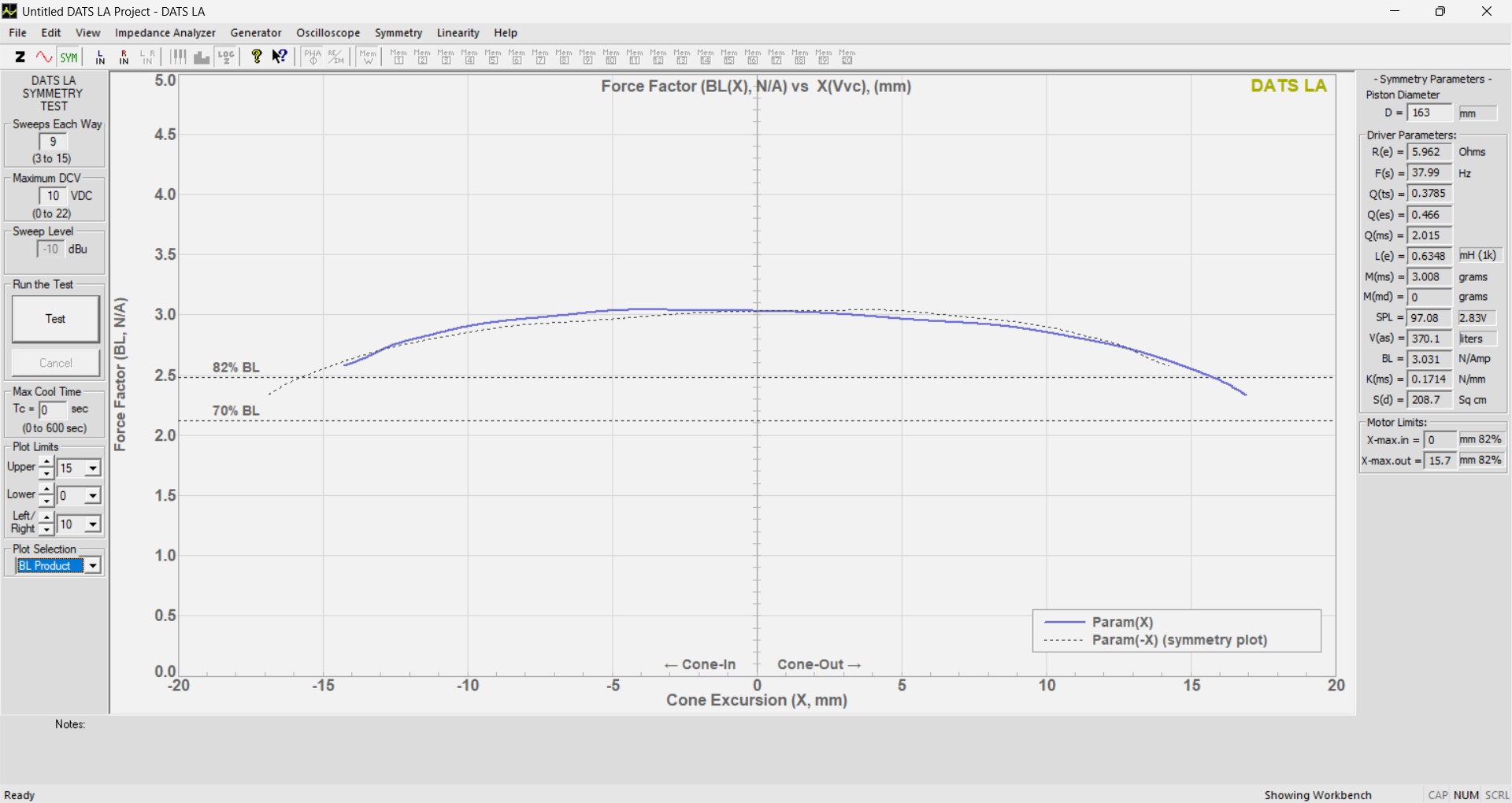

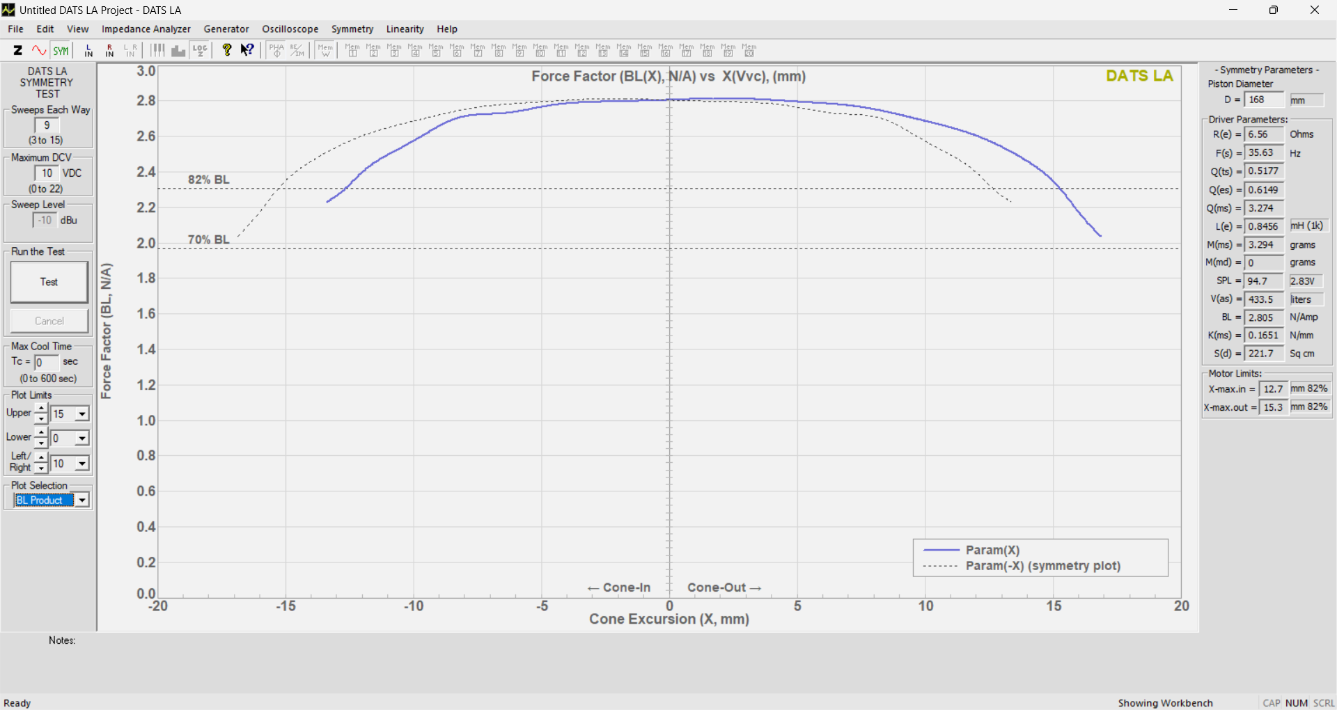

Infinity 8β CMMD woofer, OEM in Interludes.
I believe that is all the 8β woofers I have here. Read into this what you will, I will make no commentary.
Assuming the software auto-adjusts the scaling?
Feel like Iβm trying to understand voicecoil reviews with the symmetry and force factor heh. If only I knew what to observe or relate to what hear/experience.
Yes. That is correct.
That is super cool, I had no idea the new dats could do that. Does it use a physical acceleration measurement device or done electronically? Through the vc measurements?
Please keep measuring and posting. Very interesting to see, especially if a cheaper driver does very well or if a fancy driver falls short of expectation.

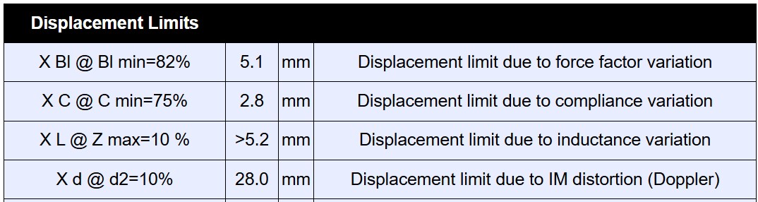

Interesting results. I remember that the Klippel system measures Xmax four different ways and takes the minimum value of the four as the true Xmax. Here are the four numbers (from ErinsAudioCorner, LINK) for the SB Acoustics SB17CAC35-4:

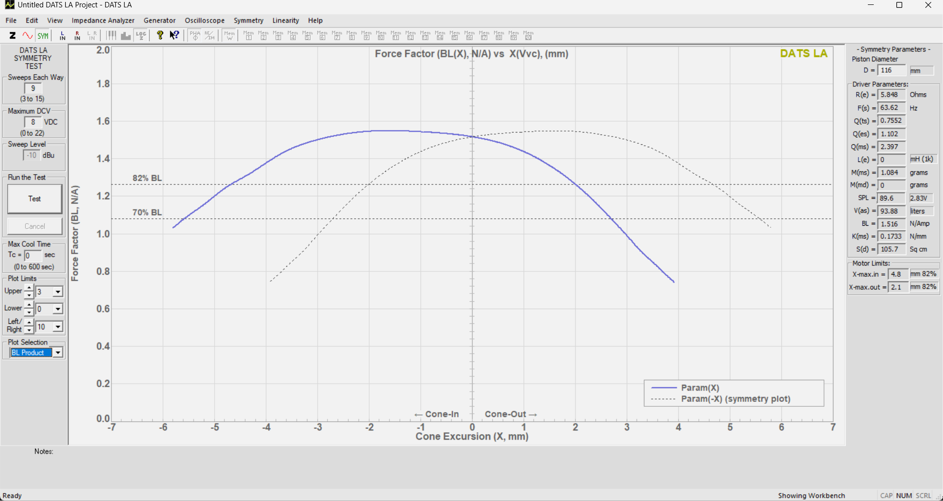

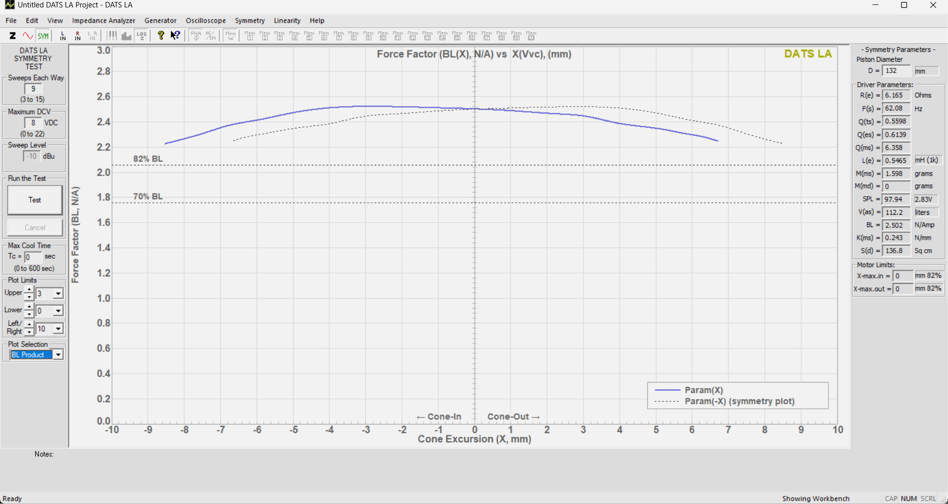

MCM 55-5660 6β. Brad tested this on his big board and it performed well there.
Thatβs all I have for 6-7β drivers.
