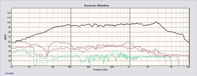

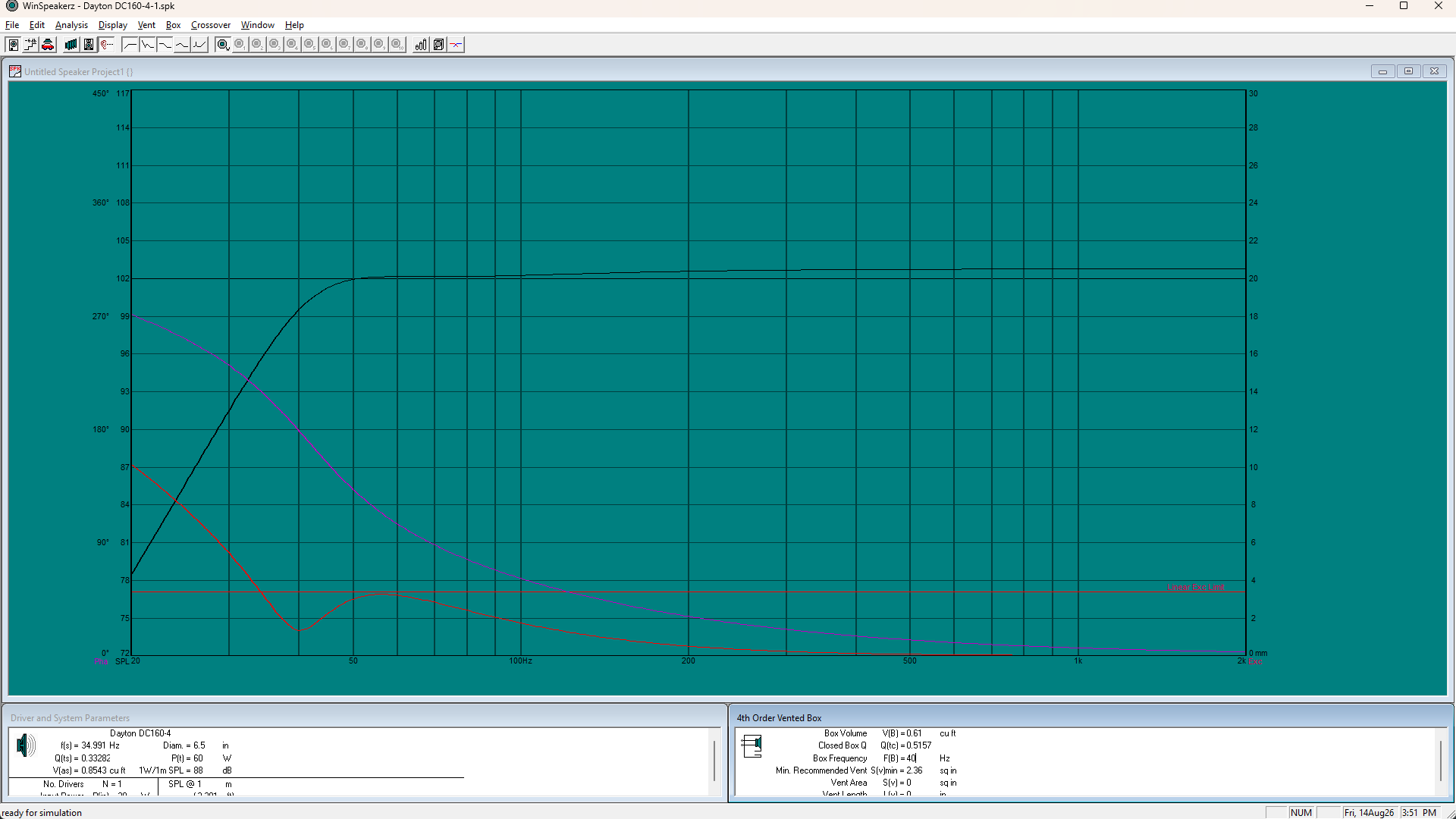

A friend of mine heard the Dactives and wants to build a pair. The Peerless woofer I used is no longer available and I’m looking for a replacement. I have a pair of DC160-4’s on the shelf and they model well in a .6 cu. ft. box. Looking around the net the only complaint I’ve seen about the DC160-4 is that the midrange distortion is high and that you should cross it low. Does anyone have distortion measurements?

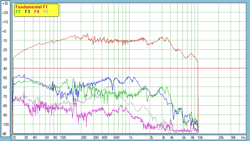

I did some more digging. I knew Zaph Audio had tested the DC160 but couldn’t see a way to see his measurements. His comments were not kind. I figured out how to get to the distortion measurements and while they may not be the best squiggles I didn’t think at 40db down they were awful.
I’m not opposed to using different driver with lower distortion but would like to keep the box small and still get down to 40Hz.

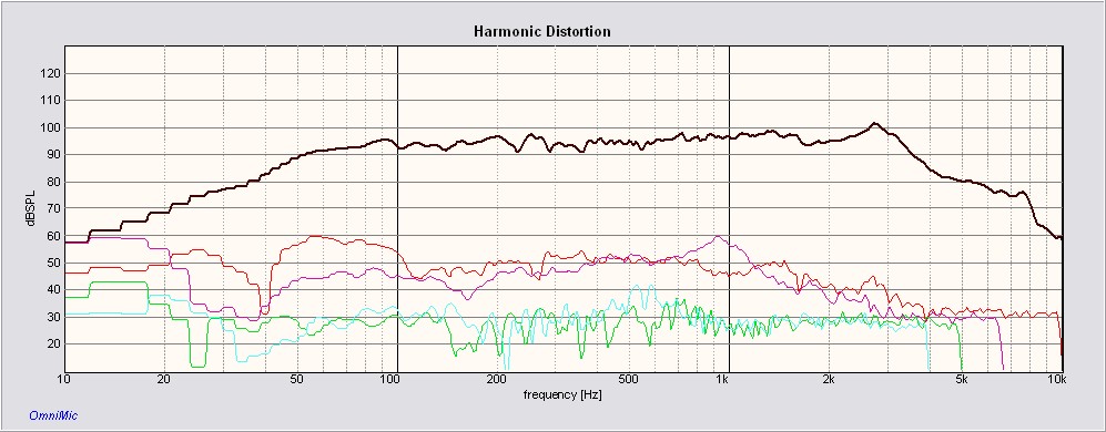

Here are my measurements of two (2) DC160-4 in-box. These were some of my first speakers and a learning experience from way back when, but I suppose valid nonetheless.
Cheers,
