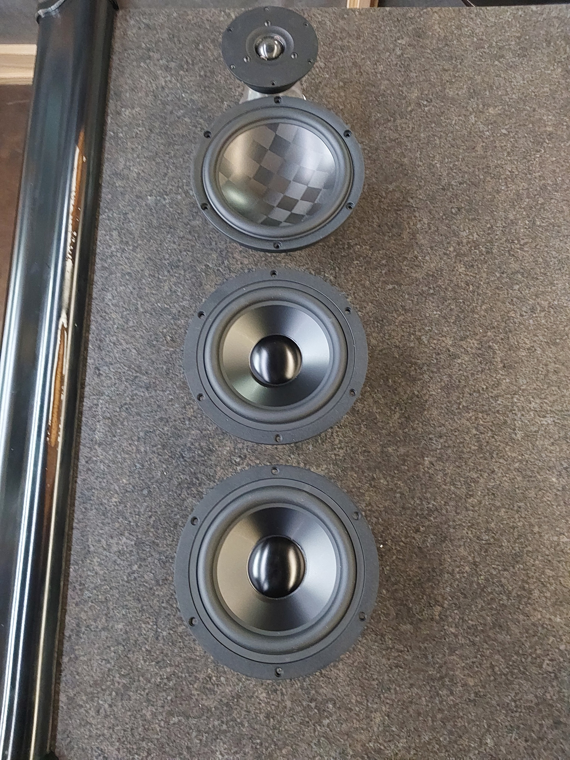

Could be a “serious” combo, but it doesn’t have to be. Could be a somewhat tongue-in-cheek combo. Might be fun to flesh out potential merits of such designs (in spite of detrements). I figure alot of us have a driver pile to draw from, mix n match and snap a pic. Maybe something could come of it?

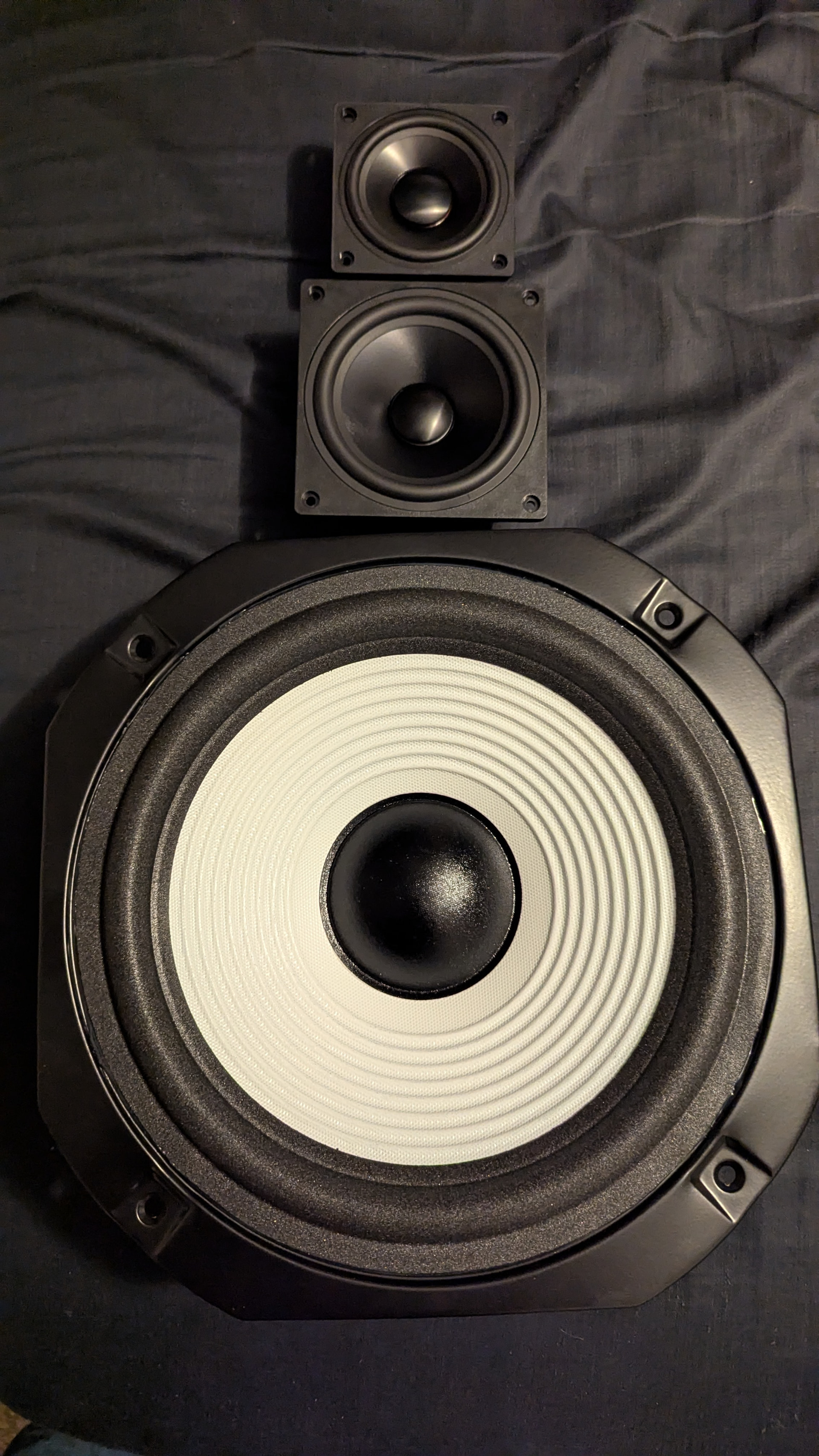

A combo I posted once in the chat. Had the DC25Ts for years. Picked up the PC105-4s as open box durring SDC garage sale. And JR talks of those GRS white cones every once in a while. (And they kept being on sale)
JBL vibes. Might get to em if I can clear out some space for projects.
I have had those white cone GRS woofers in my cart multiple times, but I have not pulled the trigger. I think they would be fun to build something around.

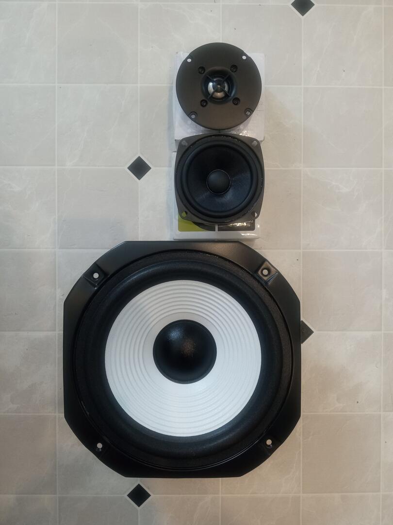

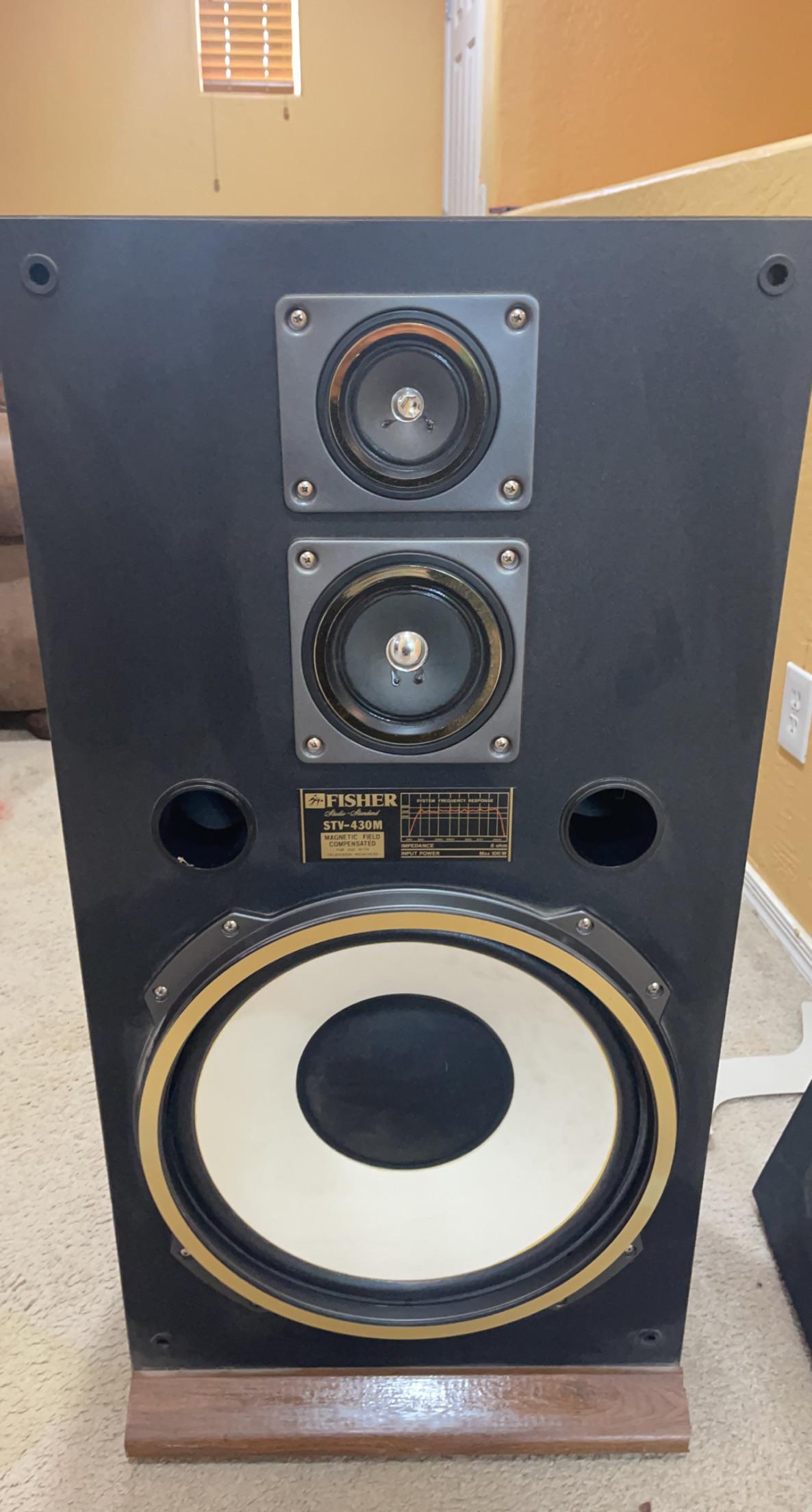

I’ll post a few pics when I get home tomorrow, but one of my future pet projects is an 80s throwback monkey coffin using the GRS 10” white woofer, and Dayton DMA 4” and 3” as the mid/tweet. Similar to the Fisher Studio Standard from that era:
Mine will be sealed and use a real crossover, of course.
I also have another budget 8” 2-way planned, this time using the GRS 8 ohm poly woofer and Tymphany BC25TG tweeter.
I expect great results from both designs.

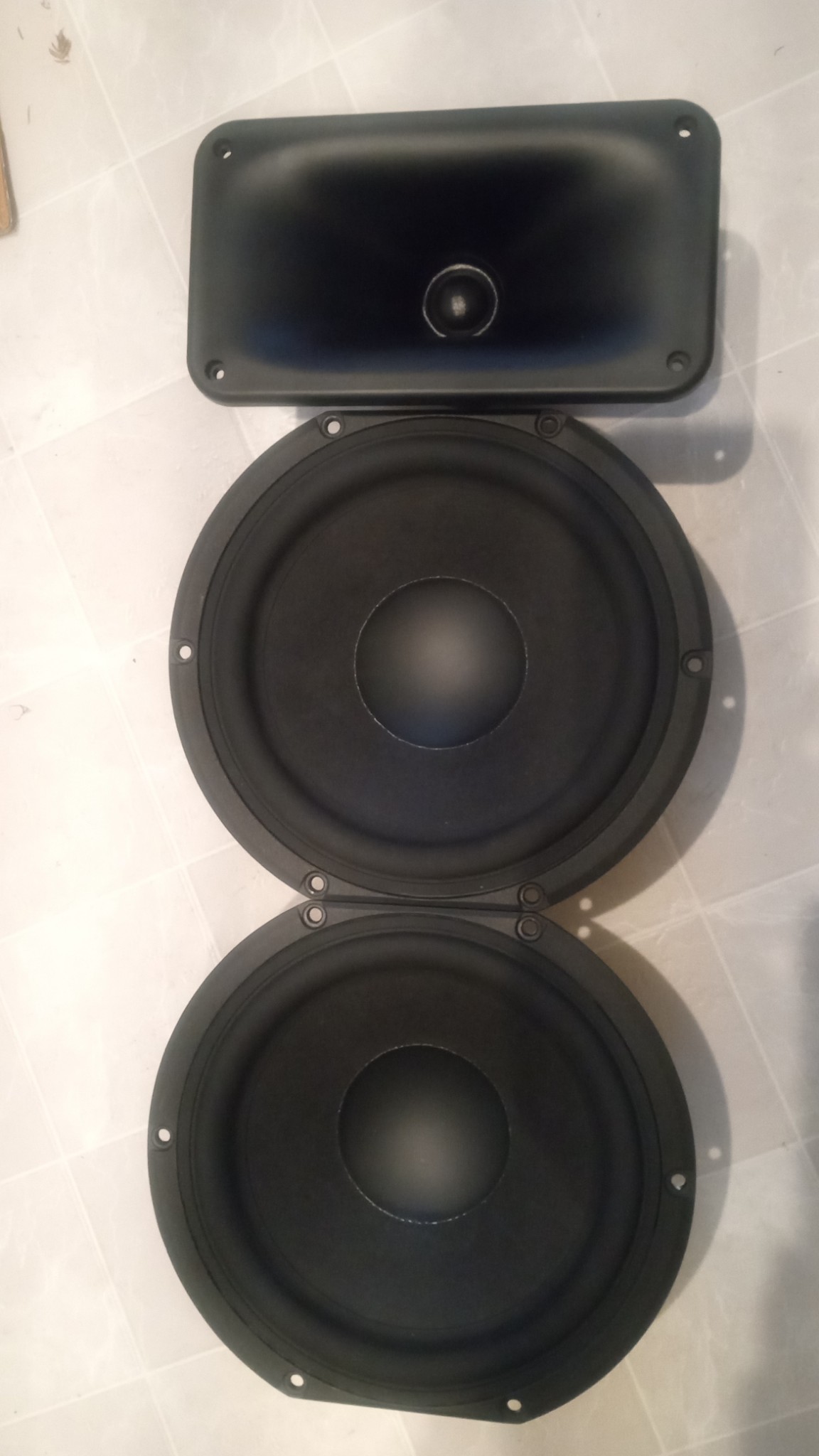

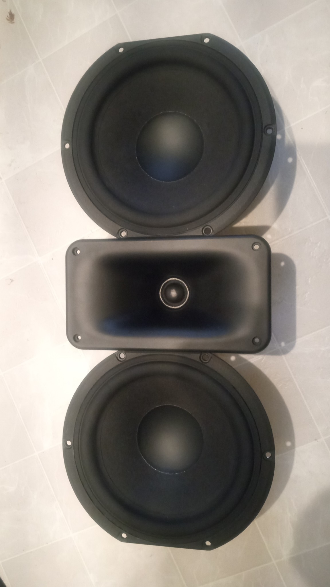

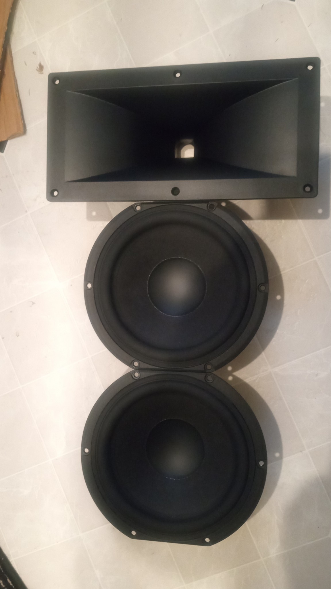

Been getting the itch to mess with horns again. This is an idea I still like. Thought it would be old school cool with the horn exposed up top and woofers set back so a grill board would be flush with the horn. 2-way like Klipsch KG4, but exposed horn like Realistic Mach One. 830869 woofers, CDs would probably be D220Ti.
Though these SEOS WGs open up other options.. They would probably end up much closer to KG4 styling. Unless the drivers go on the narrower side of the box.
Obligatory MTM shot for Craig :laughing:
Maybe a 2.5 way, keeping the mid-upper range tight to the horn ???

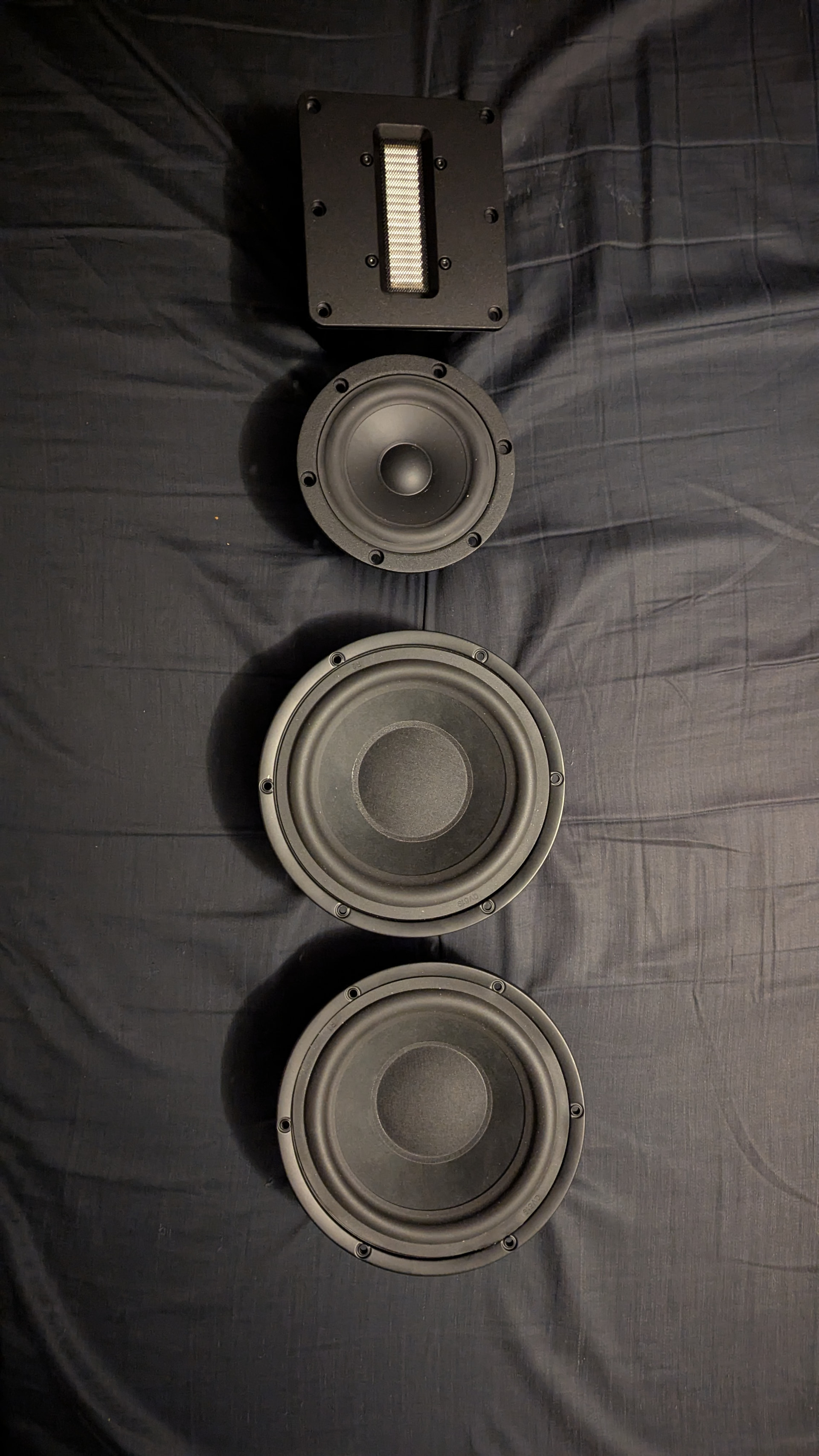

Atlas tweeter, SB Aerial mid, and Eclipse woofers. Taiga II, although I may go MTMWW on these as I do have four of the SB mids.
Taiga used 4 ohm Eclipse woofers wired in series, these are 8 ohm and will be wired in parallel. Taiga used the OG Viawave ribbon and a CSS VWR as a midrange.

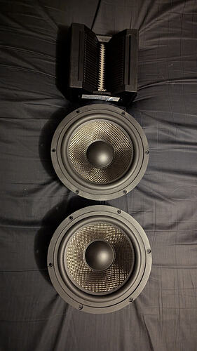

Great Heil and a pair of MCM/Multicomp Pro 8” CF woofers. Woofers are 92db, but pay for it in limited extension. Will play to 45Hz in a reasonably small enclosure however. Woofers are advertised as only 1.5mm Xmax, but I believe that to be under-rated due to the strength of the motor. Saturation helps. DATS LA, for what it is worth, pegged them at about 4mm. Should be good enough as they would be crossed at 60hz to a pair of subwoofers anyways. The Great Heil can cross very low.
So there are my three pet projects for 2026. I may do a random small speaker, but 26 is shaping up to be the year of the tower/monkey coffin.

Yeah nothing is off the table. The KG4 was a bit of a cult classic it seems. I think it crossed ~1.4khz. I just thought it would be cool to keep 2-way.. Might keep 1-2db sensitivity compared to 2.5way, but might lose out on some refinement?
