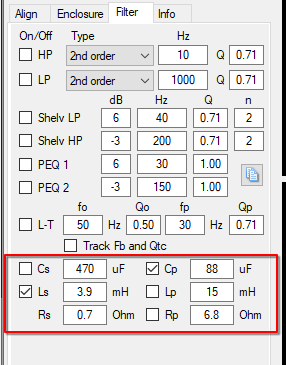

Has anyone else noticed this? The 3W Shawn and I are working has a total Driver Cost in 2025 prices of:
  • Hi-Vi F8: 75.00 ea: $150.00
  • SB12MNRX2-25-04: 62.50 ea: $125.00
  • Seas 27TDFC (H1149): 73.20 ea: $146.40
    Total of $421.40
Given the Low XO point (Shawn gave the F8 a haircut due to the really nice mid), the total component cost using Jantzen P-Cores for the woofer and Dayton Standard poly MKP caps was more than the driver cost.
Rant. Rant. Rant.
This is kind of a bump and a request - any lower price sources out there (or alternatives)?
The driver cost is fairly reasonable, but the XO cost, yikes.
Given XO cost for a 3W, it seems almost mandatory to go ahead and use boutique drivers, if you are going to be charged body parts for XO components.
