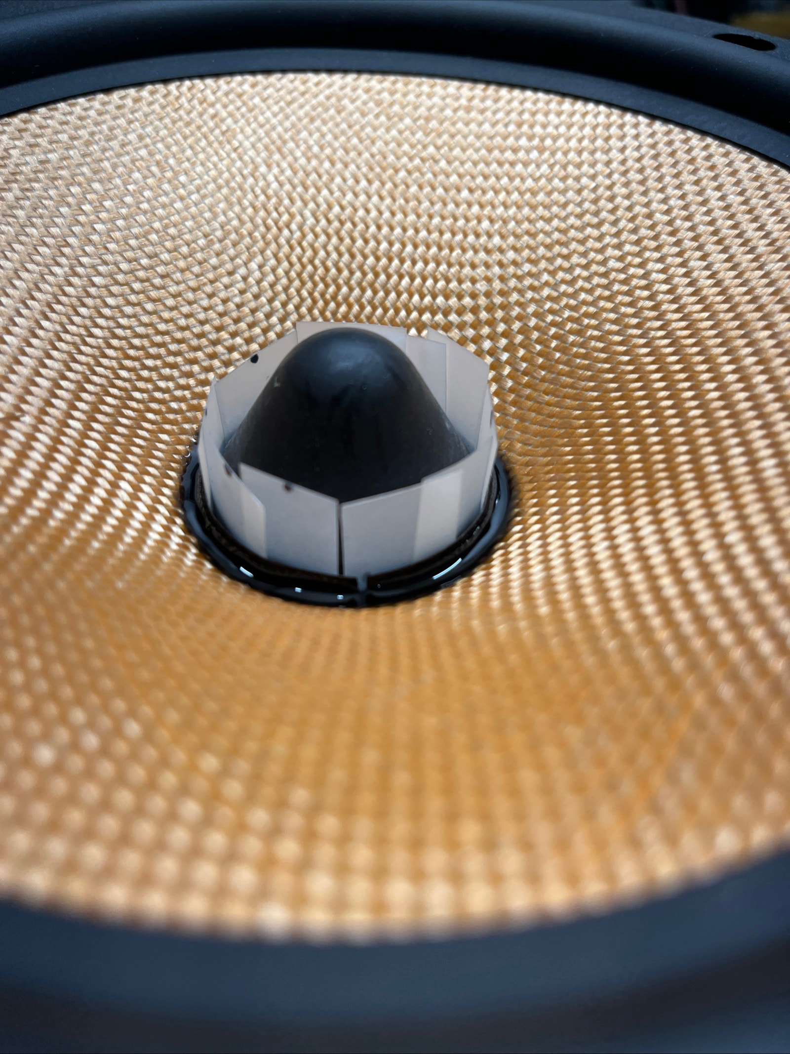

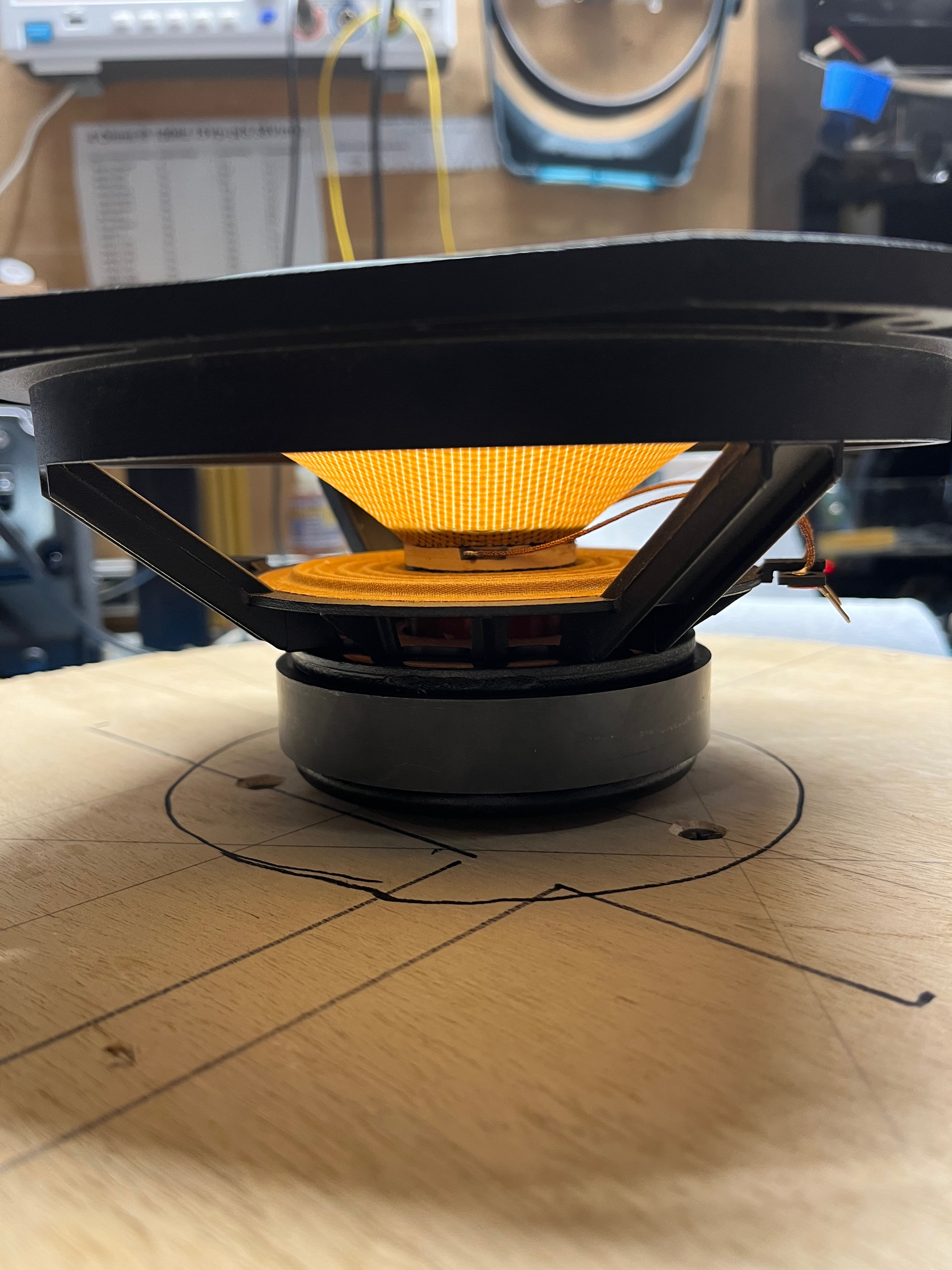

So here goes…The aerogel surrounds had hardened up and I couldn’t find a proper replacement as they’re kind of a weird size. So I saw an option on AliExpress of a surround/cone assembly, took a chance and ordered them.
After receiving them and guessing it’d be close enough, I started checking out the driver. The cone to voice coil joint actually separated fairly easy. The tinsel leads attach to the voice coil between the cone and spider, so careful work with a scalpel and the cone and surround was removed.

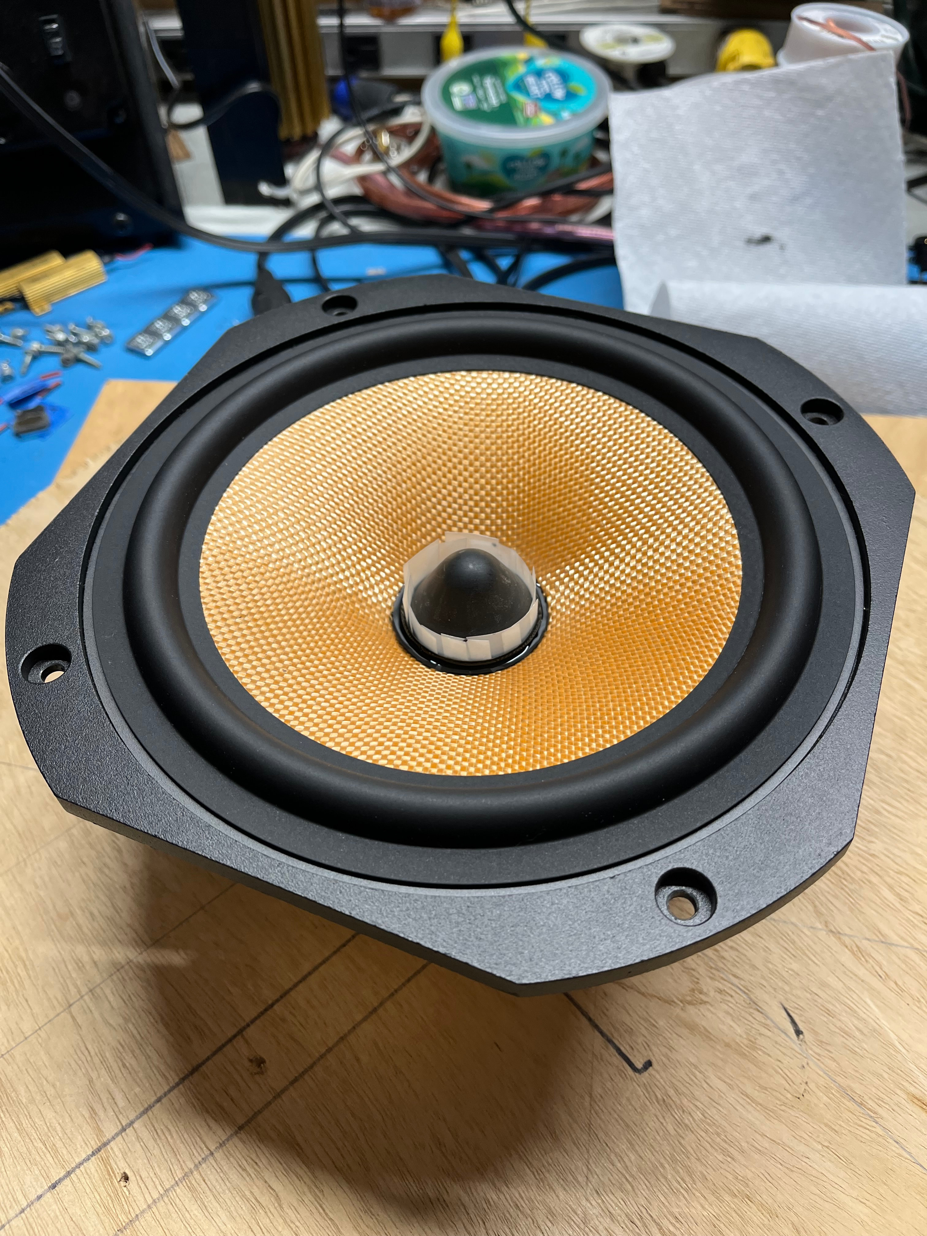

I shimmed the VC in place and started fitting the new assembly onto it. I used some fingernail scissors to trim the opening in the fiberglass cone to fit snug on the VC. Once that was satisfactory, I used black CA glue to adhere the joint.

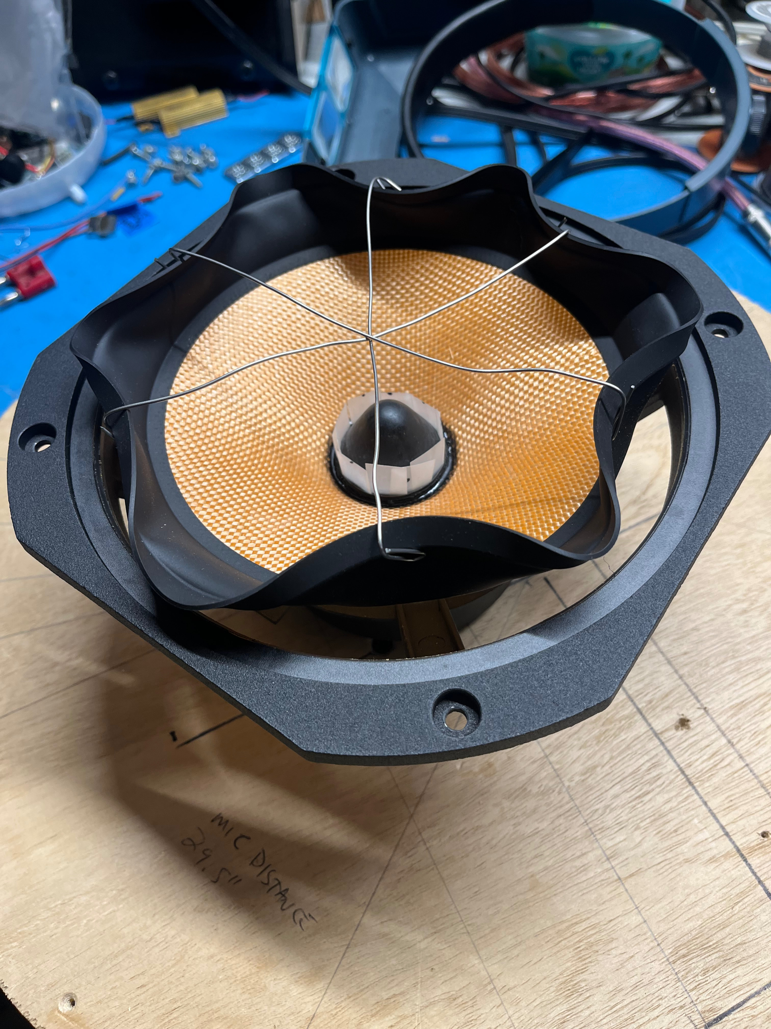

Next I used some SS wire to make the holders to keep the surround up away from the frame flange. Used the black CA again, ran a bead around it, then let the surround down.

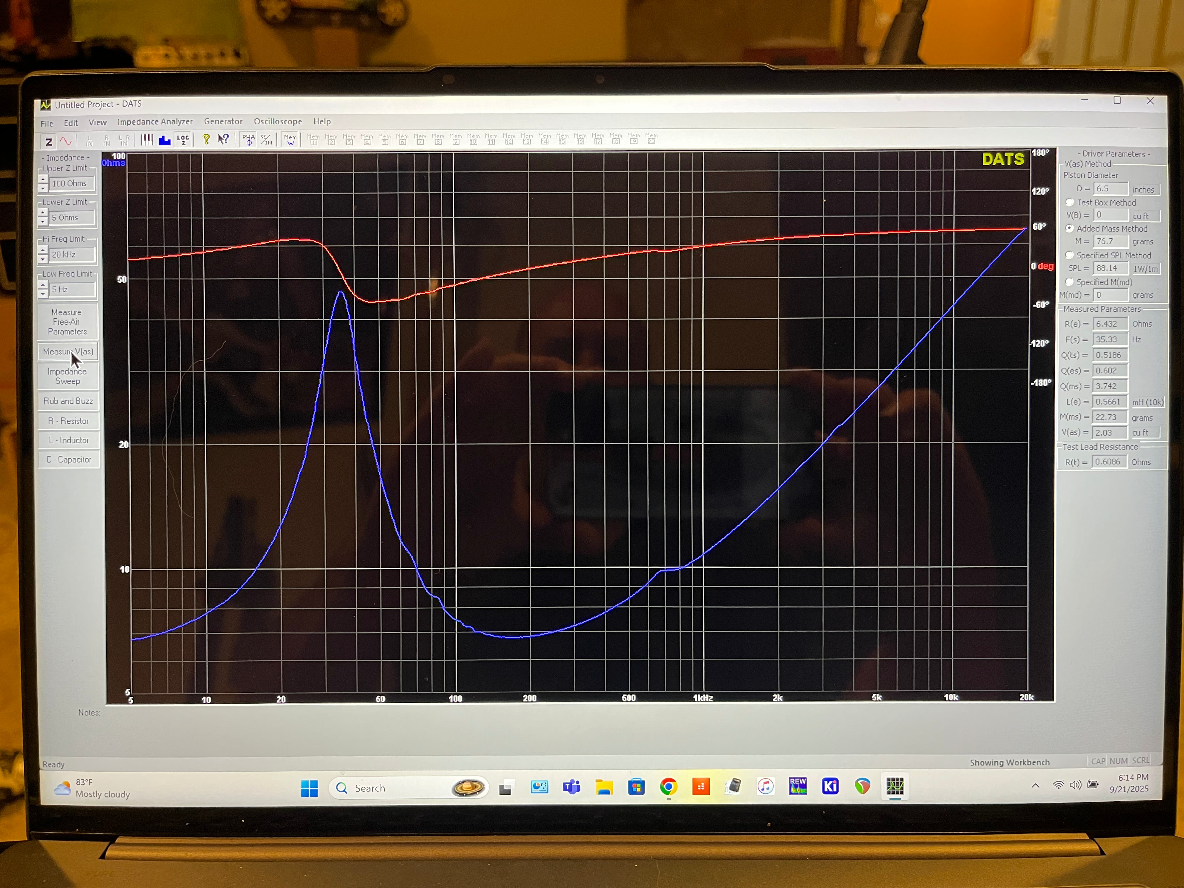

Ran DATS and OmniMic and decided to give them a go.

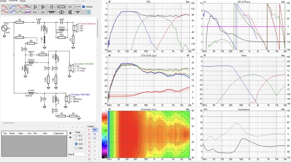

So today I experimented. I cranked up a bass heavy song, tweeters definitely moved to the bass. I then unhooked the tweeter, reinstalled, no movement. That pretty much points to the crossover. I opened VCAD and found if I short the damping resistor and add one to the negative terminal of the tweeter it’d pretty much be the same FR and actually got a better phase alignment to the mid.
I tore one apart, modified, reassembled, cranked it up and the tweeter seems to be quite still now. Ditto to the other speaker. Live and learn.
Updated crossover…
