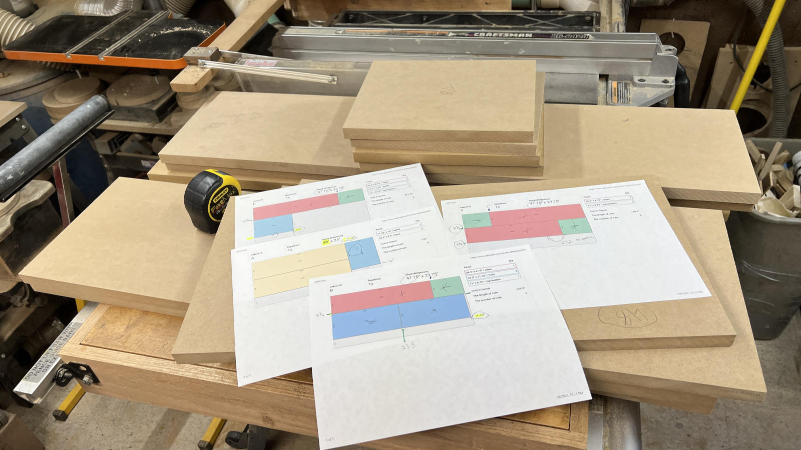

I got my replacement tweeters a while back and finally picked up some MDF from Menards today.
Looking for input from JR on my plan for the cabinet. I’m thinking 11” wide, 33” tall, and 9.5” deep. That gives me ~1.38 cubic feet. Add a few more window braces and I should be at the same volume as JR’s stand mount. I’ll make the back removable so I can stuff the bottom with Rockwool as needed to kill the standing wave. I’ll also build some kind of base with spikes for stability and that will add at least 2 inches to the total height. With my room I listen in what might be considered mid-field - about 6 feet away, so tweeter height may be more critical than those with larger spaces.
Does this sound like a reasonable plan?

I think the dimensions on my project ended up ~36" Tall x 10"Wide x 12.75"Deep. Used the Menards shelf boards, just narrowed the baffle to ~10" instead of the 11.25" width of the boards.

All panels are cut, but I may end up trying something different with the baffles. I haven’t made any errors cutting things yet, so I’m not sure if I want to push my luck.

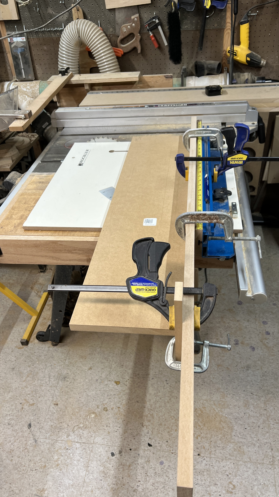

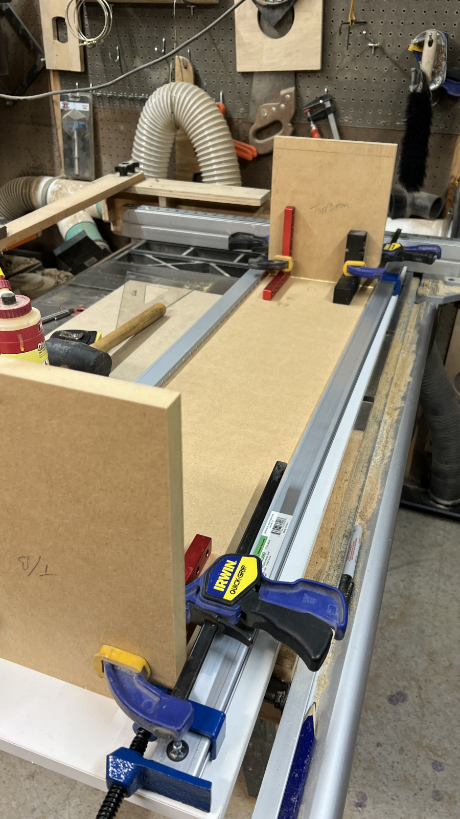

Slow going today, but I’m taking my time with this build. After hearing a larger box smooths out the low end bump with these woofers, I made these taller. I ended up at 38” which gives me ~ 1.6Cu Ft. I started laying out the sides and realized I hadn’t trimmed them to the finished length. I had to add an extension to my crosscut sled and that made things fairy foolproof - something I always appreciate.

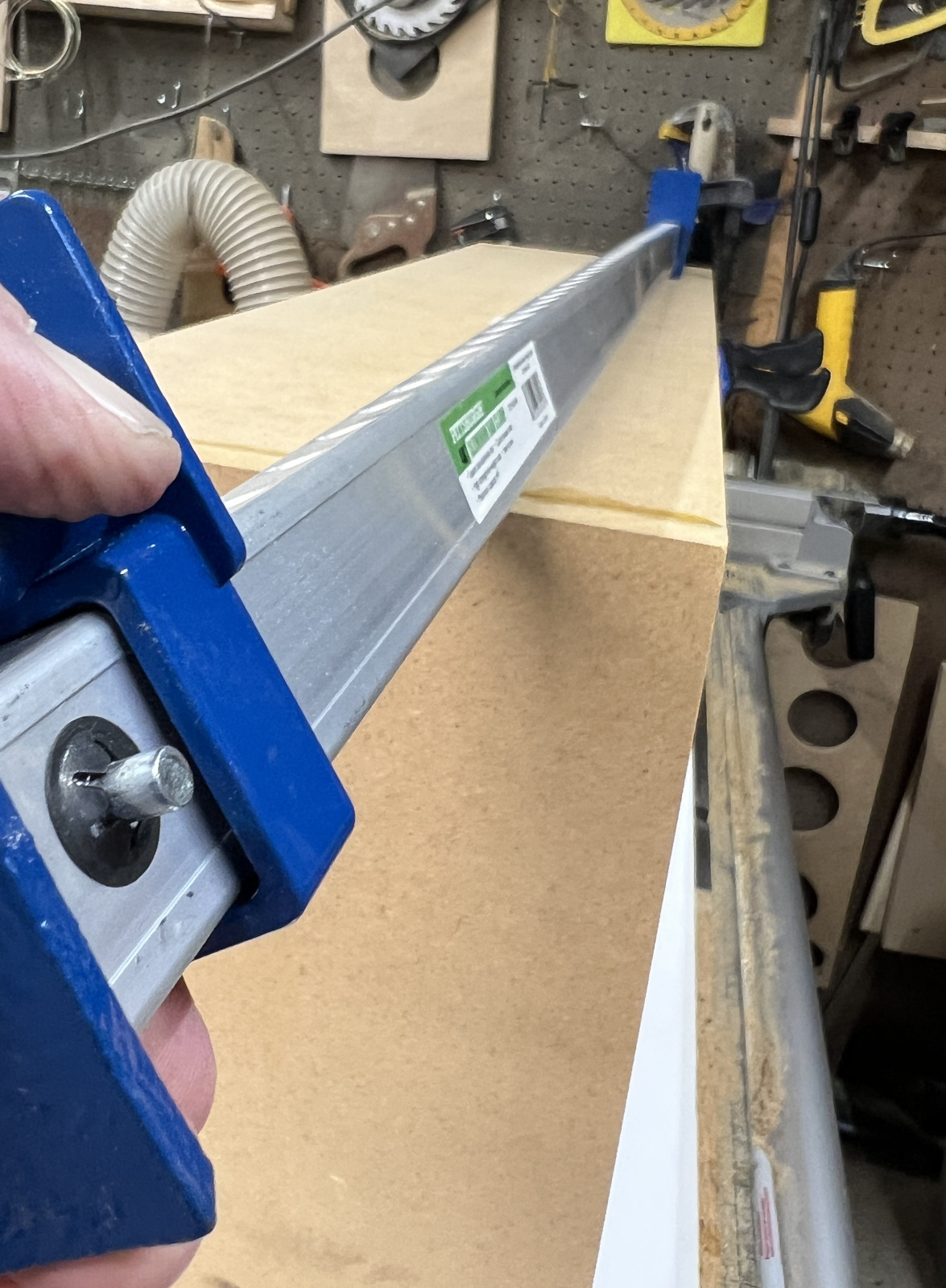

I decided to pick up some of the cheap 48” Harbor Freight bar clamps since I didn’t have any over 36”. I could have linked a few shorter ones together, but that increases my odds of something slipping while the glue dries and I know better than to press my luck. The reviews said these clamps are pretty sketchy. I agree! They flex and twist easily and I’m amazed they didn’t just break when I tightened them down. I bought 4 but may take the unopened pair back.
I have a pair of those crappy clamps!

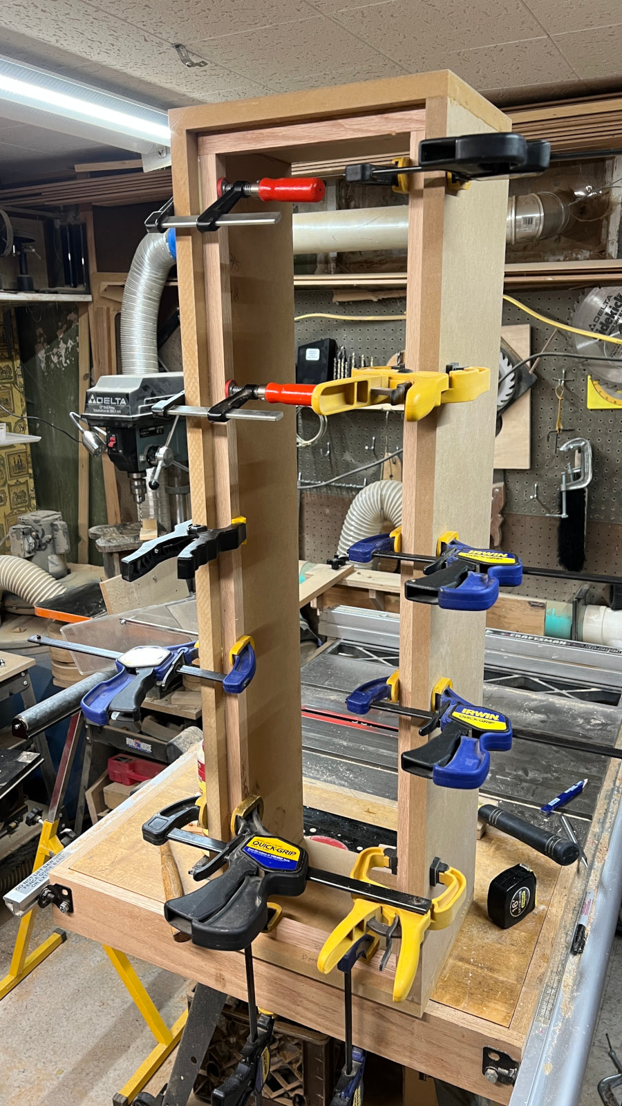

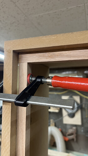

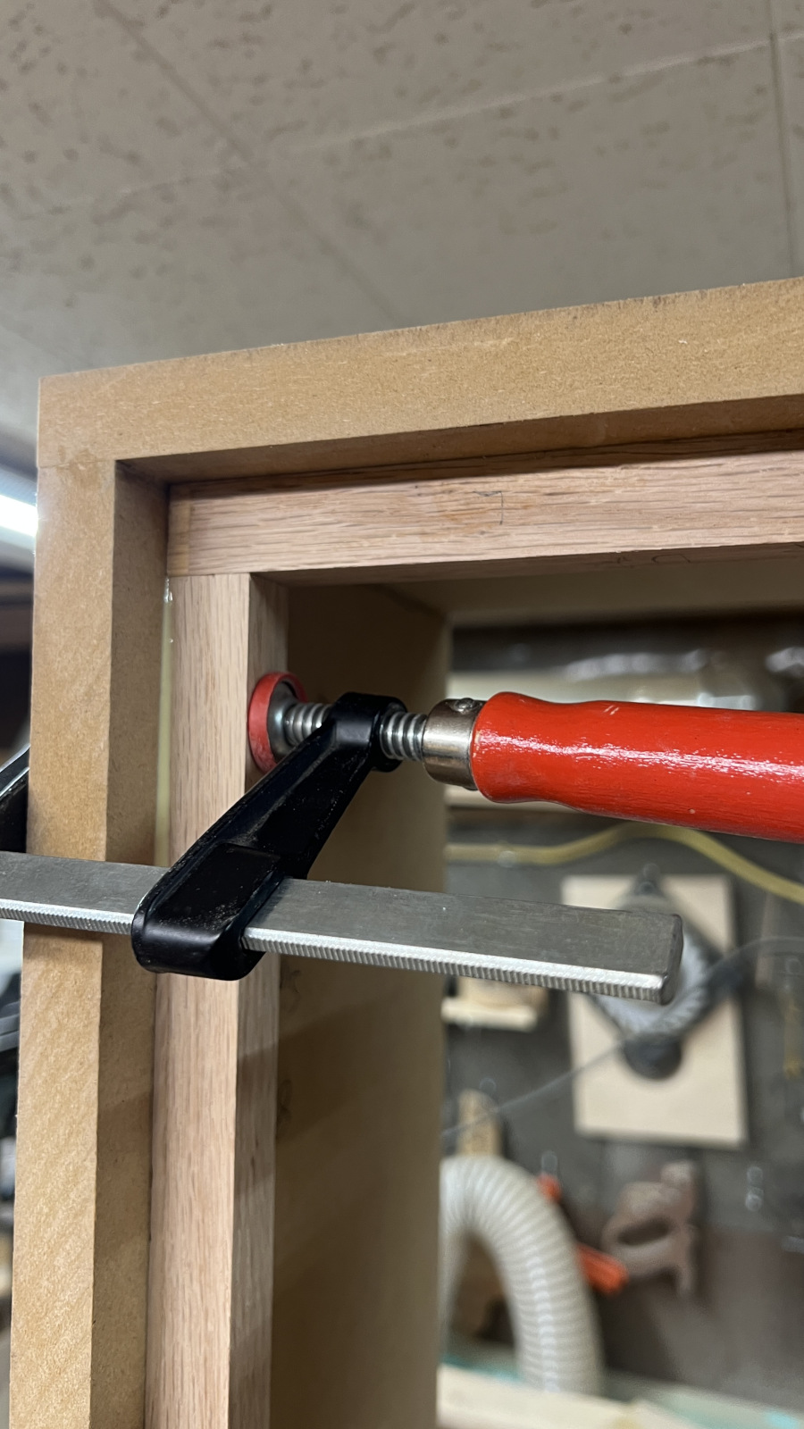

While I’m waiting on parts for the preamp project, I’m back in the shop working on the cabinets. I cut some oak strips from a stair tread I picked up at some point to make the frames the backs screw into. Nothing like waiting for glue to dry because you only have enough clamps for one cabinet at a time.
First world problems….
Nice. I have a total of 22 clamps and I keep running out of clamps too. Most of the time, I need to work on just one channel at a time. I think you need to get up to at least 50+ clamps to work on a stereo pair without slowdowns. :smiling_face_with_sunglasses:
