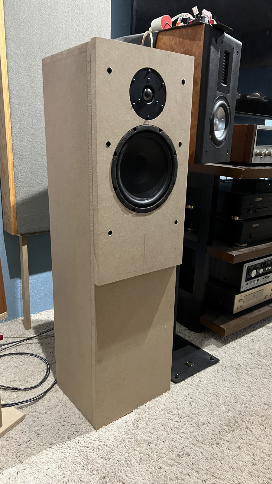

I noticed that you screwed your crossover boards to a couple hardwood pieces and then glued the entire assembly to the back panels. When the glue dries, you will then be able to remove the xover boards by simply removing the 4 screws. Clever idea. Also, clever idea to increase the tweeter mounting holes to 6 by using an old flange for line up. The thin plastic flange likes to bend up into a curvy shape with only 3 screws. It looks very flat in your pictures with the 6 screws in place. How does it look when you place a staight edge across the flange?
The tweeter isn’t perfectly flat, but probably better than using only 3 screws. That plastic faceplate is way too pliable. My recess is a touch too deep, so I need to get some thin foam weather stripping to make them flush.
Lol I saw that too and had to zoom in. I was like what’s that gizmo in his box??:rofl:
The three extra holes in the silkie faceplate really change its look to higher end; I like that alot.

I hadn’t even noticed that JR added the 3 holes. That might have been the conversation I overheard in Ankeny.
I did not add the three extra holes. I am way too lazy for that.
I added the holes as the face plate is pretty flimsy. I made a 3d printed jig to line up the holes.

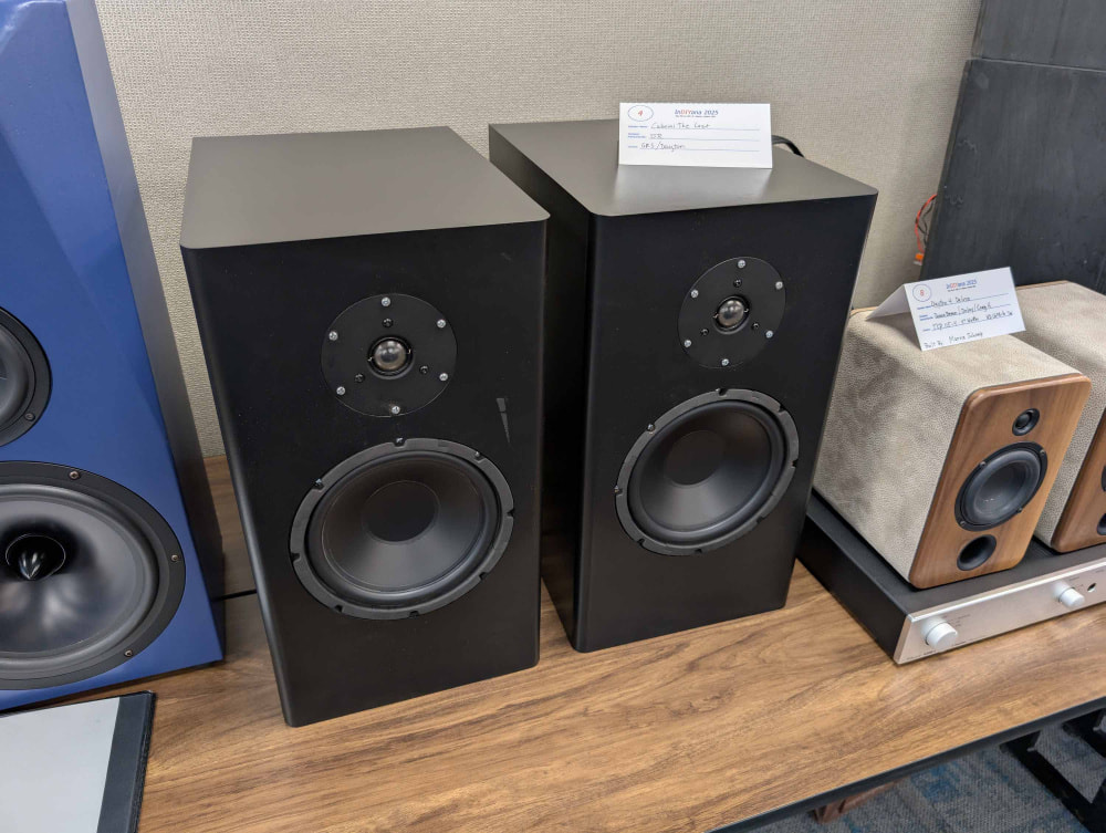

Thats actually my build of JR’s Cabrini. JR was presenting them last year at InDIYana.
