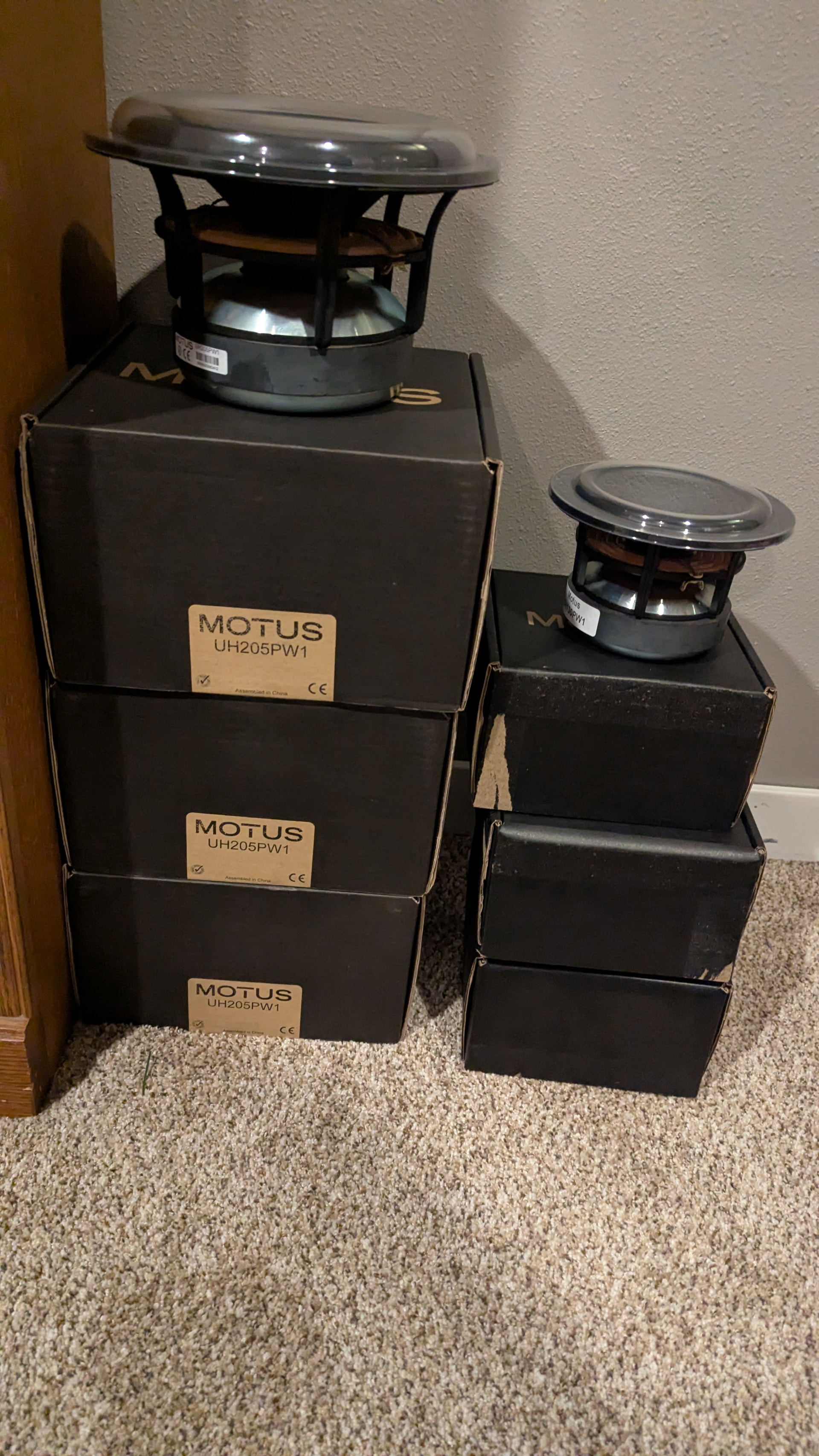

Can’t wait to get home and open these up!
I have to say, outstanding shipping service considering weather in Ohio recently. Erich is on top of things.
what’s in the tiny box? tweeters?
Pictures pictures pictures!!!
3” full range I added on a whim. Pretty nice for $27 IMHO.

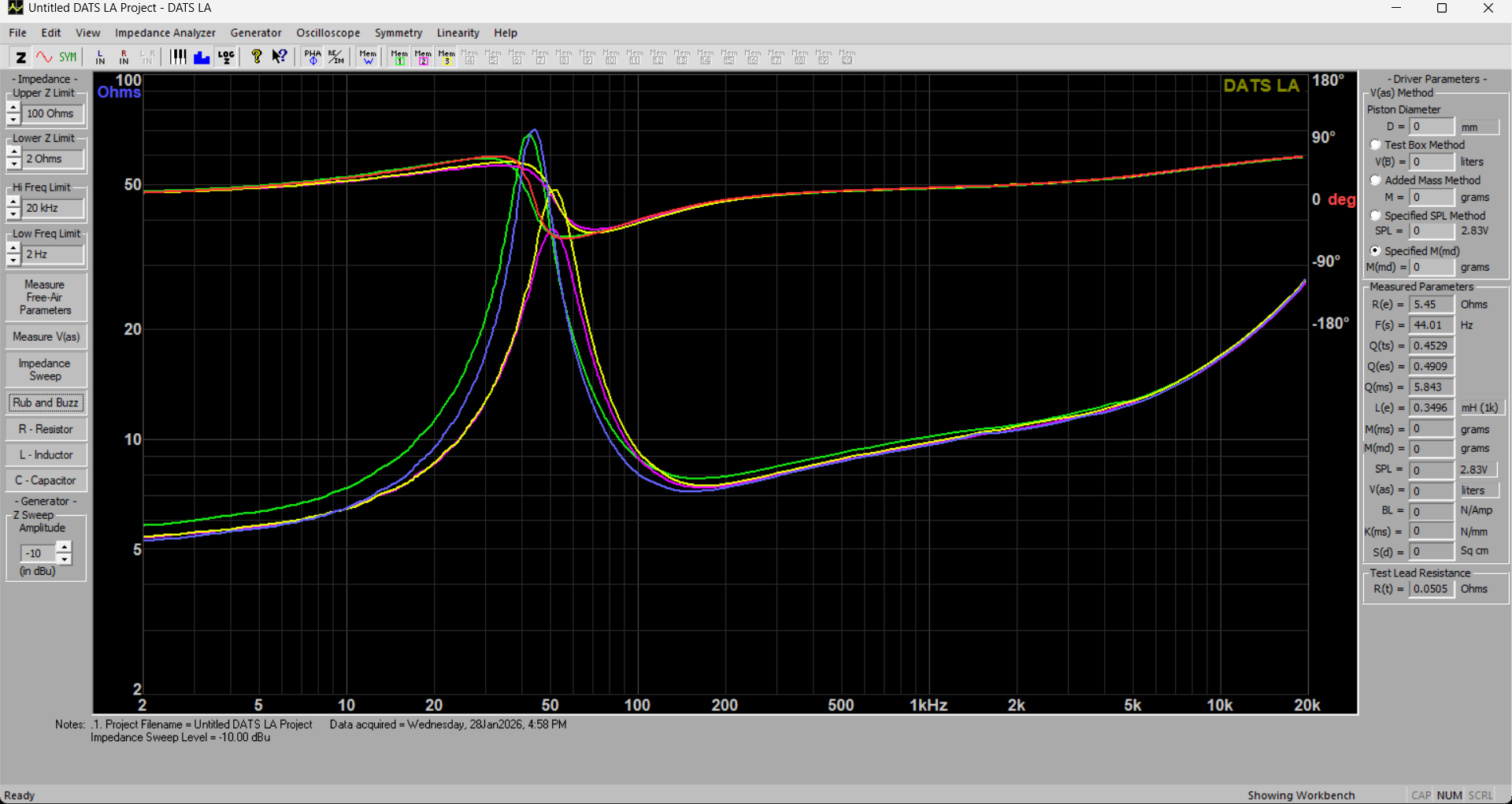

This is all four of the 5”. I did not measure Vas. Little disappointed in consistency, to be honest. I am running them as dedicated mids so no worries on the bottom end, but for all intents and purposes I have two matched pair that are a little different from each other. Pretty much within 10% which I have been told is all I can expect.
Actually not bad over their expected range.
You may just need to slightly tweak left and right crossover components, but I’m thinking not when establishing your two pairs.
Edit: I generally get some variance by just running DATS more than once…
