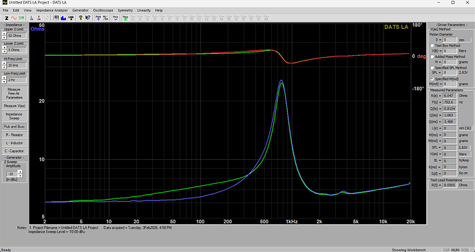

Not as well matched as I would have liked, but I have seen worse.
Not too bad, I would say. What about FR?
I have bought several different Chinese tweeters and the cheap ones measure better than the SS knockoffs. They have a big bump from 3-6khz. Guess you could notch it out. Not sure what I am going to do with them.
Will be awhile before I measure FR.
