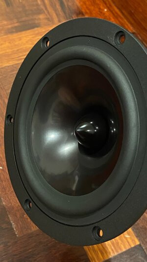

Multicomp PRO MP011860 5" aluminum cone, plastic dustcap ferrite mid-woofer with copper pole cap

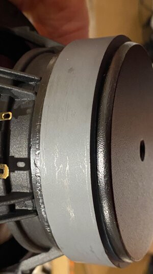

This is a plastic dust cap that moves with the cone.

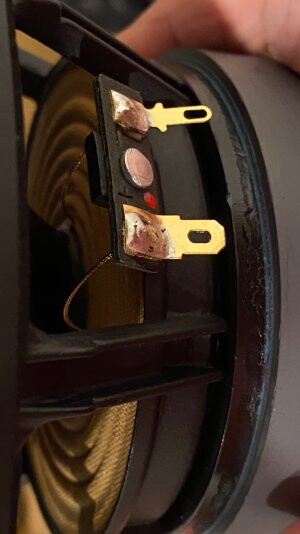

No under spider venting, small pole vent.
Despite a geometric x-max of “only” 4.4mm, the spider is quite large, with 11 corrugations.

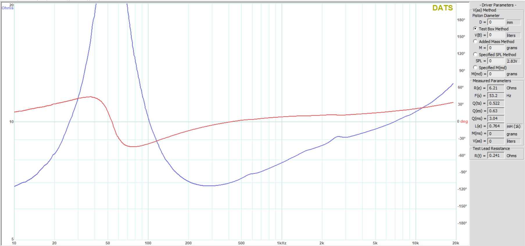

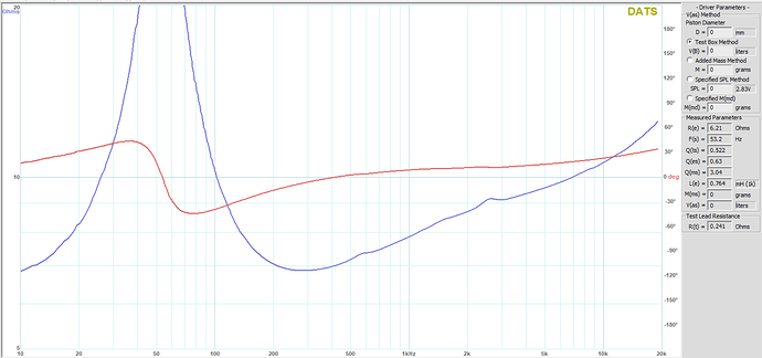

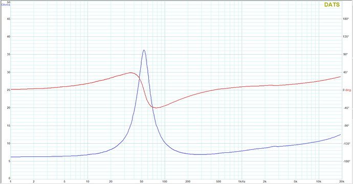

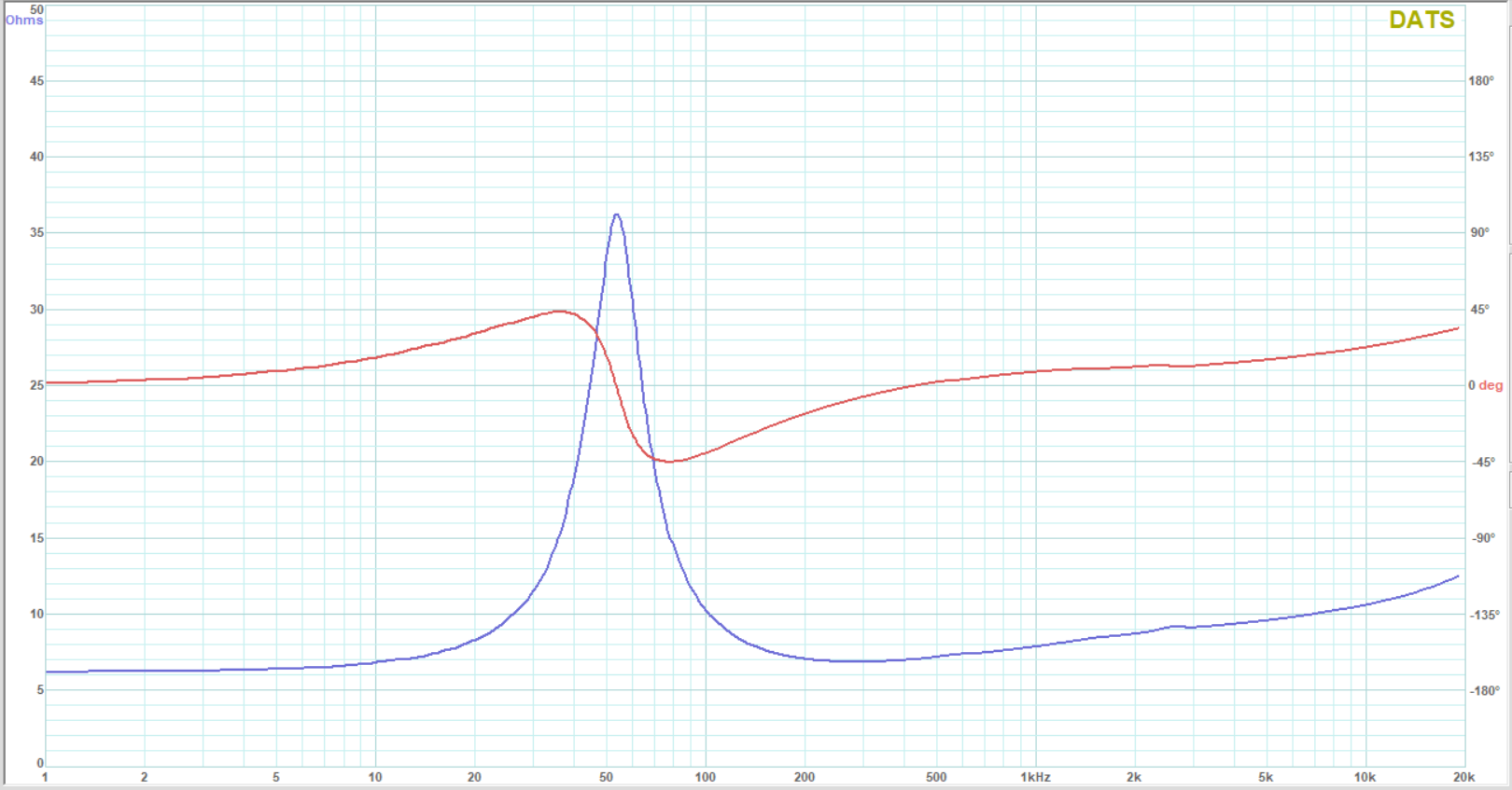

Here is the free air impedance trace:
Note the lack of rise in impedance at high frequencies, thanks to the copper pole cap.
Compare that to the Dayton’s RS150-8
Log zoomed impedance trace:
Note the blips in the impedance trace around 500Hz and 2.5KHz. We’ll come back to that later.

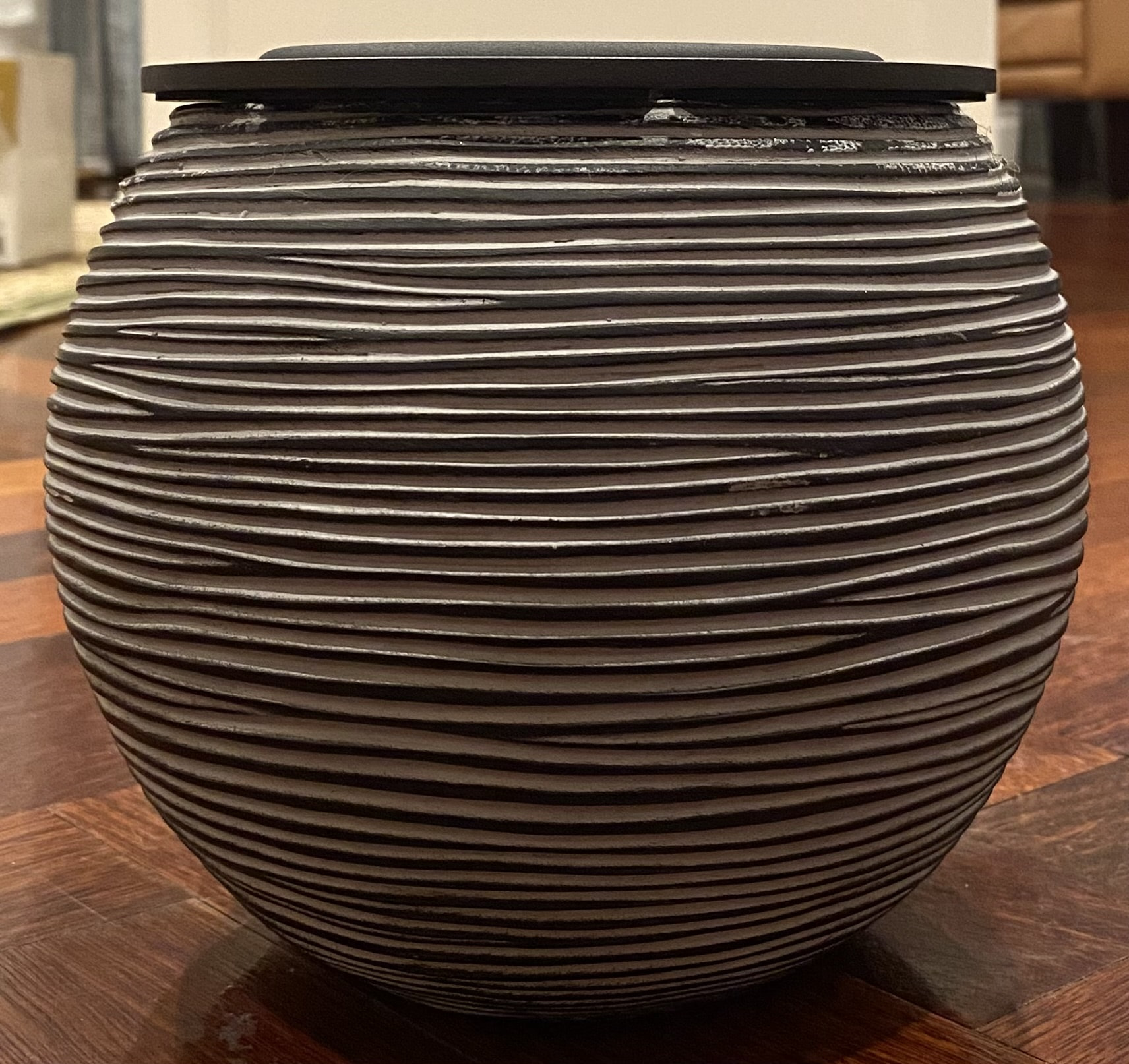

Far field measured in this pot-plant bespoke hand-made sealed spheroidal enclosure made of fibreglass :winking_face_with_tongue:

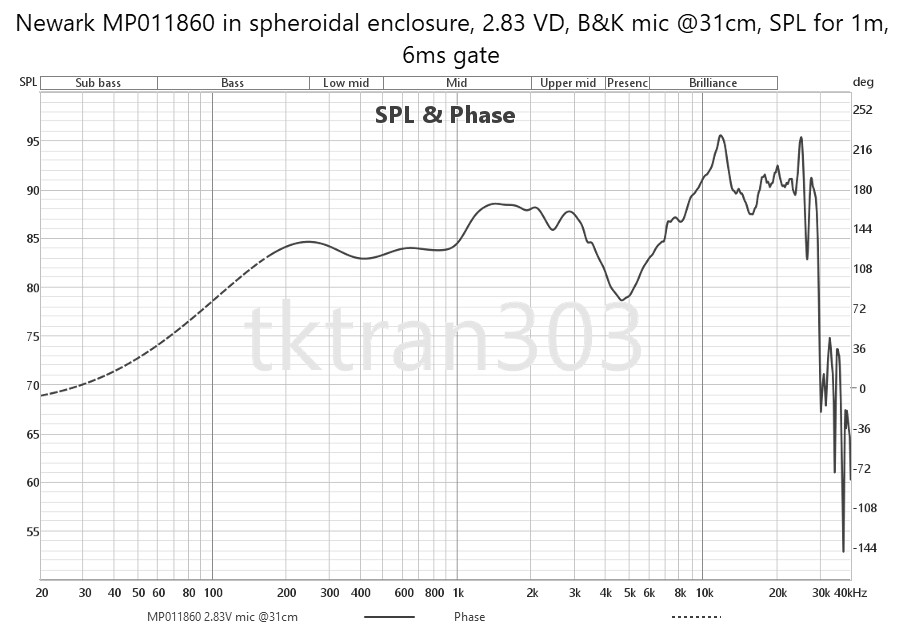

Now we measure at 31cm and 20mm, in the Hificompass.com tradition, to determine the midrange and bass performance respectively.
Amplitude response 25dB/dec, monochrome; dashed line shows imprecision due the gate.

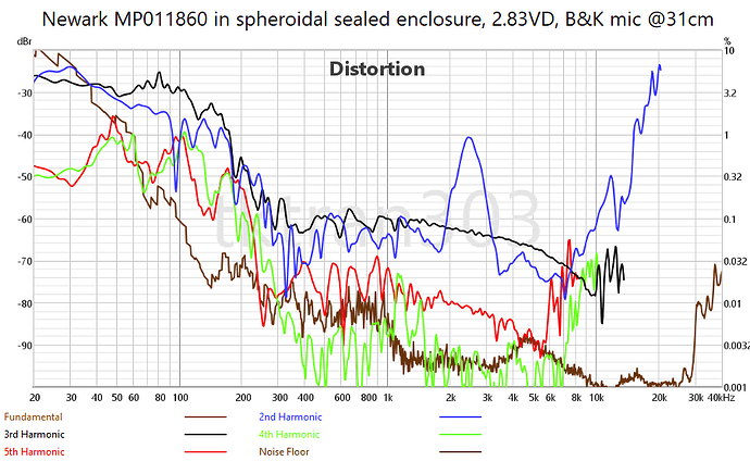

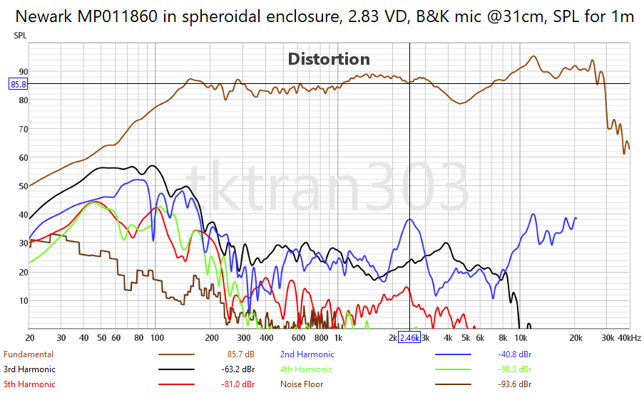

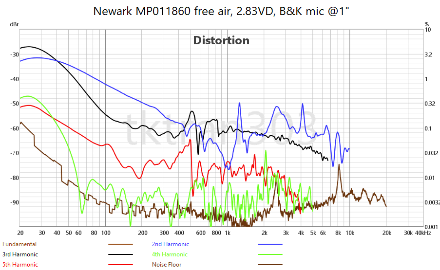

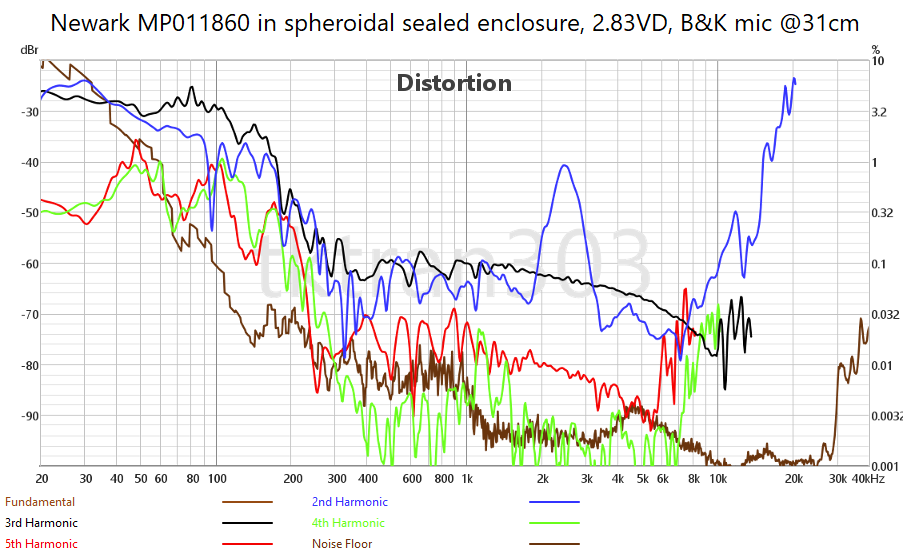

Harmonic distortion. Mic at 31cm to improve signal to noise, but SPL displayed for 1m:
N.B. Distortion graphs in REW use a fixed 1/24th octave smoothing of the fundamental.
H3 and H5 are very low and decreasing with frequency, unlike the RS150. Higher order harmonics are completely below the chart.

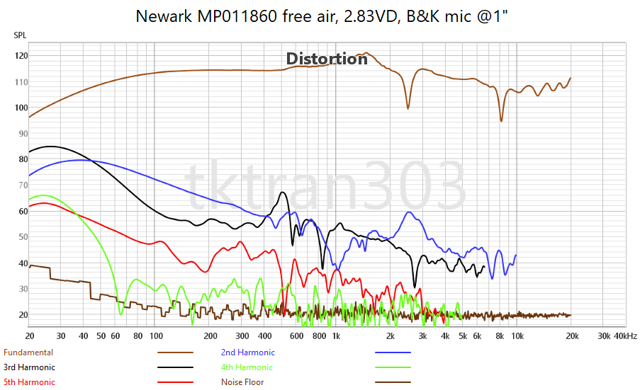

Another view:

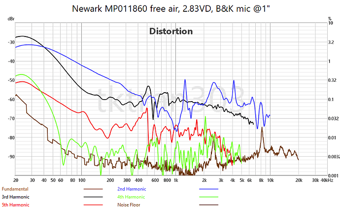

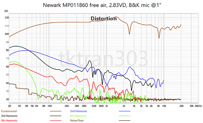

Now when mic is moved to the nearfield of the driver:

Amplitude response dip at 2.5KHz
Very slight chuffing around 500Hz, caused by air slug behind dust cap and pole vent (measurement/analysis not shown).

With dispersion diving hard past 4kHz, an acoustic LR2 is out of the question @jr-mac definitely made the right call low-passing under 2kHz.

That 2.5kHz peak is probably coming from the dust cap.
So if I had more time, I’d heat up the aluminum cone with my gas soldering iron blower (or a hair dryer), which heats up the adhesive and allow me to remove the dust cap. Then I’d replace with a 3D printed one, or a foam plug.
Or, I could remove the over-roll surround, and replace it with a lightweight flat foam one. Based on past experience, that would to gain 3–4 dB in voltage sensitivity, turning it into a great 5" pure mid 89–90dB/2.83V (400-2K). Just make sure you use a foam that’s designed for exterior use (for durability/longevity)
