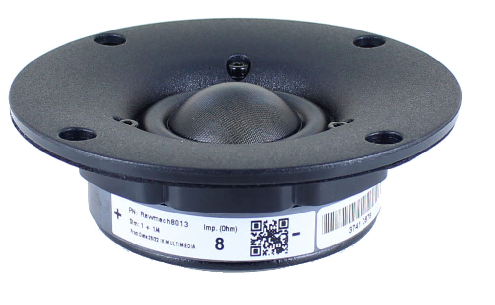

We are pairing it with the buyout Wavecor tweeter from Madisound.

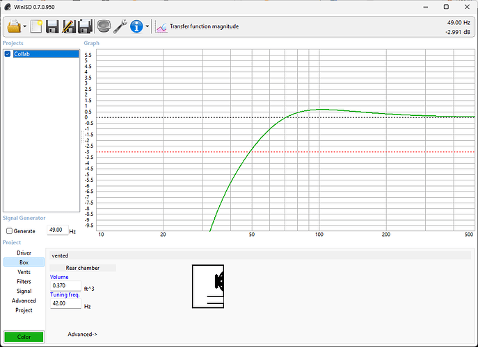

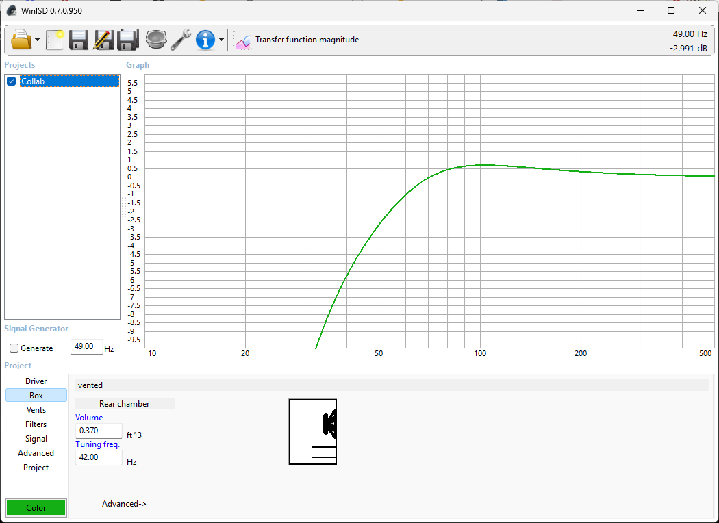

On my end, I plan on using a pair of the old school PE 0.375 curved cabinets tuned to 40Hz. This yields an F3 of ~50Hz.

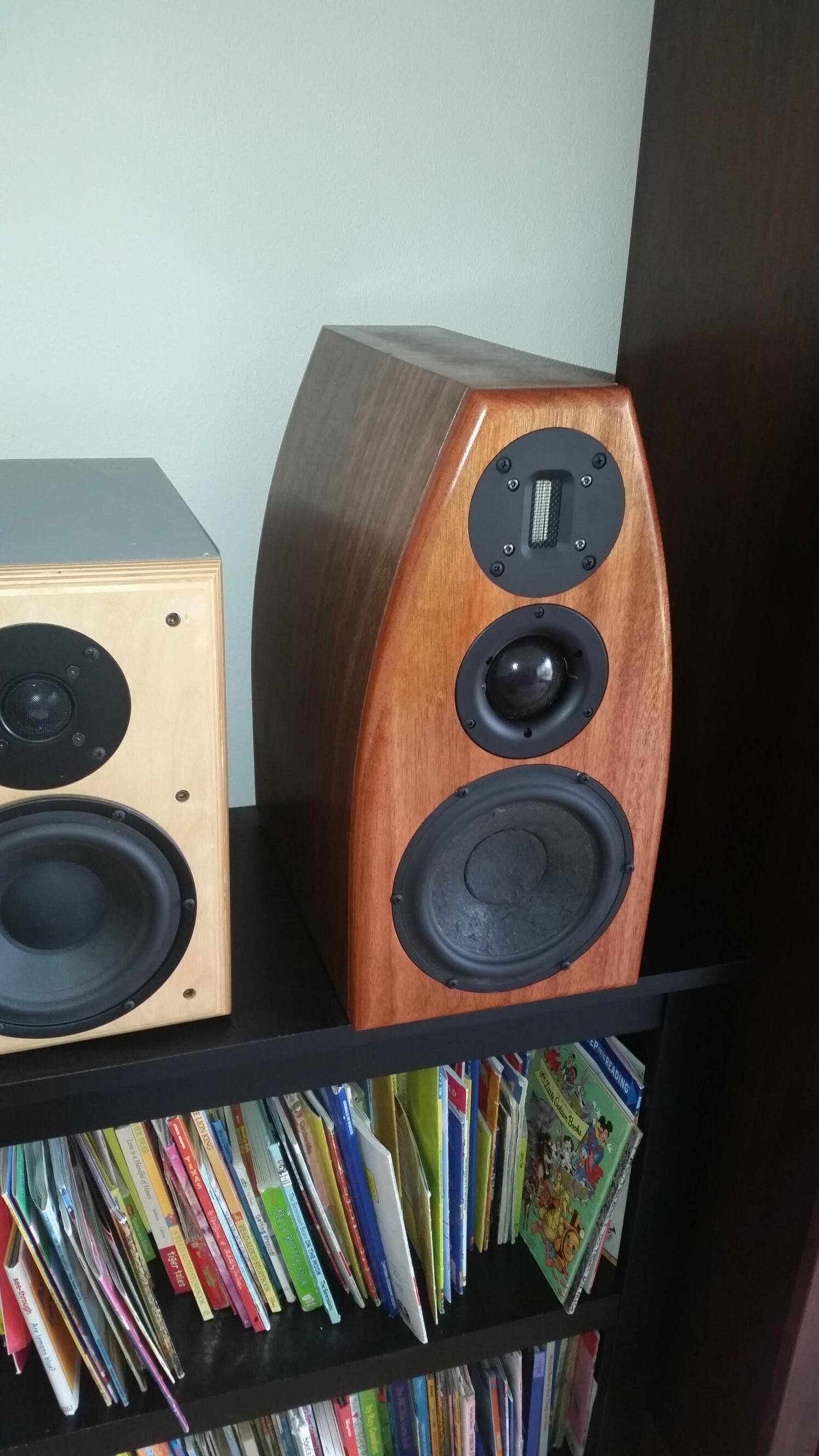

Please post cabinet dimensions, maybee I will make curved cabinets as well. Tom Z’s last build has me inspired.
Curved cabinets are fun… in a time consuming way :wink:
I’ve only built 2 projects with curved cabinets. The 44” tall Agendas, curved front to back. And the 20” tall Gormachos, curved bottom to top.

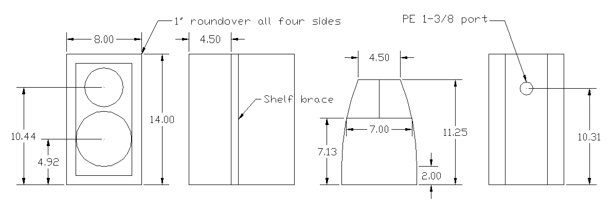

I’ll get the tape measure out tomorrow afternoon and get some CAD drawings started.
Here you go:
Was a lot of fun deriving the curve. Should be all the dims you need to get it done.

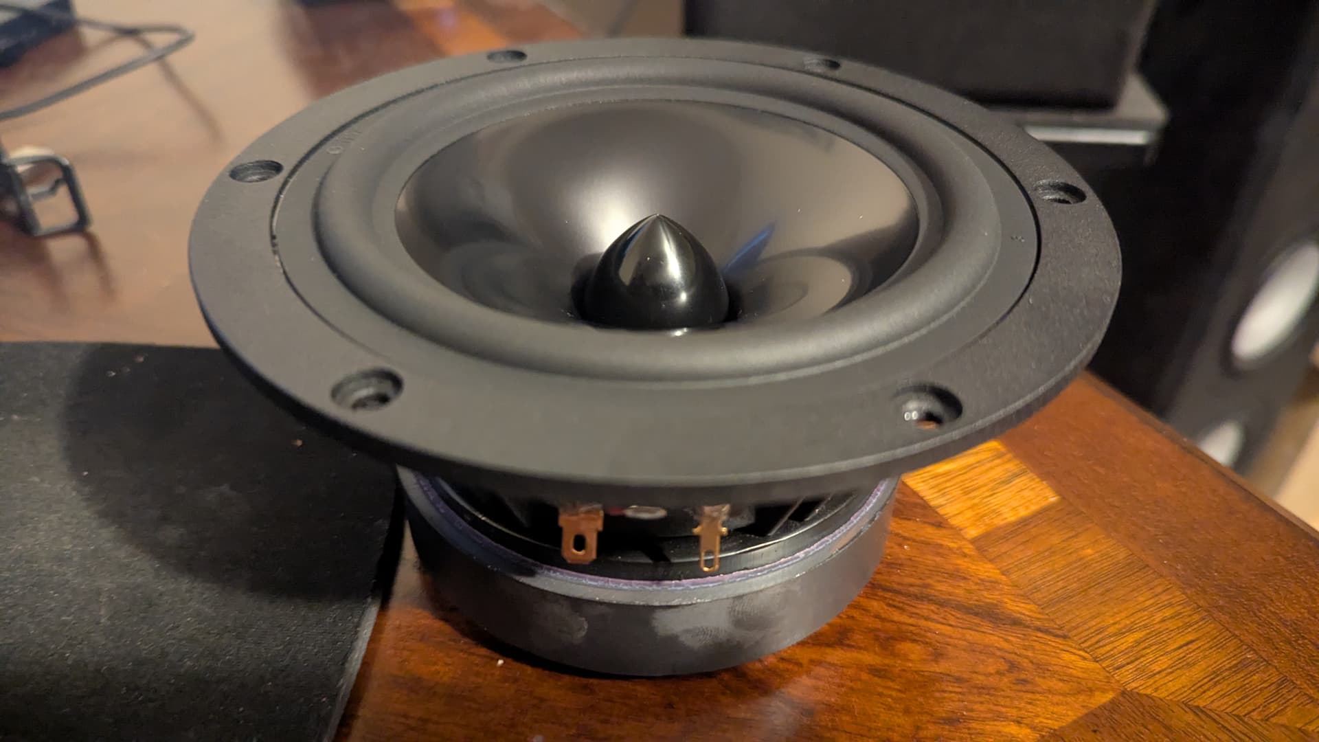

Very very similar in appearance the RS150. Measured very close to advertised.
https://www.newark.com/multicomp-pro/mp011860/speaker-20khz-8ohm-86db-150mm/dp/76AK9653
Currently $28.45, probably going up in the near future. Cast frame, copper cap, higher Xmax than the RS150, just takes a little larger enclosure for optimum extension. Lot to like here, and when you consider the price…
The tweeter went on sale after I bought my pair, as is par for the course. $28 for a Wavecor tweeters is insane, grab a pair while you can.

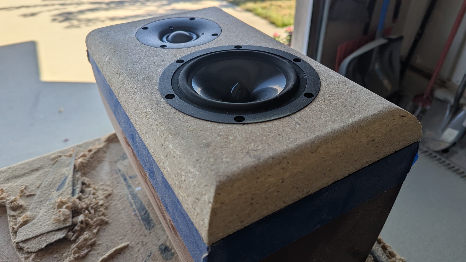

Decent enough for what amounts to a 5.5” driver. Have not done any cabinet work yet due to some other stuff that has come up but hope to do some of it today. For this one, I just need to machine baffles and cut holes for the ports.
Can you post driver TS specs for those that want to play along? My woofers are not in yet.
I did not measure Vas, but the rest of the parameters were all close to advertised so I made a reasonable assumption that advertised Vas is close enough.

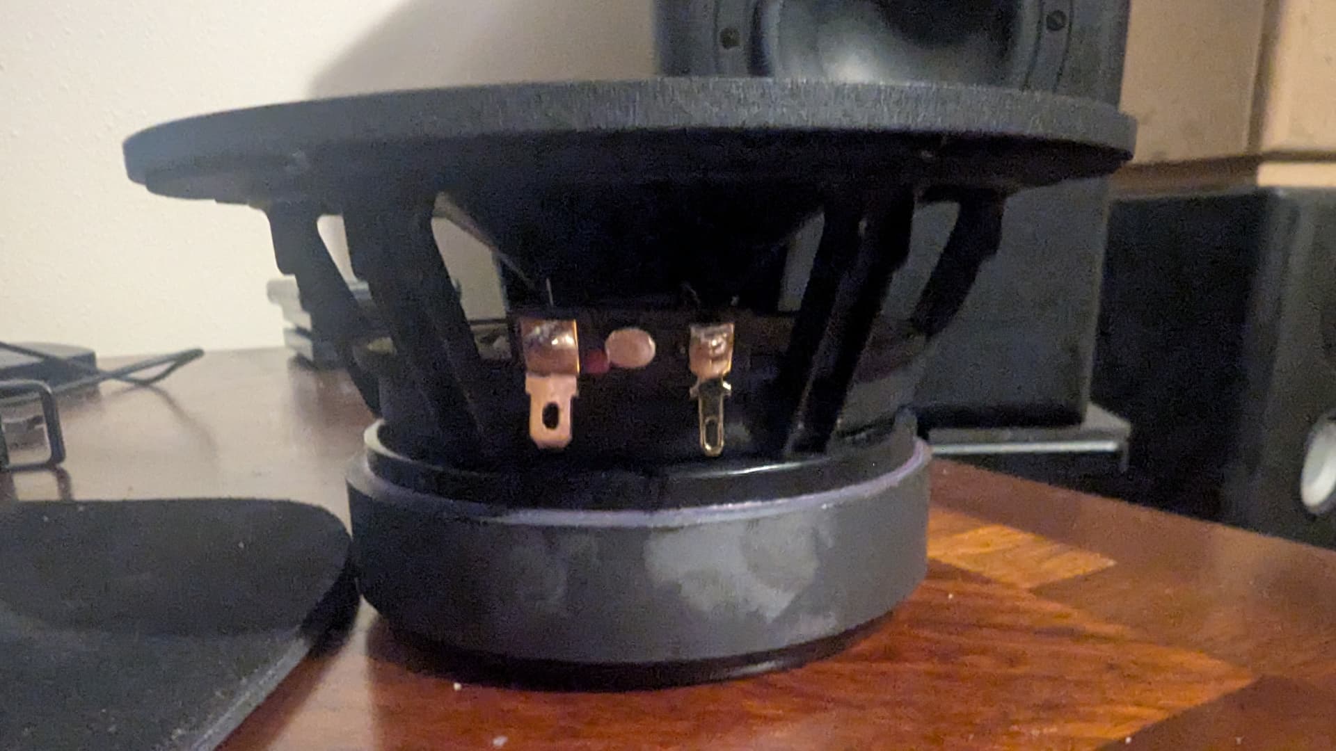

Be advised that is not a phase plug on this little woofer.

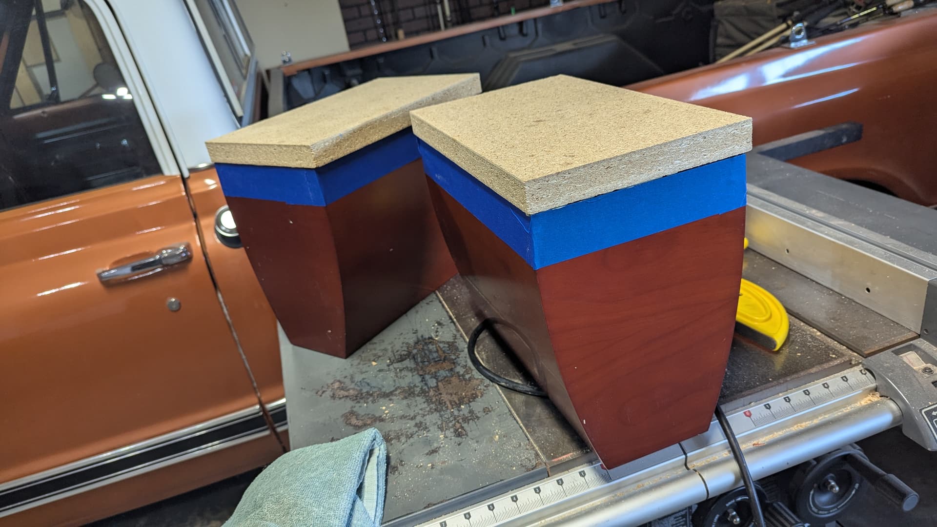

Got baffles glued on today.
Some time today I will be routing these baffles as well as another pair. That means I will have three pair to keep me busy over the coming months.

Going to Duratex the baffles when all is said and done. That will look nice with the cherry veneer.

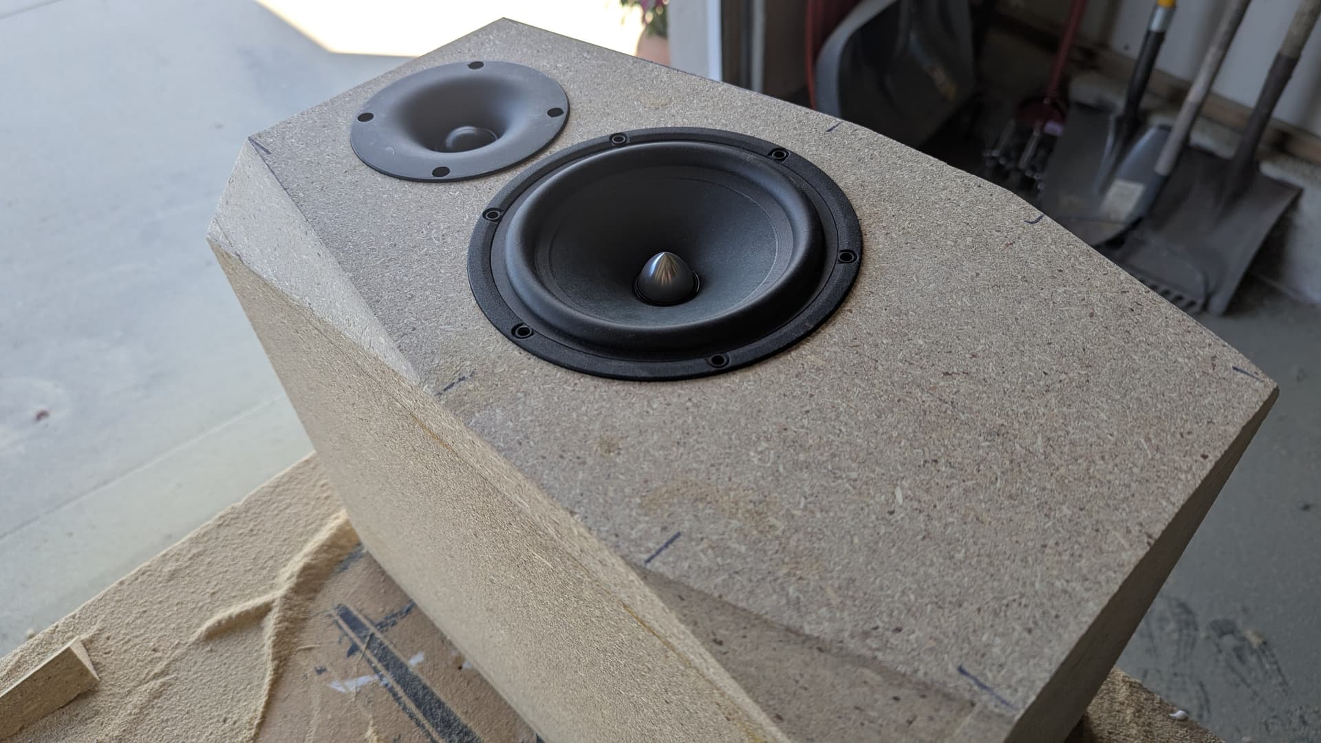

These are done with the machine work, on to other pair.
The other one I machined up today. High hopes for both of them.
