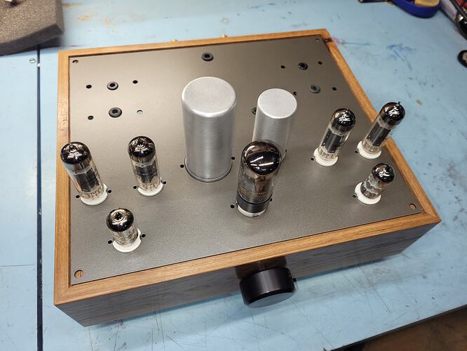

I finished machining the top plate after work yesterday. Went in to work early this morning and painted it then baked it in one of our ovens. The tubes, sockets, and caps are just sitting there for overall reference:
That looks awesome! Just to be clear…you simply painted it with a high temperature engine paint (something off the shelf from a big box store?) and baked it? Is the oven at work anything special or were you just avoiding baking paint in your kitchen oven?
Back history: when I was still single I stored my racing slicks in the living room, cleaned cylinder heads and other car parts in the dishwasher, and cured painted engine parts in my kitchen oven.
Fast forward two deades… I can’t spray paint anything in our garage when it it is too cold to have the overhead door open. The fumes somehow make their way under the door and into our house.
Yes, just off the shelf spray can Dupli-Color high temp (500 °F) engine paint from Autozone, Advanced Auto Parts, etc. I apply two light coats, ten mins apart, then a heavy/wet coat after another 10 mins. I let it air dry for 30 mins then bake it at 175 °F for 2 hours. That bake cycle drives 99.99% of the solvents out and after a 20 min cool down it is fully cured. I do it at work because I can and there are zero complaints at home about the smell :wink:

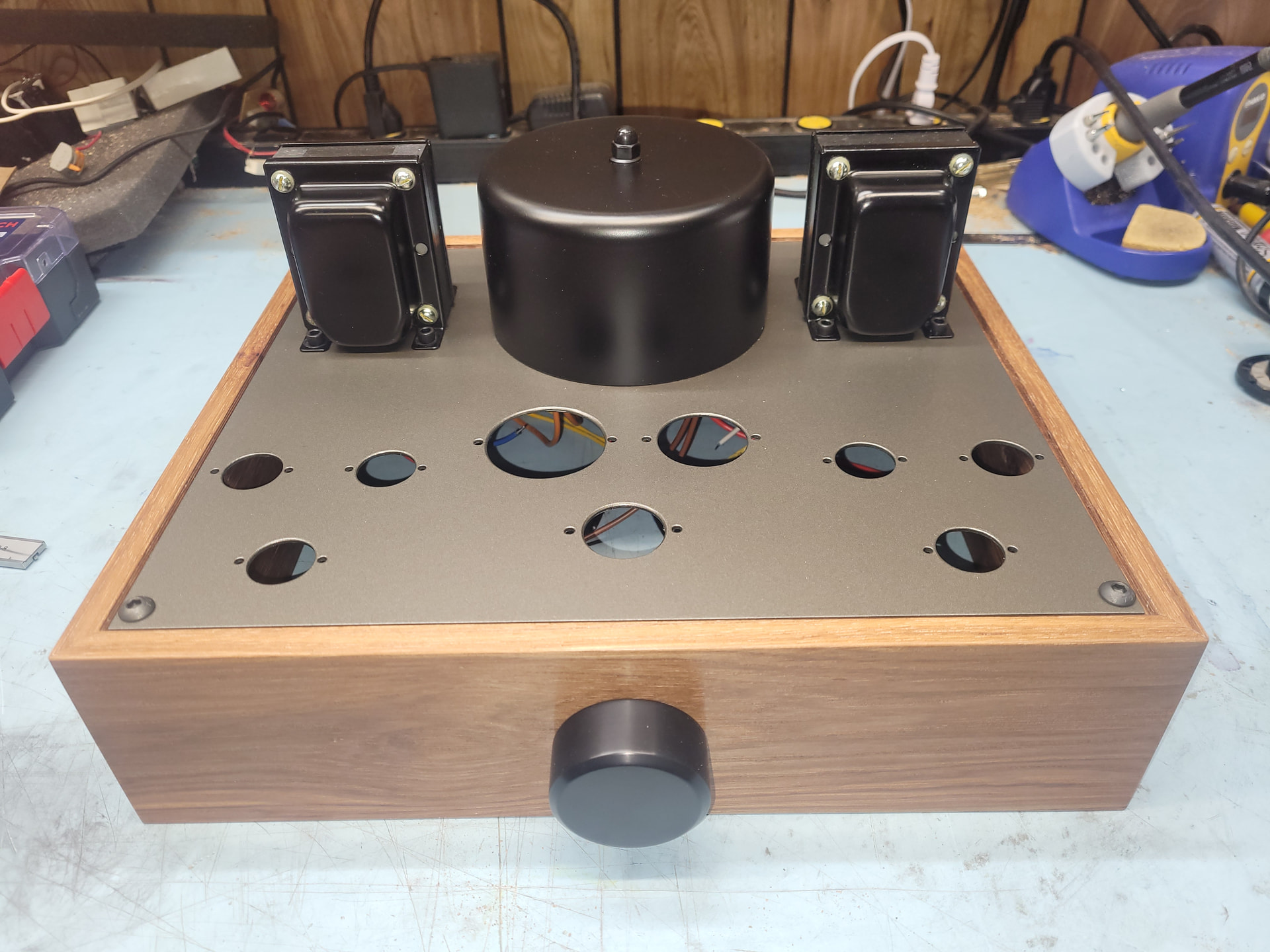

Had some time early this morning. Got the output transformers, power toriod and its cover mounted.

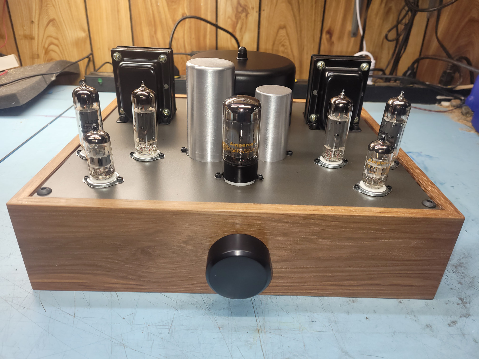

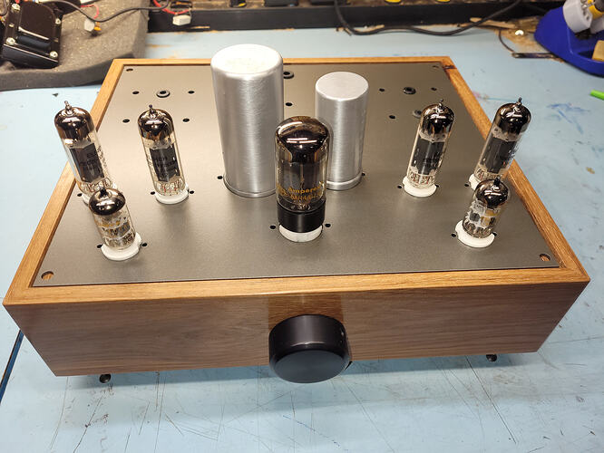

Last picture until I get some serious wiring done under the deck:

That looks fantastic, Craig.
Yes, beautiful!
BTW, how much power will this thing make? I seem to have missed the application too.
Very, very nice, and Amperex tubes
Amperex tubes courtesy of Tom S.
