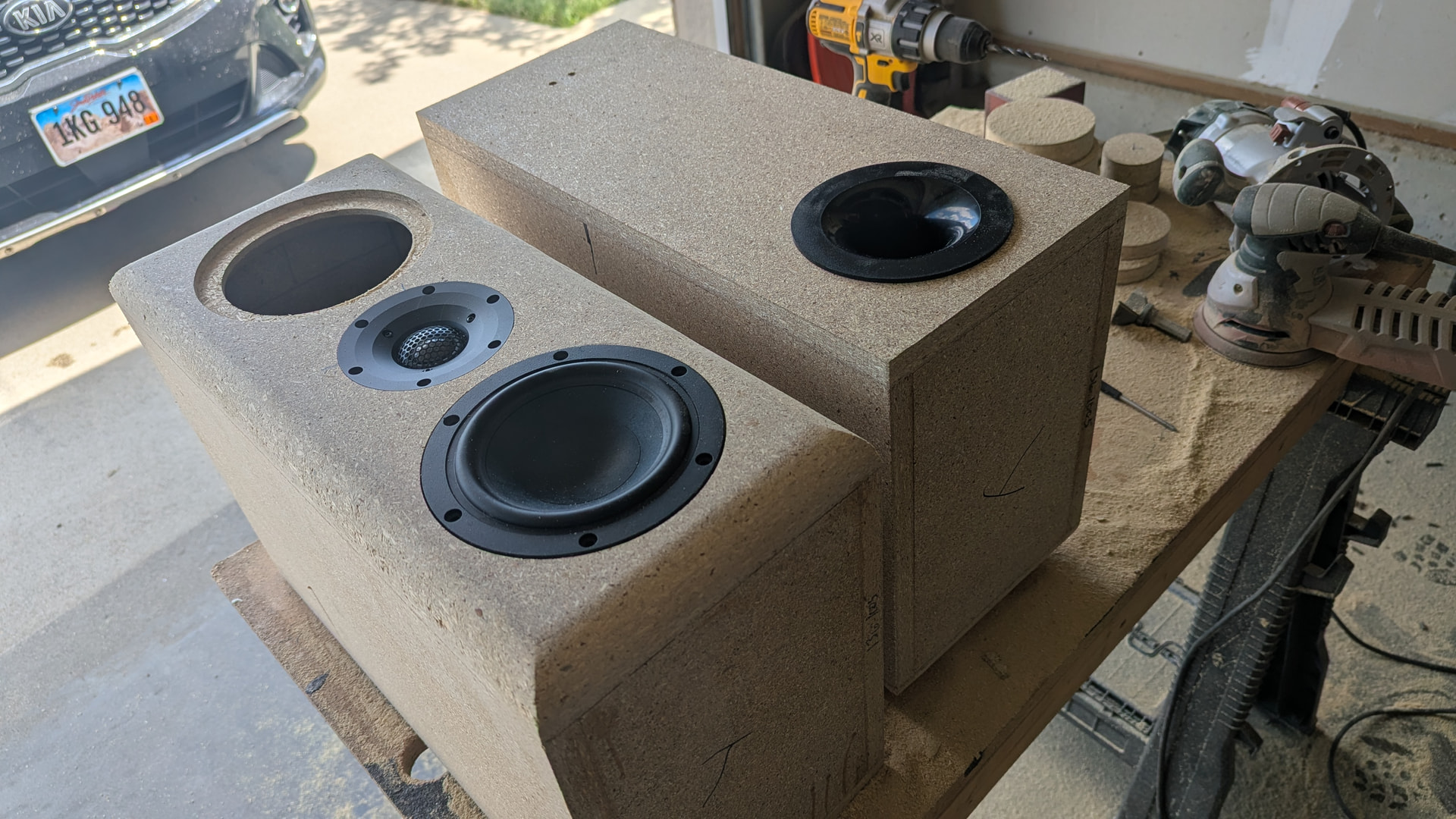

There, machining done and ready for bodywork. 1" roundovers.
Is that tweeter a knock-off of the SEAS DXT?
Yes. With, I hope, a better motor.

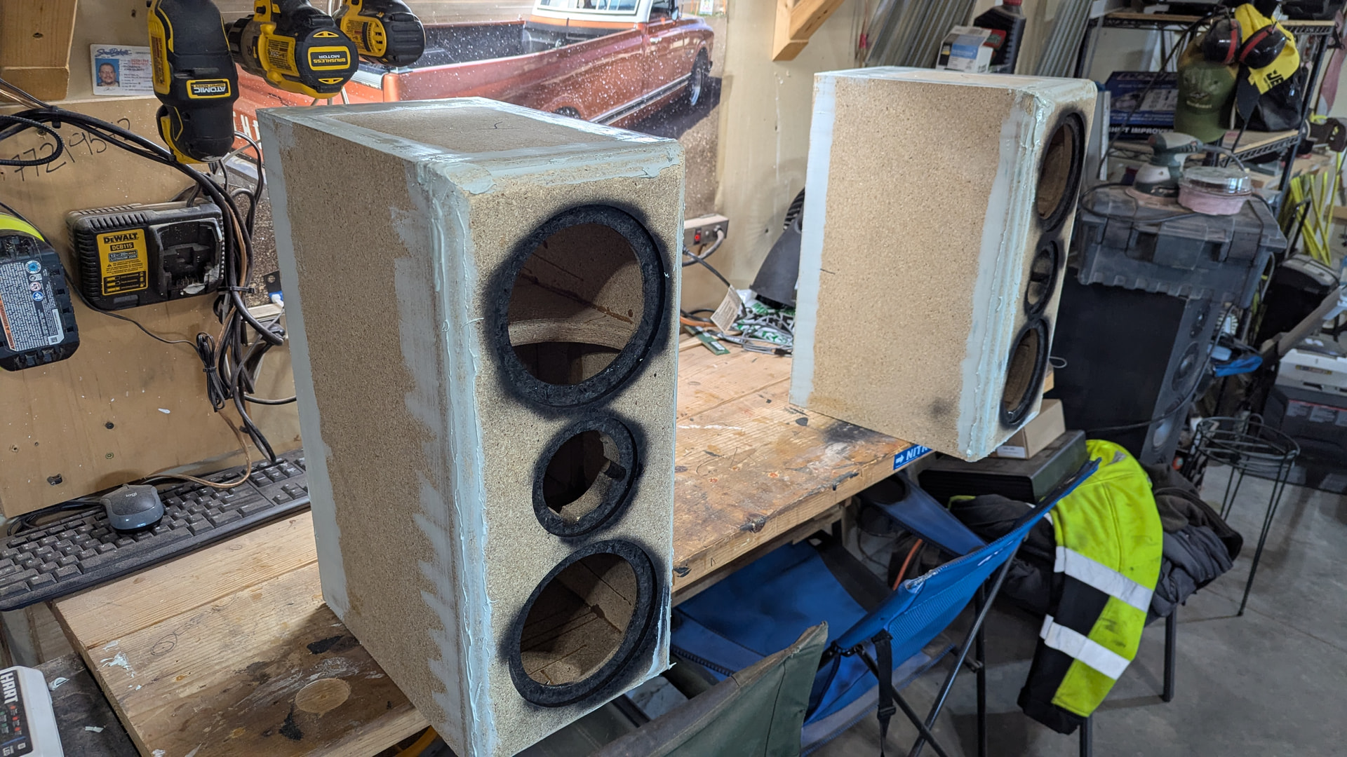

Bodywork about half done. Need to sand this stuff off, apply a glazing coat and then sand that. Then it is time for duratex!
I have a very good feeling about these.

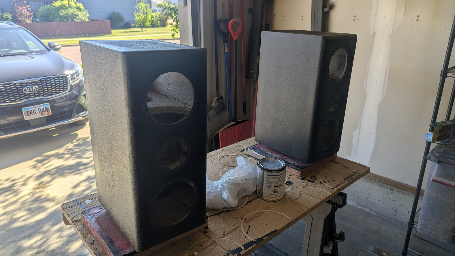

First coat.
Was gonna three coat it, but decided two is enough. Hope to get one assembled and ready for measurements when I get home from work today.
