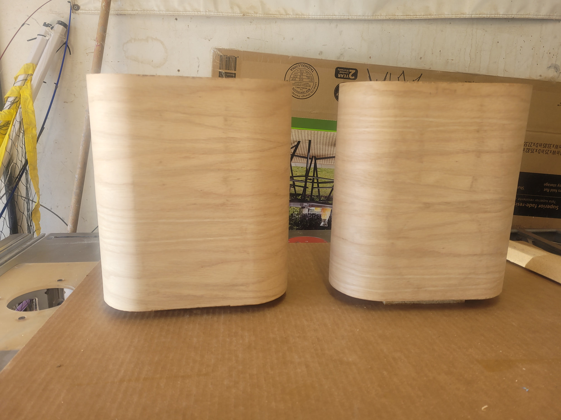

I have decided to veneer these instead of painting them. I have some very nice paper backed oak veneer. I want to wrap them each with just one piece of veneer resulting in a single vertical seam on the back. That said I will be applying the veneer with grain going side to side instead of vertically. I don’t recall ever seeing any speaker veneered like that. They will either look cool as kiss or a hot stinking mess. I won’t know until it’s too late lol!

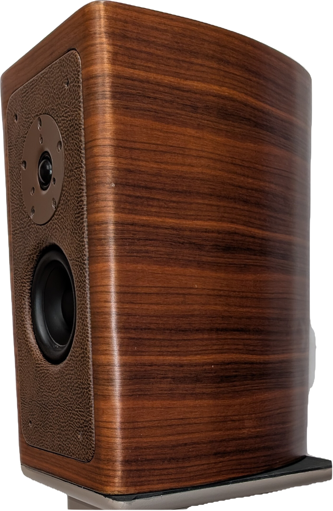

A couple of my recent builds were horizontal grain veneer, though not oak and not a total continuous wrap to a single seam.

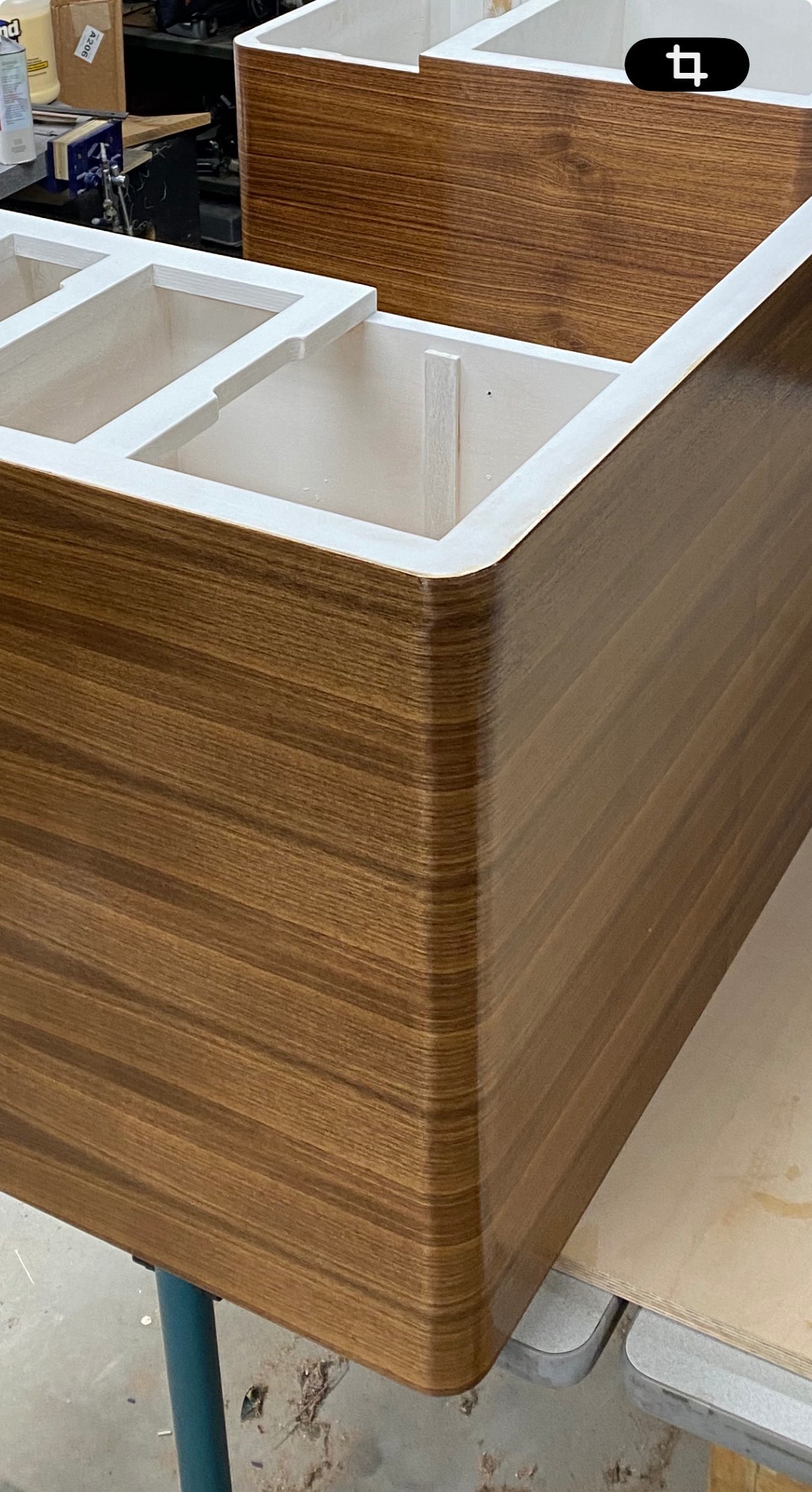

I’ve done horizontal grain veneer on a couple of builds that had veneered round overs and were one continuous wrap.
Those all look great! Thanks guys.
Ron’s is horizontal, but the grain is parallel with the round over. Craig is talking about the grain will be perpendicular to the round over.
I’ve done that on the desk I made for my wife. That was an 1.625" radius, so your tubes should be no prob. Paper backed walnut…
Now nailing the seam on the back is another thing. Good luck​:sign_of_the_horns:t3:

Well… they are not absolutely perfect, but they certainly don’t suck! :slight_smile:

Nice! Which glue did you use?
Titebond II

That is very clever how you did the rounded sides, well done.
I was going to suggest veneer softener, but too late and apparently not needed
Looks awesome!
Look great from the photo. if you don’t mind, can you get a close up on the seam and how you got the edges to line up? Titebond II with the heat iron on method or just wet titebond II and use a roller?
