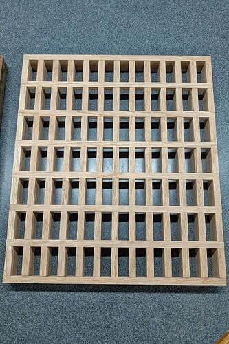

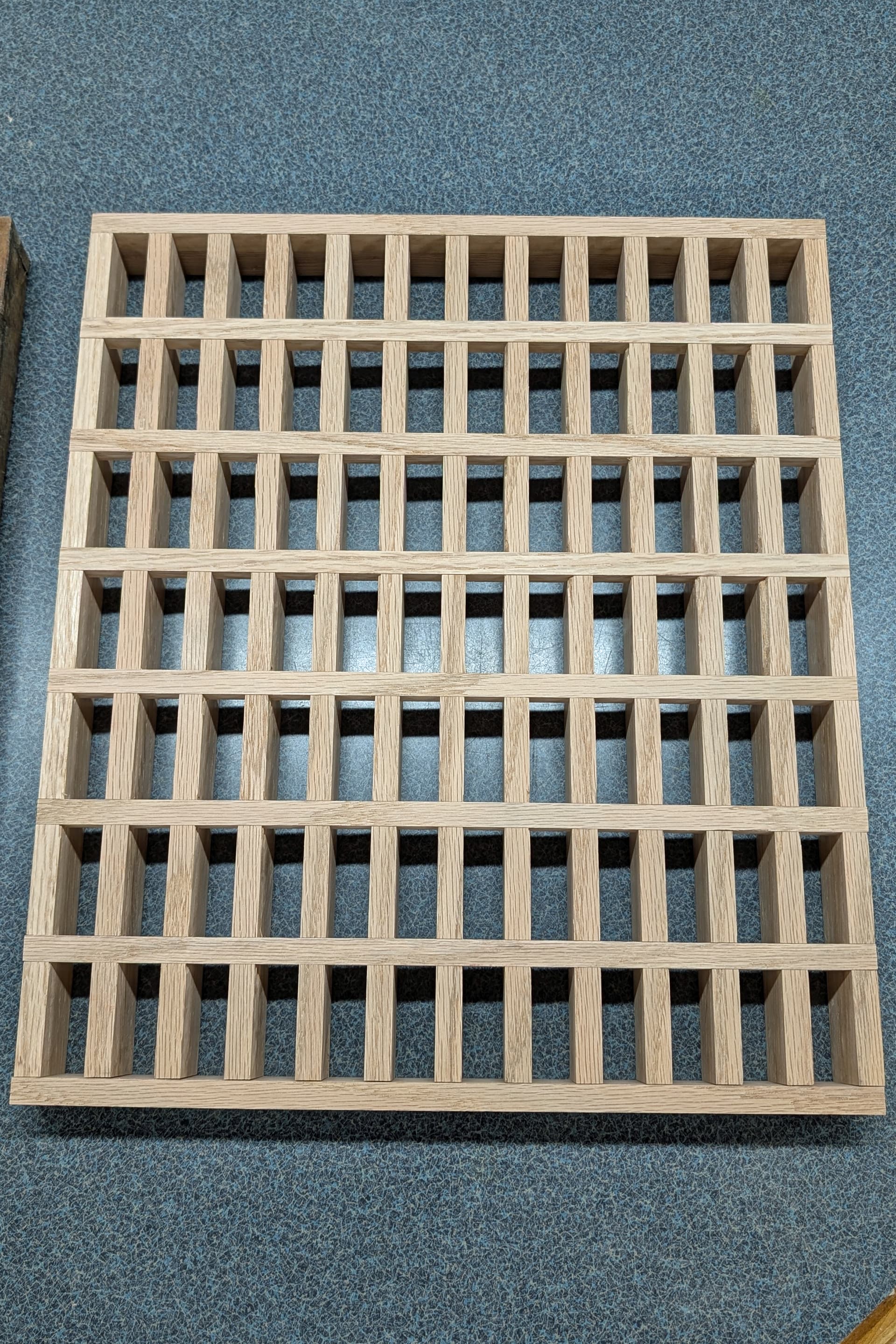

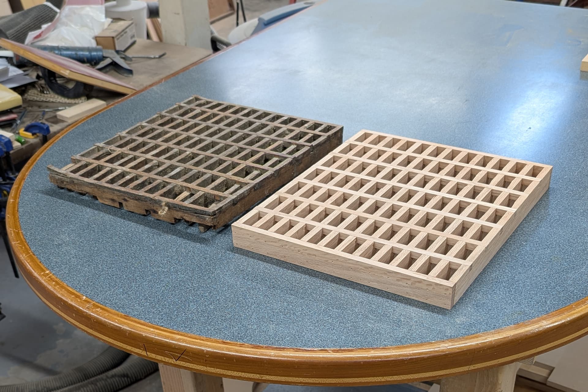

My wife bought a 1919 house to fix up and I get all the hard projects. The cold air returns are oak and are pretty rough. This is a small one and I have another one that’s at least twice as big to do.
Half-lap joints?
Looks good.
Kind of funny, sold a router to a guy last weekend who was doing a similar project, heat registers. His old cheap router bit the dust.
The long bars are 1 1/4 x 3/8. The cross bars are 3/8 by 3/8 and fit in dado cuts. That’s how the original was built.
Ahh, took a closer look. Cool.
Looking at the originals they looked like they were all full height pieces until I examined them closely. I too assumed they were half lap joints until I went to build a replica.

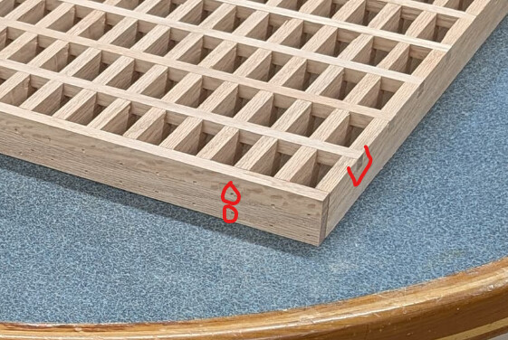

Ron, are you able to post a couple of close-up pictures of the joints? I am not understanding what type of joints you put in.
pin nailed on the ends and dados on the top.
ok, the top piece goes in halfway into the dado. Thanks for hte explanation.
