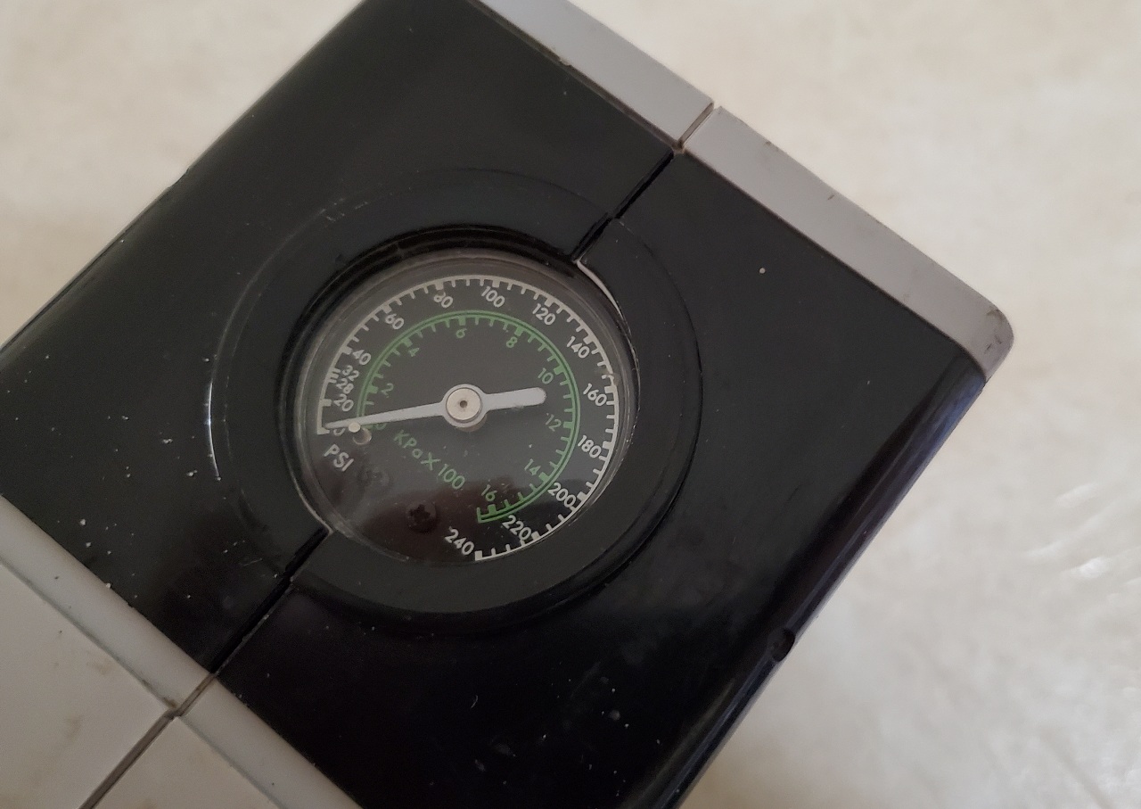

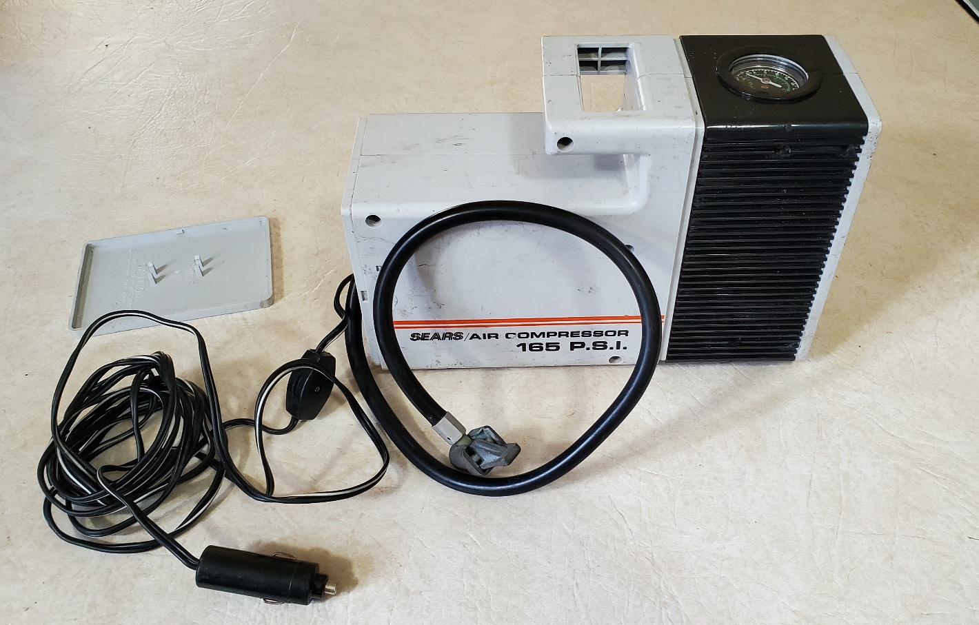

I picked up a used Sears 12V inflator at my local Re-store for $2. Got it home, hooked it up to my bench top power supply and discovered that it could not develop pressure at the nozzle. Took it apart and discovered that the small 1/4" ID hose between the pump and air pressure gauge had broken off. So I replaced the broken hose with some high pressure (133psi) stuff (fuel line) and now it works good. Tested it on my car. It is kind of slow, but works good. I can pump each tire up from about 30psi to 38psi in about 5 minutes. A completely flat tire would probably take about 10 to 15 minutes. The motor draws over 5 amps from the battery during operation and it makes a moderate amount of pumping noise. But it is not too bad. I lubed the pump piston sleeve and crank shaft bearing with new grease when I had it apart.

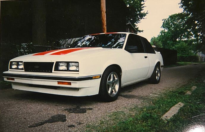

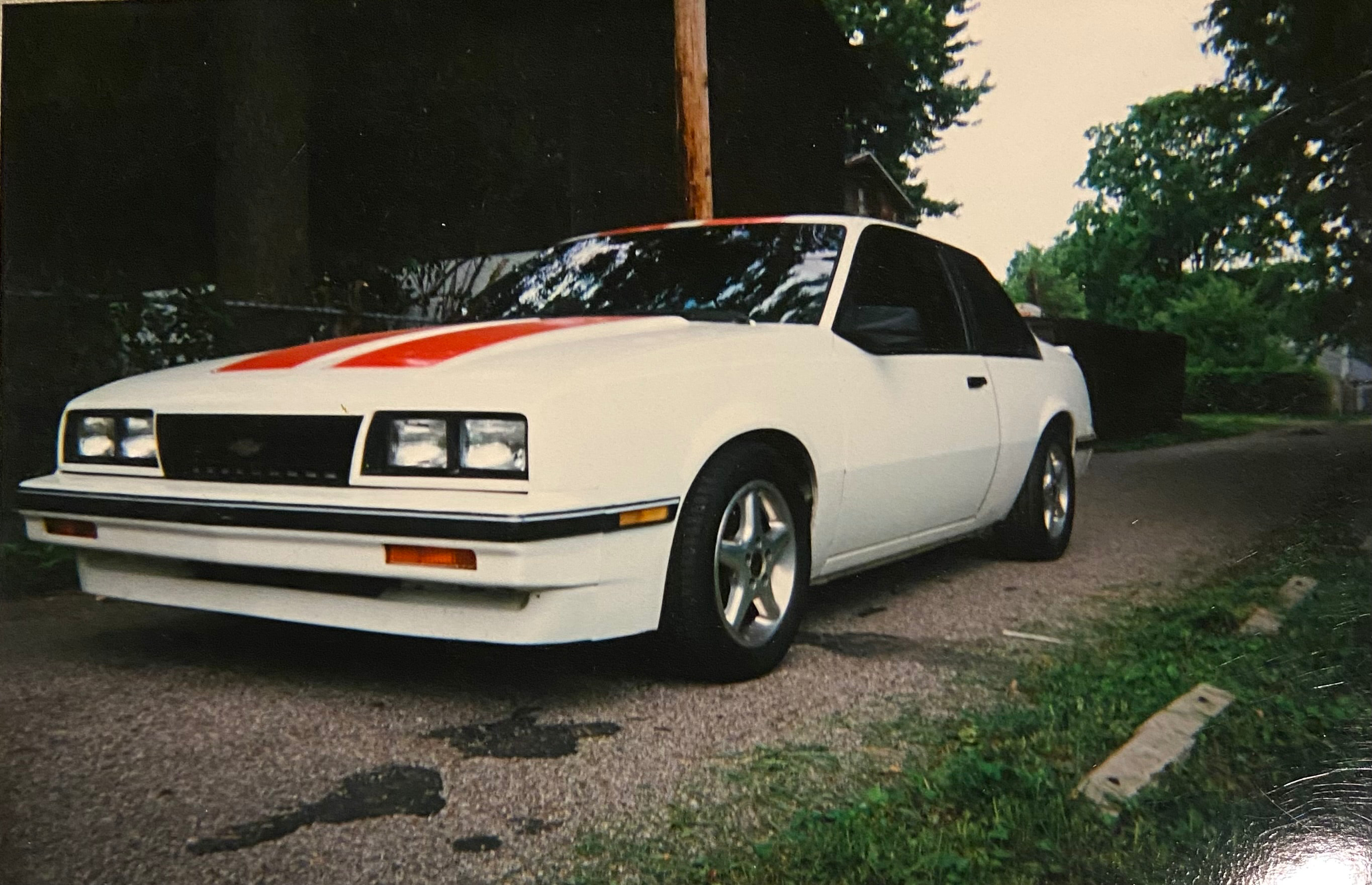

Back in the mid nineties after totalling my first car, an 86 Cavalier, I was in need of another ride… cheap. A friend of a friend’s dad fixed cars to sell. He just finished an 86 Cavalier (go figure!) Had a brand new paint job in black cherry red on it. I was able to work out a deal and had an even nicer Cav than before.
Two weeks later one of the biggest hail storms to hit Louisville happened. I was in the top floor of an apartment, by myself, and thought this is the end. It sounded like a train was running on top of the place, it was so fucking loud!!
After it ended and everyone started coming outside. There was about a foot of golf ball sized hail covering the ground, unreal. This happened in the evening, so I didn’t get to see what had actually happened to my car till the next morning.
So yeah, devastated. I just spent everything I had to buy that car and it was demolished. Sad sad day. Luckily the windshield was the only window broken, which is free replacement in Kentucky. But everything else…:man_facepalming:t2:
I slowly starting fixing small dents myself and saving up to buy a hood, a grill, and trunk lid. Eventually could afford to have the roof fixed. Then eventually an El Cheapo paint job. It took me well over a year to finally get that car back into shape. Had to replace the engine in it during all of that, another feat in itself.
She was quite the looker for being an ol 86 Cavalier..
