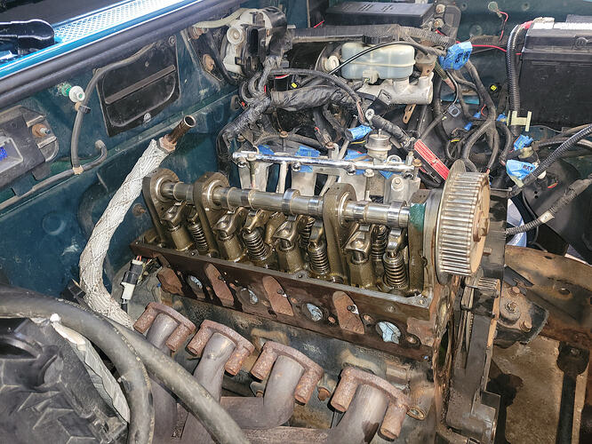

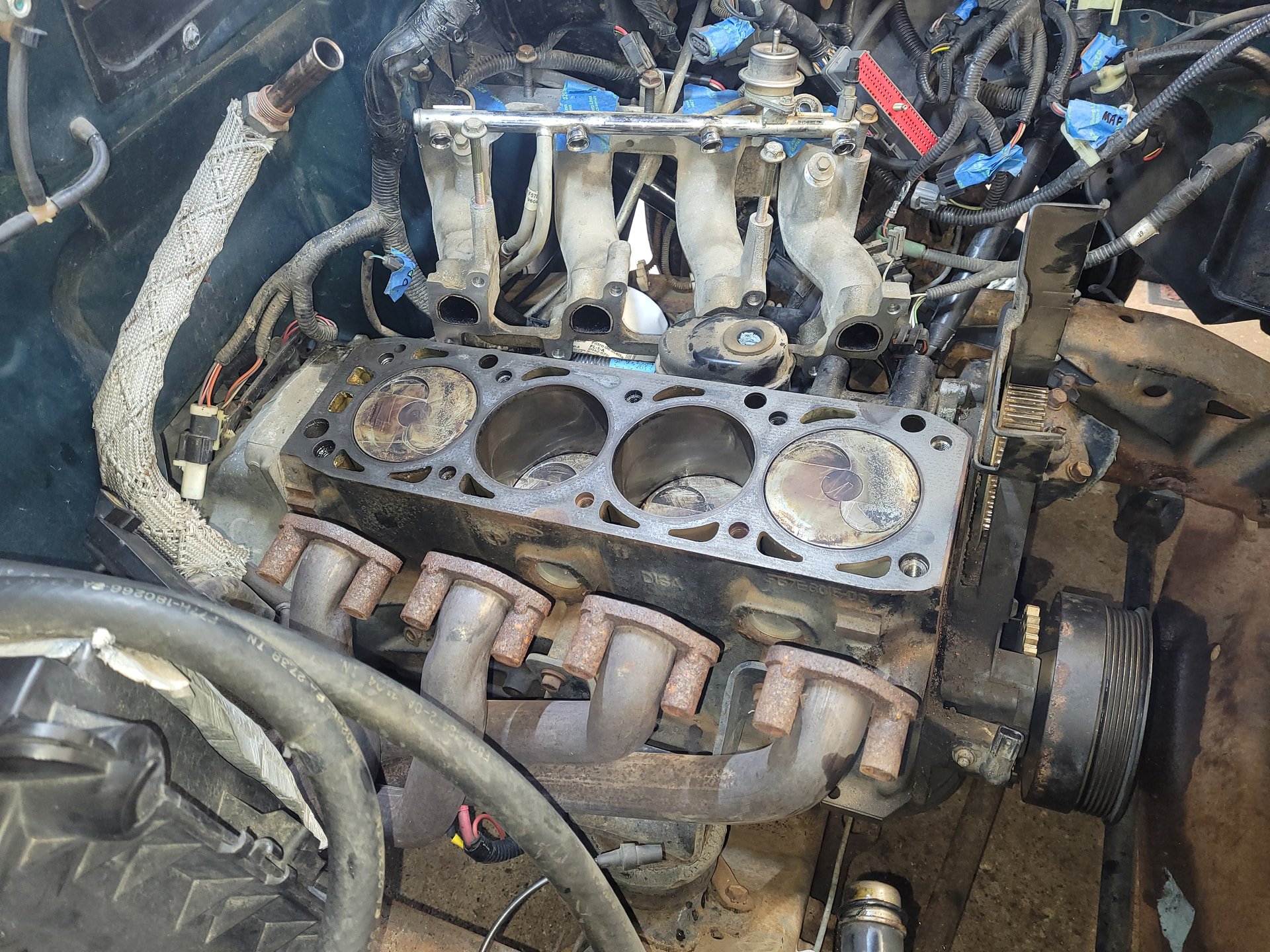

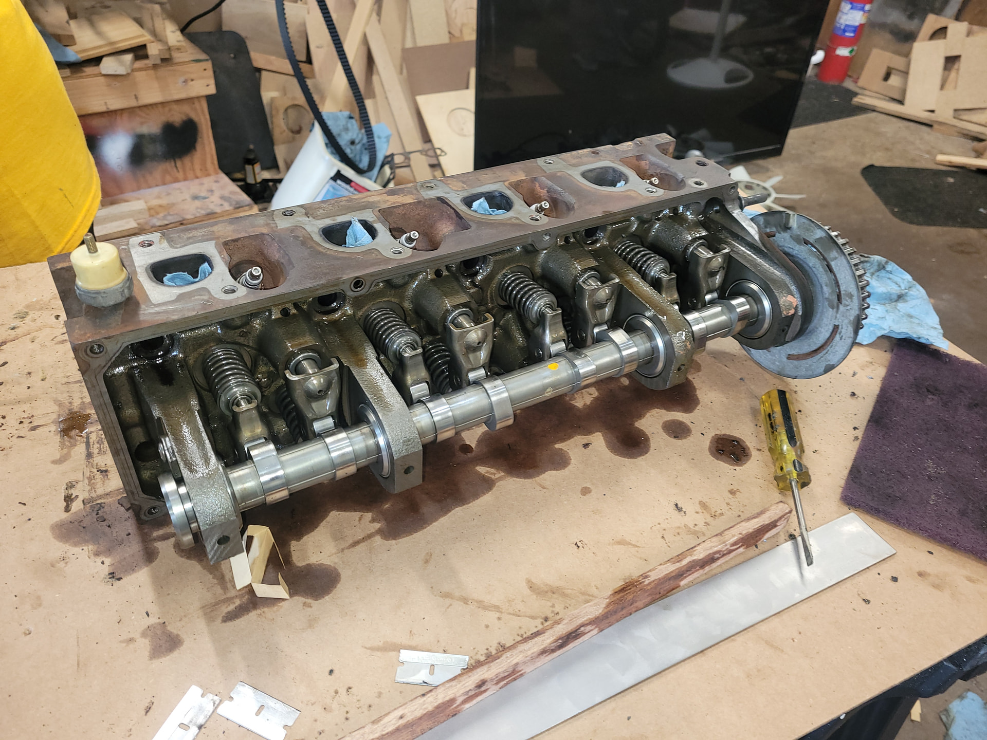

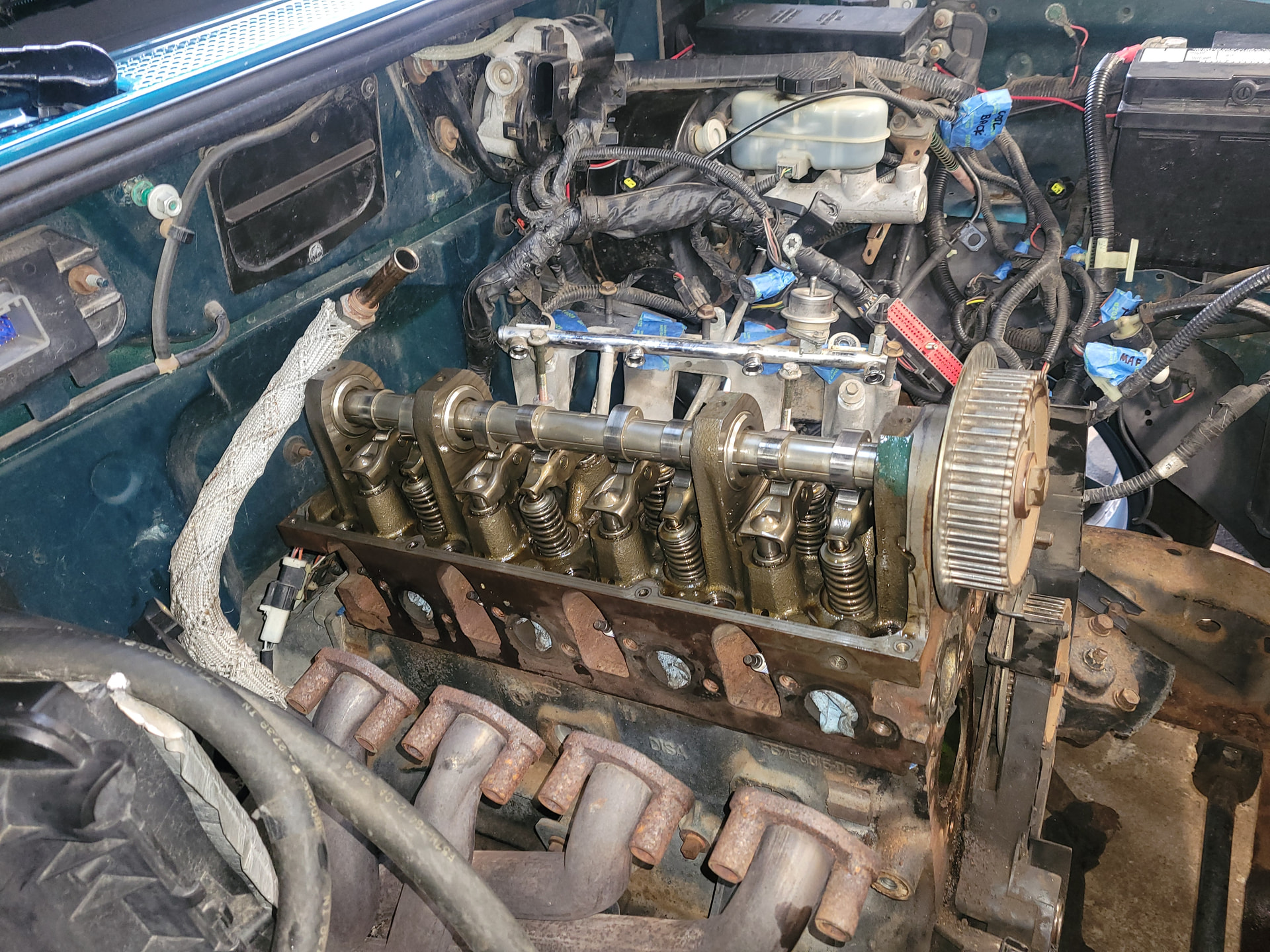

We noticed a small drop of coolant under the Ranger. Wiped it up then noticed another drop a couple days later. After careful inspection my son and found the head gasket was weeping out a bit. Nothing into the oil or the cylinders. We blew it apart and are now putting it back together. Head and block are perfectly flat. Valves and seats look really good. Cylinder walls look almost new. My son is learning a ton of wrenching tech working on this together. He says he loves it!
Hell yeah Craig! Guessing new timing belt and such while it’s all apart?
Yo ! You guys slap on some headers?

For sure. New timing belt and tensioner, water pump, and T-stat.
It’s factory. I reminds me if the stock shorty headers that came on my 93 5.0.
Is it the dual spark plug head? Definitely do the set under the intake manifold now. Those are a nightmare once it’s all together.
Yep, dual plug head. We changed all 8 before the header and lower intake. Got a set of new wires too.
