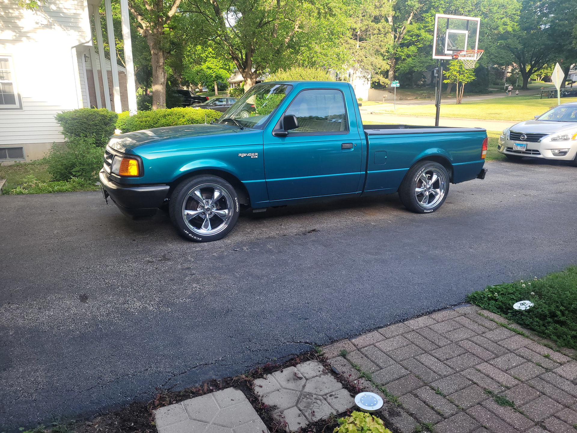

Not more chunk yet… but way lower!
Might need to re-aim your headlights tonight . . .

Looking great! With the new stance, don’t really think all that much more chunk needed. 255/45 or even 235/50 might work also.

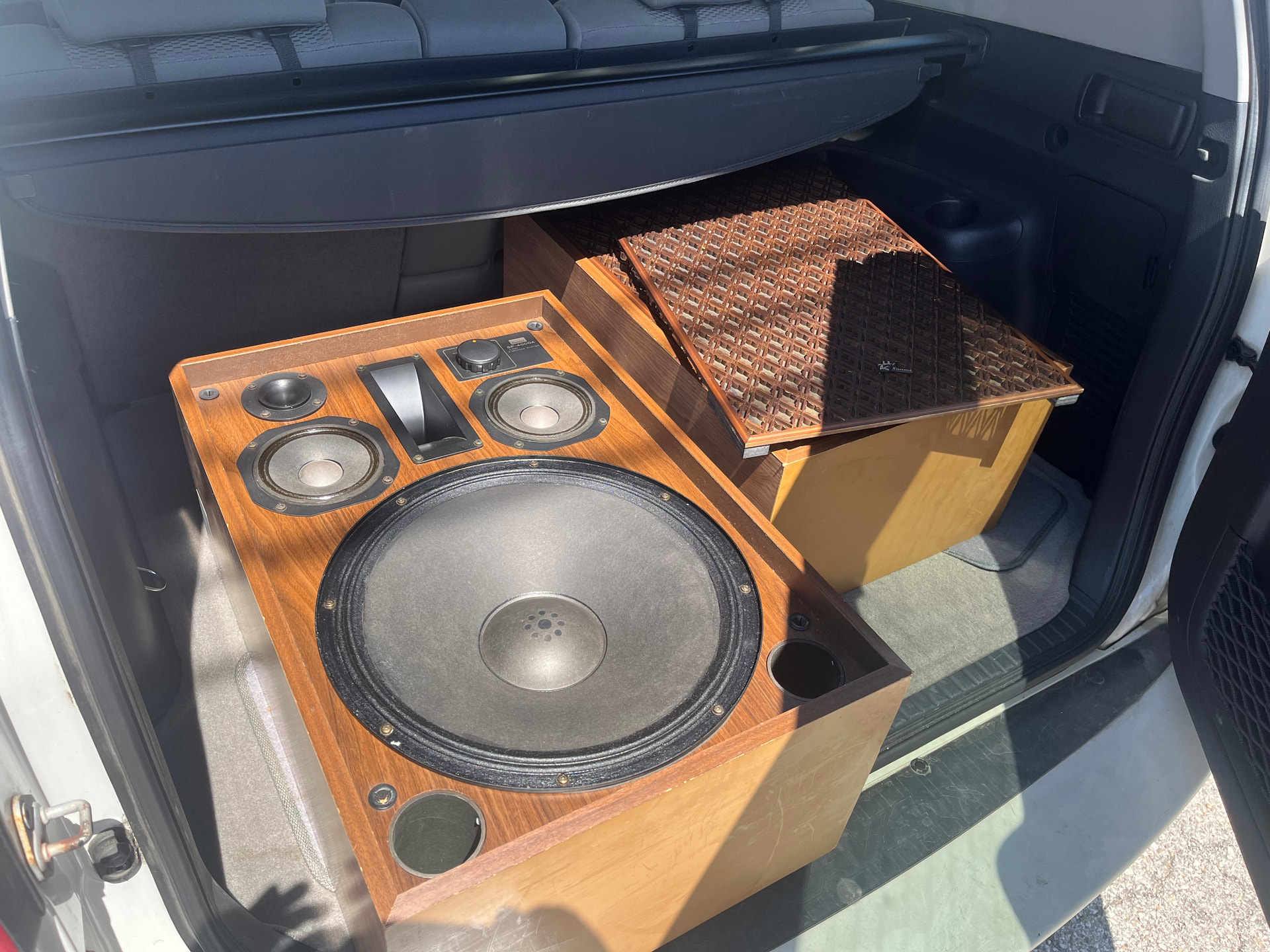

Replacement surrounds for the Sansuis. They originally didn’t have a separate surround, just a pressed edge and some doping, kinda like a guitar speaker. I was able to use some JBL cloth surrounds. FS went from 60 to about 44. Bonus, it loaded in the cab a bit better, still to small of an encloser, but whatever. They make sound again.

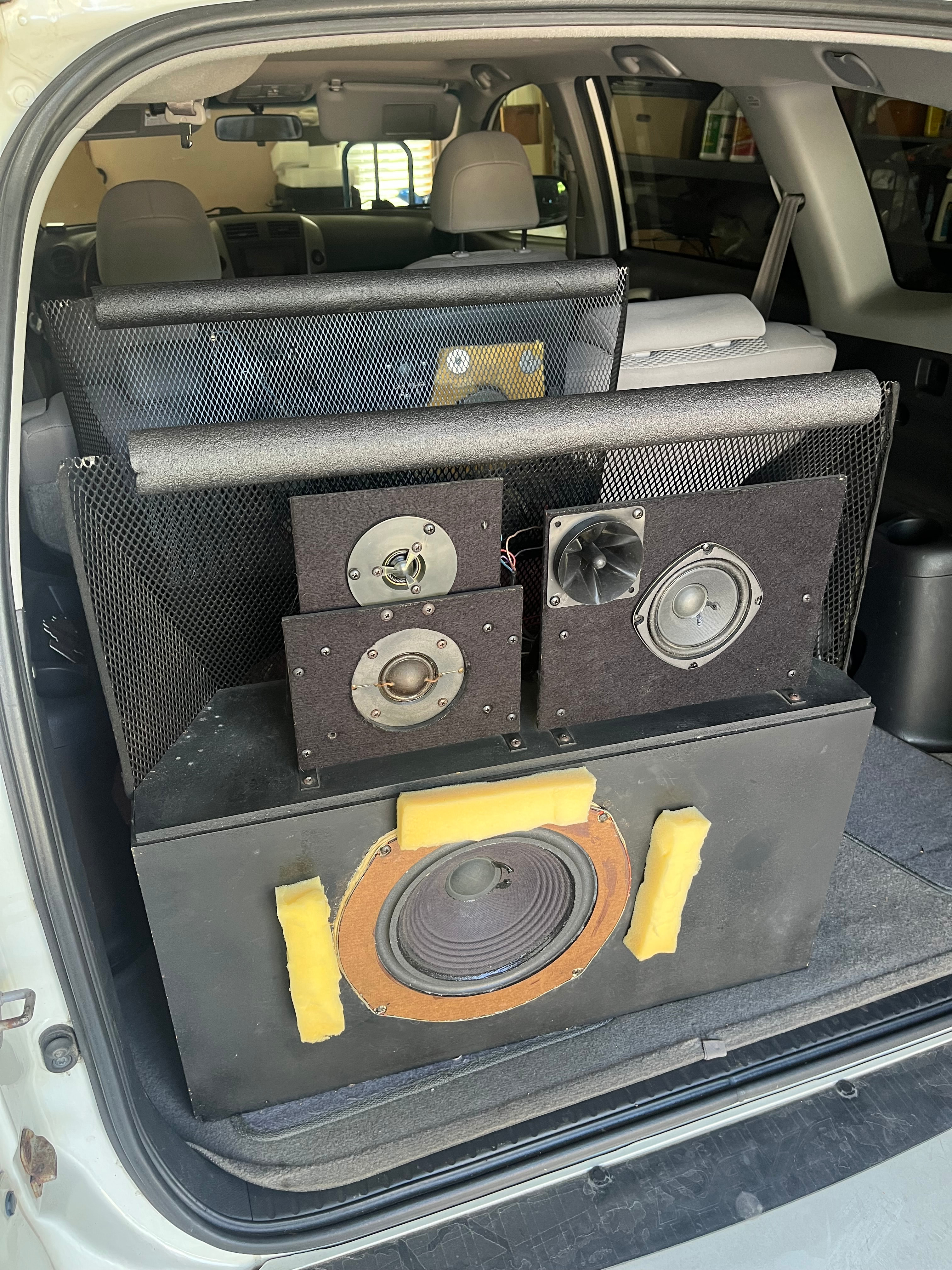

After dropped those off, I picked up a pair of Dahlquist DQ-10s. Customer said it sounds like it has holes in the frequency response.
After getting them home and doing some research, the midbasses aren’t original. I hooked them up and something is definitely wrong, they don’t sound very good…at all.
Based upon the driver alignments, I’m guessing they have some interesting directivity control going on with that design . . . (focused/narrow).
Beautiful work, as usual, Eric!
Looks like an Advent woofer…
It is, luckily they’re already refoamed.
