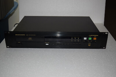

I still need to investigate fixing the Marantz Pro player I have. Mechanism is slick, no grease issues, no teeth missing on the gears. Plays fine when drawer is in position. It seems the limits may be out as it thinks it is shut or open, and needs help to get there.
I’m no repair man, but if it’s doable, I’d like to. It’s a lot like this one on ebay.
Wolf, chances are it uses an opetical sensor to know when the tray is closed. post lots of pics of the internals and I will try to help identify the mecanisma and develop a repair.

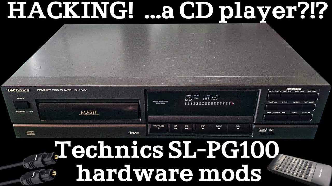

The digital out mod got my gears turning to do a little research.
It seems some brands had higher models that did have digital outs, so the capability was still there but parts were just left off the board:
If that was not the case with a model.. seems to get out in the weeds pretty quick chasing down clocks and whatnot.

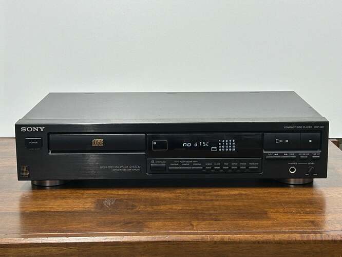

I’m not finding much info regarding my CDP-391. But the case is pretty vacant with the PCB against the front panel:
https://www.leboncoin.fr/ad/photo_audio_video/2912900701
So much room for activities that I found someone added a tube buffer :laughing:?!?
Though the TDA1543A was a standard 8-pin format, which might make things easier to figure out:
Though that converter may not work since the TDA1543A uses “24-bit right-justified” format. As opposed to the non “A” model chip’s standard I2S format. Quickly going way over my head.

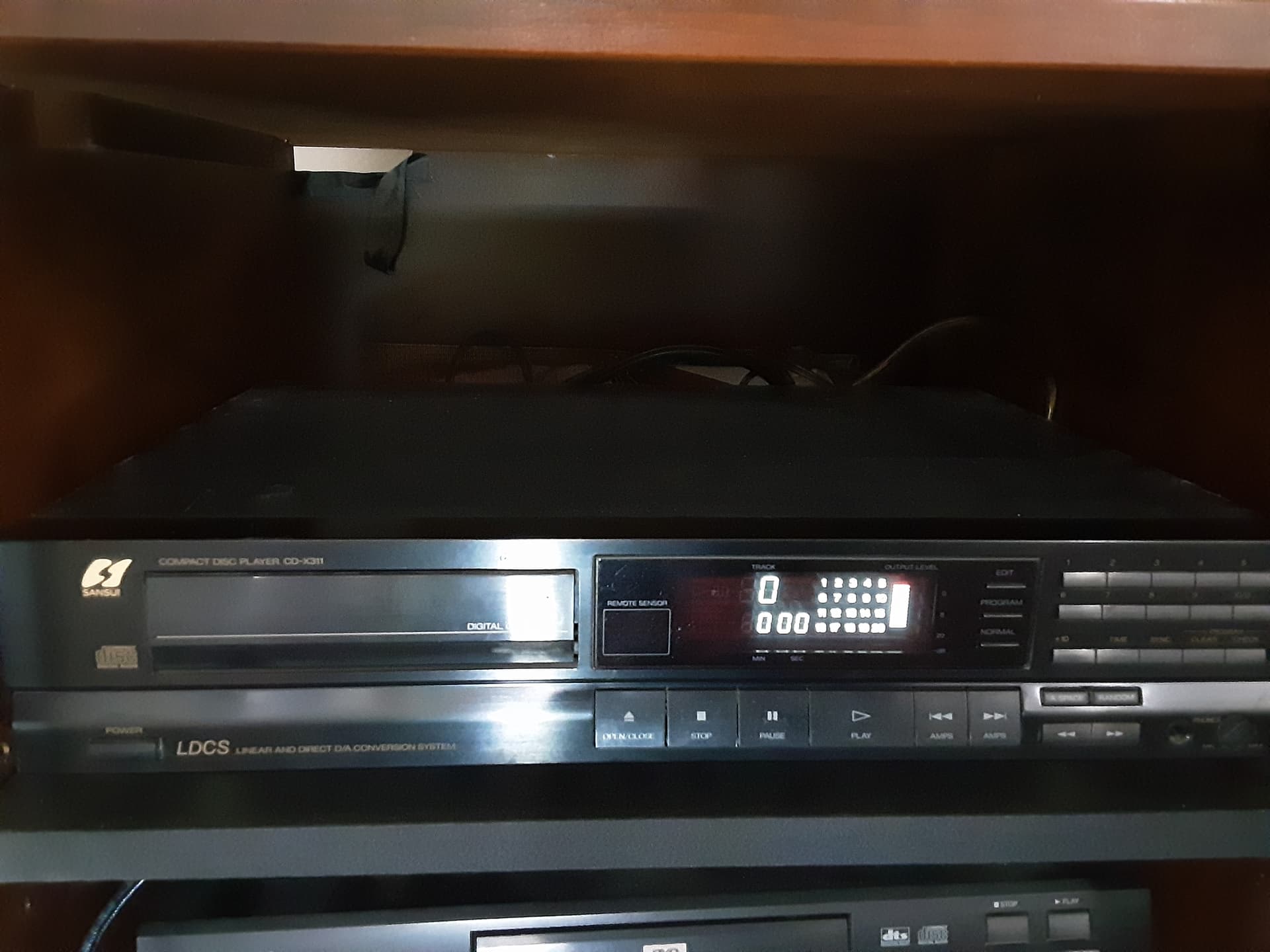

I bought this guy new in the late 80’s. Still functional.
I have a matching tuner and amplifier. Cool stuff.

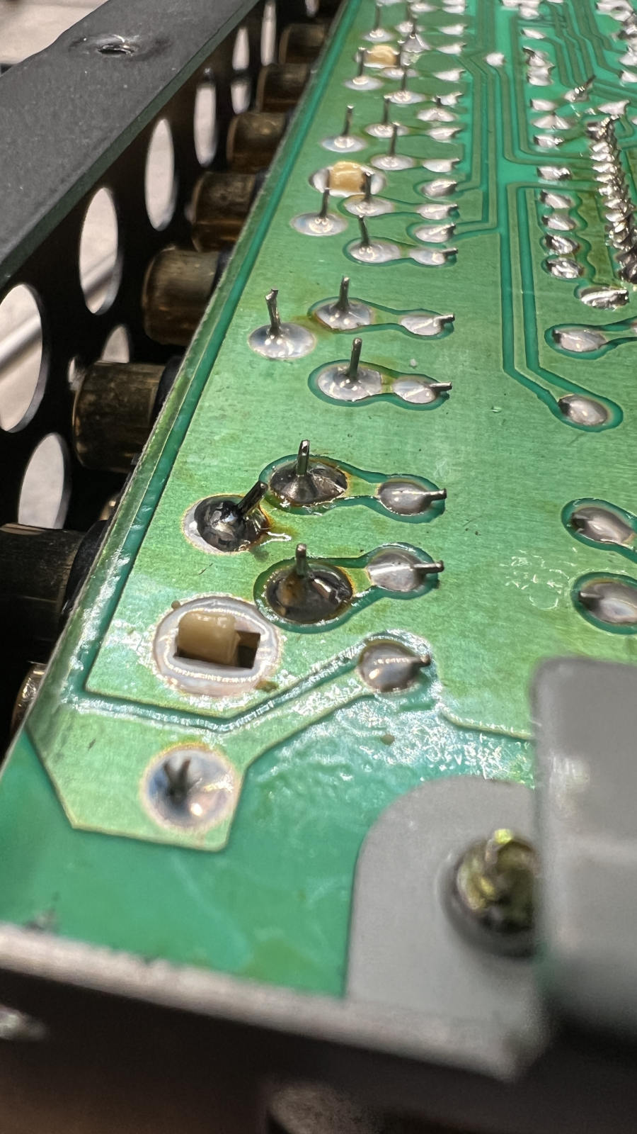

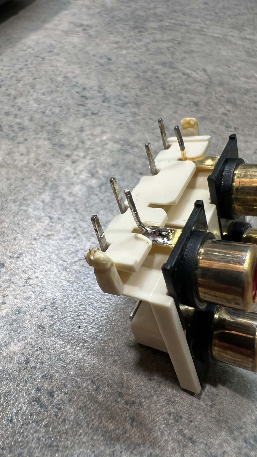

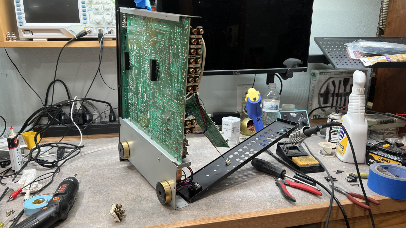

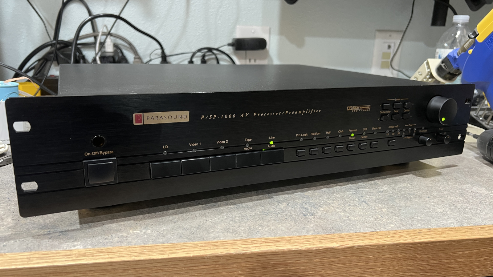

I’ve been moving a lot of gear around this weekend in the man-cave and storage room. I decided to put my old Parasound preamp back into service. These came out in ‘95, so I guess it qualifies as vintage. I plugged it in and it sounded like the main L&R channels were playing the surround signal. To the bench it goes! I expected to find a scrambled processor chip, but I got bursts of normal stereo just moving it around on the bench. Turns out the RCA jacks for the Line In and Front Out both had sheared ground pins. That was creating an unintentional Hafler surround circuit. 28 screws and a little soldering - it’s fixed and sounds great again.
I only found the actual problem when I noticed the ground pin was floating around when I reflowed the solder connections.
Good job Tom! One thing I have found helps with longevity, clean ALL the flux off the board. I use 99% IPA. There are some cleaners made specifically for flux that works even better but it is a bit pricey.

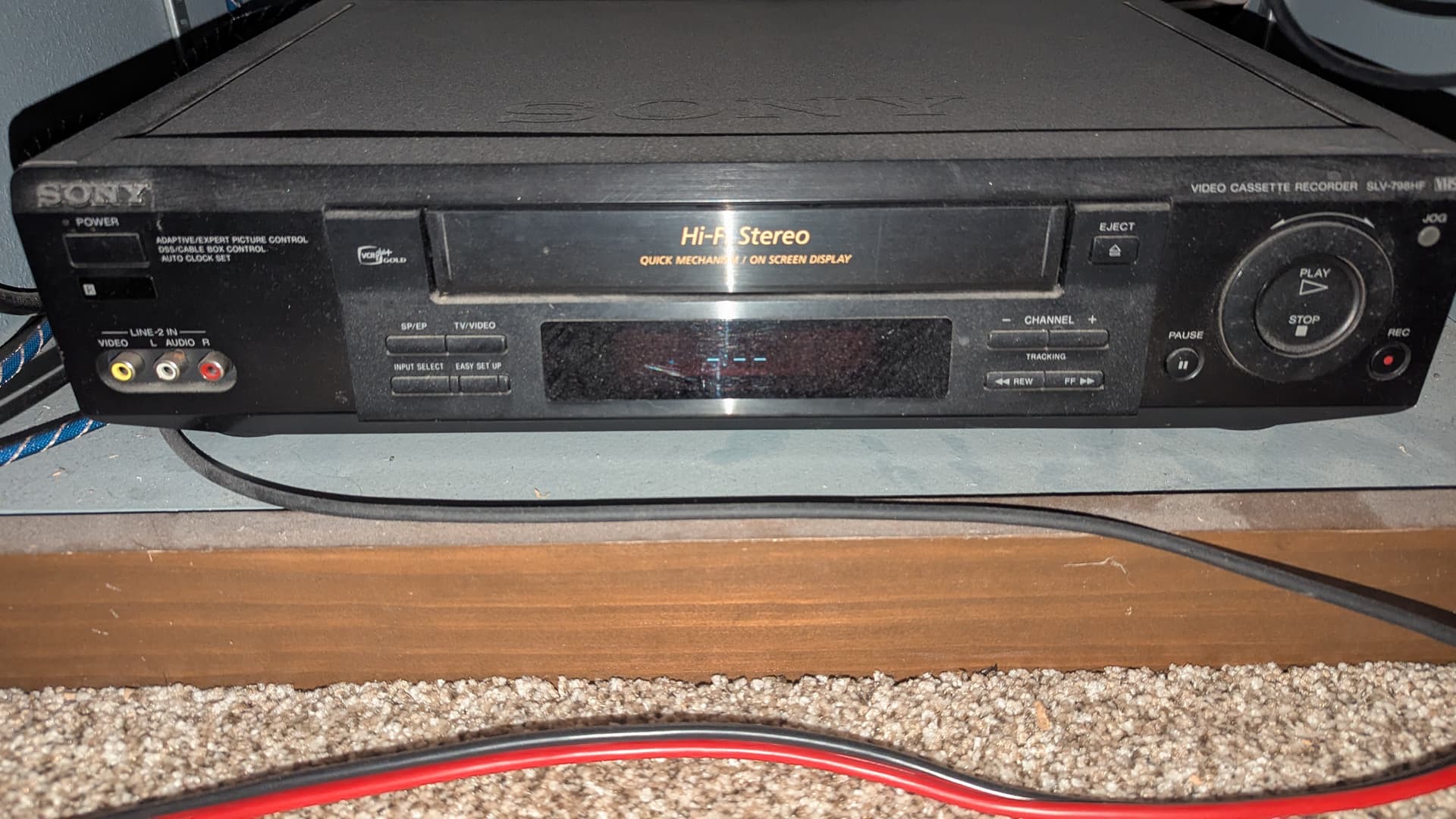

Not a recent find, but a sweet old school VCR nonetheless. VHS upscaled to 4K is not the greatest viewing experience however.
Sorry about the dust lol.

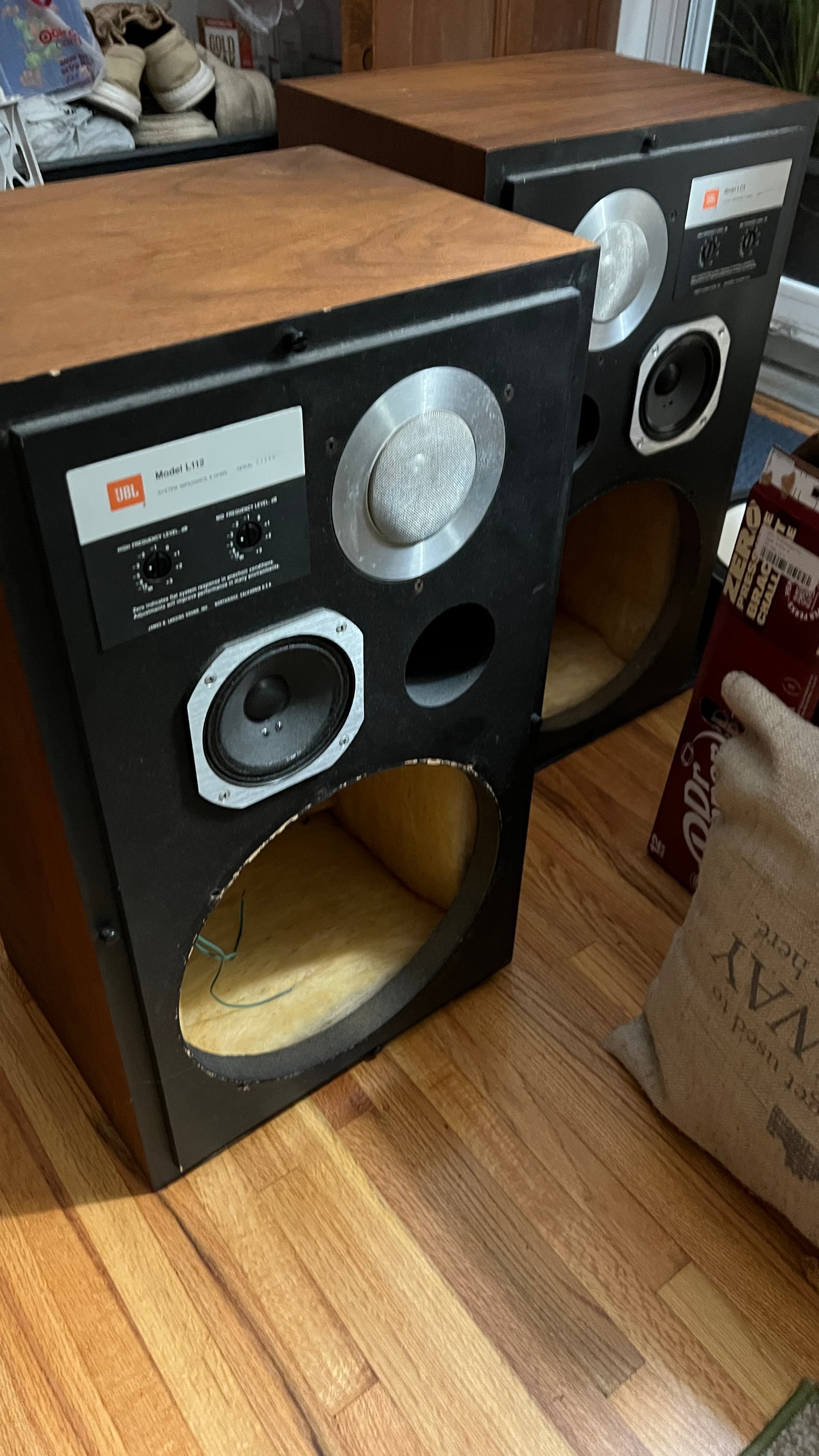

I’m getting to the age where I’m finally letting some of my vintage gear go. My buddy TJ had been dropping hints that he wanted first dibs on the JBL L112s that have been taking up space in my listening room for years. He’s found some great pieces for me and I know he’ll give the JBLs a good home, so I let them go for a bargain price.
Plus, these turned out to be a decent investment. Paid $75 for them and got 10x that after 19 years. Everybody wins!

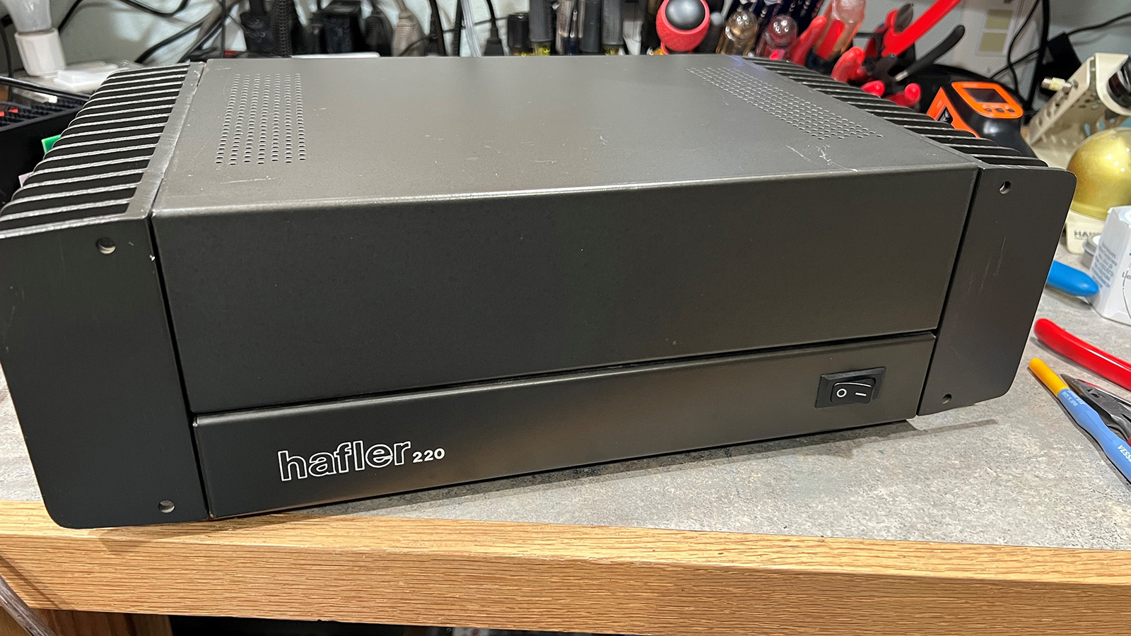

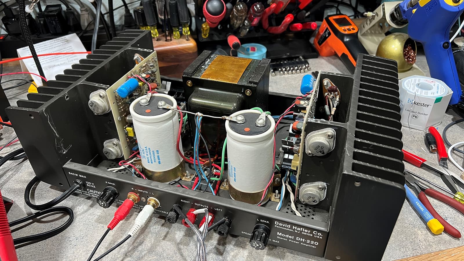

I picked up a nice old Hafler DH-220 yesterday. It showed up on ShopGoodwill at our local store and I couldn’t resist. I’ve always wanted to see/hear what all the hype was about with these amps. I wouldn’t say it was a super deal, but much better than what you pay on eBay. It just needed a new power switch. The Nichicon caps on the boards are dated 1981. I think the RCAs may have been upgraded, but other than that it looks original and clean inside.

Can’t say anything bad about my DH200👍🏻
Looks like someone already swapped the RCAs. Luck dog you!!
