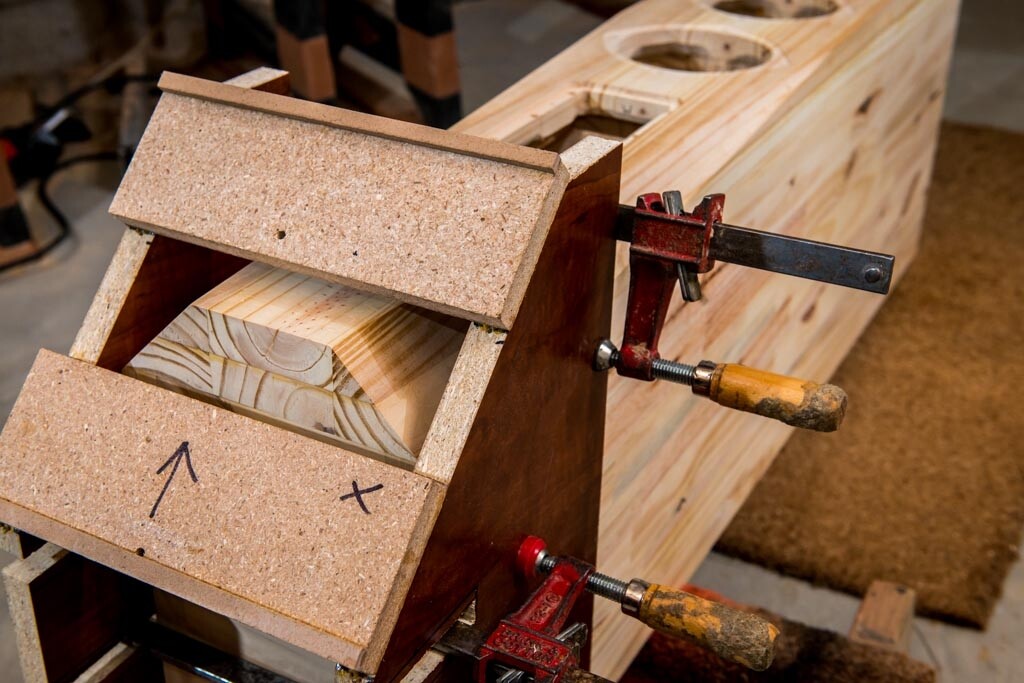

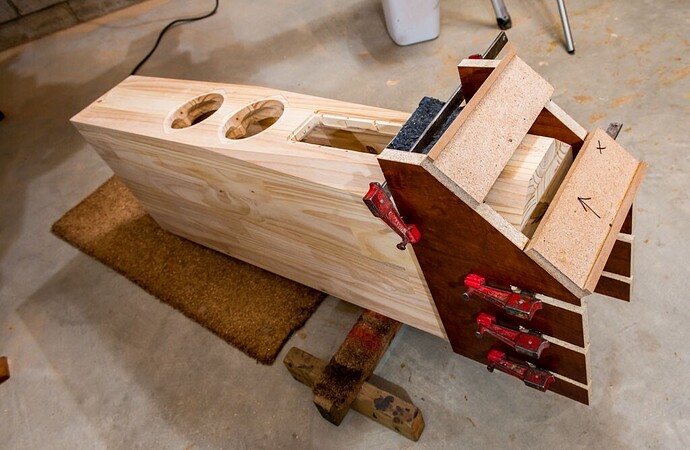

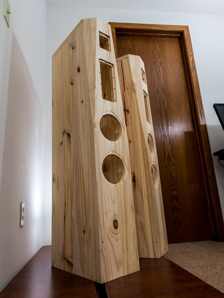

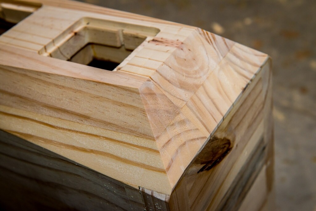

Ani, back in 2018, I built a pair of @ScottS 's Matrix Revolution speakers. I decided to modify my rendition with facets on the top and sides of the baffles. My fixture for the top baffle edge facet looks very similar to the fixture that @raddon is using above. It just clamps to the sides of the box to create a platform to guide the router.

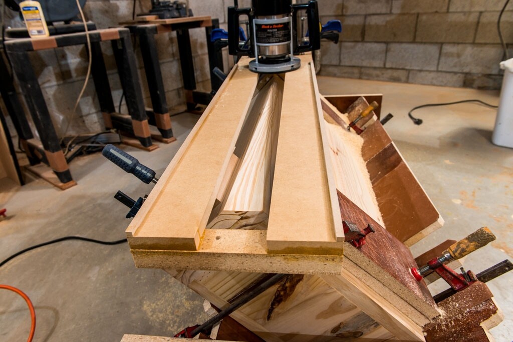

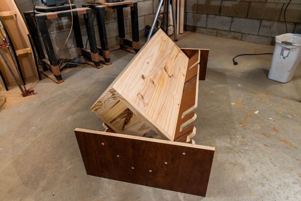

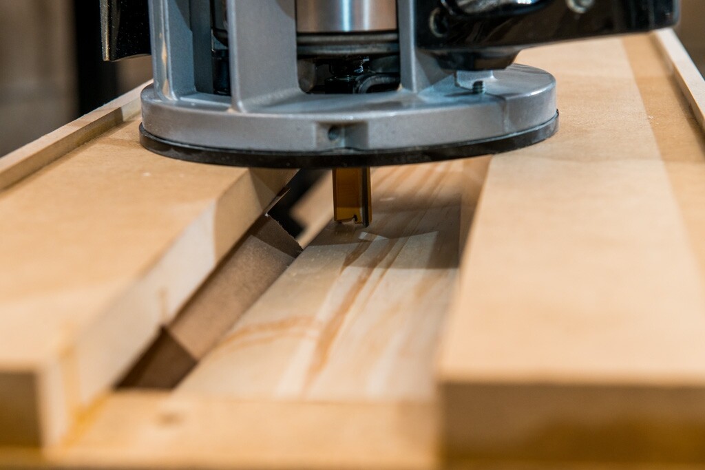

I also built a two part fixture to cut the longer facets along the edge. The base fixture holds the speaker at a 45 degree angle. A long sled is clamped in place above the base to provide a platform to guide the router.

I saw and studied your jigs.
realized that my side clamped guides needed to have deep slots for the clamps!
Thanks Don, Bill. Bill, the idea of cutting slots is greaat, allows the clamps of really hold tight, else only the edges might be gripping questionably!
