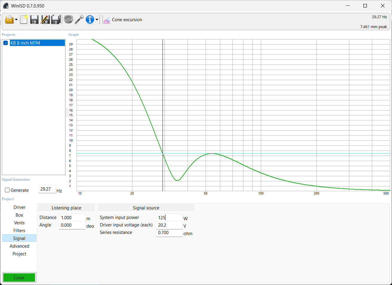

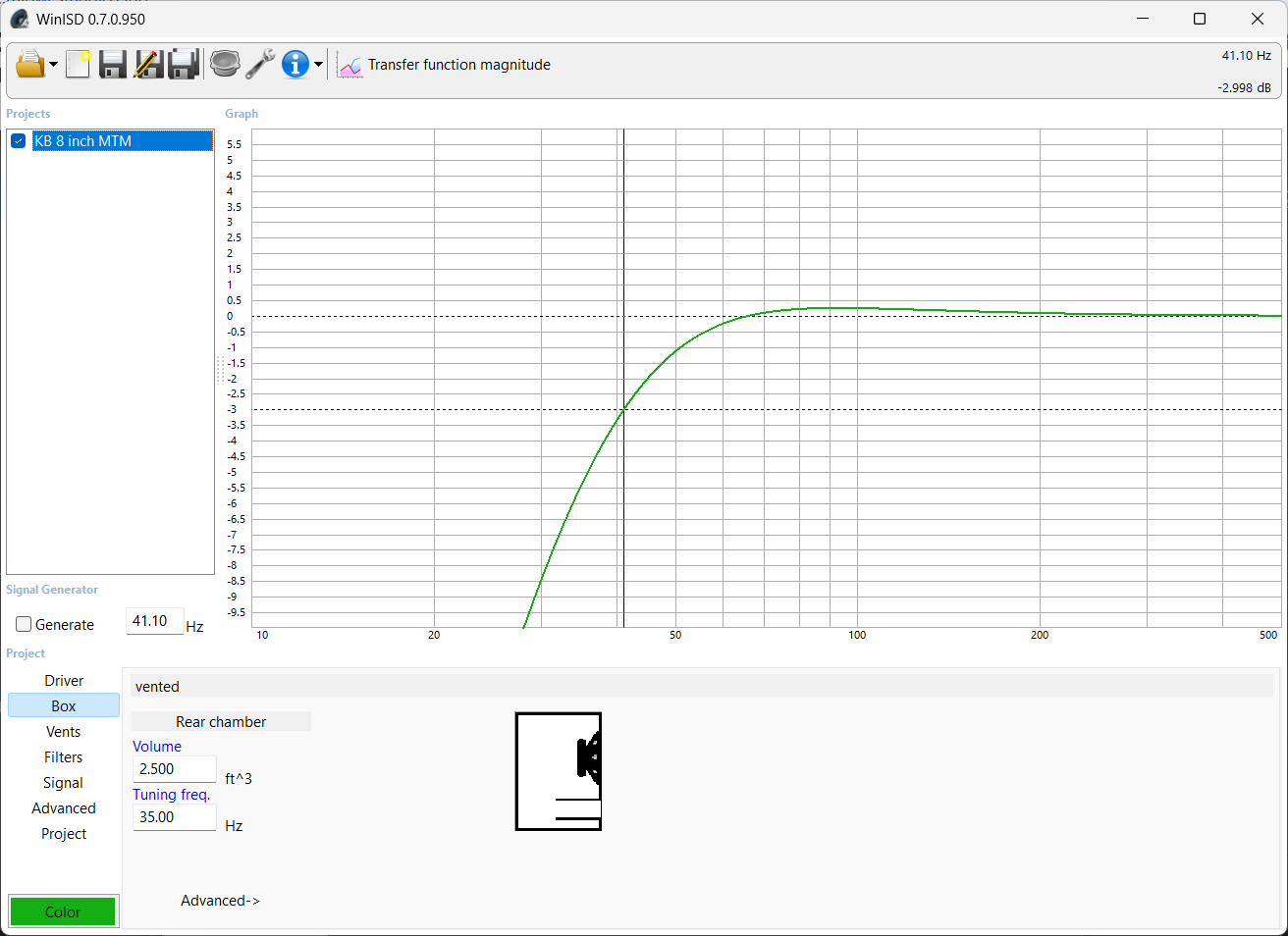

2.5 cubes with some added series resistance…

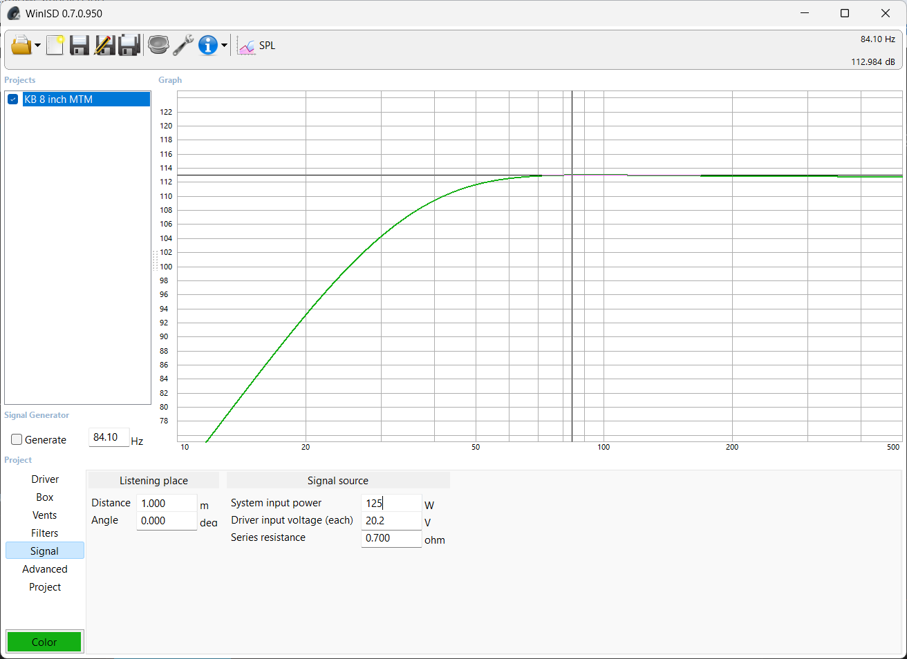

With 125 watts applied it doesn’t breach Xmax until below 30Hz:
At which point it would be playing extremely loud (107 or so db after baffle step loss):
For the majority of music these would be fine for cranking to 11. For the rare content below 40Hz, subs would be needed but you would need monsters to output matching SPL from 20-40Hz. Multiple 12s I imagine would be barely sufficient. Or just enjoy the overhead these speakers would offer.

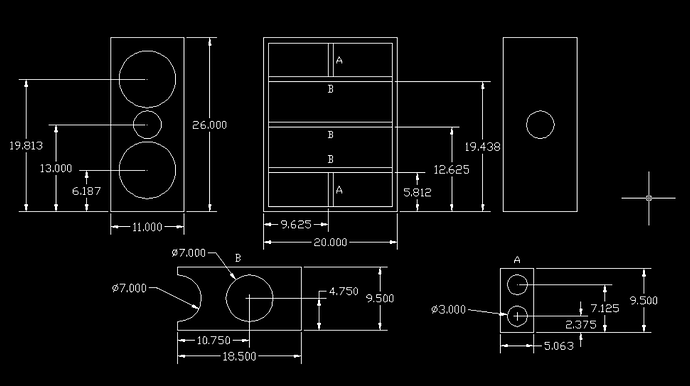

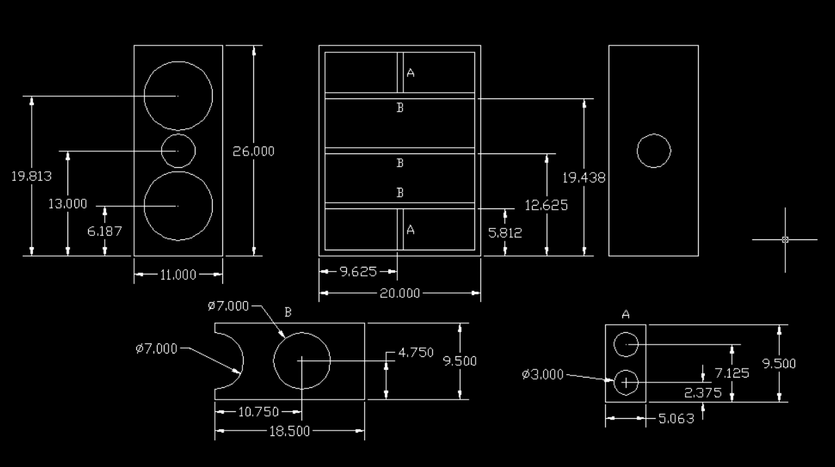

I am in process of doing some cad work for a stand mount MTM rather than a tower. Maybe I’ll do the tower and Nick can do the stand mount.
Will be a big, heavy cabinet. Take some serious stands.
At 20" deep that’s a doozie. Depending on the situation, some may favor that massive stand mount over a hefty tower though. Sitting atop twin subs perhaps?
Me personally, 20" deep is a bit ridiculous. That’s just fighting the fact it needs to be a tower.

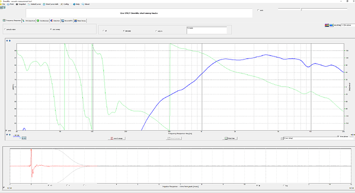

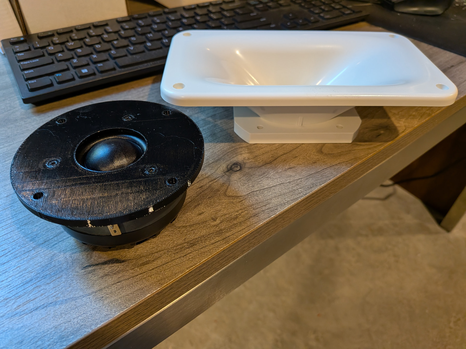

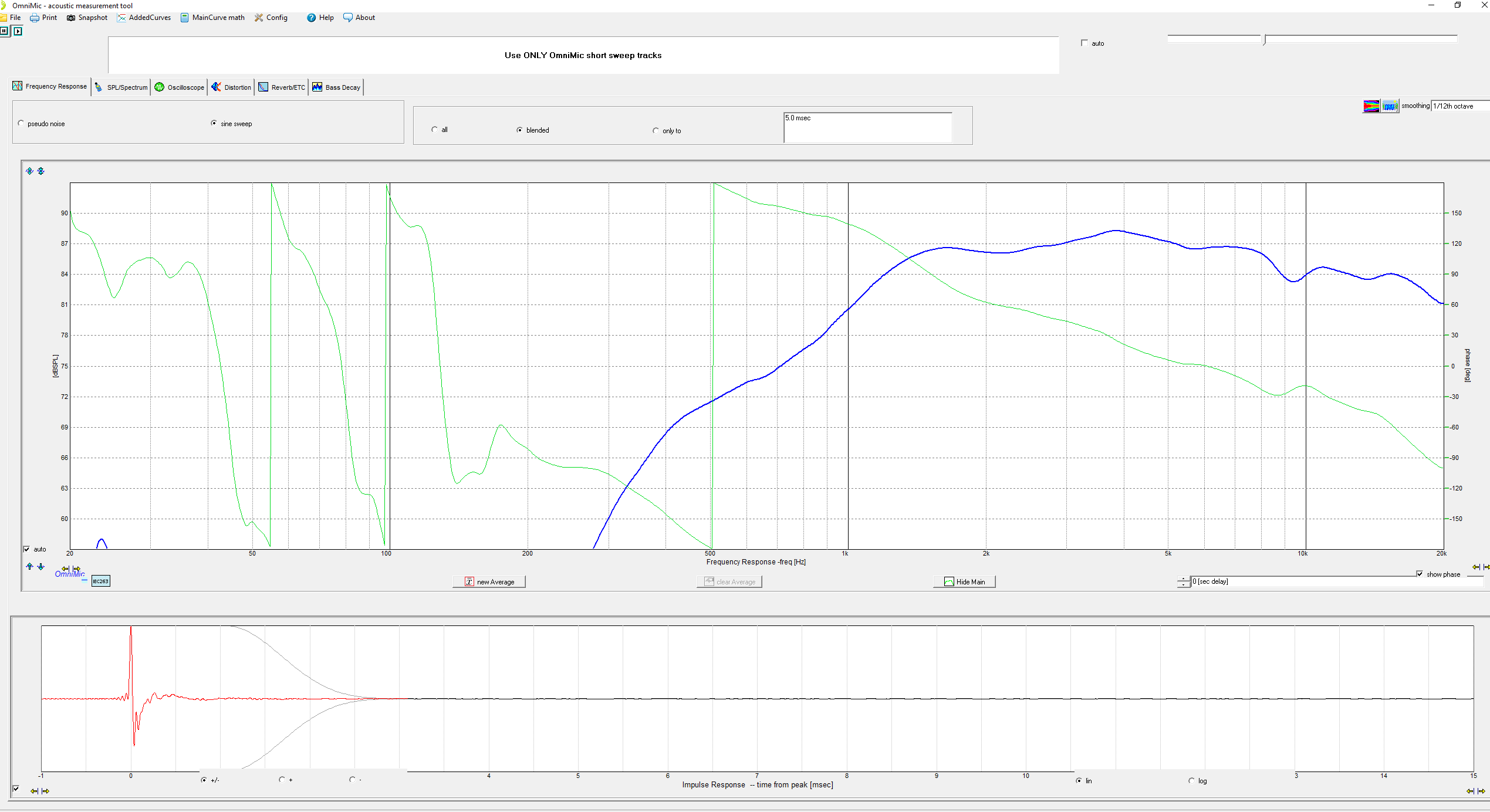

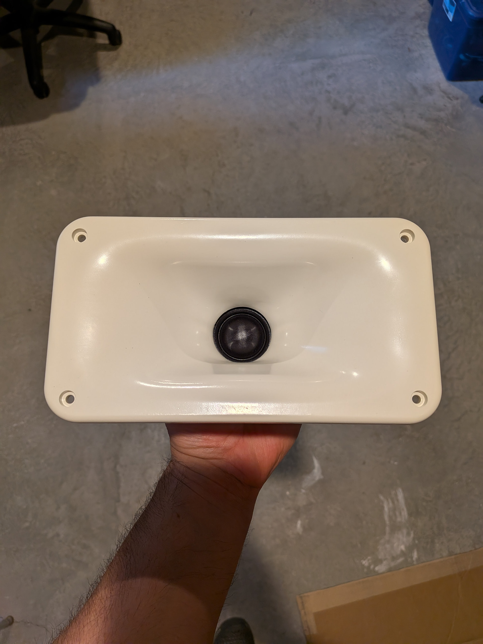

Here is the TW030WA05 with and without SEOS. Green stock and blue with SEOS.
Looks like a throat resonance at 9.4kHz…8.2 uF cap in series
