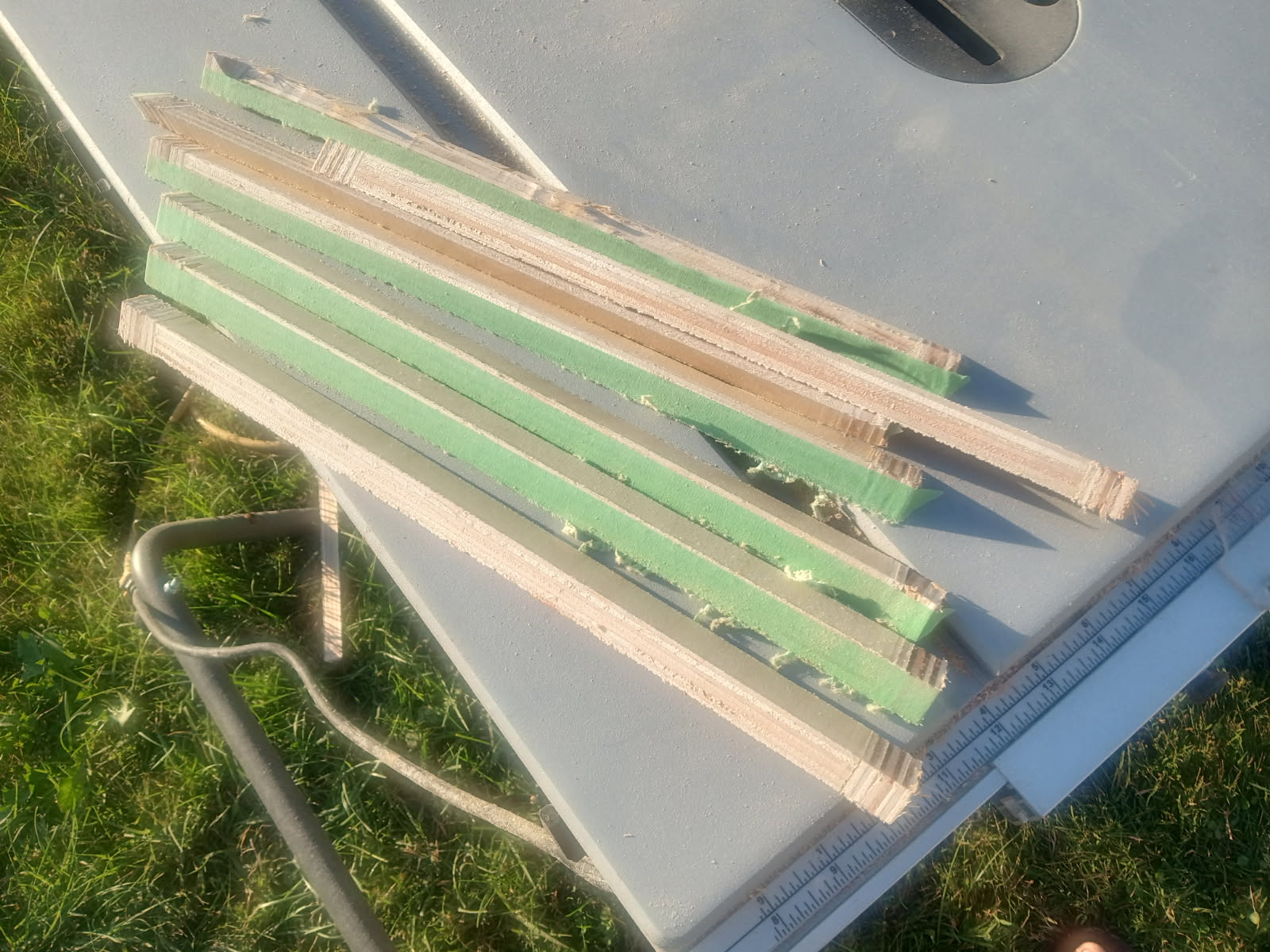

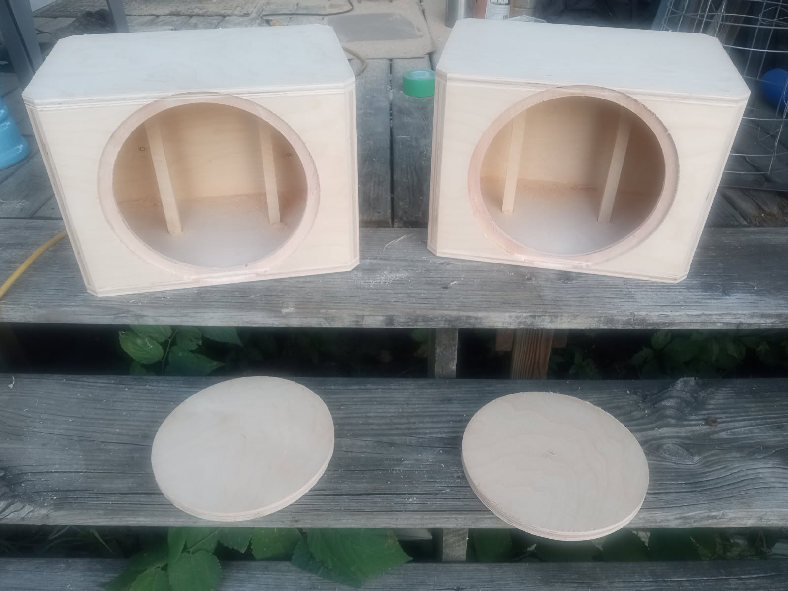

Table saw went better. I was able to trim the bad spots off by going a little past 3/4".

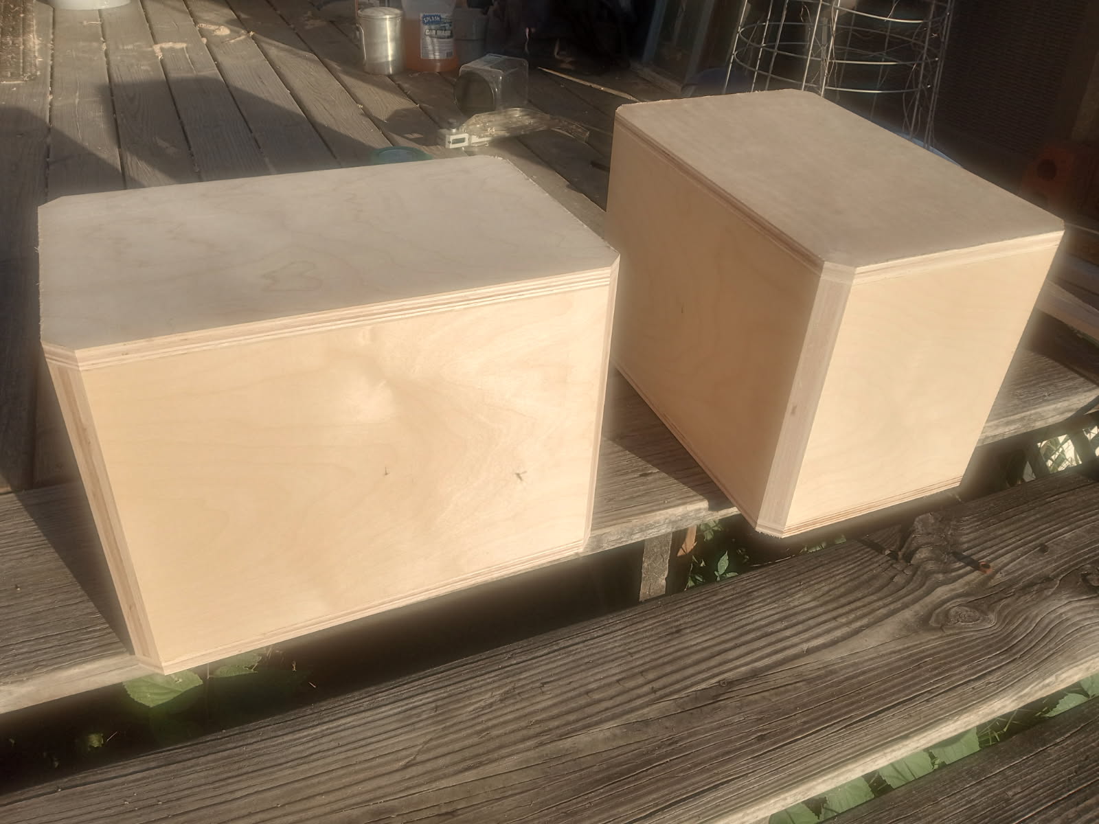

If you didn’t pick up on my earlier hint (dimensions), these will be oriented horizontally.

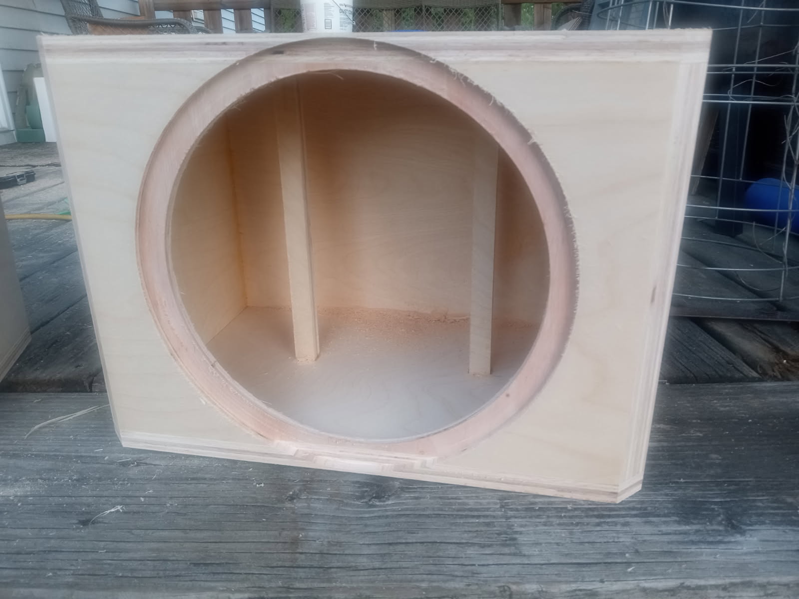

Hot off the circle jig:
Yes, seems a rather impossibly large cutout for the size of enclosure. Maybe I should have called them “Shoehorns” :person_facepalming: (foreshadowing?).
I plan to try out a design philosophy that I’ve had at the back of my head for years. One that seeks to maintain sensitivity by baking BSC into the design. It employs a combination of 1) selecting a woofer with a natural response rise towards the LF region. 2) Use a large baffle to reduce the baffle step frequency range. 3) Employ a high Q enclosure alignment to boost the region below where the rising woofer response tops out and begins to fall off.
Obviously I’m a bit limited on the baffle size though.

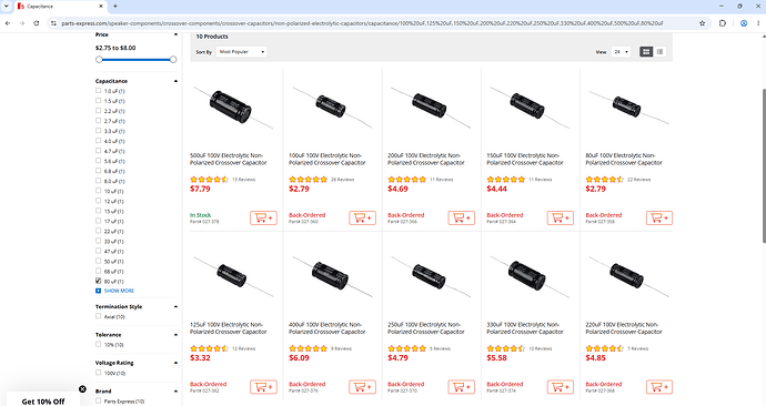

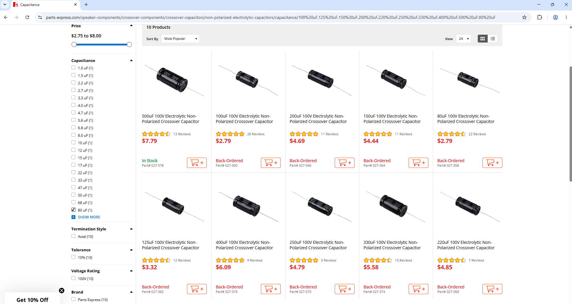

Harrrrumf! I was going to suggest a few of these in parallel to hit your goal capacitance… but it seems all the large size NPE caps at PE are out of stock :frowning:
https://www.parts-express.com/250uF-100V-Non-Polarized-Capacitor-027-370?quantity=1
500’s are in stock, to bad Jule doesn’t have any.

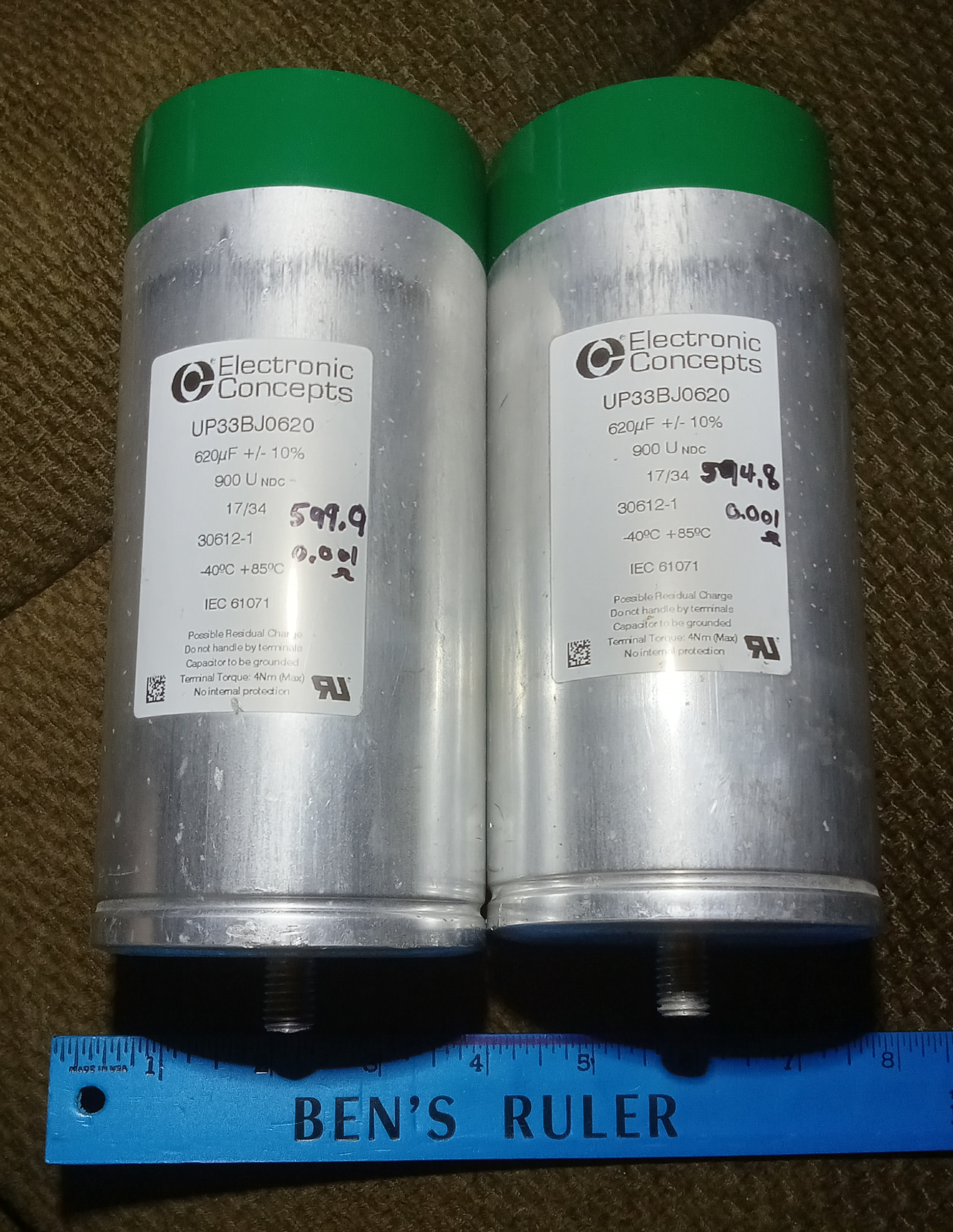

If it makes you feel better you can parallel a poly for part of the value. Since most applications like this take 200uF or more depending on cutoff and impedance load, there is room for adding to make value.
You don’t have to get something like these film 600uF monsters:
These were on ebay for about $56 each. List retail is a LOT higher. Last I knew or looked, a 200uF Solen costs about the same.
Javad used the PE NPEs on the Omegas’ assist circuit, FWIW.

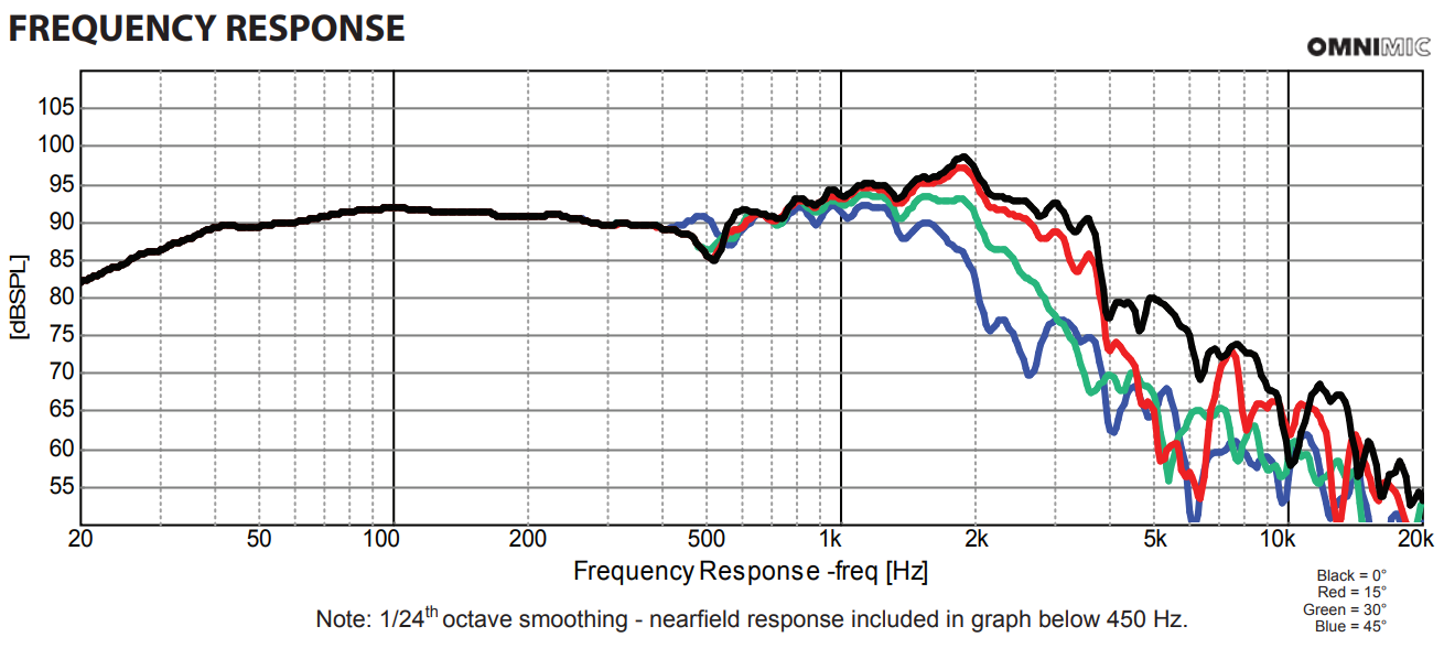

I guess I’ll reveal the woofer then: The “new” GRS Poly cone 12" (4ohm)

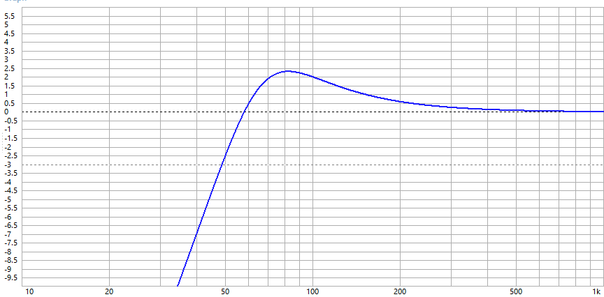

It appears to have the natural LF rise in response:
And in this enclosure it would get a QTS of around 1.186. F3 just under 50hz (.5ohm coil dcr added, note .5db increments) Though the F3 may actually end up in the mid 50s if the Q bump becomes the true response knee:
For the current price It ain’t playing around. I’m pretty sure I measured 6.5" Dia on the magnet. It might be bit of a handfull to cross in a 2-way and get sounding OK, judging by the response plot and resonances seen in the impedance plot. But I’m game to give it a try.
The baffle step midway point should be somewhere between 250-350hz just based on baffle dimensions. Not factoring in any other… additions. So hopefully that is low enough for this all to play a notable roll in.
Qms is only 3 on this woofer. And I calculate a Cmes of ~900uF if it is Mms / (BL)^2.
