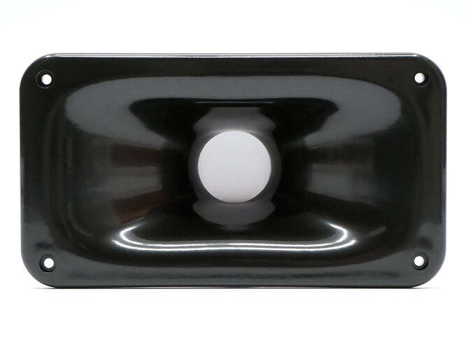

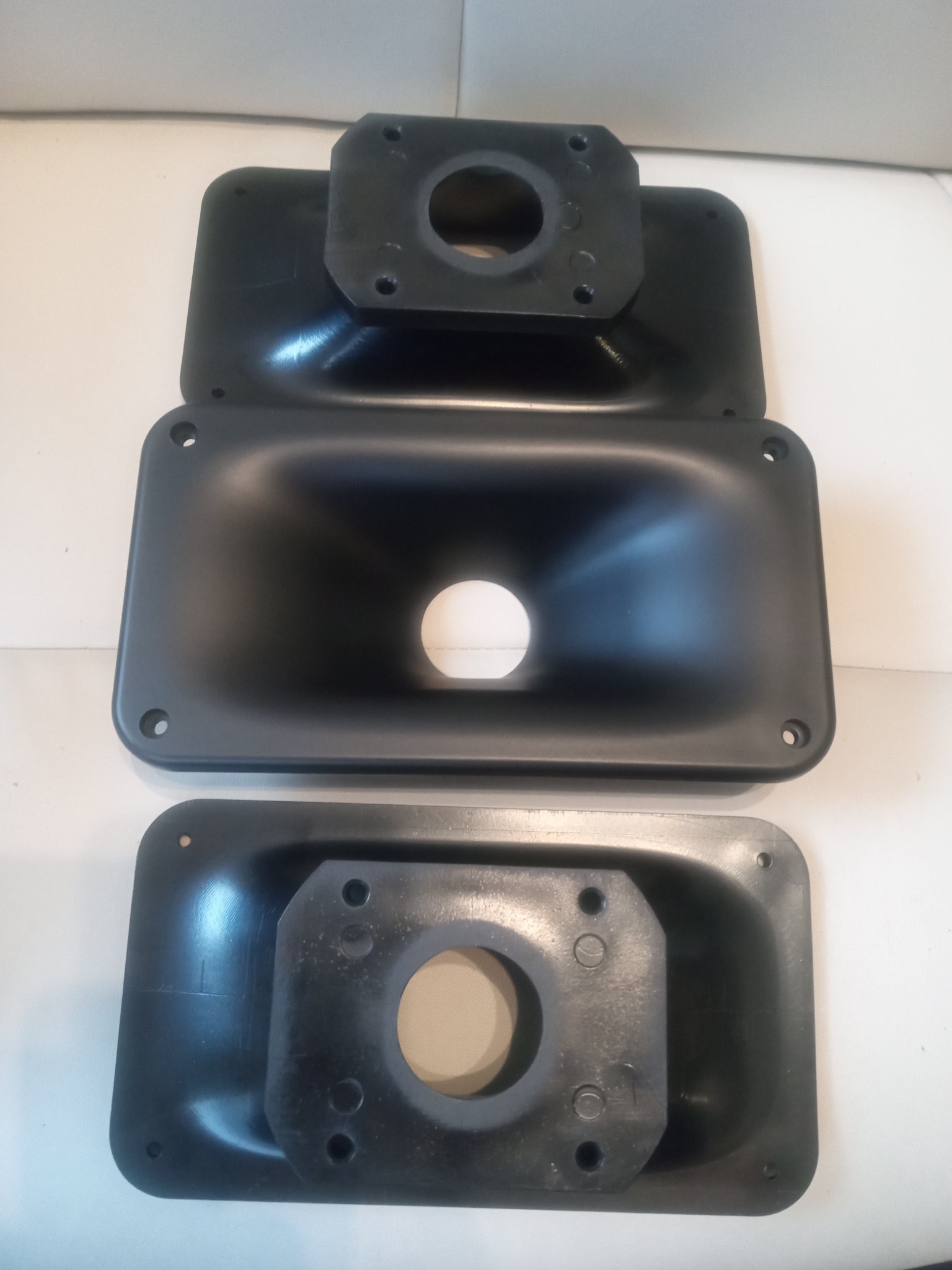

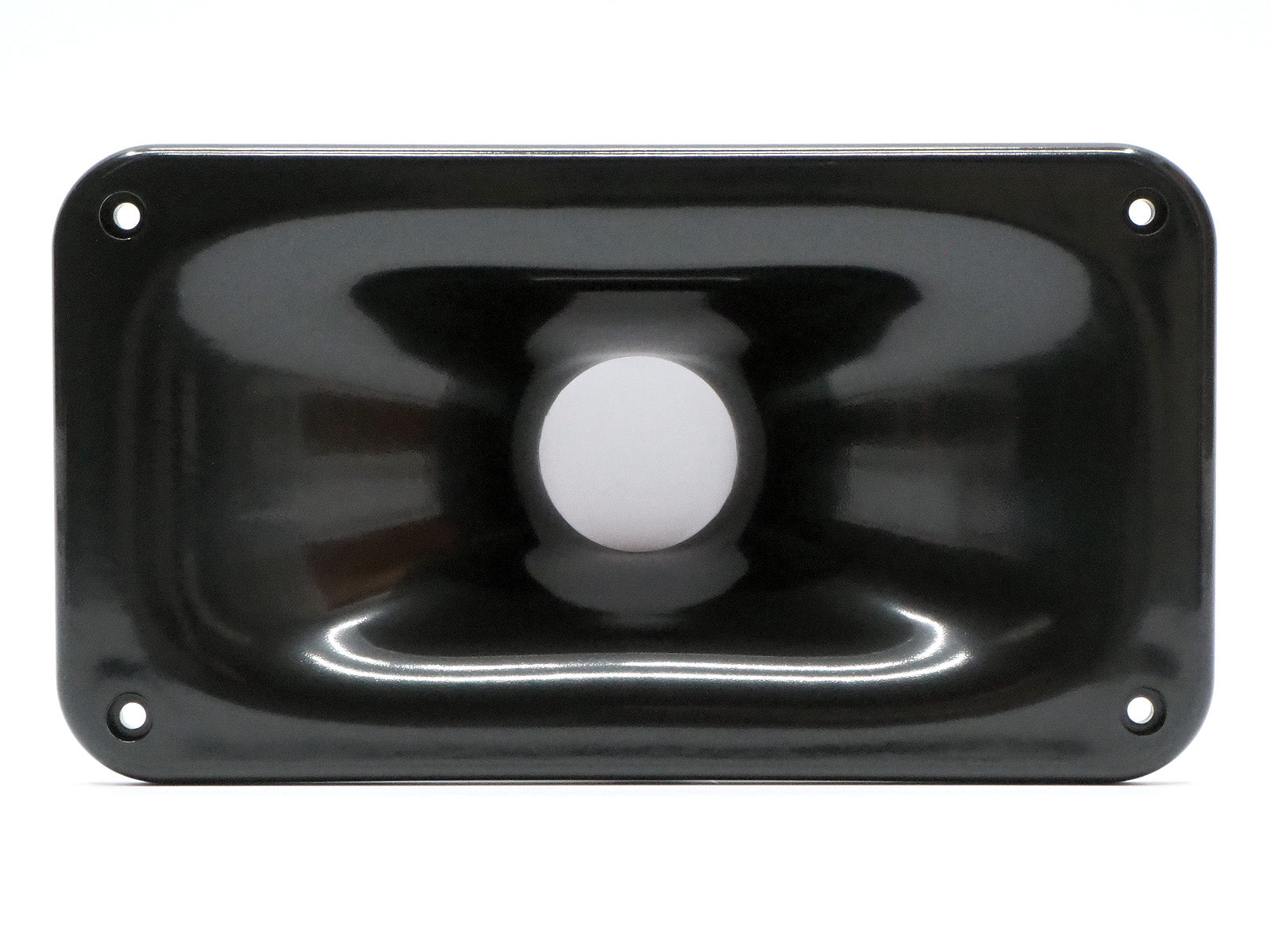

I picked up a pair of the SEOS-838 waveguides from Cinergy. I didn’t have a specific project for them in mind at the moment, but I’m sure I can come up with something :laughing:. 38mm throat intended for dome tweeters.
These things are super chunky! Very thick material. 5/16" outer flange. 3/8" driver flange. They gave the driver sealing surface a light sanding, and did a good job cleaning up the throat. They only listed glossy finish ones, but sent satin finished ones. No complaint from me, I prefer satin anyway. The dimensions seem a little larger than they list (~8 5/16"W, 4 9/16"H, 2 1/8"D)

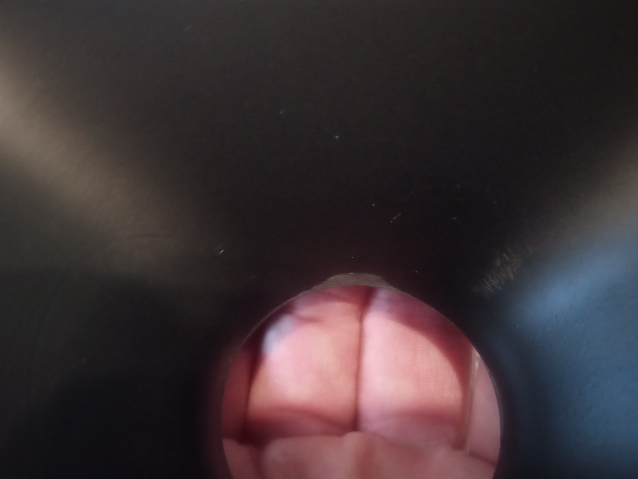

Showing the cleanup done on the throat:
Cinergy threw in a 3rd one with a note “I added an extra for experimenting”. I’ll use it for testing out different tweeters/mounting. But once I’m done with it I’ll probably bring to InDIY for anyone else interested to use as a test mule.

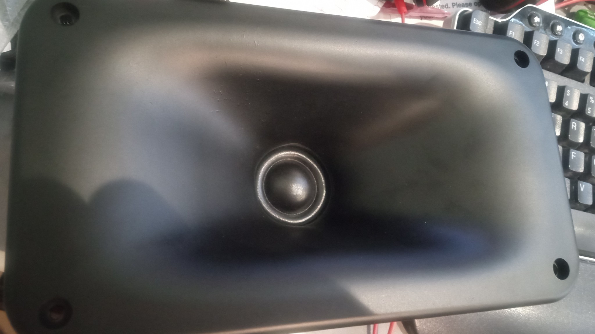

Looks like the screw holes line up well enough with the 3dprinted adapters that beastmode or nip ring would mount right up. I need to get some hardware.

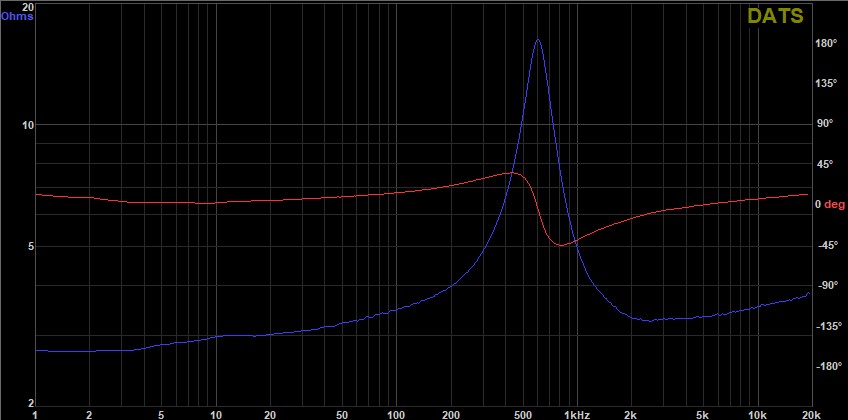

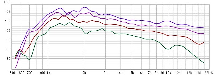

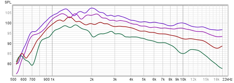

Got some quick measurements. DX25BG60-04 with the 3Dprinted adapter. I just plonked it on the carpet with no baffle. Aimed the mic down ~2ft away and guesstimated angles (roughly 0, 15, 30, 45)
I bet on-baffle, alot of the squigglies would clean up quite a bit.
How low are you planning to cross? 2k looks really good till 30Deg, maybe a bit lower too.
Beastmode ftw.
The one time I used this tweeter, the notch that I used to squash the resonance peak seemed to dominate. It wouldn’t let me cross below ~1.8k, though I ended up ~2k. That was probably due to the Q of the notch (width of range of influence). If I made it narrower that would probably allow lower crossover IE: Filter shape more like a spike, rather than a mountain.
I don’t know that I’d get 1khz out of it. ~1.5khz would probably work with anything I’d need it for.

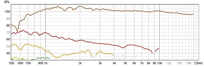

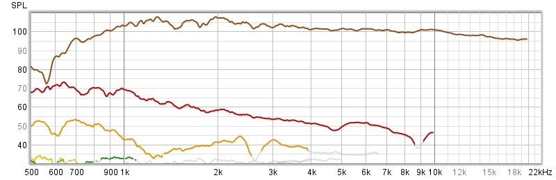

I went back through reviewing measurements and mulled over the distortion on these a bit. The HD3 is rather telling; dropping down to a low point at 1.24khz. If you can get a highpass down that far, looks the tweeter would give zero effs.
DX25BG60-04 is ~$35 right now. And the SEOS-838 is ~$20. So I supose the question is: Would there be better options for $55 if you also needed a low crossover?
