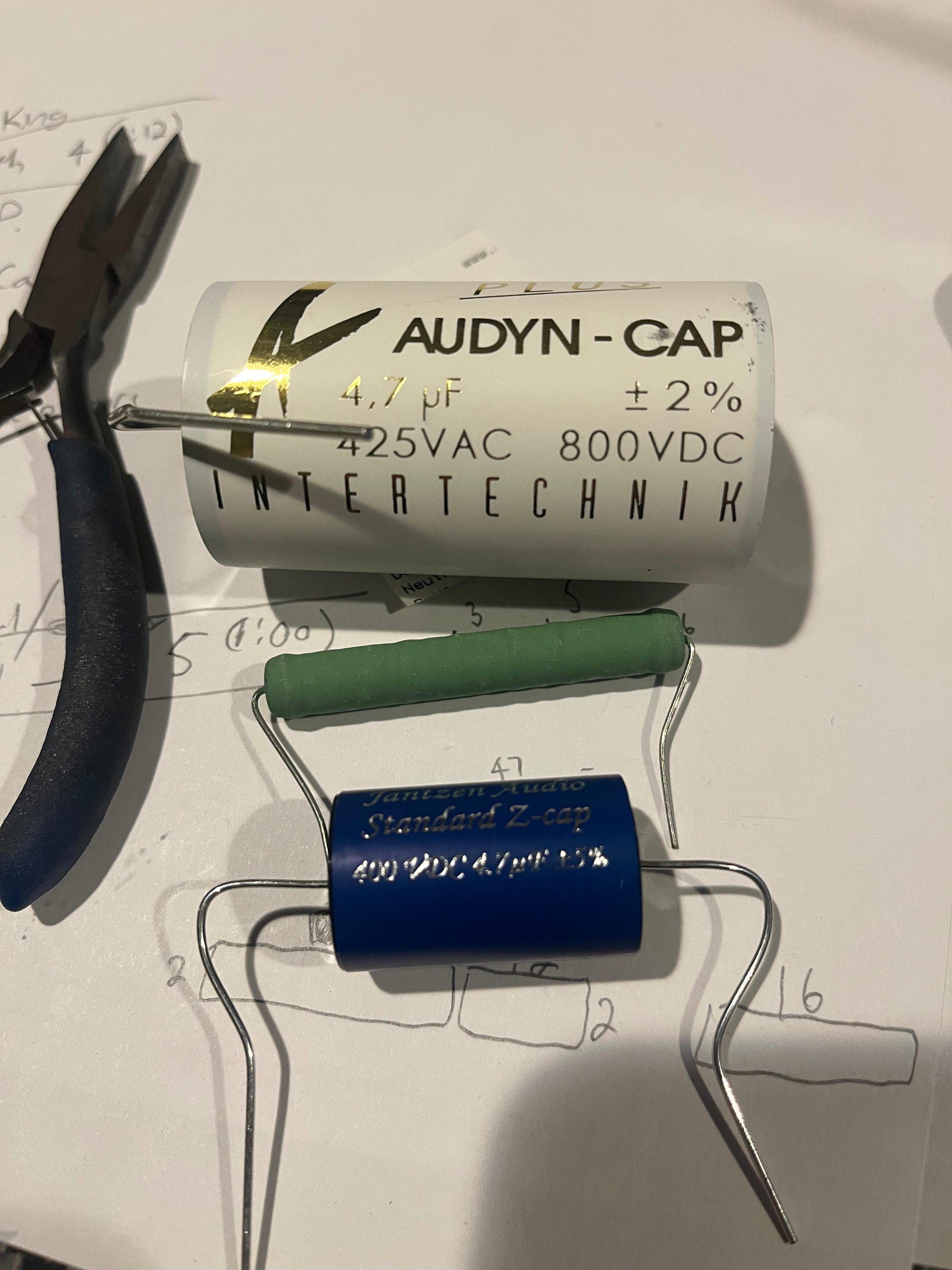

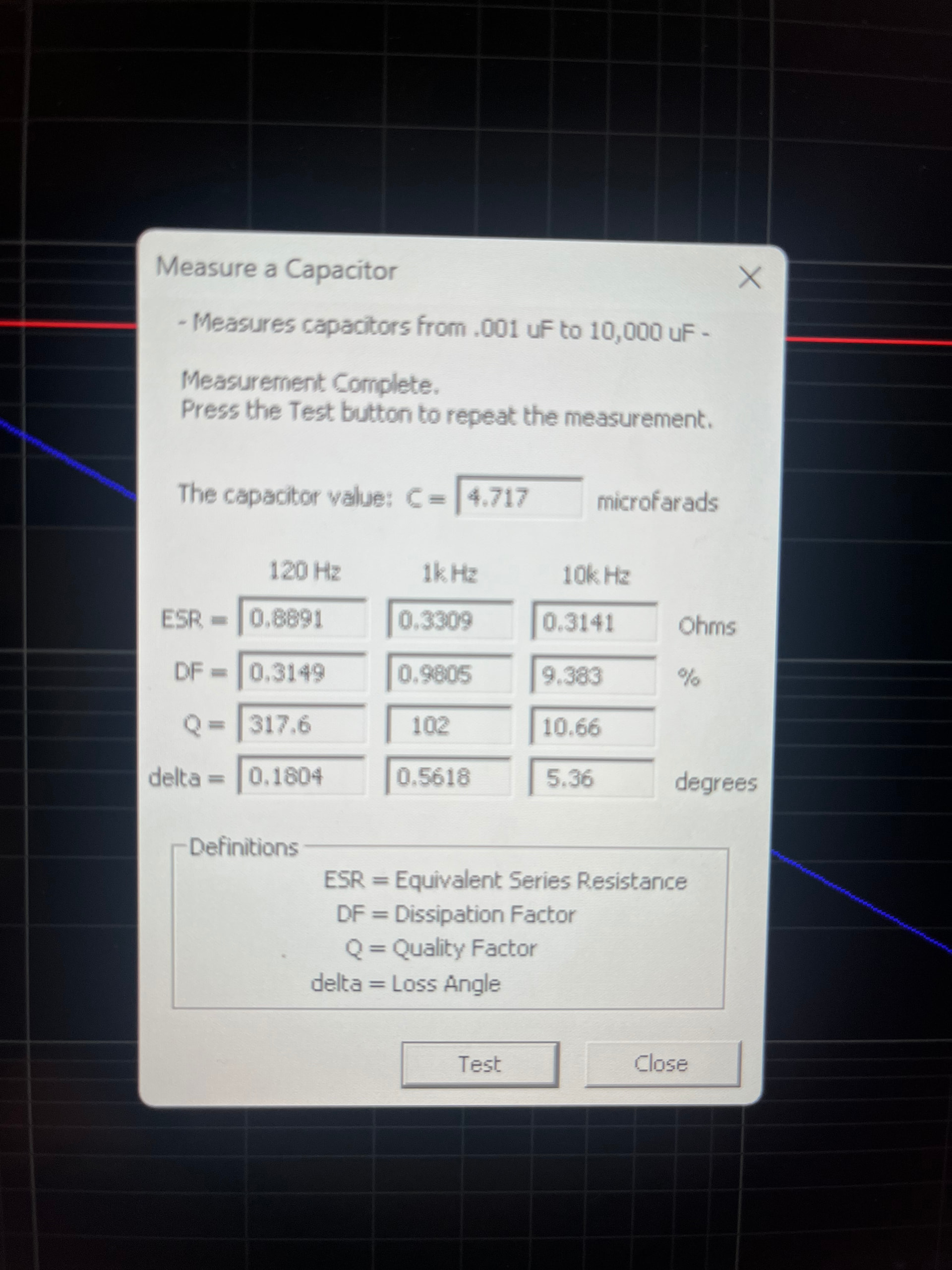

I don’t know anything about the ESR. For the polys, would you expect 400v to have less ESR than 250V, which would be less than 160V?

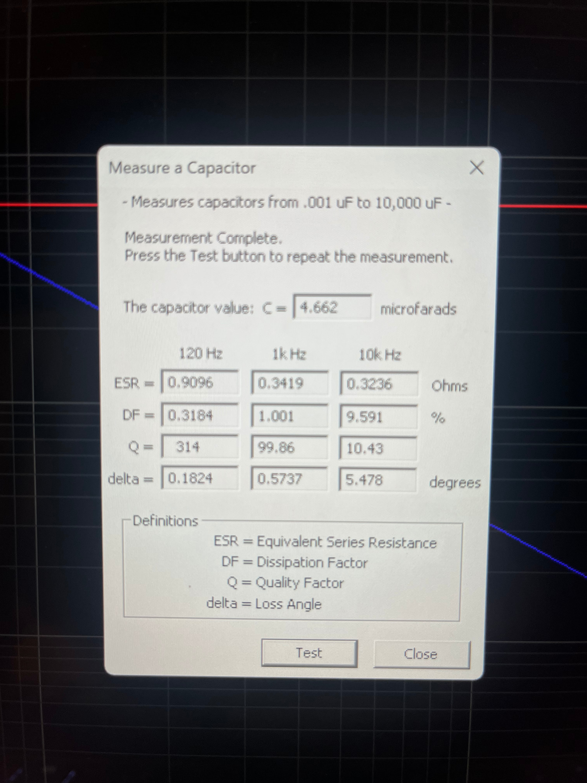

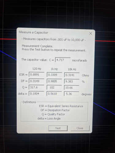

I don’t have two of the same brand to compare, but I do have Audyn 4.7/800v and a Jantzen 4.7/400v
Audyn:
Jantzen:
To be fair measuring less than 1 ohm accurately requires ok equipment. Inductance and capacitance are both notoriously hard to measure accurately. Without kelvin leads it is probably as good as can be expected. We all know those aligator clips and wire are a weak spot. Unfortunetly the internal clmponents probably arent much better. For $100 its still a good value. I have the newest version of DATS but havent played with it yet to see if the added cost = added value.
Just to be clear, I’m using the newest version DATS.

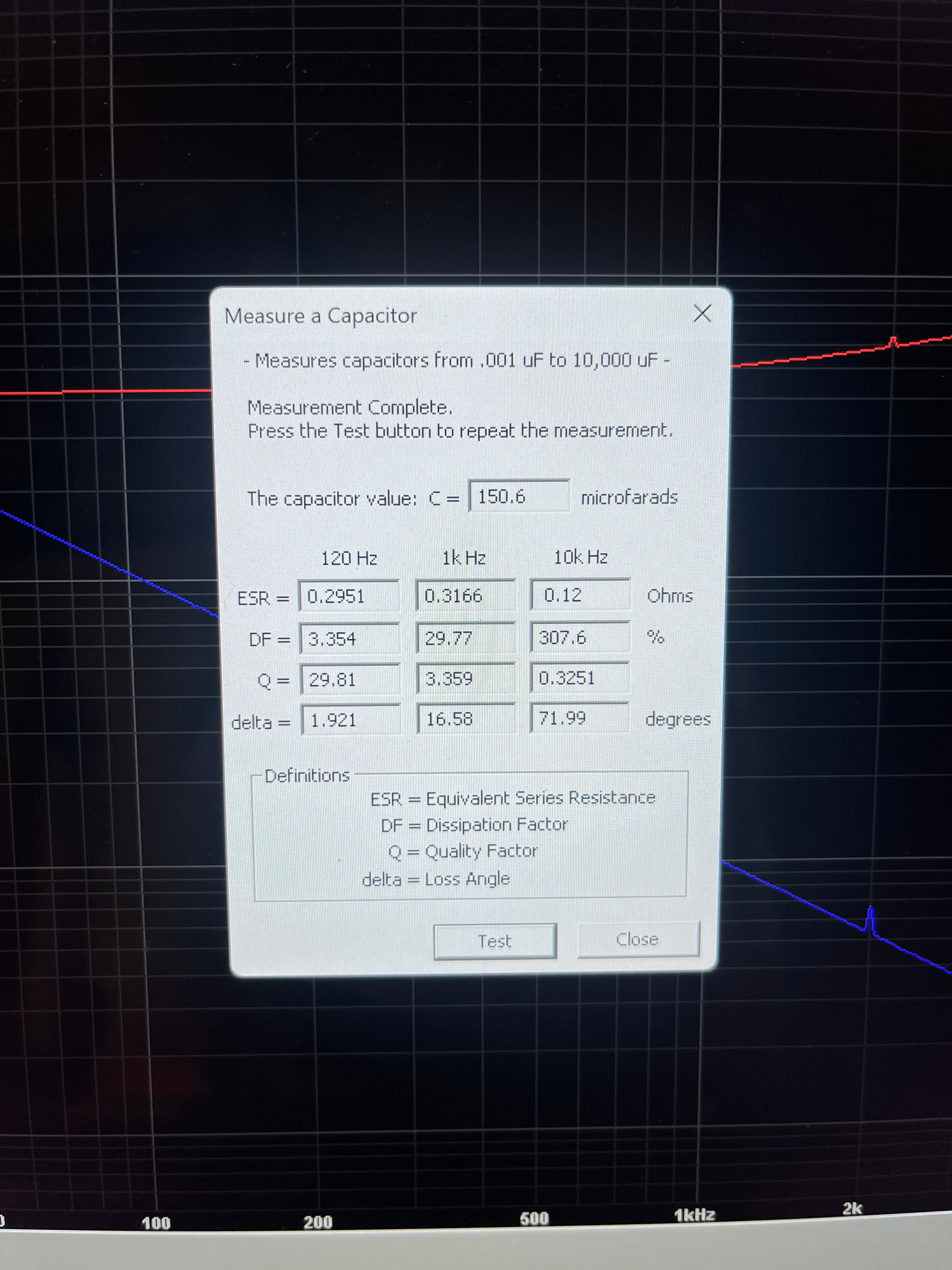

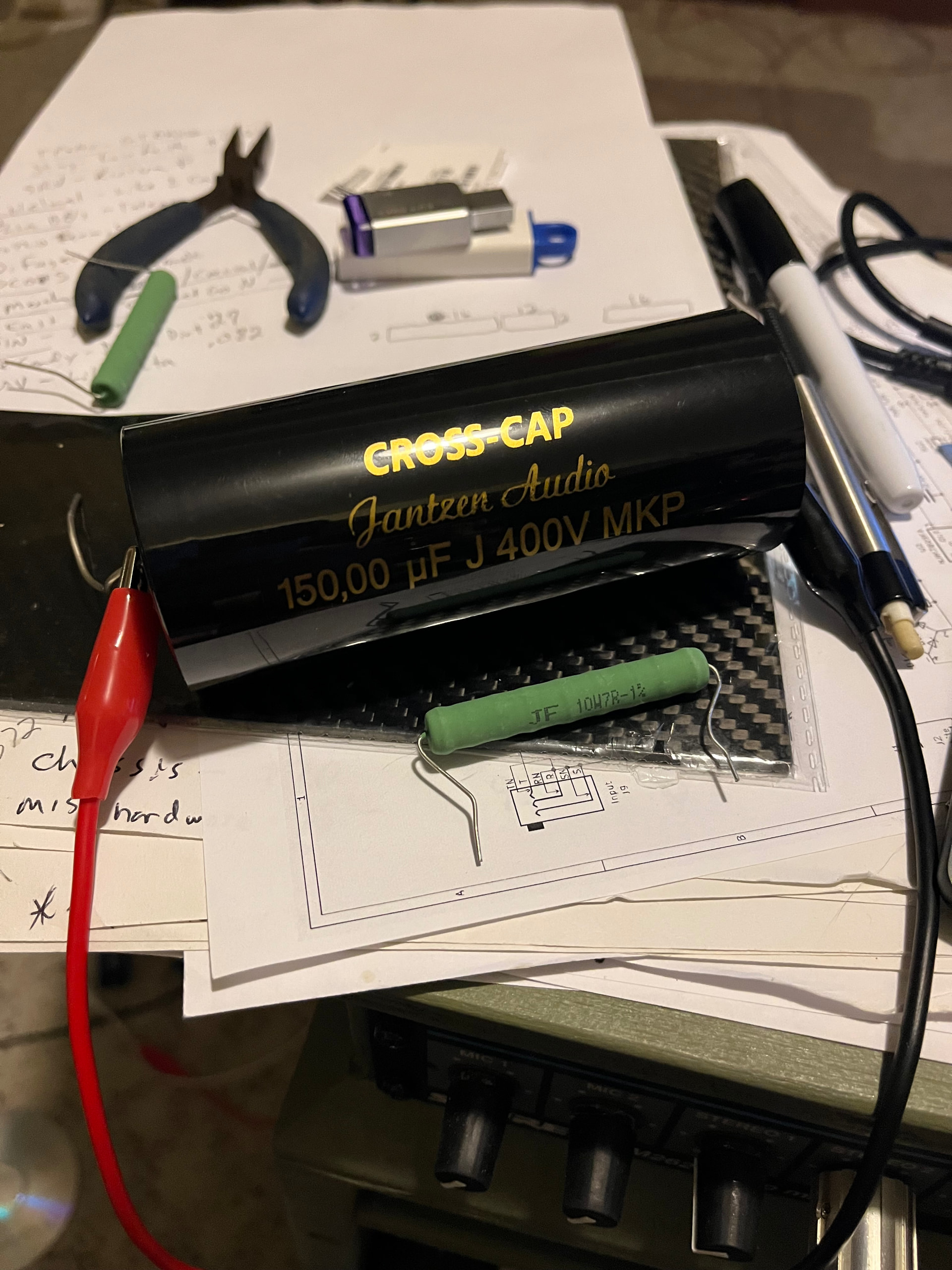

I bit the bullet and ordered the Jantzens from PE. Those AliExpress/eBay ones are a month out, can’t wait, need stuff now!!

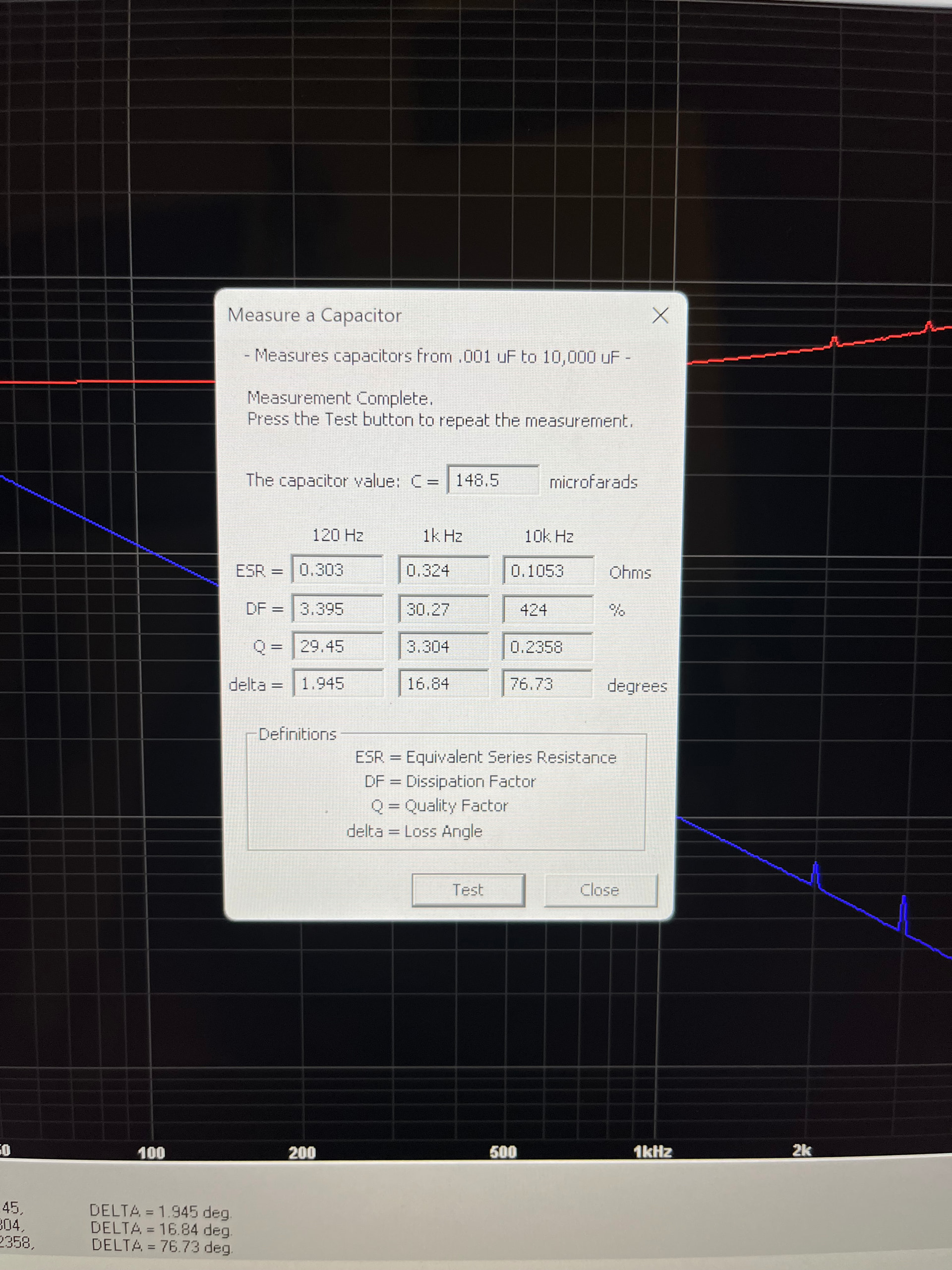

Well that’s fucking disappointing…

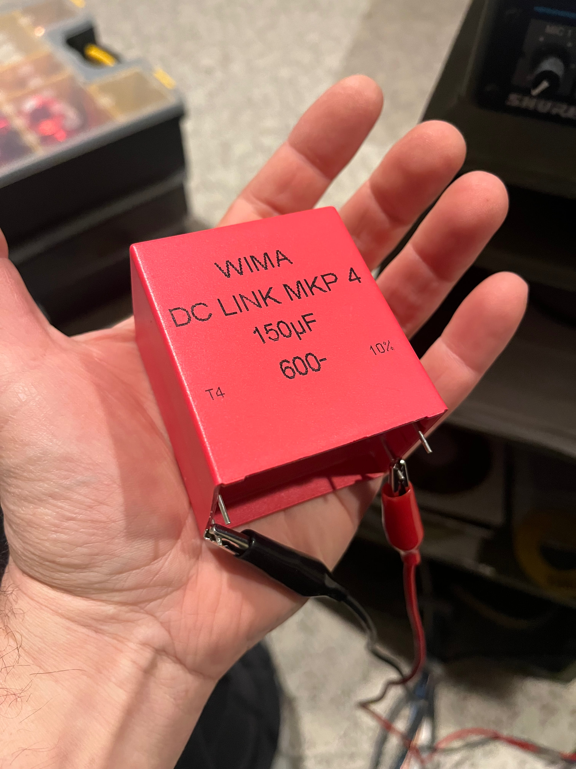

https://www.digikey.com/en/products/detail/wima/DCP4I061509JD4KSSD/9370004?gclsrc=aw.ds&gad_source=1&gad_campaignid=20228387720&gbraid=0AAAAADrbLlhjutE3jqkVpCc1UvGs1bdjD&gclid=Cj0KCQiA18DMBhDeARIsABtYwT23-cnXIp6l5M1ebT68WqIov7MXKeISpktxVEsQcuo_hXP94JC09bQaArlqEALw_wcB
https://www.mouser.com/ProductDetail/WIMA/DCP4I061509JD4KSSD?qs=K%252B2js4Ch3BJRcPv%2FKzbD5w%3D%3D&srsltid=AfmBOopsV9ORMEXxeiBUsHNnjOsgGE9GPLAyp1TZGYSUyu2_tNxH97Lz
These might be worth cosidering if you are still looking.

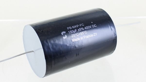

Yeah, I should have tried those, but figured after seeing DaveFreds Solen measurement, I’d be good with the Jantzen.
PE wants $80 a piece for the Solen, that’s a hard pill to swallow.
I’ll send the Jantzens back, Wimas up next.
Only $51 at MAD.
I’d really like the 250V version, but depending on the outcome of the Wima, might try that one.
And of course I got an email stating there’s an extra $9 tariff fee on the Wima…FFS! :man_facepalming:t2:

Servey says…
Nope. I really wish I had DaveFreds cap to varify my DATS unit.
Next…
We should all bring out DATS, laptops, and a few big PP and/or NPE caps to Indy. Have a ESR measurement fest during one of the breaks. :smiling_face_with_sunglasses:
As was mentioned earlier, I wonder if the issue here isn’t just DATS not having the resolution at these super low resistances like we’d see for ESR.
Measure a known resistor in series with it, and see if that improves the measurement.
I’m chasing the fact that DaveFreds Solen measurement of .07@120Hz happened. Then bettered it with the meter. I have Solens ordered.

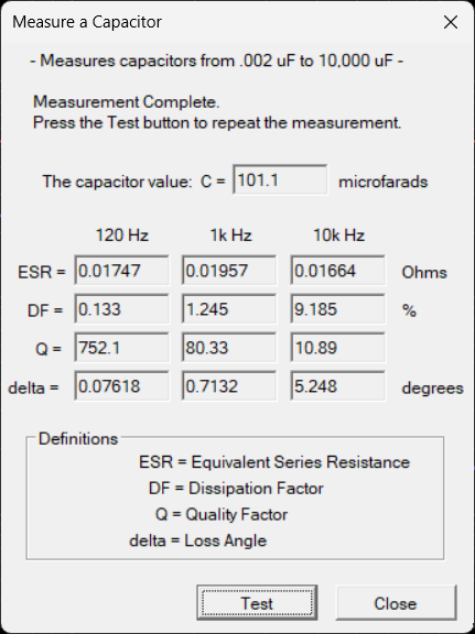

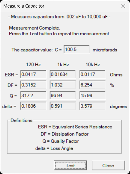

I do not have any 150uF caps, but here is an Audiophiler 100uF measured using the DATS LA:
And an Audyn Q4 100uF:

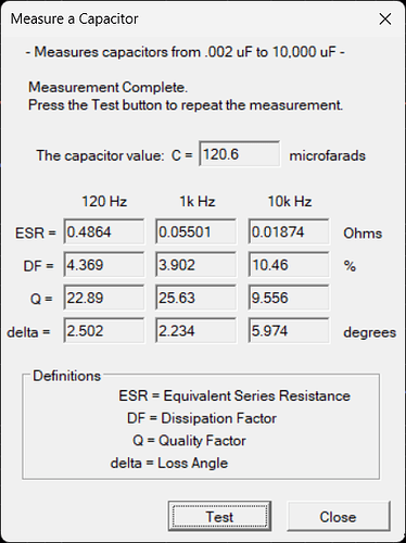

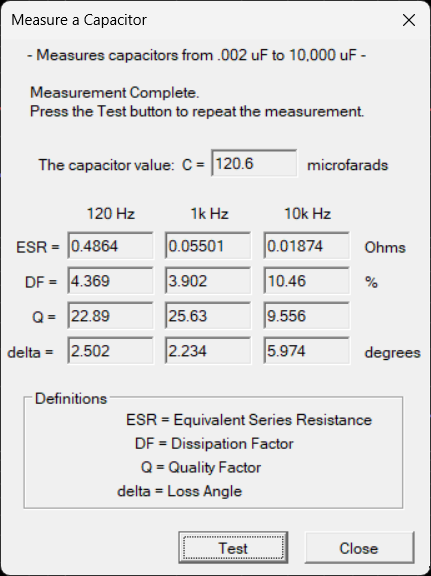

And finally an Erse 100uF NPE advertised at 5% :
I think this started when you saw how much ESR changed the simulation in VituixCAD. Maybe just measure the tweeter with a single cap and see if that matches the sim with ESR close to zero (which I think is the VituixCAD assumption) or close to the ESR that you are measuring with DATS.
