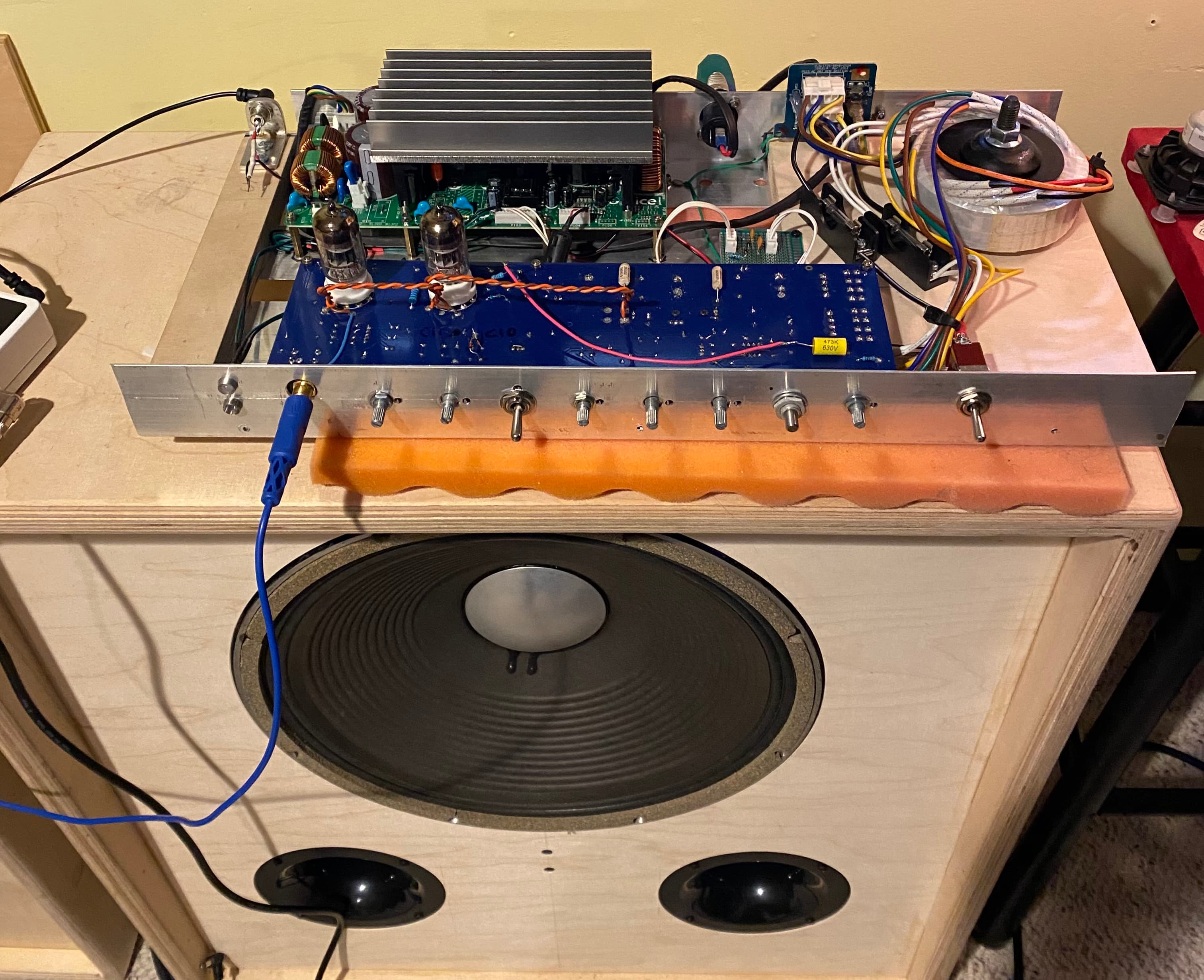

When I started designing and prototyping my bass amp, I was blown away at how efficient the 700AS power amp module was.
With just this hearsink screwed to it, no thermal grease, I played about an hour, at probably 75% volume and could lay my hand on the heatsink. Freaking awesome!

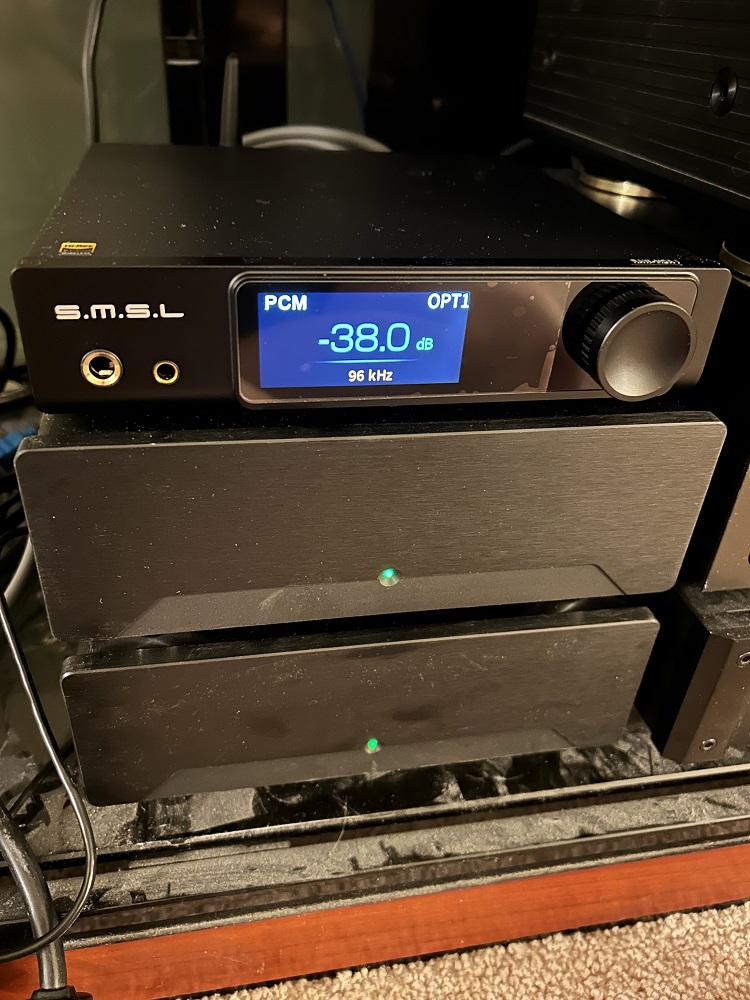

Here’s a photo of how the 300W monos are being used. I use green LEDs for the Icepower monoblock enclosures, because I also have Hypex amps that are using blue LEDs, and a couple stereo amp chassis (including the Icepower 200AS2 and a Hypex NC122MP that I don’t use because it has a nasty turn-off pop) that are using white LEDs.
The IcePower 300AS1 amps are being fed by a SMSL RAW-MDA1 DAC, using the built in volume control of the DAC. This combination sounds really, really good. (That’s reviewer-speak.)

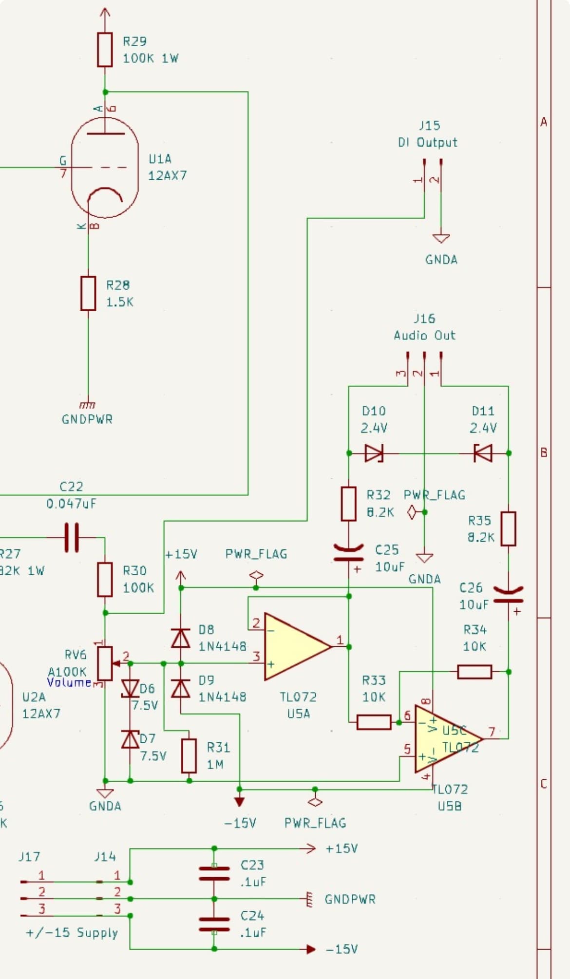

You can run single ended input. Especially since its capable of accepting a 12V swing on the input.
For prosperity…
Here’s the circuit I use to turn a single ended signal to balance driver for the IcePower module.

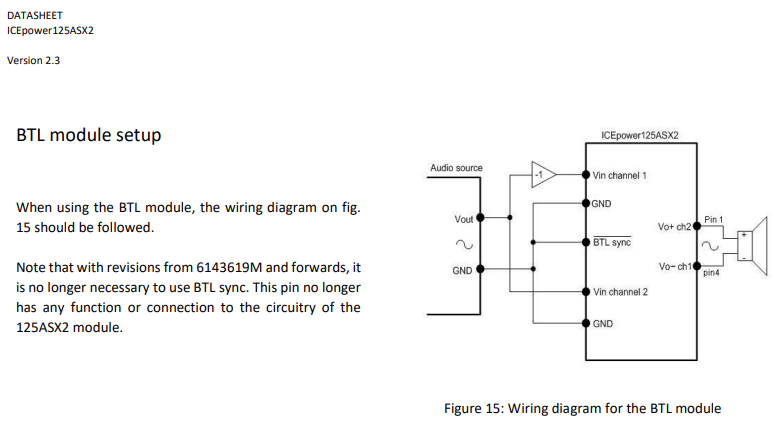

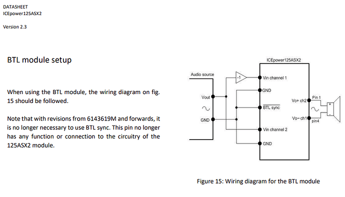

Thanks Eric, what i am not sure about is - does sending a balanced signal automatically turn a ASX125 into BTL mode utilizing both inputs? Need to re-look at the documentation, but I am still not very sure of the connections.
Ani, Send balanced + to Ch2 input and balanced - to Ch1 input. Make note of the pins used for output as well.
Thanks, this helps - it was there somewhere!
