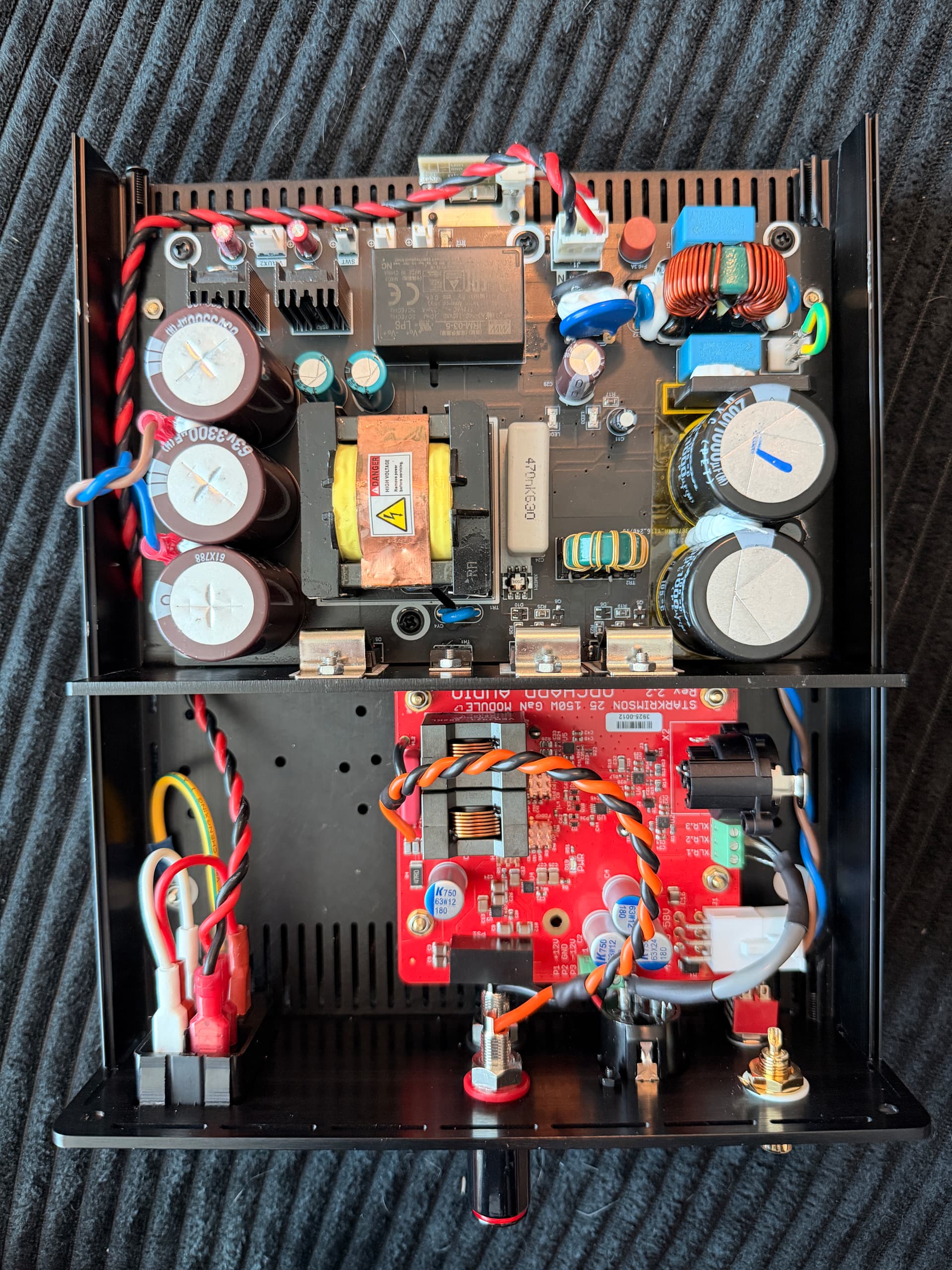

I recently disassembled a dual mono ICEpower amp to repurpose the case for an Orchard Audio Starkrimson 25 build. The case has a bunch of holes predrilled for various layouts of the specified amp brand and none of the holes lined up in a way that made sense for the repurpose, but I was still able to shoehorn everything in. The final product looks good and sounds spectacular. I haven’t had the chance to work on auxiliary power for the RTX module to convert single ended RCA input to the balanced that the amp board wants. That’s a project for another day.
