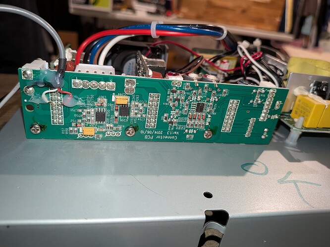

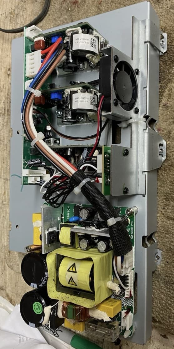

I have a Hypex NC252MP that I built into a Ghent case a few years ago. Much like most of the ICEpower amps, this model has a built in power supply. I’ve seen some cheap Hypex UcD modules, but they need a separate power supply and also have a specialized connector pinout which makes them a little less appealing. When I saw this board on ebay that came with a power supply, 2 UcD250LP modules, and a board that interconnects them I went for it. Hopefully with minimal effort I can get it up and running and see how the UcD sound.

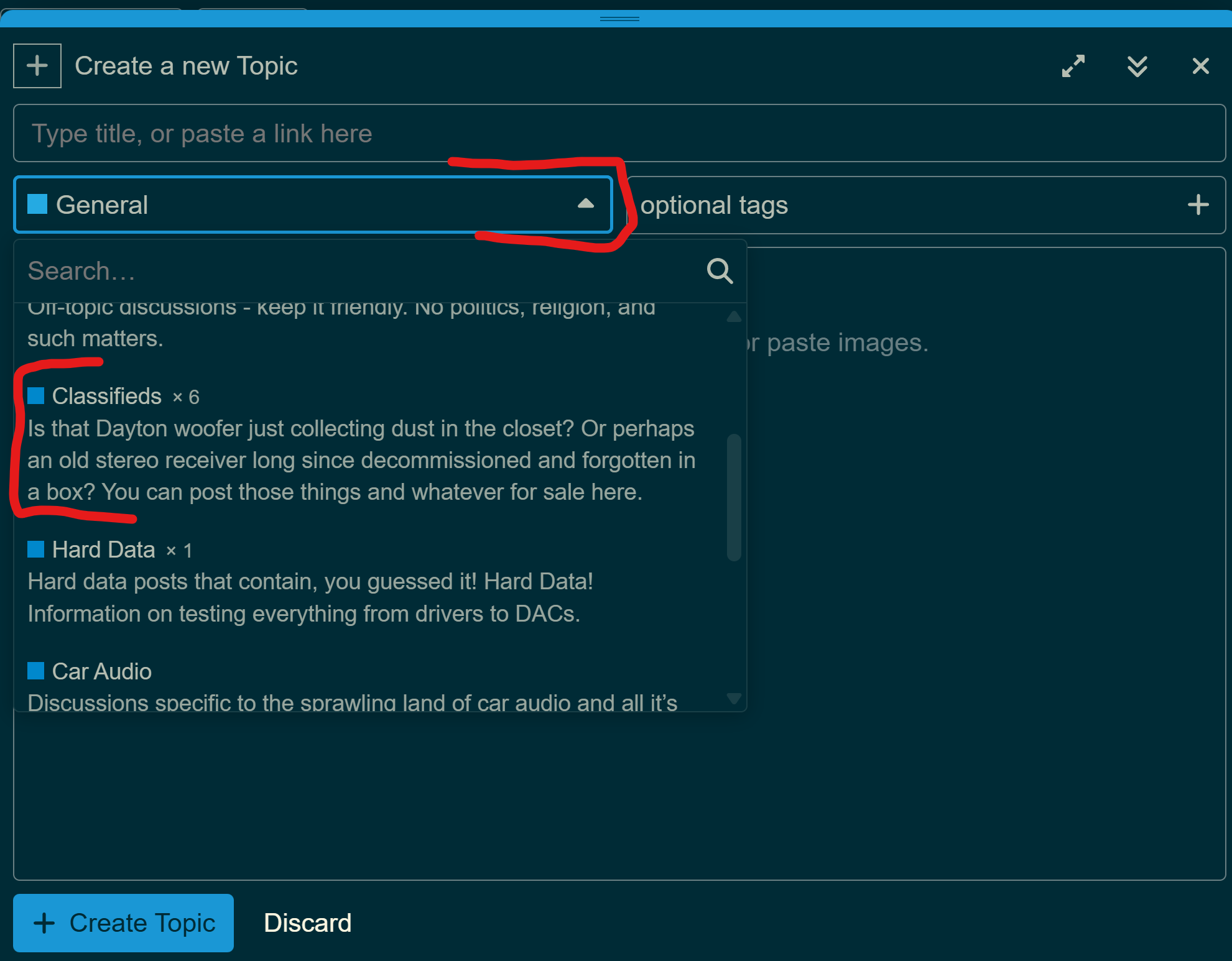

You should post them here for a week first. May give you the chance to avoid those pesky eBay fees.
That’s a great idea. Is there a specific sales thread? Sorry, I’m new here.
Thanx!
Click on the “New Topic” button on the home page to start a new thread. When you do, there is a drop down of “Forum Areas” to choose from. Most use “General” (which comes up by default) but you can scroll down and select “Classifieds”.
It’s alive! It needed some of the same connectors that the ICEpower amps use. Using the Hypex SMPS400 and UcD250LP datasheets, I was able to verify how the connector board interfaces. From what I could tell in my pcb tracing, the audio input into the connector board was only single-ended. The JRC 4580 opamp must be creating the balanced signal. I ended up removing the four capacitors that fed into the amp audio inputs to isolate them from the board and soldered directly to the Hypex module pins on the connector board. I only have 13.3dB of gain now, but shouldn’t be a problem for sensitive speakers. Feeding it with the Hifiberry Studio Dac8x. Time to solder up the other channel.
I had tinkered with those OEM modules when someone was refurbing(repair) and selling off on ebay cheap, though had bad luck where 50% still bad - was able to return defective ones but was a hassle.
But I too had run them direct feed knowing low gain which fine for me, and used to it since try lot of pass 25wpc-er’s where gain typically 15db. Though I know that also input impedance also low, 1.5k? if i recall, direct feed but that was fine for me too using a preamp/buffer or direct from my dac, that can act as headphone amp implying it less bothered by low impedance.

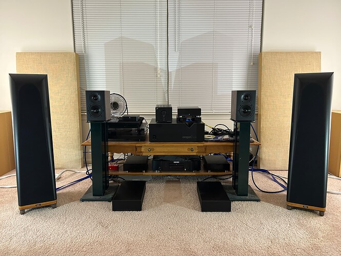

Here’s one more photo of my upstairs listening room just for fun, showing my Ice and Hypex Class D amps, plus the Aragon I used before. Speakers are Thiel CS1.7 and Neumi Silk 4 (very similar to Silverline Minuet) plus a pair of DIY subs with prototype 6x9 woofers from my previous job.

The Aragon is powerful and has a warm sound with strong bass; the circuit was designed by Dan D’Agostino for Mondial. My unit has some transformer hum in it, but that doesn’t appear on the outputs. It was tested by Audio Science Review and their sample had relatively high noise and distortion. It is technically a ‘vintage’ amp by now, over 30 years old. It is warmer sounding than my 200AS2 and 1200AS1 monos, but it’s also warmer sounding than many other amps.

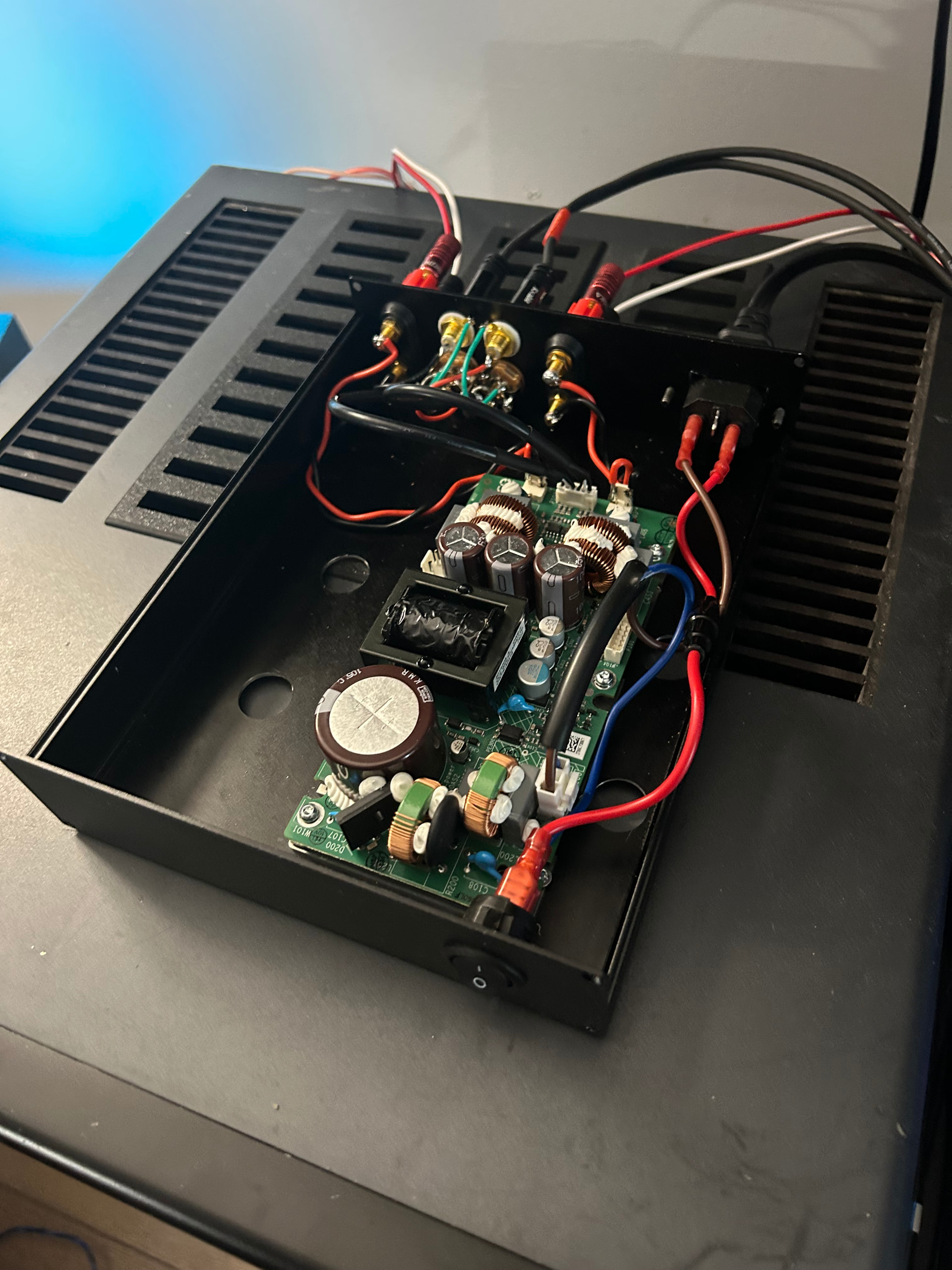

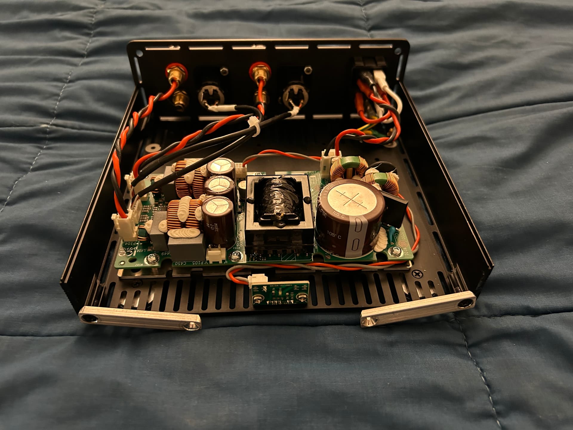

PE has those 200AS2’s back in stock, so I bit and bought one plus the signal cable and mains plug with a 12% interweb coupon. They’re out of stock on the speaker harness but I’ve soldered directly to pins for those before - should’ve added heatshrink and need to earth the chassis. But using a cheapo 35ish buck case from amzn, drilled and assembled over long lunch break (~90min).
So far sounds good, no bass wimping like some tpa3255’s modules that had tried in past. Confuses me how the 2x215 and 2x100 modules are same price, though I think really it’s 90x2 into 8, ~200x2 into 4 based on datasheet and power graph.
Put some TRS connectors on back, with trs-to-rca adapter plugged in to ground out the IN- as like to have the balanced input option available. Not like need another amp, but know easy enough to sell off if need funds for other toys.
The 100W and 200W modules are similar in complexity, so it makes sense that cost won’t scale linearly with power output. The 100W module uses a TPA3251 and the 200W module uses TPA3255, and maybe the SMPS voltage is adjusted for either chip to avoid overcurrent, but you’ve still got an output filter and a SMPS for both modules.
