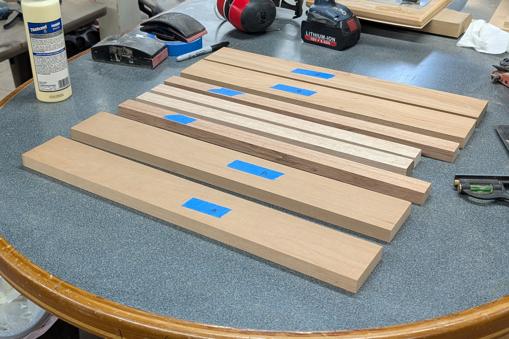

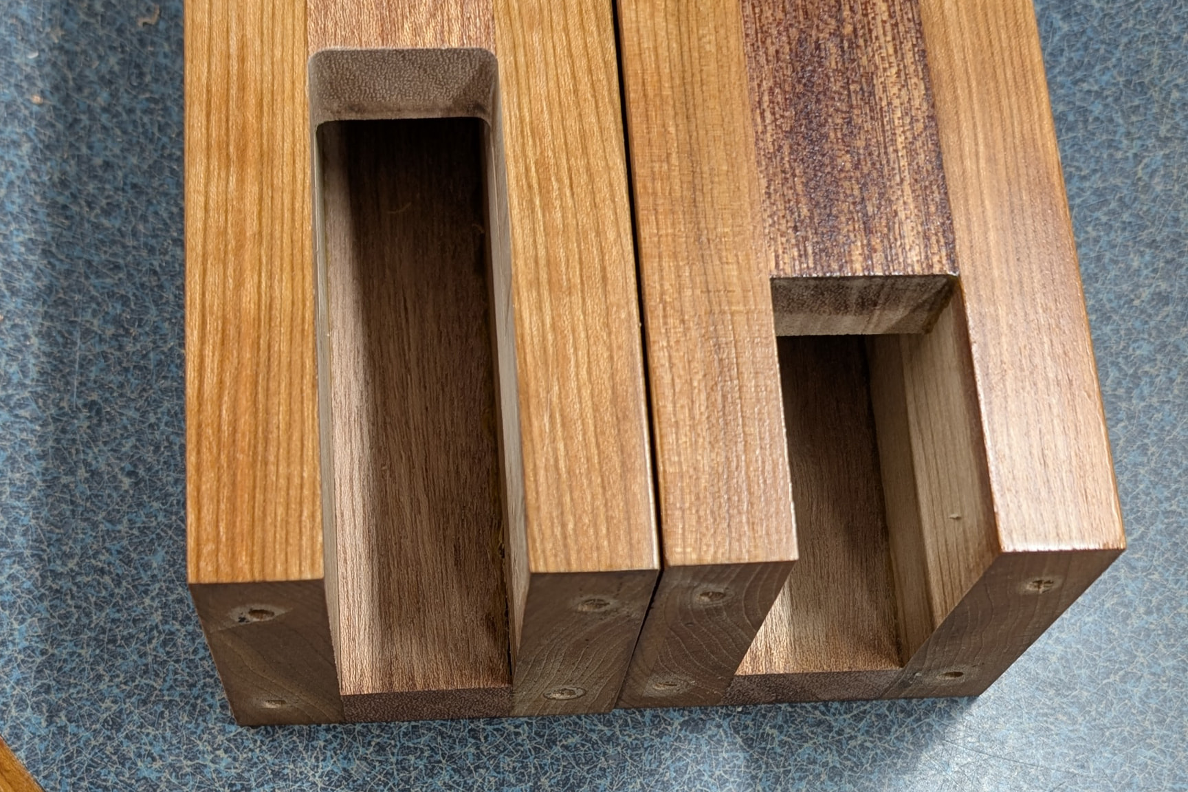

Cut Cherry and Mahogany to build some hollow posts.

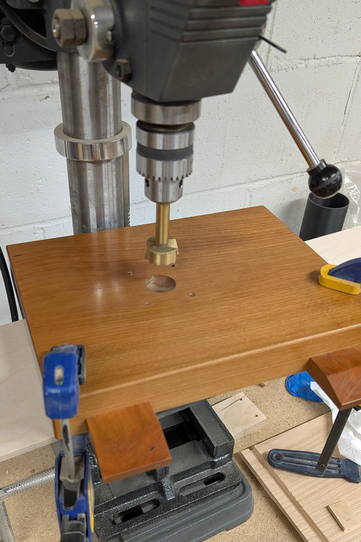

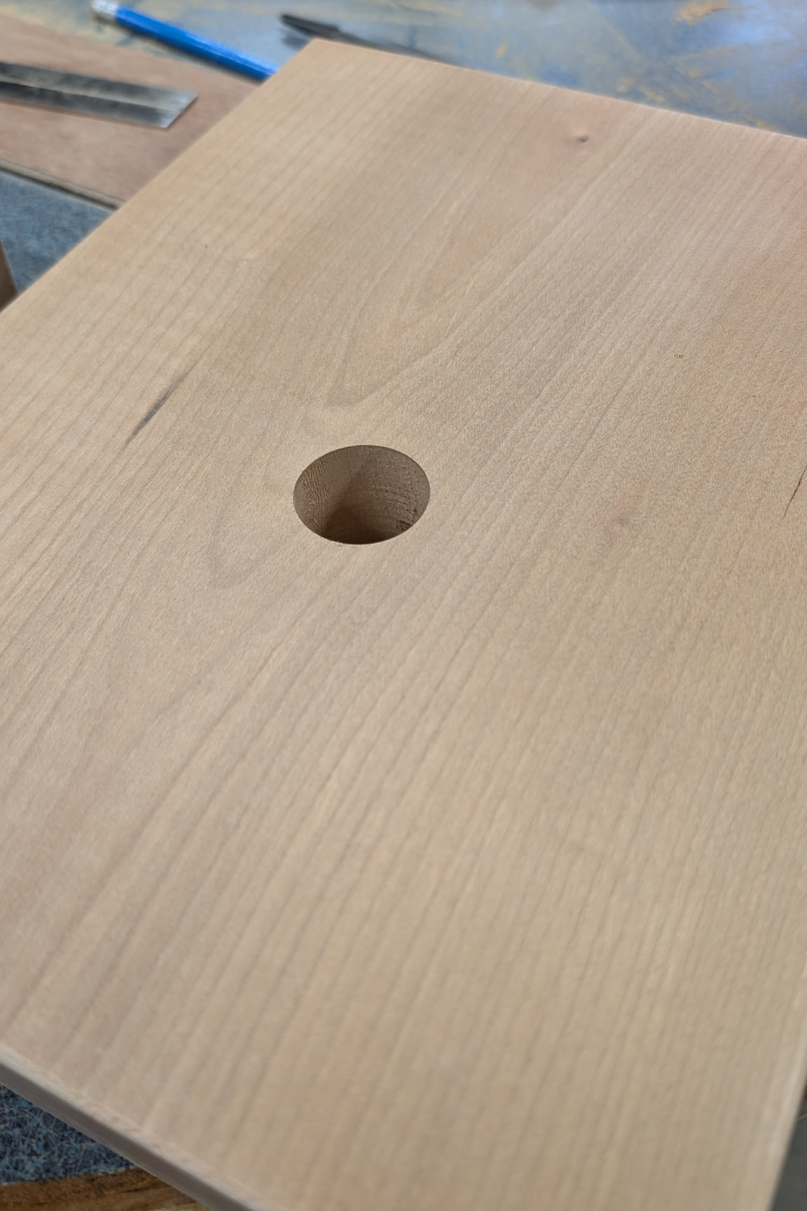

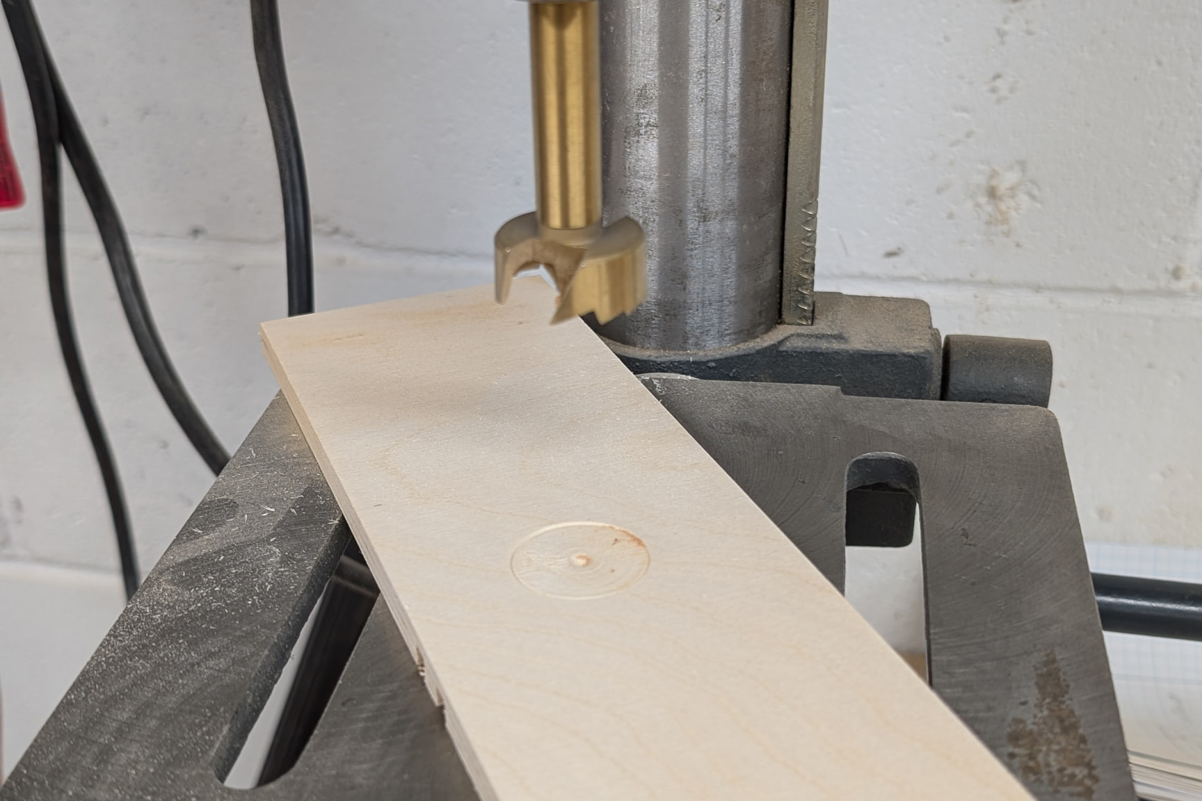

Big forstner bit used to cut holes in the bases.

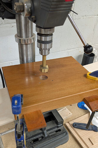

Drilling holes in the solid Cherry bases.

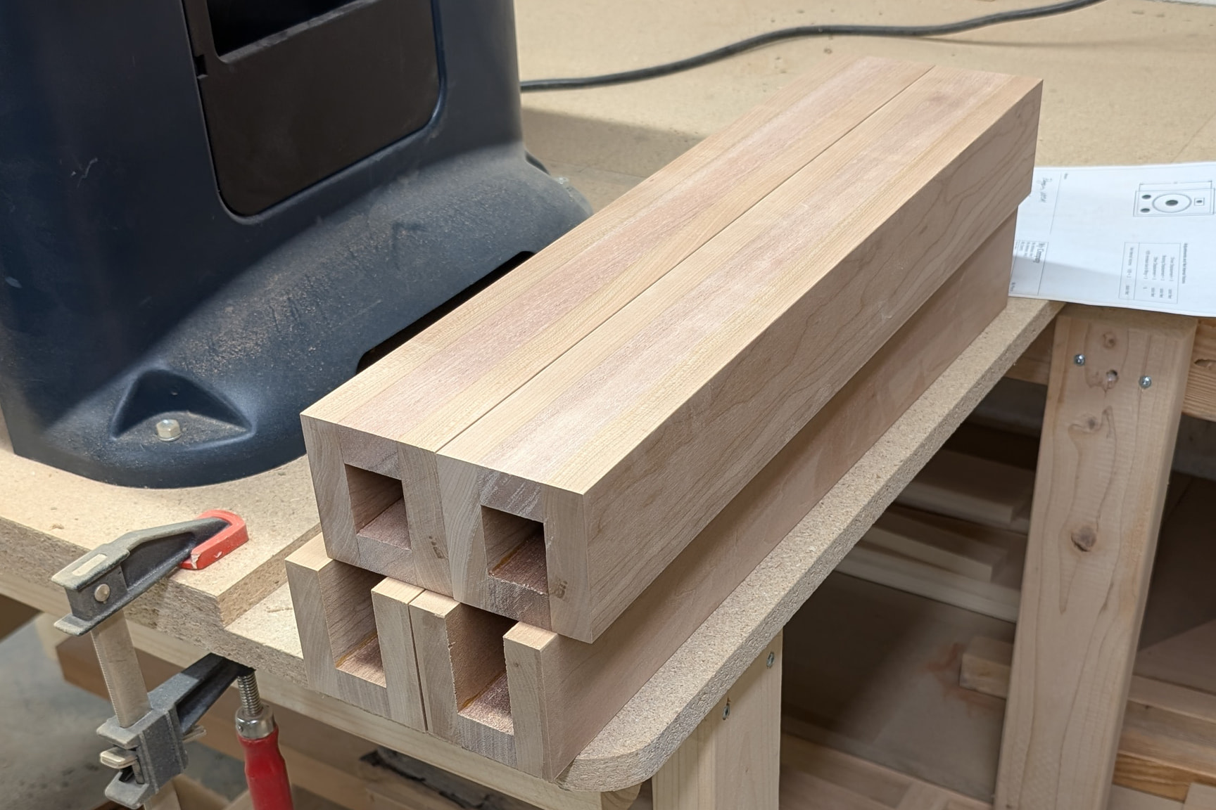

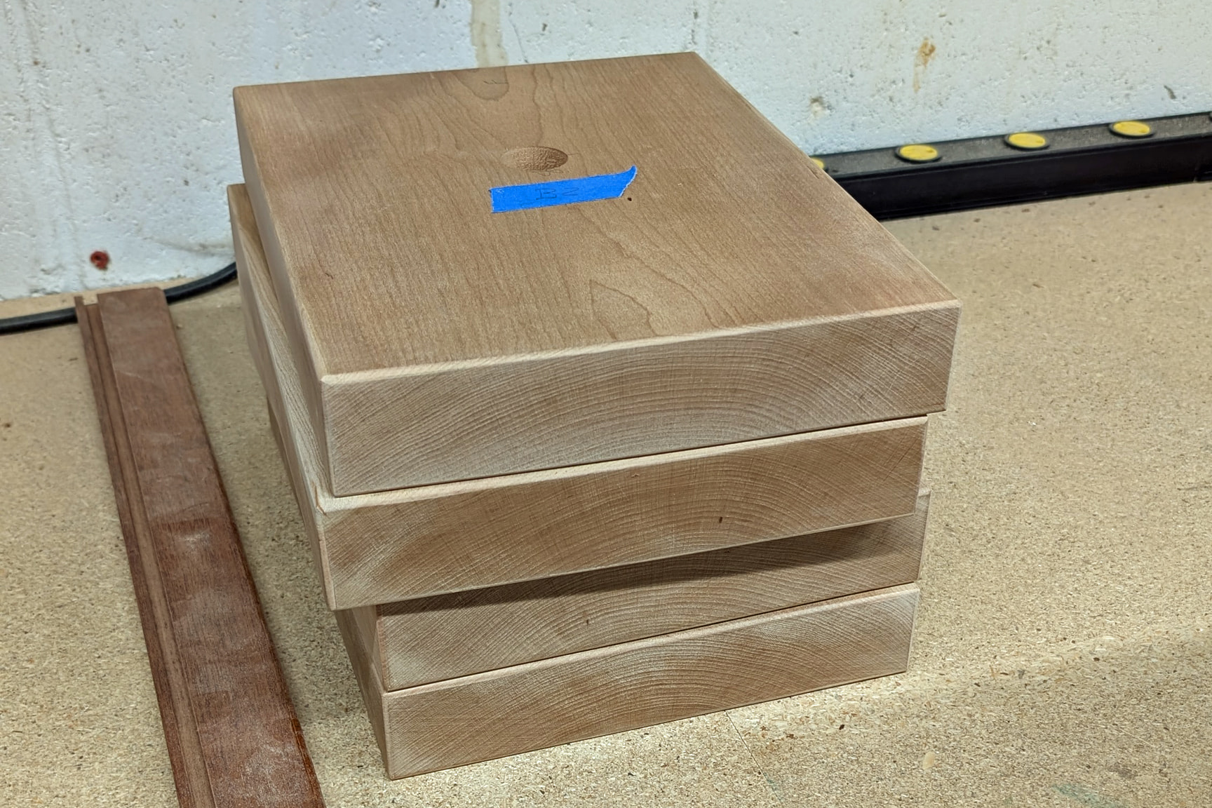

4 bases.

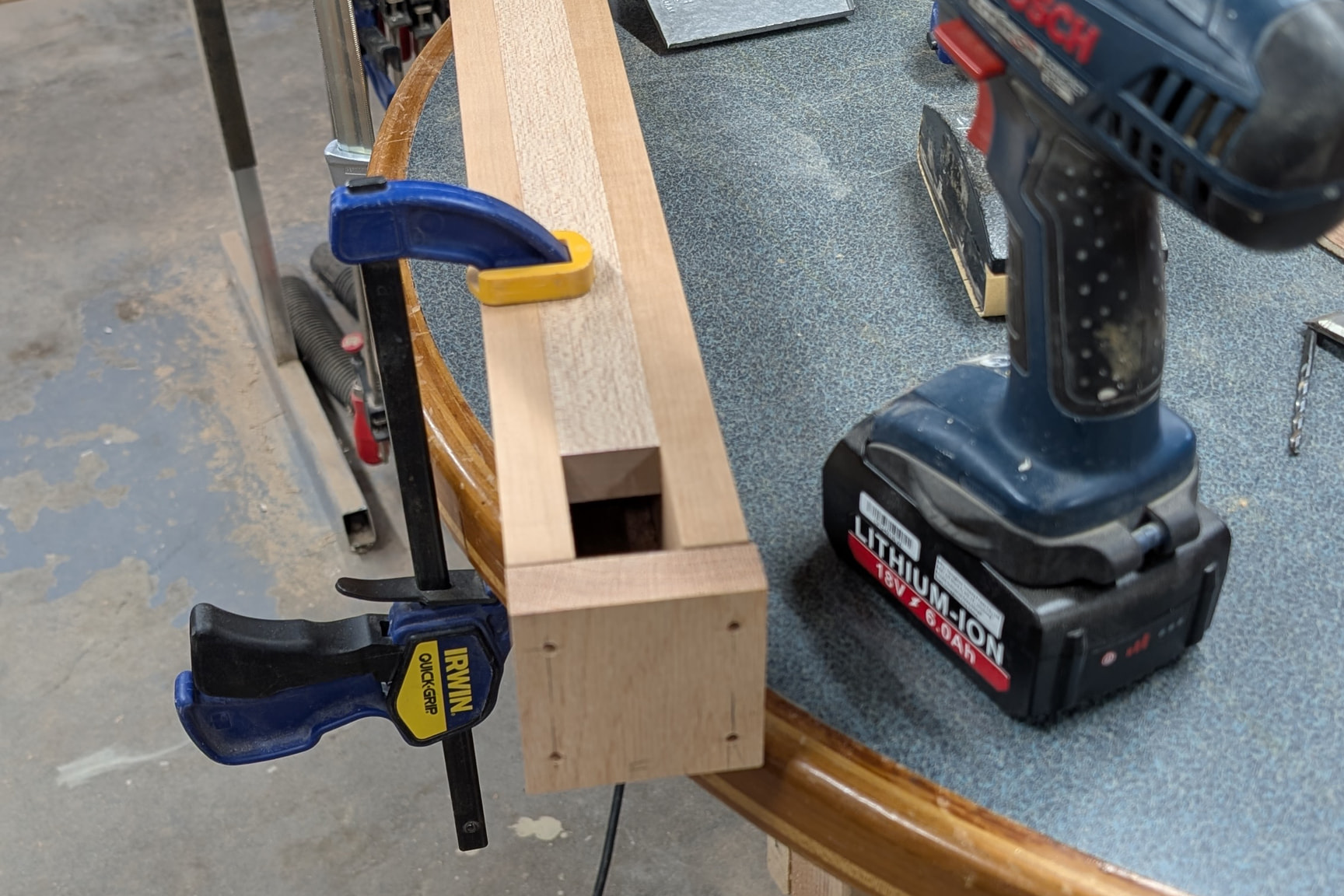

Glued up posts. The back of the post has an opening for the speaker cable and connector.

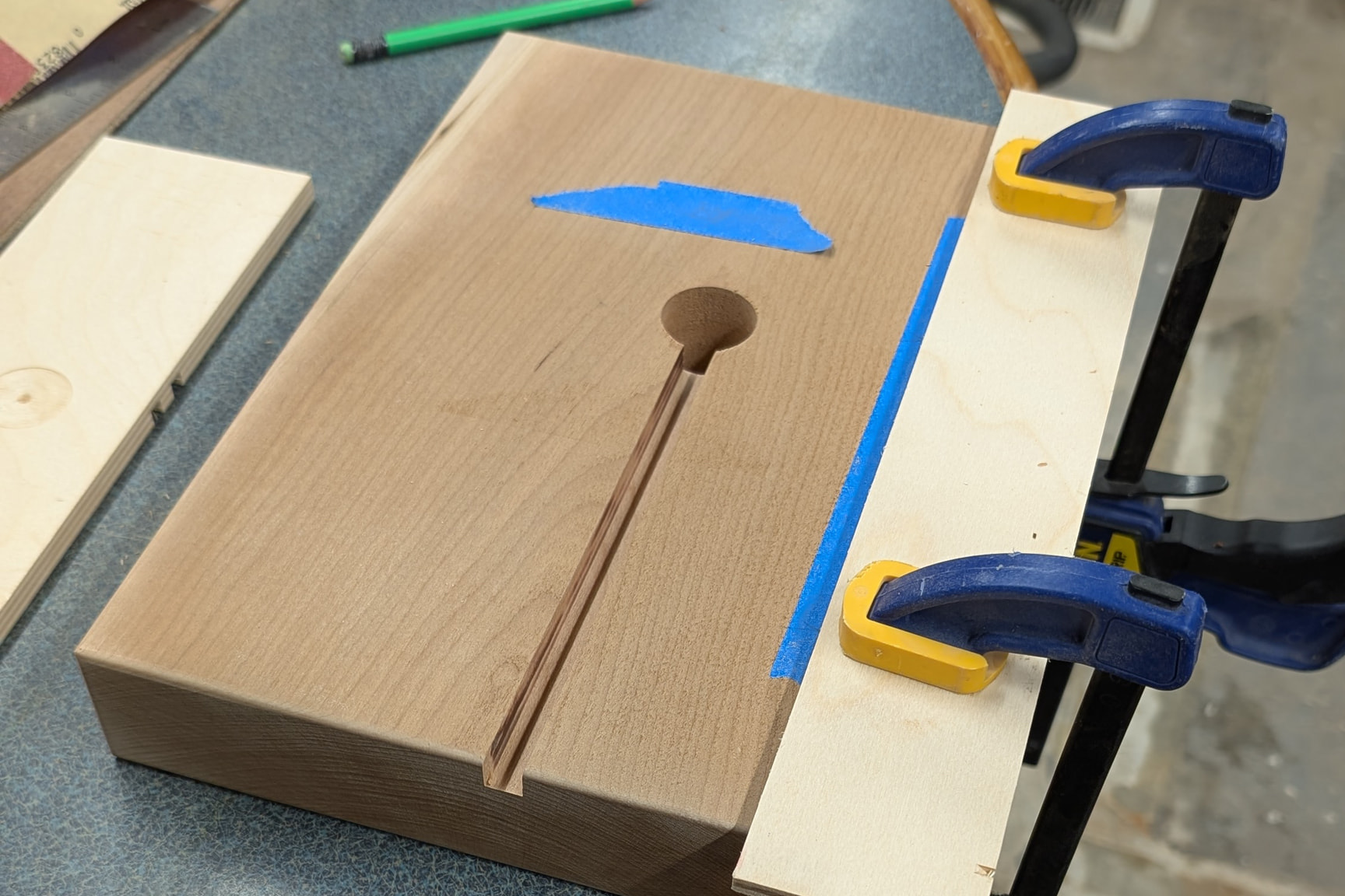

Routering a slot in the bottom of the base for the speaker cable.

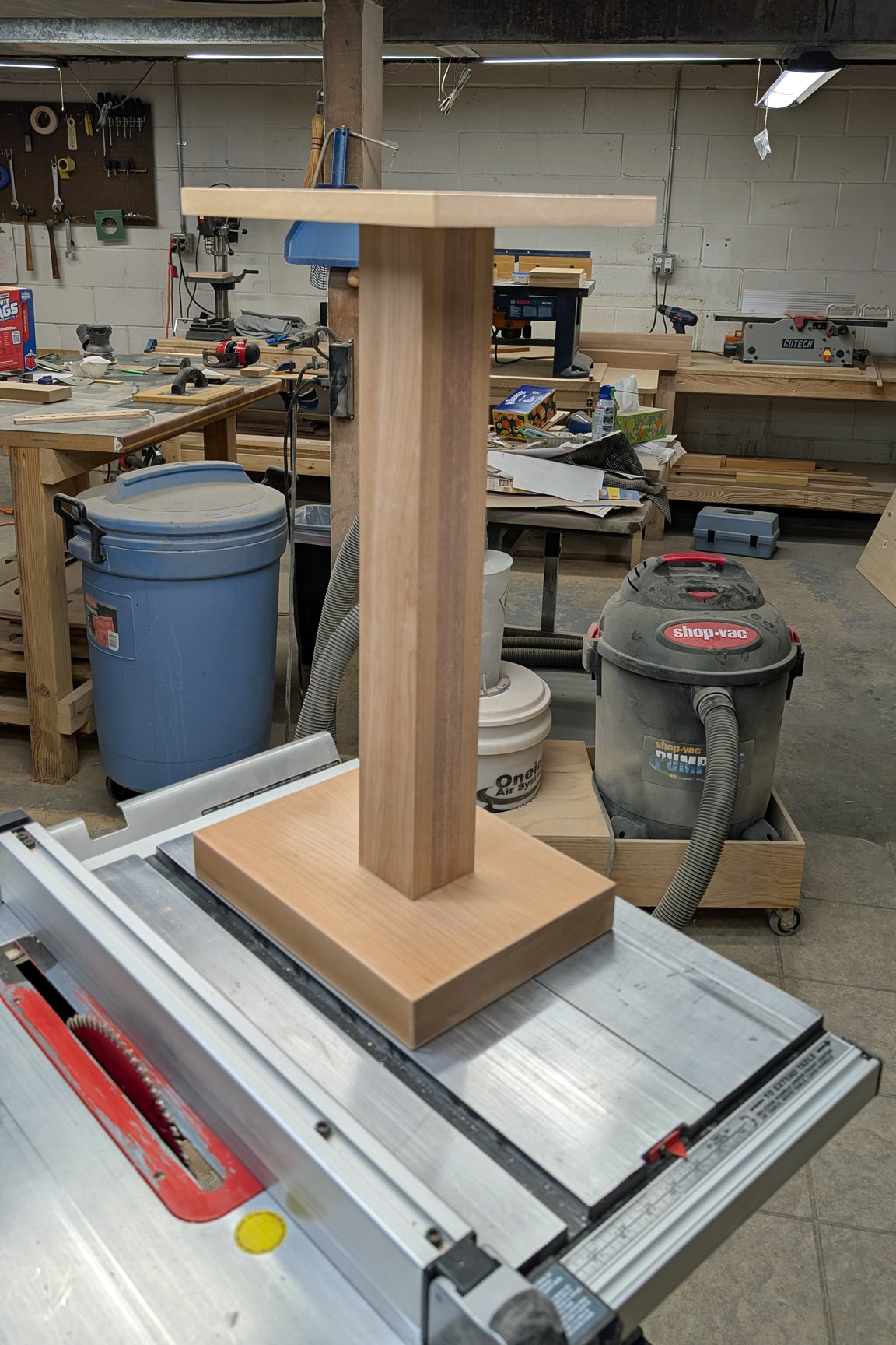

Test fitting stand parts.

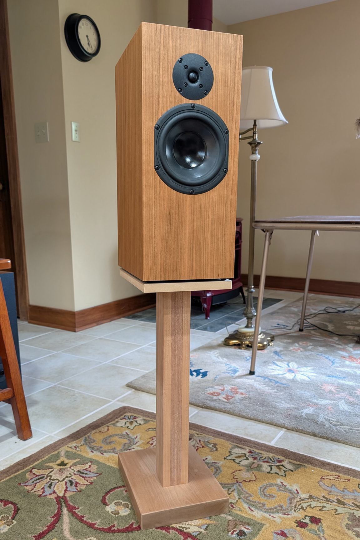

Test fitting speaker to stand.

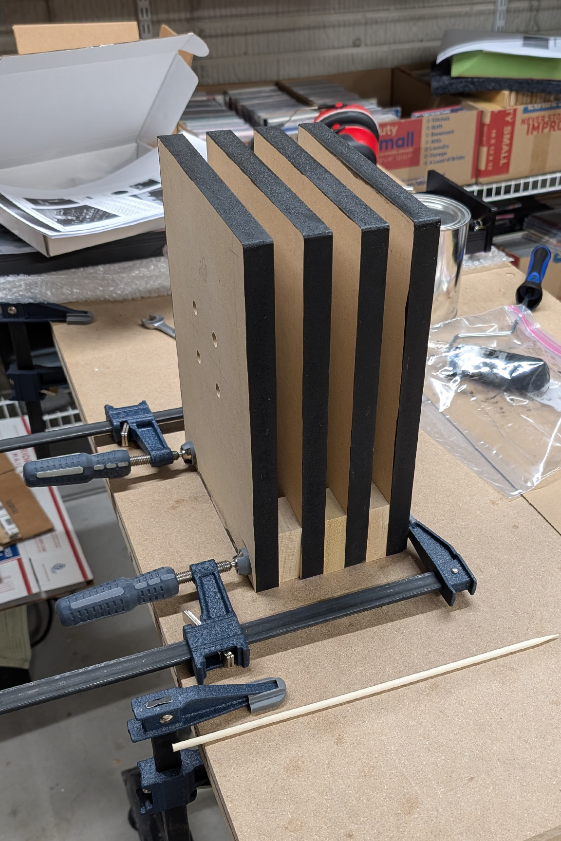

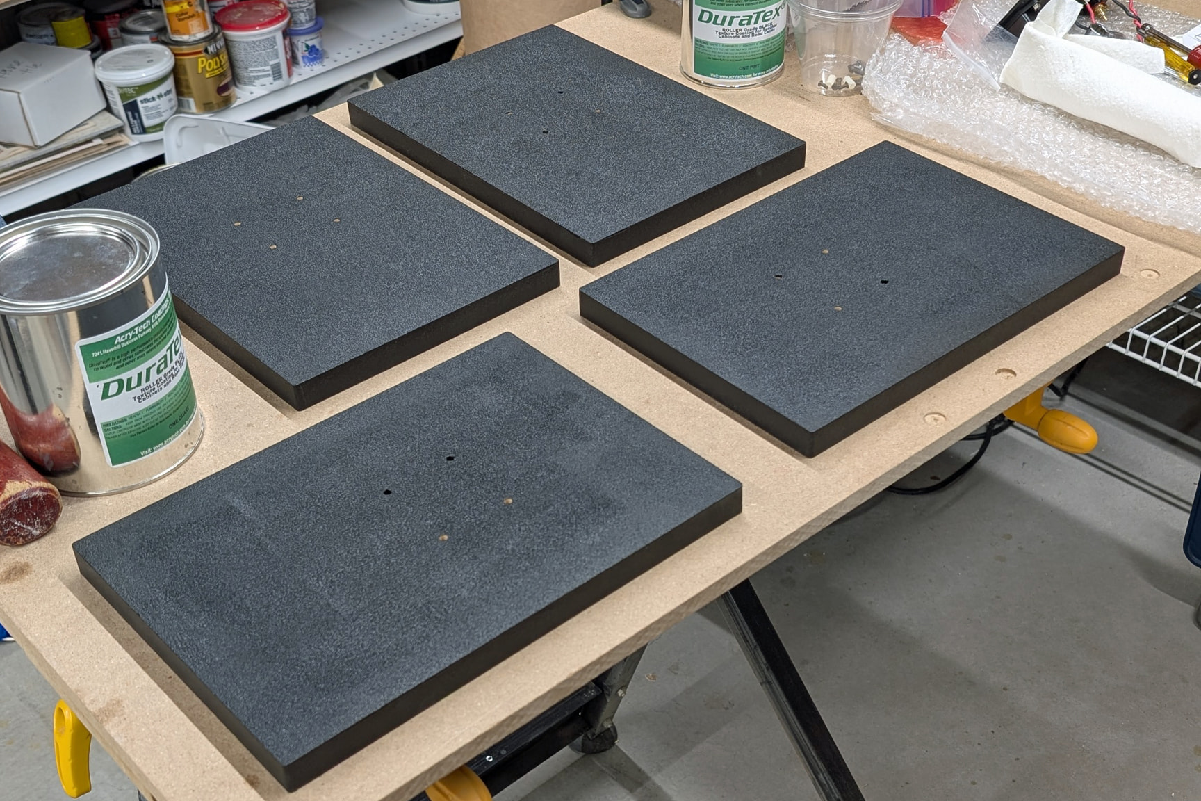

Applying Duratex to edges of stand tops.
Applying Duratex to the tops.

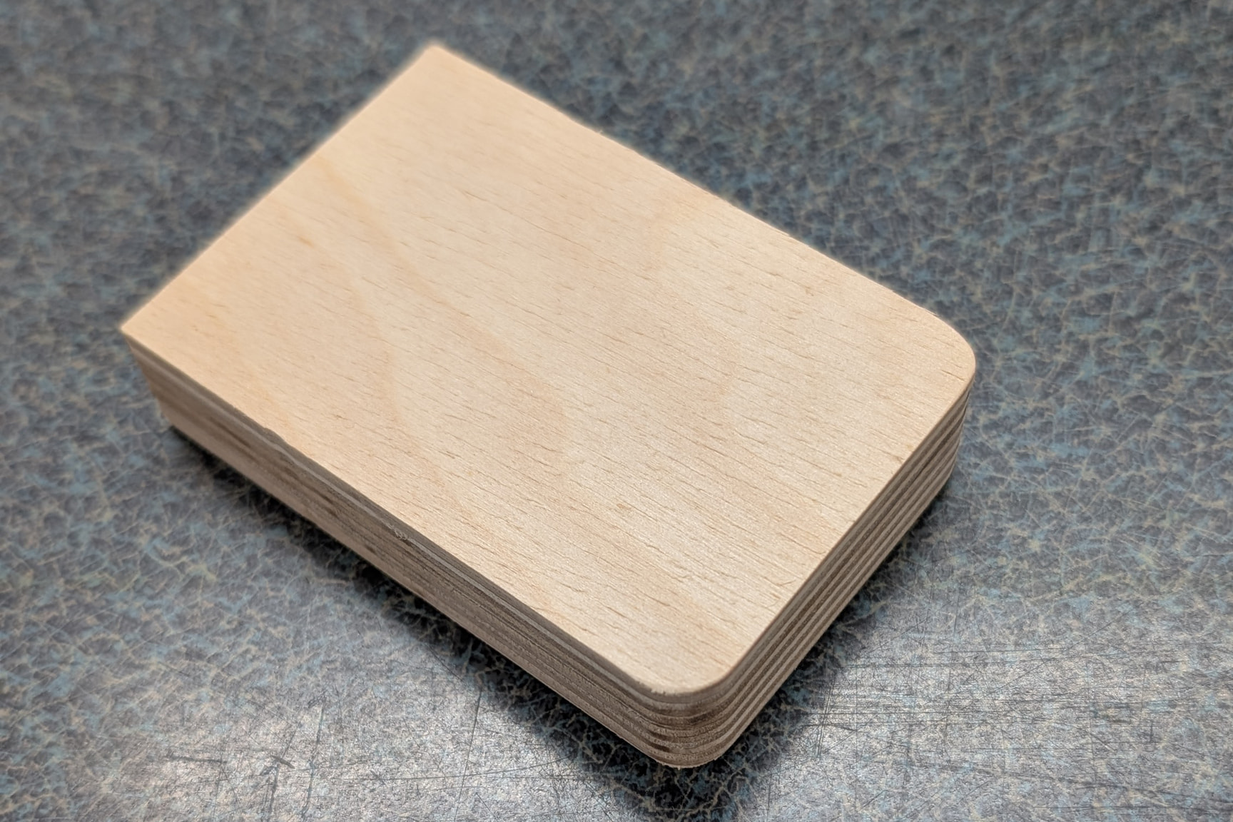

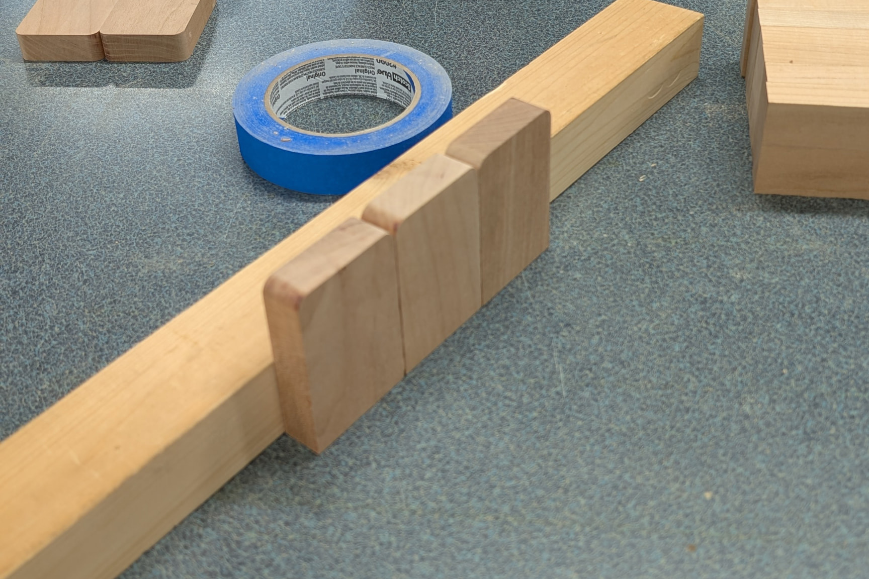

Outrigger test block.

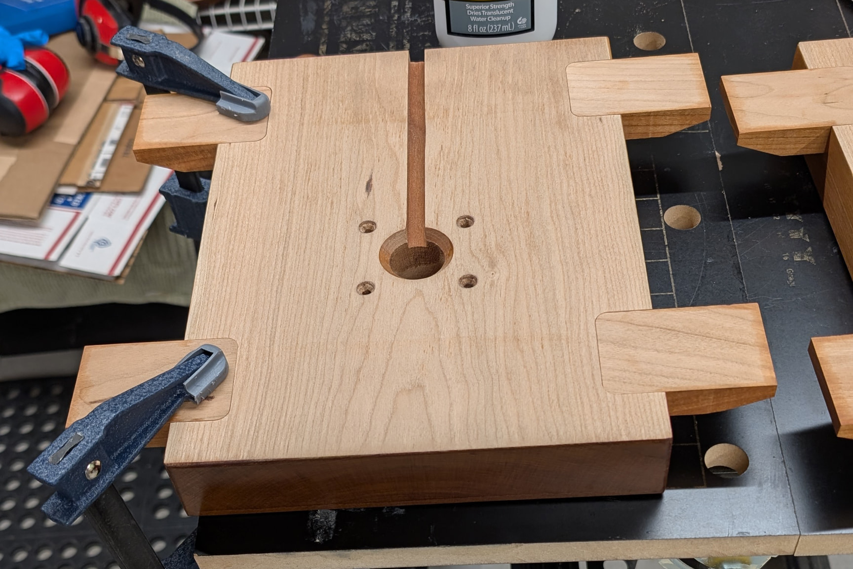

I made 12 Cherry outrigger blocks and cut matching pockets in the bases. I neglected to take pictures of the pocket.

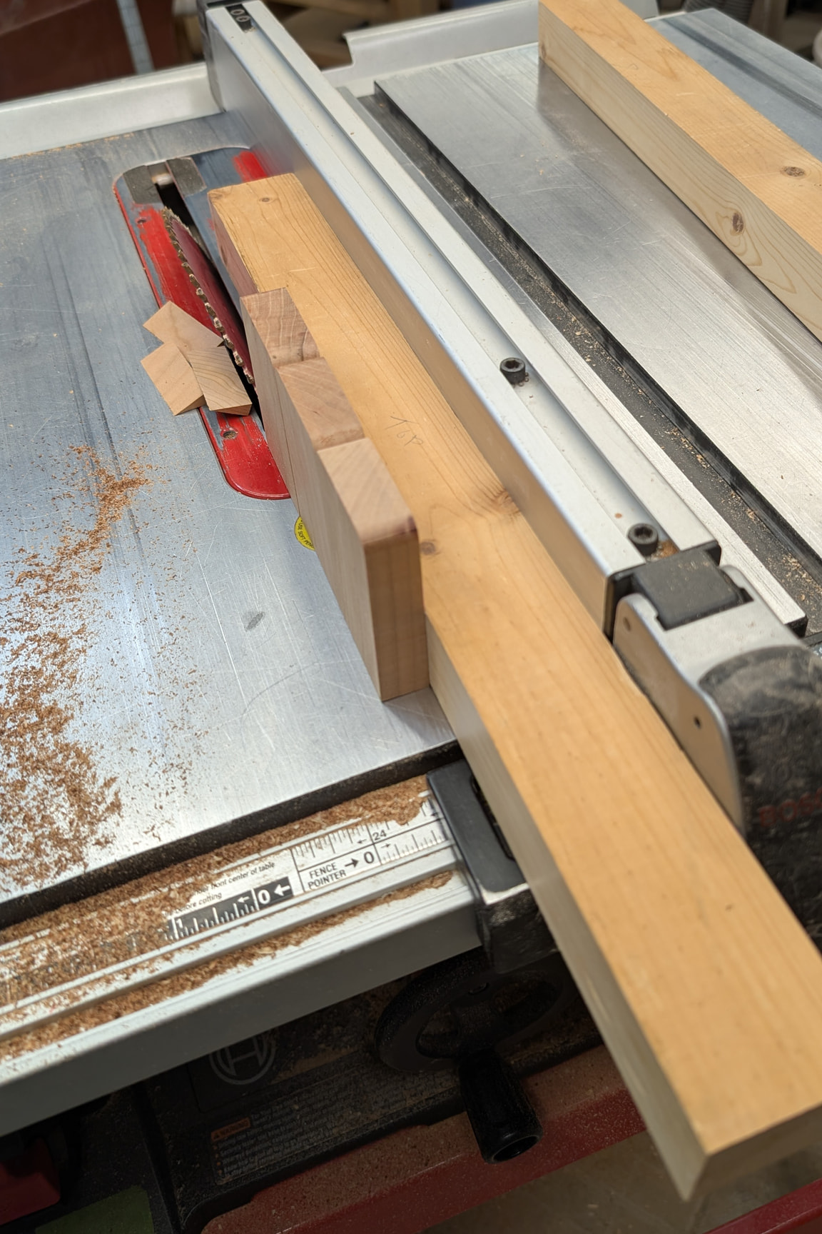

Fastened the outriggers to a piece of scrap wood with double sick tape so a taper could be cut on the table saw.
Cut outrigger tapers.

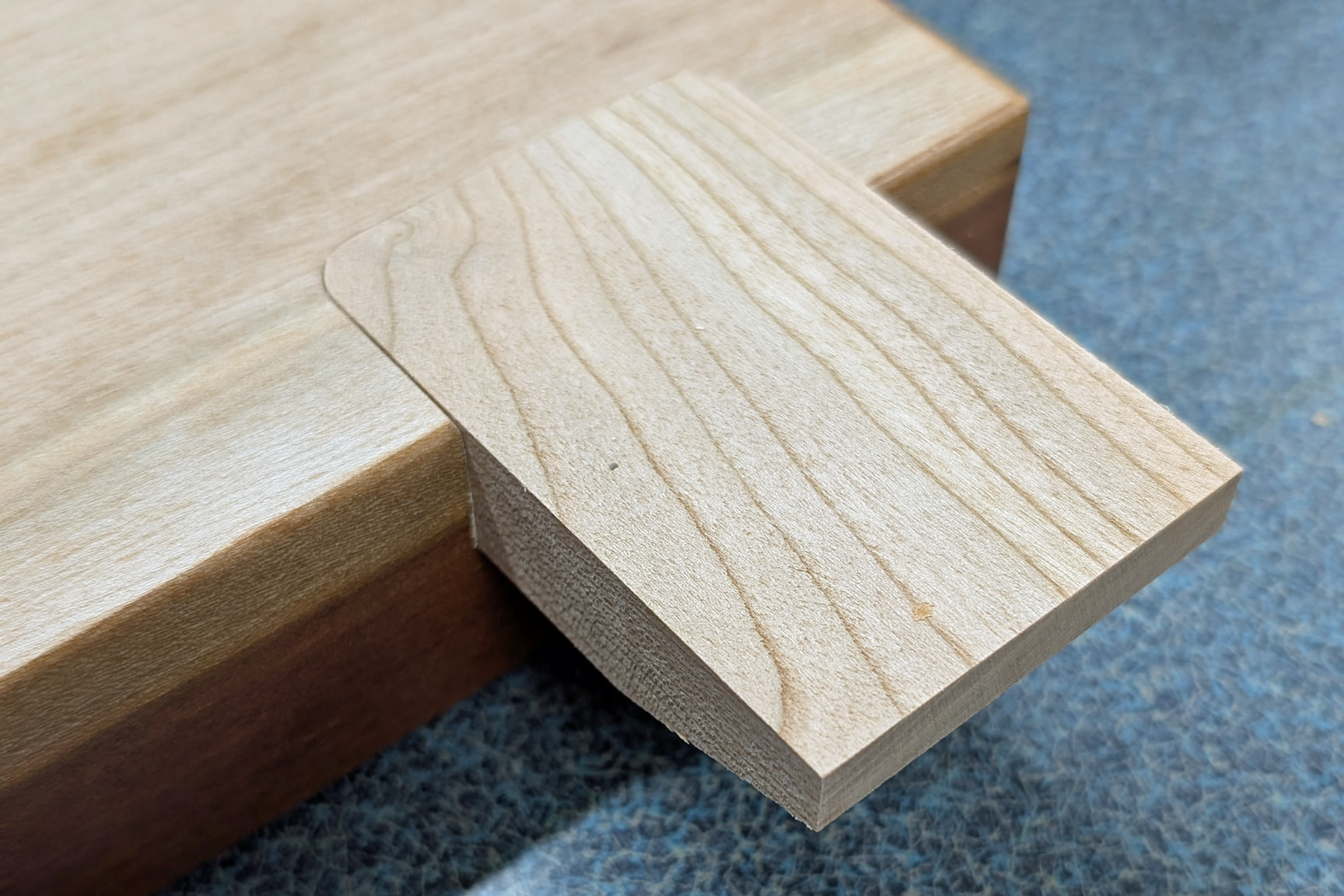

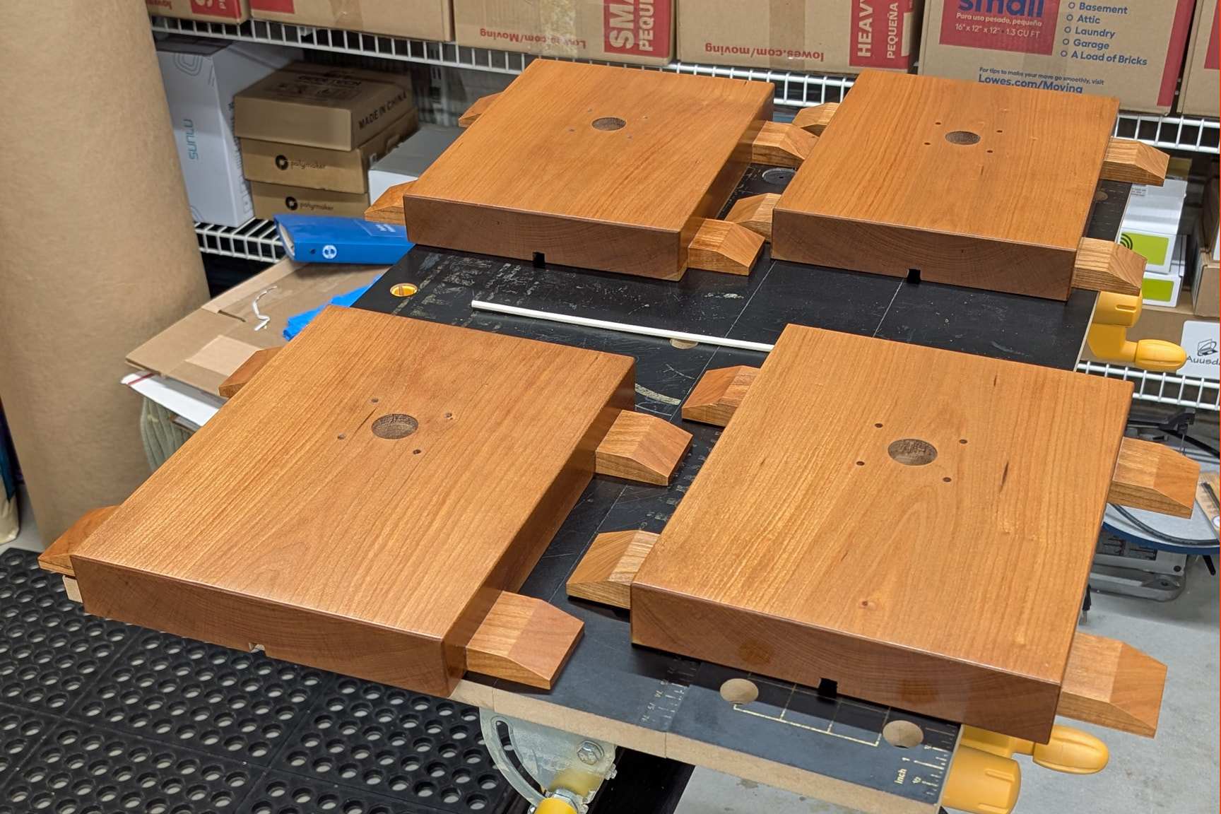

Test fitting outrigger. All outrigger are left slightly proud to be trimmed flush latter.
Gluing outriggers.

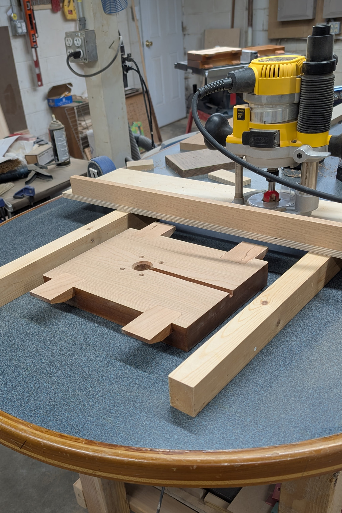

Routing the proud outrigger blocks and base flat with a router jig.

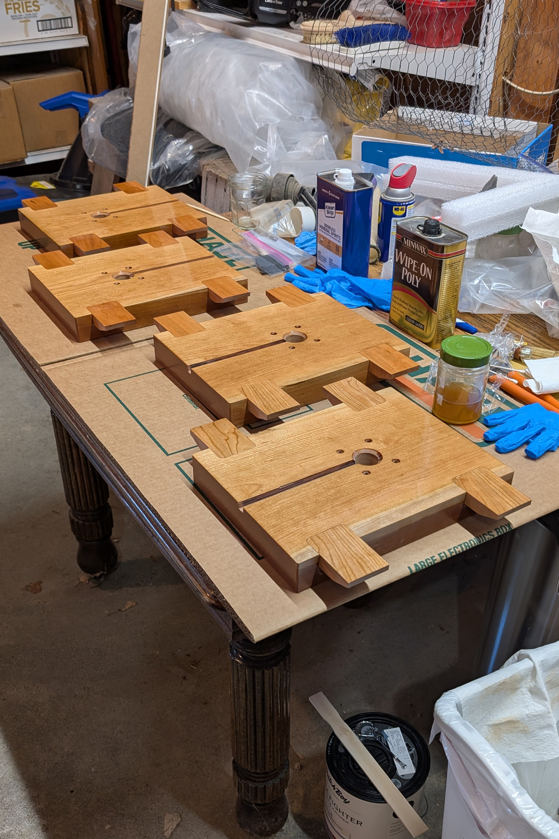

Finishing the bases.
Finished bases.

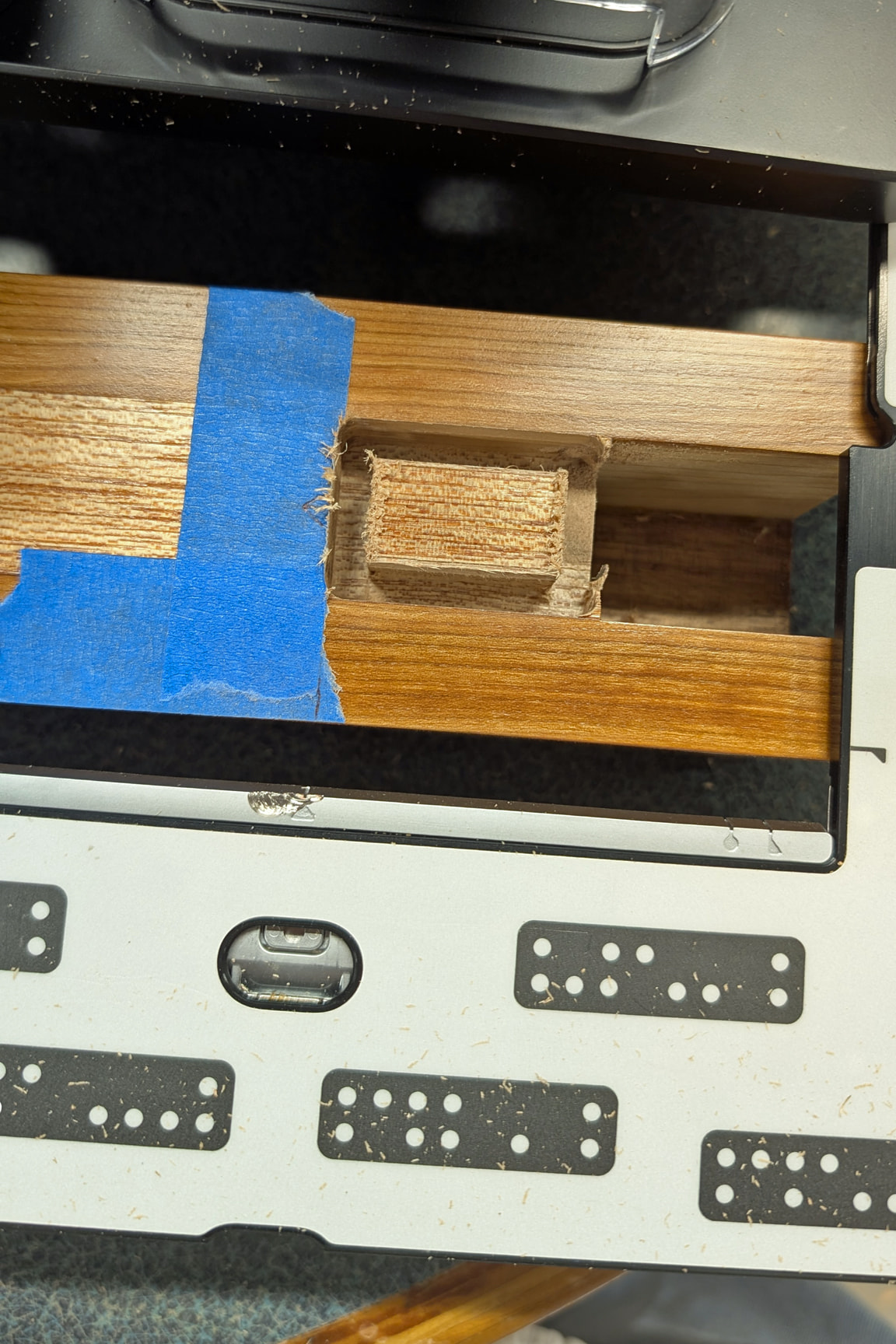

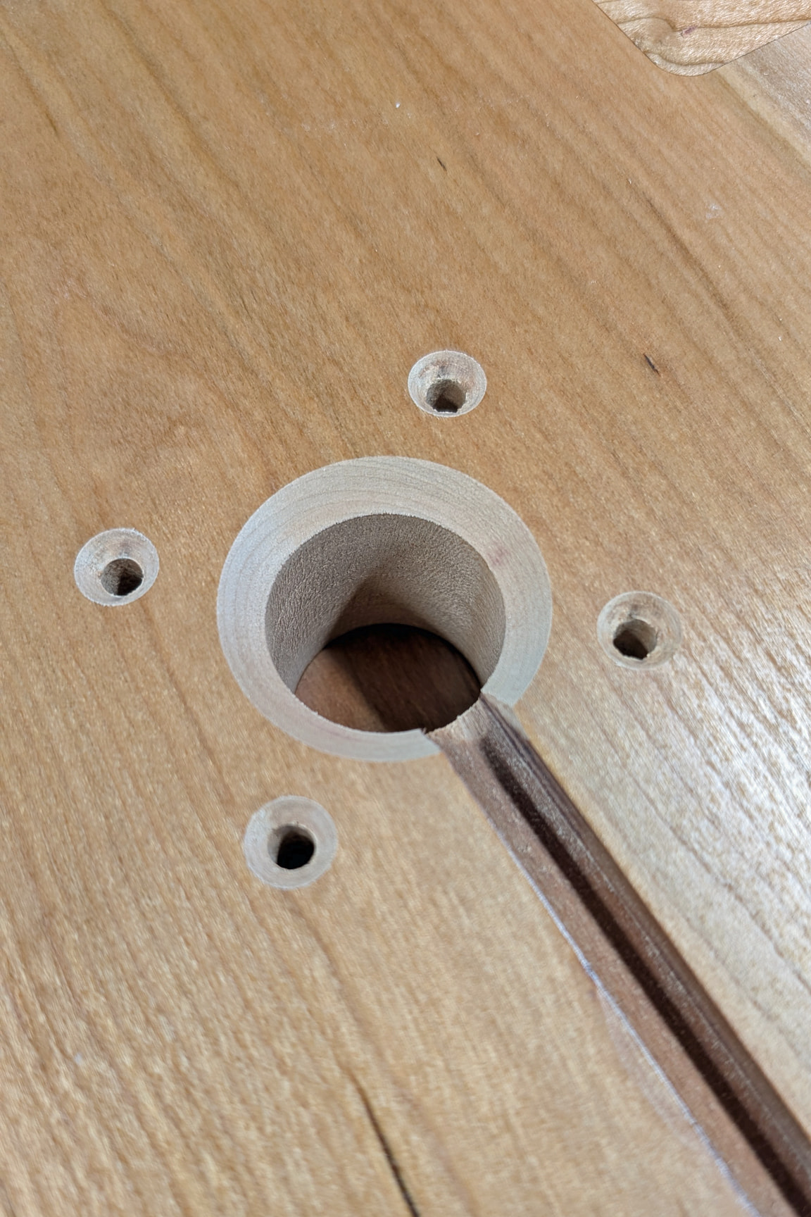

When I tried to install the speaker cable and with its Speakon connector the hole in the base was slightly too small and the cutout at the top of post back was too short for the connector to turn the corner so I needed to rebore the hole larger and cut a longer slot in the back of the post.
I put a scrap of thin plywood on the drill press with double thick tape. I installed the original bit in the drill and used it to position the base and clamp it to the plywood. Then I replaced the bit with a larger one and redrilled the hole at the same position as the original hole.
Re-drilling the bases.
Re-did the chamfer on the bottom of the hole with a bearing bit on the router table and touched up the screw countersinks.

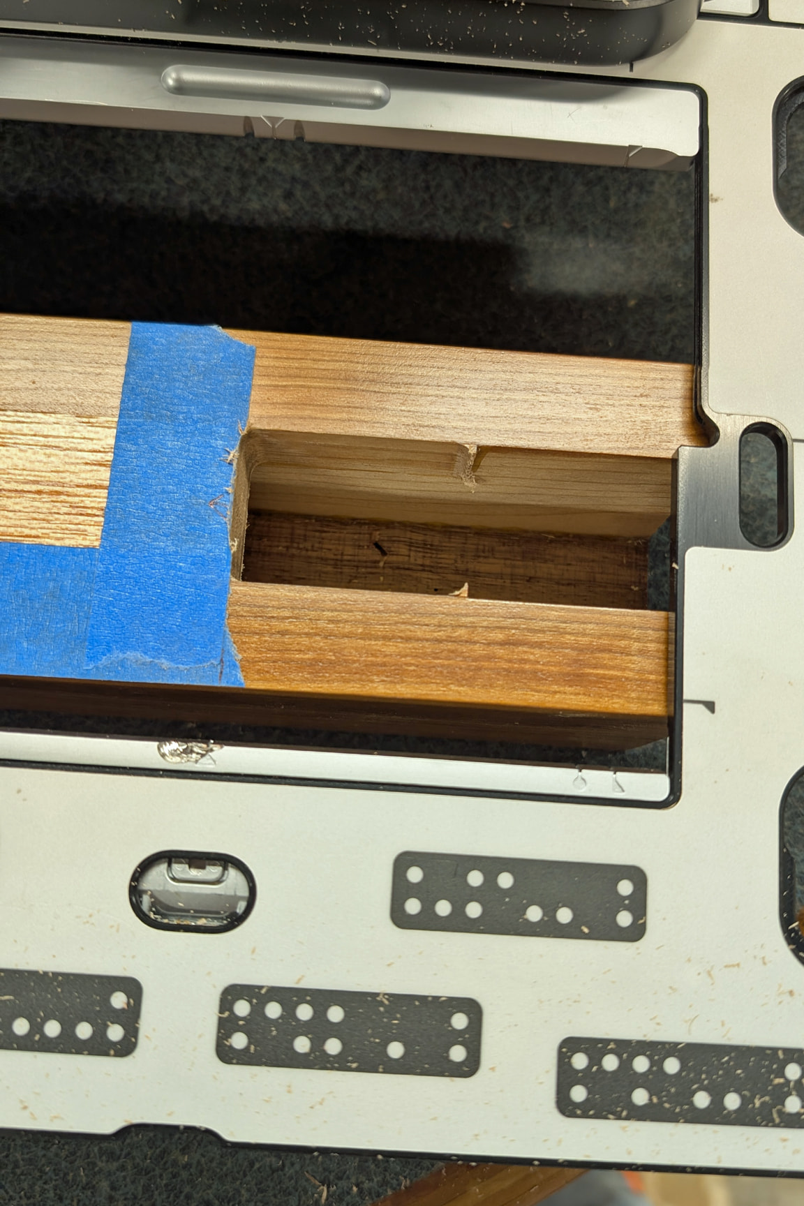

I used the Shaper router to cut the post notch longer.

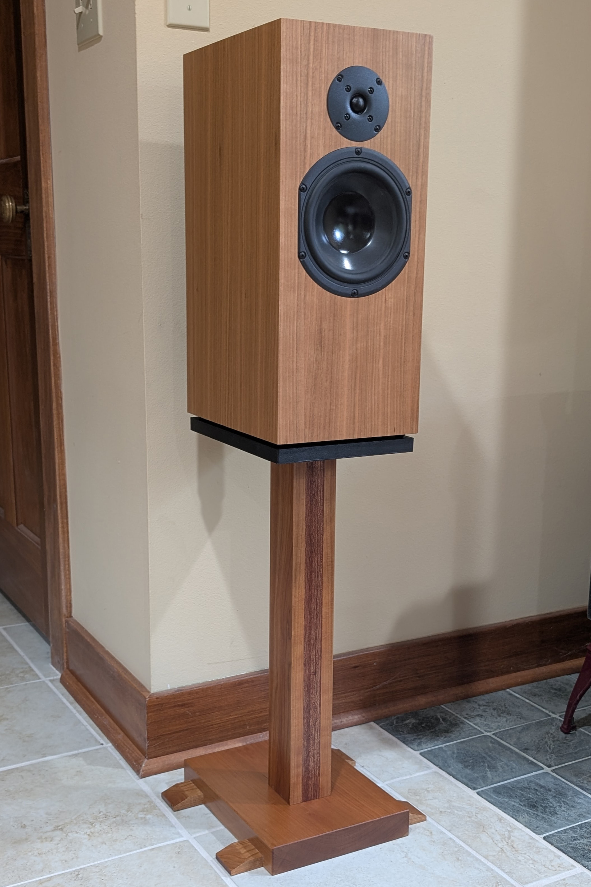

Finished.

The outriggers look nice. Had you not mentioned these were after-the-fact, wouldn’t know. They actually make the base look smaller/ less bulk than if the base extended out that distance.
