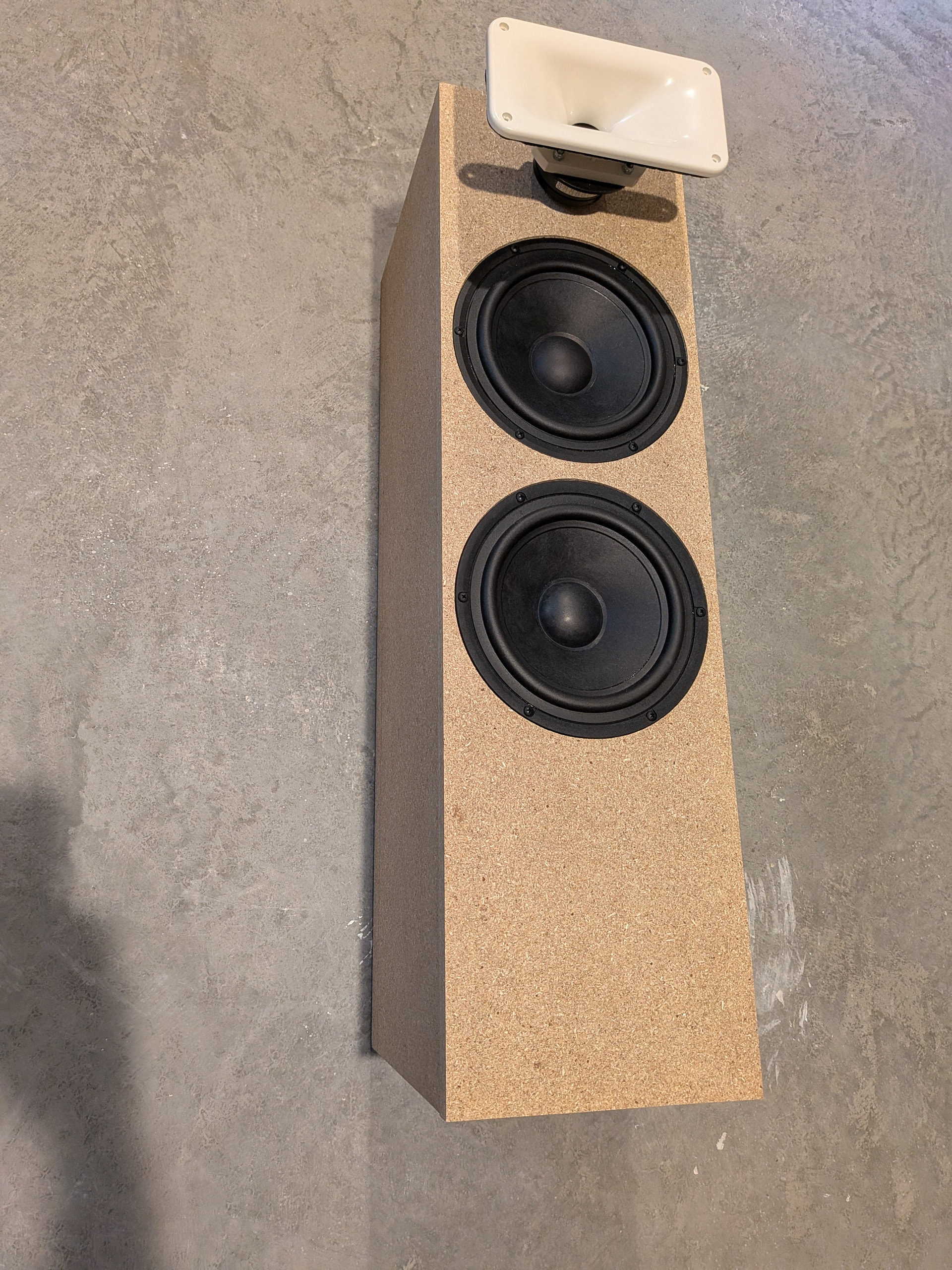

Here is one of mine.
Pay no attention to the Vas in my post, looks like I clicked the wrong thing.
